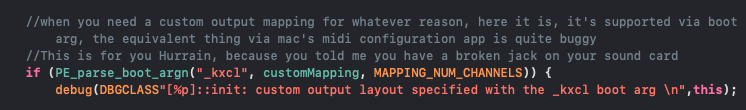

ITzTravelInTime Posted May 4, 2020 Author Share Posted May 4, 2020 (edited) So little update on the driver, it's almost ready, i finished my code checking and now i am just making some find adjustments, i added some funny comments (inspired by the devs at valve) and all the needed credits to all the people from the commiunity who helped, in particular @BiOM1 and @>Alejandro. I added and perfected my huge sample rates support and added support for multiple bit depths, as well as reworking all the boot arg stuff, more details on that later. BTW here there are some of screenshots from the source code just for you to enjoy, while i work on the release. PS: Please admins don't remove the last screenshot please, it's just for fun no one is being hurt EDIT: @Detrich @btwise @BiOM1 @>Alejandro the github repo has been updated with the latest source code, a release will follow in about a couple of days, since i need to prepare a good description for it, but you find a universal 32+64bit binary of the kext (for mac os x 10.6+) and the matching floatlib attached to this post. kxAudioDriver_v2.1.zip Edited May 4, 2020 by ITzTravelInTime Link to comment Share on other sites More sharing options...

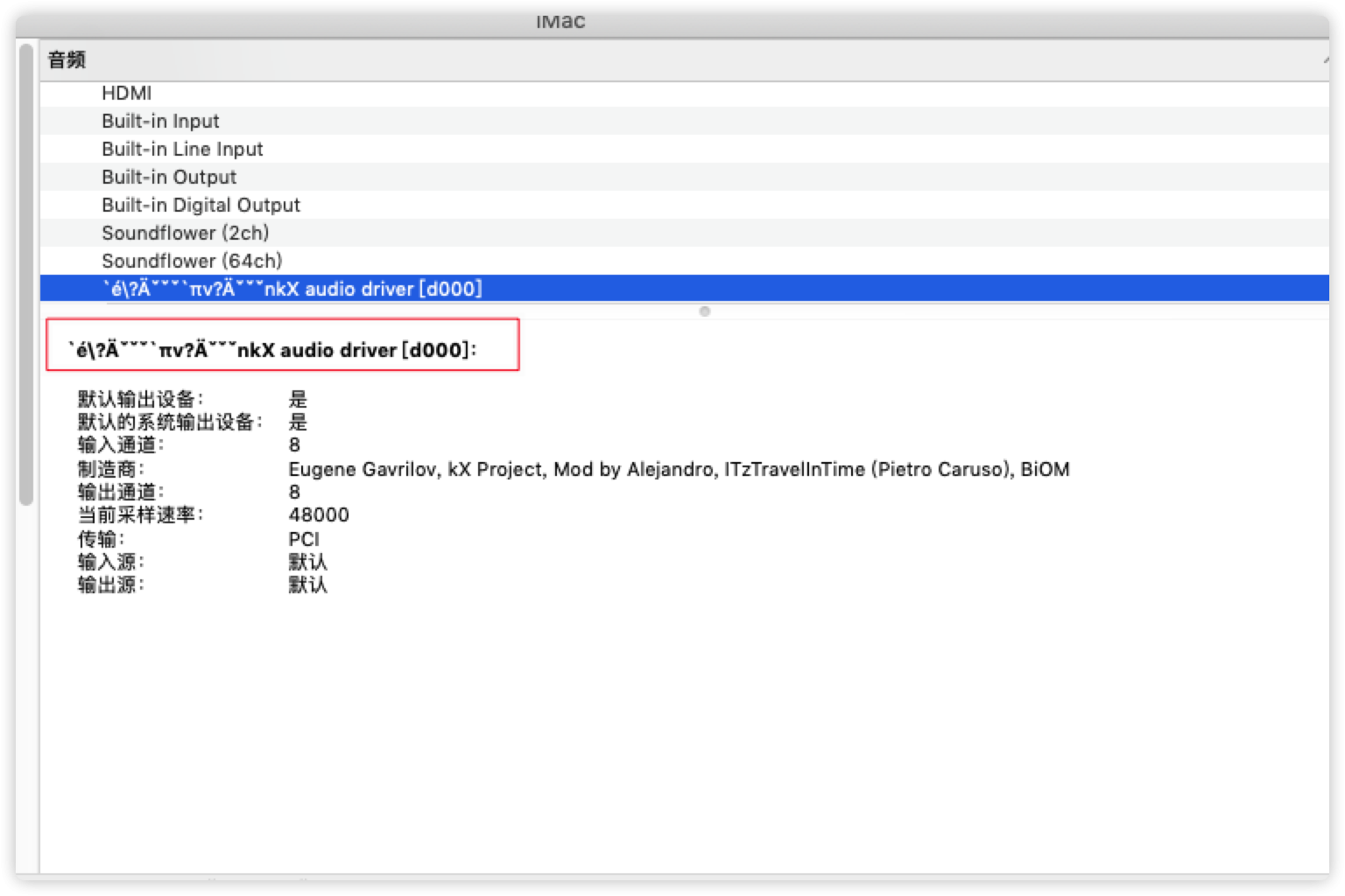

ITzTravelInTime Posted May 5, 2020 Author Share Posted May 5, 2020 (edited) 1 hour ago, btwise said: The new driver has been tested, but it seems that the identified model is not normal. After listening to the music for about 5 minutes, the system crashed but did not restart! 1) it's a known bug which doesn't affect functionality, the driver will still work fine, it only appeared on sierra in my testing (for example on mountain lion it didn't show up), so it's not a deal braker. it's just about something not being quite right with the way the system apis handle the sound card name or some driver bug on specific os versions, it needs be investigated deeply. 2) what sound card do you have? if it isn't recognized with a proper name but it has that generic kx audio driver name, it means that it's not listed in the supported cards list in the frname file, if you whould like to contribute i can try to add proper support for your sound card, or at least to get a proper name to show up, we need to discuss this via private messages. 3) the crash is very wired and unexpected, it never happened on any of my systems with this driver, to boot into the system use the boot arg -kxoff which disables the driver 1 hour ago, btwise said: @ITzTravelInTime The new driver input function is invalid, cannot carry on the recording! You need the kx ac97 app and to set the sampling rate to 48khz, i forgot to mention that recording is still pretty esperimental EDIT: try also to boot with the boot arg _kxcfm=2 EDIT 2: maybe i found a solution to the garbage text bug, but i needs to be tested EDIT 3: small changes committed to the github repo to try to fix those issues Edited May 5, 2020 by ITzTravelInTime Link to comment Share on other sites More sharing options...
btwise Posted May 5, 2020 Share Posted May 5, 2020 4 hours ago, ITzTravelInTime said: 1) it's a known bug which doesn't affect functionality, the driver will still work fine, it only appeared on sierra in my testing (for example on mountain lion it didn't show up), so it's not a deal braker. it's just about something not being quite right with the way the system apis handle the sound card name or some driver bug on specific os versions, it needs be investigated deeply. Although it does not affect the use, it is not very beautiful. 4 hours ago, ITzTravelInTime said: 2) what sound card do you have? if it isn't recognized with a proper name but it has that generic kx audio driver name, it means that it's not listed in the supported cards list in the frname file, if you whould like to contribute i can try to add proper support for your sound card, or at least to get a proper name to show up, we need to discuss this via private messages. The model of my sound card is: Creative Audigy2/Audigy4 Audio MODEL:SB0610 CHIPS:CA0108/CA10300 Device ID:VEN_1102&DEV_0008&SUBSYS_10231102&REV_00 I used xcode11.3.1 to compile your updated github code today, the driver obtained did not load successfully, but with the binary file you published can load normally, I do not know is the compilation problem or your code has a problem! How to set output jack in MACOS, currently only one output can work, but in WINDOWS multiple output jack can work! Link to comment Share on other sites More sharing options...
ITzTravelInTime Posted May 5, 2020 Author Share Posted May 5, 2020 6 hours ago, btwise said: Although it does not affect the use, it is not very beautiful. The model of my sound card is: Creative Audigy2/Audigy4 Audio MODEL:SB0610 CHIPS:CA0108/CA10300 Device ID:VEN_1102&DEV_0008&SUBSYS_10231102&REV_00 I used xcode11.3.1 to compile your updated github code today, the driver obtained did not load successfully, but with the binary file you published can load normally, I do not know is the compilation problem or your code has a problem! How to set output jack in MACOS, currently only one output can work, but in WINDOWS multiple output jack can work! I have added your card to the list, and fixed some compiler stuff, apparently you have some revision of the cards with a different subsystem id than the listed one, and you need xcode xcode 8 if you want the driver to be compatible with sierra or earlyer versions, apparently this is a problem with the macos sdk, but i will upload here a precompiled binary when i can. For the output you need to use the midi configuration system app to configure the 7.1 or 5.1 setup and the you need to playback a some sound source whose supports 5.1 or 7.1, thatàs a limitation of the os and not a limitation of the driver, the driver just gives all the output channels of the card to the. Link to comment Share on other sites More sharing options...
btwise Posted May 5, 2020 Share Posted May 5, 2020 39 minutes ago, ITzTravelInTime said: I have added your card to the list, and fixed some compiler stuff, apparently you have some revision of the cards with a different subsystem id than the listed one, and you need xcode xcode 8 if you want the driver to be compatible with sierra or earlyer versions, apparently this is a problem with the macos sdk, but i will upload here a precompiled binary when i can. I won't be using the early system! So what version of XCODE do I need to compile to get binaries that work? 41 minutes ago, ITzTravelInTime said: For the output you need to use the midi configuration system app to configure the 7.1 or 5.1 setup and the you need to playback a some sound source whose supports 5.1 or 7.1, thatàs a limitation of the os and not a limitation of the driver, the driver just gives all the output channels of the card to the. How to set 5.1 or 7.1 mode in MIDI configuration, I see that there are already 8 channels by default, but only one output hole can be used! Is there a fully functional KX control panel program available under MACOS similar to WINDOWS?KX AC97 is too simple! Link to comment Share on other sites More sharing options...

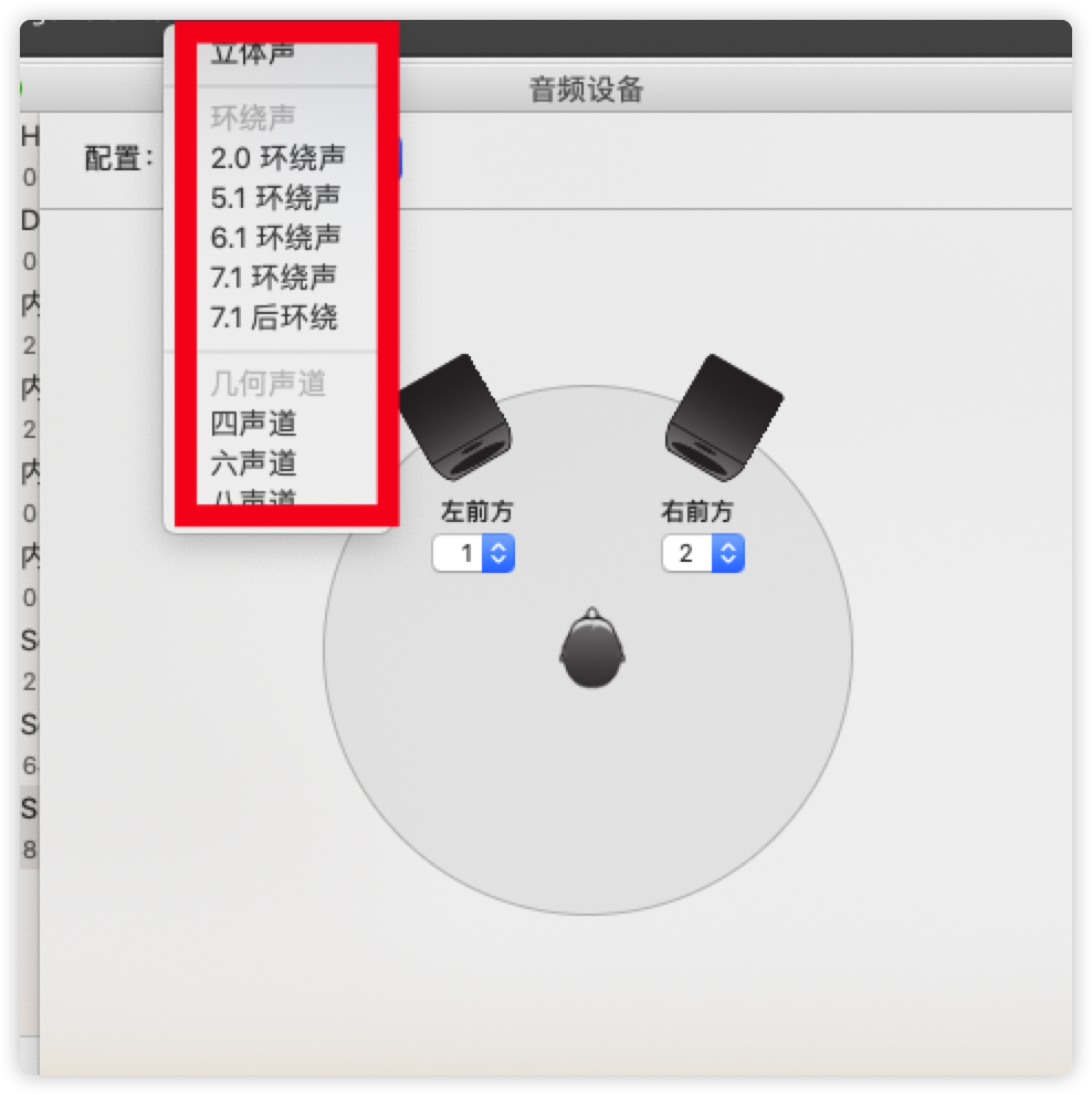

ITzTravelInTime Posted May 5, 2020 Author Share Posted May 5, 2020 2 hours ago, btwise said: I won't be using the early system! So what version of XCODE do I need to compile to get binaries that work? How to set 5.1 or 7.1 mode in MIDI configuration, I see that there are already 8 channels by default, but only one output hole can be used! Is there a fully functional KX control panel program available under MACOS similar to WINDOWS?KX AC97 is too simple! I'll send the compiled binary later, when i can use my mountain lion machine. I am sorry but, there isn't any control panel for mac, porting whould be too complicated and time consuming. For the midi configuration app use the button you see in the picture, which is used to access output setup, then configure the card for 5.1 or 7.1, after that you have to play back something which outputs 7.1 or 5.1, to use the 7.1 or the 5.1, because your normal audio will be played back on only 2 speackers, for exaple you will hear audio on all the speackers by playing a dvd, again that's a limitation of the os, not a limitation of the driver. Link to comment Share on other sites More sharing options...

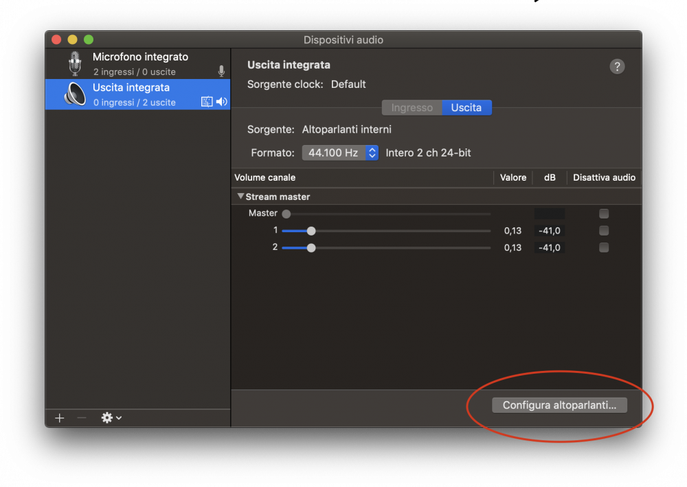

btwise Posted May 6, 2020 Share Posted May 6, 2020 10 hours ago, ITzTravelInTime said: For the midi configuration app use the button you see in the picture, which is used to access output setup, then configure the card for 5.1 or 7.1, after that you have to play back something which outputs 7.1 or 5.1, to use the 7.1 or the 5.1, because your normal audio will be played back on only 2 speackers, for exaple you will hear audio on all the speackers by playing a dvd, again that's a limitation of the os, not a limitation of the driver. Yes, I have tested it, and I can choose 5.1 or 7.1, let the other jack sound, but it seems to lack a 2.1 mode, I use 2.1 stereo, there is a bass stereo and two speakers! Link to comment Share on other sites More sharing options...
ITzTravelInTime Posted May 8, 2020 Author Share Posted May 8, 2020 On 5/6/2020 at 5:15 AM, btwise said: Yes, I have tested it, and I can choose 5.1 or 7.1, let the other jack sound, but it seems to lack a 2.1 mode, I use 2.1 stereo, there is a bass stereo and two speakers! I don't even know if the os has settings for your setup to be honest, maybe it could be achieved using some custom settings. Honestly i don't have that mutch experience with those things and it's not related to the driver, so i think that this is something to investigate separately, so i reccomend you to try to open a new discussion or ask some other apple forums, maybe someone already figured this out and can help you. Link to comment Share on other sites More sharing options...
