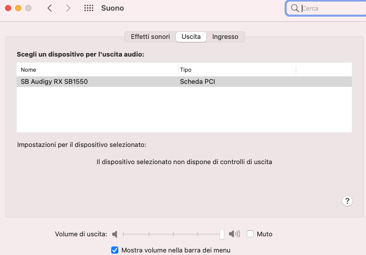

ITzTravelInTime Posted April 23, 2021 Author Share Posted April 23, 2021 6 hours ago, bluenote56 said: As a former hi-fi journalist I'm a little mad about sound reproduction, but you know, wife, son, daughter, your available room and "free mind time" become limited. So I enjoy a little bit my hackintosh also for everything concerning sound & music and this work of yours made my day. Of course I have double boot and I' going to explore the win side (I'm your father..no this was another thing). Thanks again I'll watch for your possible progress. thank you for using my driver fork, about the future i am working on a port of the driver for ppc macs (so i can finally use my audigy 2 zs on my powermac g4, but i am doing to achieve this is hard) and i will roll out some new intel driver releases based on the work i am doing optimizing the driver for the ppc machines. i hope apple will make some apple silicon machines with pcie slots so i can attempt at porting the driver over to them as well, some of the work i did for ppc can be re-used for arm actually. Also let me know about the sound quality of the driver, compared to the windows creative drivers this driver doesn't use any filter or effect, and it uses an apple's library to convert the system's float pcm samples to sint32 samples to be used by the sound card. Link to comment https://www.insanelymac.com/forum/topic/321954-kx-audio-driver-mod-sound-blaster-live-audigy-124rx-emu-edsp/page/21/#findComment-2756303 Share on other sites More sharing options...

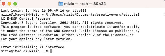

iltenente Posted May 16, 2021 Share Posted May 16, 2021 (edited) Hi, I have an E-MU 1212M PCI card and before the last update to 11.3.1 the driver worked perfectly. Now when I run the edspctrl executable it doesn't work and therefore neither does the driver. You happen to know how to solve the problem. Edited May 16, 2021 by iltenente Link to comment https://www.insanelymac.com/forum/topic/321954-kx-audio-driver-mod-sound-blaster-live-audigy-124rx-emu-edsp/page/21/#findComment-2758249 Share on other sites More sharing options...
ITzTravelInTime Posted May 16, 2021 Author Share Posted May 16, 2021 (edited) On 5/16/2021 at 10:05 AM, iltenente said: Hi, I have an E-MU 1212M PCI card and before the last update to 11.3.1 the driver worked perfectly. Now when I run the edspctrl executable it doesn't work and therefore neither does the driver. You happen to know how to solve the problem. Sorry I haven't tested the driver on this os version and i can't even get my e-mu 0404 to work reguardless the os version, so i couldn't test the edspctrl program myself. Anyway check if the driver is loaded first, you should see the card in the system preferences or in the midi configuration app, if you don't then i reccommend you to install the driver in the /Libray/Extensions folder using a big-sur-compatible kext install tool, since loading of some kexts from th bootloader seems to be broken in big sur 11.3. Edited May 18, 2021 by ITzTravelInTime Link to comment https://www.insanelymac.com/forum/topic/321954-kx-audio-driver-mod-sound-blaster-live-audigy-124rx-emu-edsp/page/21/#findComment-2758255 Share on other sites More sharing options...
iltenente Posted May 17, 2021 Share Posted May 17, 2021 (edited) 21 hours ago, ITzTravelInTime said: Sorry haven't tested the driver on this os version and i can't even get my e-mu 0404 to work reguardless the os version, co i couldn't test the edspctrl program myself. Anyway chech if thedriver is loaded first, you should see the card in the system preferences or in the midi configuration app, if you don't then i reccommend you to install the driver in the /Libray/Extensions folder using a big-sur-compatible kext install tool, since loading of some kexts from th bootloader seems to be broken in big sur 11.3. I tried to install in the folder you suggested but the driver don't load so the problem is the kext load and not edspctrl. In big sur 11.3 for me all worked properly. Edited May 17, 2021 by iltenente Link to comment https://www.insanelymac.com/forum/topic/321954-kx-audio-driver-mod-sound-blaster-live-audigy-124rx-emu-edsp/page/21/#findComment-2758353 Share on other sites More sharing options...
bluenote56 Posted May 18, 2021 Share Posted May 18, 2021 On 5/16/2021 at 10:05 AM, iltenente said: Hi, I have an E-MU 1212M PCI card and before the last update to 11.3.1 the driver worked perfectly. Now when I run the edspctrl executable it doesn't work and therefore neither does the driver. You happen to know how to solve the problem. Hi, have you tried to install the kext as I wrote before? You coud give it a try. Ciao Link to comment https://www.insanelymac.com/forum/topic/321954-kx-audio-driver-mod-sound-blaster-live-audigy-124rx-emu-edsp/page/21/#findComment-2758505 Share on other sites More sharing options...
ITzTravelInTime Posted May 18, 2021 Author Share Posted May 18, 2021 On 5/17/2021 at 9:24 AM, iltenente said: I tried to install in the folder you suggested but the driver don't load so the problem is the kext load and not edspctrl. In big sur 11.3 for me all worked properly. Yes but have you used a proper kext installer tool? just dropping the kext file in the folder i specified will not result in the kext working, you need a tool to take care of it. Also for the kext to work you should have SIP disabled on bis gur, which is a topic which has been covered better in other places of the forum, keep in mind that big sur changes how the SIP works so you have to look for Big Sur specific info. Link to comment https://www.insanelymac.com/forum/topic/321954-kx-audio-driver-mod-sound-blaster-live-audigy-124rx-emu-edsp/page/21/#findComment-2758521 Share on other sites More sharing options...
iltenente Posted May 18, 2021 Share Posted May 18, 2021 1 hour ago, ITzTravelInTime said: Yes but have you used a proper kext installer tool? just dropping the kext file in the folder i specified will not result in the kext working, you need a tool to take care of it. Also for the kext to work you should have SIP disabled on bis gur, which is a topic which has been covered better in other places of the forum, keep in mind that big sur changes how the SIP works so you have to look for Big Sur specific info. Yes I've used Hackintools to rebuild kextcache and repair permissions and I've disabled SIP but the kxdriver don't load! I checked, all the kext in the /Libray/Extensions folder are loaded but not the audio driver! Link to comment https://www.insanelymac.com/forum/topic/321954-kx-audio-driver-mod-sound-blaster-live-audigy-124rx-emu-edsp/page/21/#findComment-2758539 Share on other sites More sharing options...
