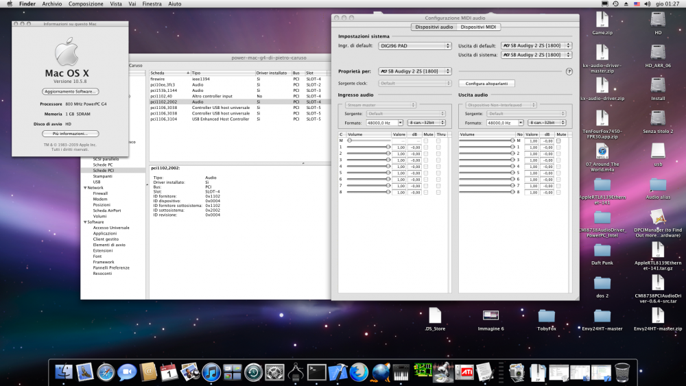

ITzTravelInTime Posted February 26, 2021 Author Share Posted February 26, 2021 (edited) Just an update, i have started working on a fork for PowerPc macs, this fork whould maintain x86 compatibility but it will be focused on getting the driver to work on PowerPC macs running OS X 10.5.x Here is the github branch link: https://github.com/ITzTravelInTime/kx-audio-driver/tree/PPC_Experimental Edit: This fork is currently broken, it can't work on PowerPc macs at the time of writing, because it misses support for the implemen tation of the pci I/O ports on PowerPc, as far as i know it should just work on x86 for now, with the main difference being the fact that it lacks the IOAudioBlitterLib and uses a more simple way of working with audio samples, also audio inputs are broken on this fork. Edited March 1, 2021 by ITzTravelInTime 1 Link to comment https://www.insanelymac.com/forum/topic/321954-kx-audio-driver-mod-sound-blaster-live-audigy-124rx-emu-edsp/page/20/#findComment-2751915 Share on other sites More sharing options...
ITzTravelInTime Posted March 6, 2021 Author Share Posted March 6, 2021 So i have announced i am working on a powerpc kext, but what i didn't tell you is the fact that most likely the kext could also work on apple silicon using almost the exact same code, so if apple will ever release an apple silicon machine featuring pcie slots i think we can get something like the audigy rx working on those machines. All of this depends on if i am able to get it working on power pc, since both shares pretty similar models for pci device usage, that said porting this kext on other platforms i very complicated due to the huge ammount of x86-specific stuff present inside the kext. That said i have done all the gound work that's needed, it mostly needs the finishing touches now and the be debugged. 1 Link to comment https://www.insanelymac.com/forum/topic/321954-kx-audio-driver-mod-sound-blaster-live-audigy-124rx-emu-edsp/page/20/#findComment-2752542 Share on other sites More sharing options...
ITzTravelInTime Posted March 7, 2021 Author Share Posted March 7, 2021 About the PPC port project i have opened a dedicated thread: https://forums.macrumors.com/threads/kx-audio-driver-sound-blaster-live-and-audigy-series-driver-os-x-ppc-porting-project.2287424/ 1 Link to comment https://www.insanelymac.com/forum/topic/321954-kx-audio-driver-mod-sound-blaster-live-audigy-124rx-emu-edsp/page/20/#findComment-2752679 Share on other sites More sharing options...
ctamy Posted March 18, 2021 Share Posted March 18, 2021 Hello ITzTravelInTime I was testing the driver that you publish and the version that Alejandro publishes and I have the following experiences. 1. ITzTravelInTime version: Audio and microphone work on my SB Audigy 2 ZS card. Sound reproduction by iTunes is free from distortion or crackle in the sound. If I play videos on You Tube I hear a crackling sounds. 2. Version> Alejandro: Only the audio works, there is no microphone. Playback by itunes and you tube has no distortions or cracks in the sound. I do not know if it is possible that you can check that little problem when playing videos on You Tube Best regards Link to comment https://www.insanelymac.com/forum/topic/321954-kx-audio-driver-mod-sound-blaster-live-audigy-124rx-emu-edsp/page/20/#findComment-2753334 Share on other sites More sharing options...
ITzTravelInTime Posted March 18, 2021 Author Share Posted March 18, 2021 9 hours ago, ctamy said: Hello ITzTravelInTime I was testing the driver that you publish and the version that Alejandro publishes and I have the following experiences. 1. ITzTravelInTime version: Audio and microphone work on my SB Audigy 2 ZS card. Sound reproduction by iTunes is free from distortion or crackle in the sound. If I play videos on You Tube I hear a crackling sounds. 2. Version> Alejandro: Only the audio works, there is no microphone. Playback by itunes and you tube has no distortions or cracks in the sound. I do not know if it is possible that you can check that little problem when playing videos on You Tube Best regards The issue with youtube seems to come from possible system timer issues, i have tryied working up some solutions like an alterntive sound sample conversion system which made things better for youtube but didn't get rid of issues (and also added some cracking sound issues with some particular sounds as a result of how it works, but at least it is portable to non-x86 architectures and also it is compatible with older os x versions like leopard), i can link this version if you want but it will not sound the best (also recording with it seems to be distorted in my tests). I can give you a download of the latest version with the new sound system and without it, of course all just for testing purposes, those are not fully tested driver releases. Link to comment https://www.insanelymac.com/forum/topic/321954-kx-audio-driver-mod-sound-blaster-live-audigy-124rx-emu-edsp/page/20/#findComment-2753368 Share on other sites More sharing options...
ITzTravelInTime Posted April 1, 2021 Author Share Posted April 1, 2021 I managed to build a version of the driver that loads and has features working on PPC macs, sadly playback still doesn't work, but i am working on figuring out that. 1 Link to comment https://www.insanelymac.com/forum/topic/321954-kx-audio-driver-mod-sound-blaster-live-audigy-124rx-emu-edsp/page/20/#findComment-2754427 Share on other sites More sharing options...
