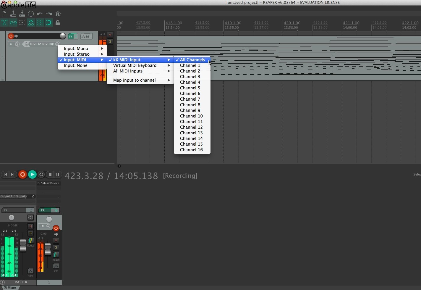

ITzTravelInTime Posted October 15, 2021 Author Share Posted October 15, 2021 4 hours ago, >Alejandro said: I continue to work on my version of the driver. Now I'm working on midi support. While at the initial stage, but there is already a positive result, midi messages from an external source are sent to the DAW. Tests were carried out on e-mu 1616m and audigy 2 zs. That’s great news, in the meanwhile I am working on a port to PPC macs of my fork of the driver, so I can actually use my audigy 2 zs on a Mac with pci slots. For that I had to re-do the stuff reguarding I/o ports amount other things, to support both x86 io ports and memory mapped io ports. I recommend you take a look at that so perhaps you can also use my i/o implementation. Link to comment https://www.insanelymac.com/forum/topic/321954-kx-audio-driver-mod-sound-blaster-live-audigy-124rx-emu-edsp/page/22/#findComment-2769316 Share on other sites More sharing options...

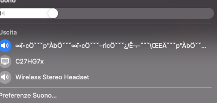

morfy Posted October 30, 2021 Share Posted October 30, 2021 Hi I'm trying monterey and the drive works fine, only when I go to install it it shows me these strange characters ... what could it depend on? Ciao sto provando monterey e il drive funziona bene, solo che quando vado ad installarlo mi fa vedere sti caratteri strani...da cosa può dipendere? Link to comment https://www.insanelymac.com/forum/topic/321954-kx-audio-driver-mod-sound-blaster-live-audigy-124rx-emu-edsp/page/22/#findComment-2770522 Share on other sites More sharing options...
ITzTravelInTime Posted November 1, 2021 Author Share Posted November 1, 2021 On 10/30/2021 at 10:02 PM, morfy said: Hi I'm trying monterey and the drive works fine, only when I go to install it it shows me these strange characters ... what could it depend on? It must be some bug with the macOS system libraries, not really the driver itself, i did a lot of thing to try and fix this issue. But it's just a cosmetic thing, not really a functional bug, perhaps this issue improved in some more recent builds i did, i might try to upload one of them when i can, so you can try it out. Link to comment https://www.insanelymac.com/forum/topic/321954-kx-audio-driver-mod-sound-blaster-live-audigy-124rx-emu-edsp/page/22/#findComment-2770759 Share on other sites More sharing options...
morfy Posted November 2, 2021 Share Posted November 2, 2021 On 11/1/2021 at 5:30 PM, ITzTravelInTime said: It must be some bug with the macOS system libraries, not really the driver itself, i did a lot of thing to try and fix this issue. But it's just a cosmetic thing, not really a functional bug, perhaps this issue improved in some more recent builds i did, i might try to upload one of them when i can, so you can try it out. I realized that every restart it changes its name, but it remains functional ... Link to comment https://www.insanelymac.com/forum/topic/321954-kx-audio-driver-mod-sound-blaster-live-audigy-124rx-emu-edsp/page/22/#findComment-2770897 Share on other sites More sharing options...
ITzTravelInTime Posted November 2, 2021 Author Share Posted November 2, 2021 Just now, morfy said: I realized that every restart it changes its name, but it remains functional ... Yes, the problem is caused just by dirty memory that get's considered as part of the name string for some reason. 1 Link to comment https://www.insanelymac.com/forum/topic/321954-kx-audio-driver-mod-sound-blaster-live-audigy-124rx-emu-edsp/page/22/#findComment-2770898 Share on other sites More sharing options...

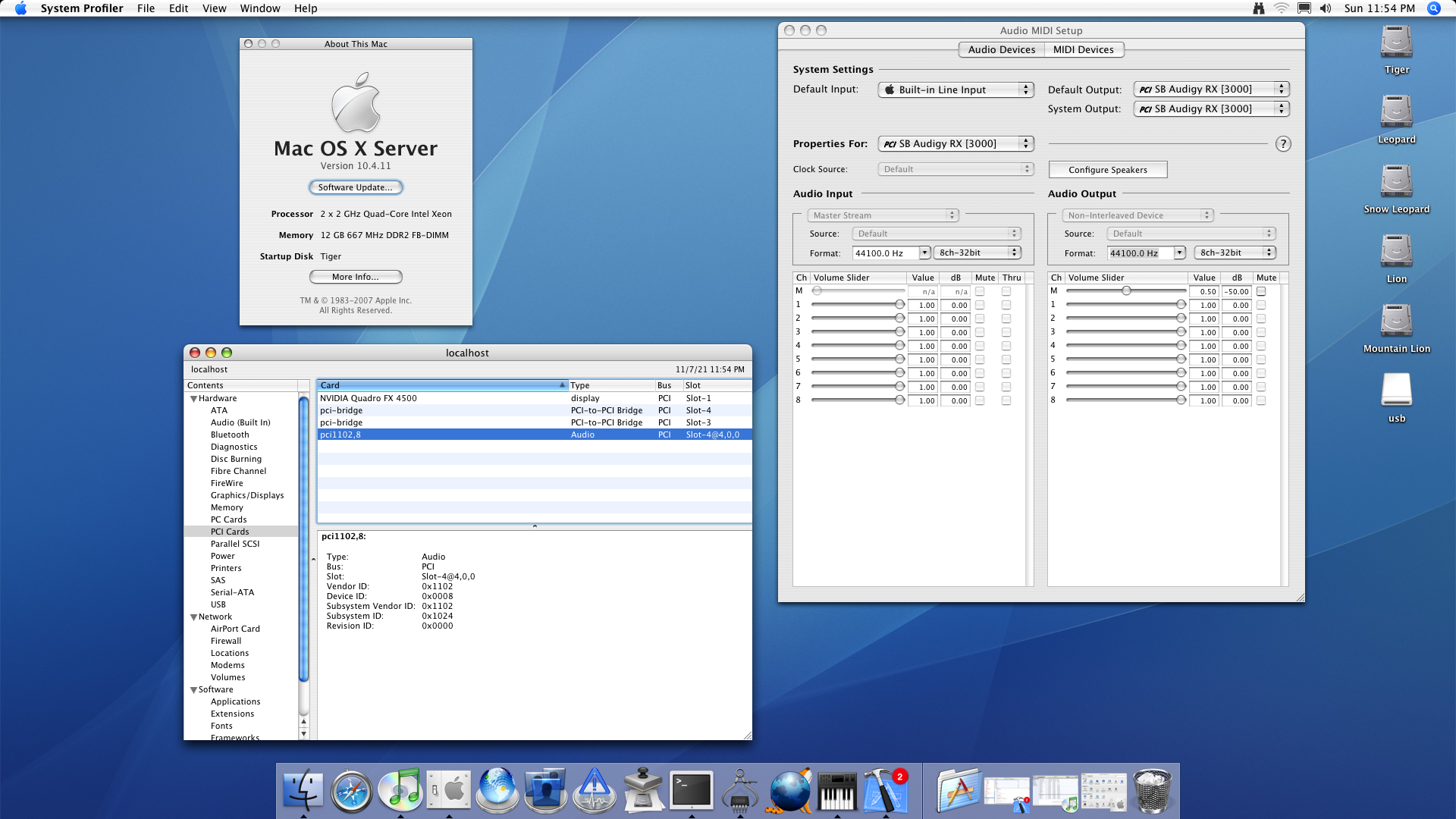

ITzTravelInTime Posted November 7, 2021 Author Share Posted November 7, 2021 So about my back-porting projects for the driver here is it running on OS X Tiger using my mac pro and my sb audigy rx, soon i will try to make a proper 64 bit + 32 bit release for OS X Snow leopard and newer and a 32 bit release for Tiger and Leopard, all those 3 releases will be for x86 computers only (so no PPC support) and the 64 bit version should work also with all OSes past Snow Leopard, inclusing Big Sur and Monterey out of the box (and for now requiring installation in /Library/Extensions for those newer OSes). Here is a screenshot: : 1 Link to comment https://www.insanelymac.com/forum/topic/321954-kx-audio-driver-mod-sound-blaster-live-audigy-124rx-emu-edsp/page/22/#findComment-2771354 Share on other sites More sharing options...

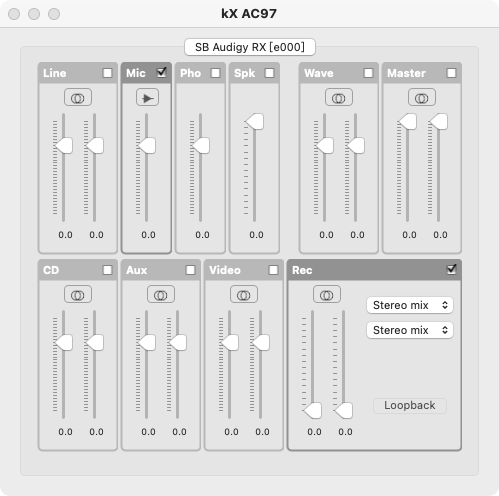

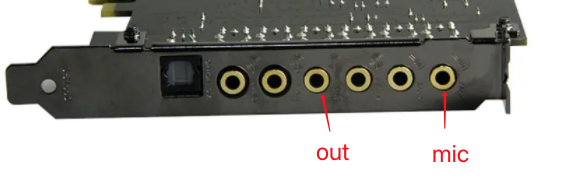

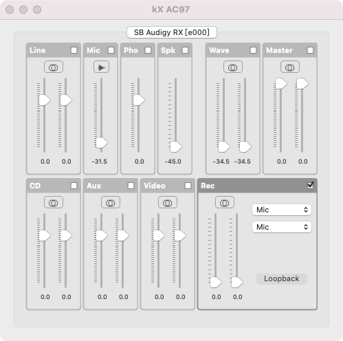

fangf2018 Posted March 20, 2022 Share Posted March 20, 2022 My system version 11.2.3 Sound card I use: sb1550 I want to turn off the headset by AC97, The sound is processed by other software and then output Because I do audio live Now you can't turn off the headset through the sound card, so there will be two sounds Link to comment https://www.insanelymac.com/forum/topic/321954-kx-audio-driver-mod-sound-blaster-live-audigy-124rx-emu-edsp/page/22/#findComment-2778631 Share on other sites More sharing options...
fangf2018 Posted March 20, 2022 Share Posted March 20, 2022 Other buttons don't work. Only rec works to control the microphone Link to comment https://www.insanelymac.com/forum/topic/321954-kx-audio-driver-mod-sound-blaster-live-audigy-124rx-emu-edsp/page/22/#findComment-2778632 Share on other sites More sharing options...

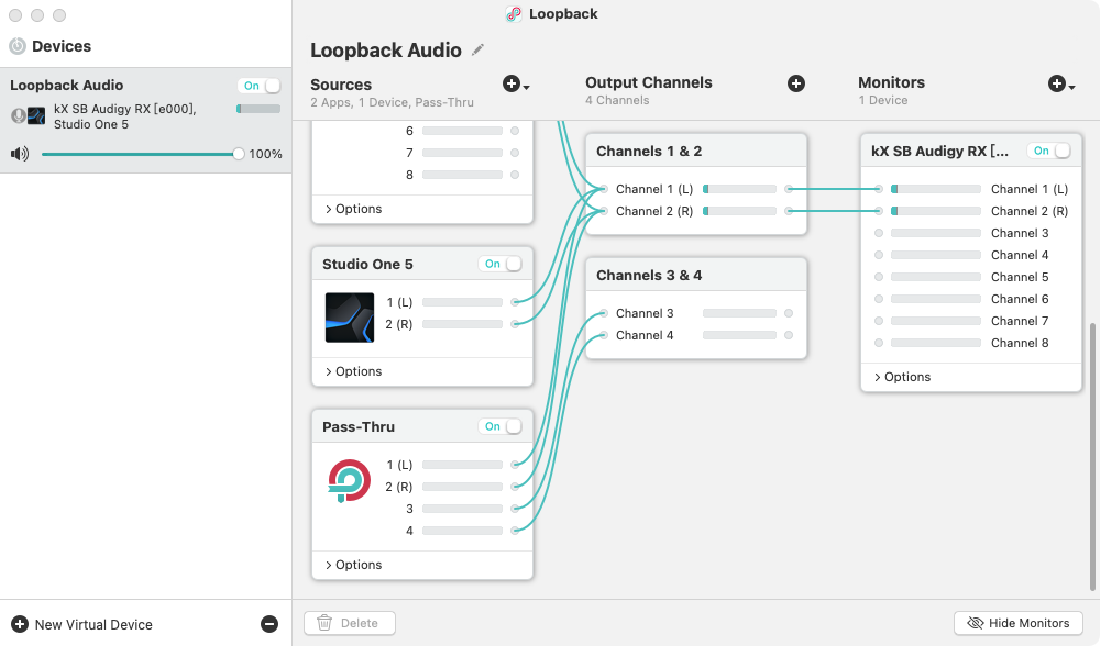

fangf2018 Posted March 21, 2022 Share Posted March 21, 2022 I set it like this, but I can still hear my voice clearly, just a little lower How can I turn off my voice feedback Looking forward to your reply, thank you Link to comment https://www.insanelymac.com/forum/topic/321954-kx-audio-driver-mod-sound-blaster-live-audigy-124rx-emu-edsp/page/22/#findComment-2778744 Share on other sites More sharing options...

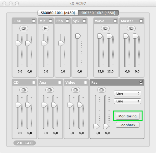

>Alejandro Posted March 21, 2022 Share Posted March 21, 2022 (edited) Just now, fangf2018 said: I set it like this, but I can still hear my voice clearly, just a little lower How can I turn off my voice feedback Looking forward to your reply, thank you Try this kx ac97.app. I have added an input monitoring button. kX AC97.zip Edited March 21, 2022 by >Alejandro Link to comment https://www.insanelymac.com/forum/topic/321954-kx-audio-driver-mod-sound-blaster-live-audigy-124rx-emu-edsp/page/22/#findComment-2778746 Share on other sites More sharing options...
