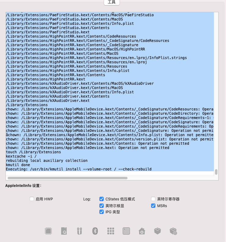

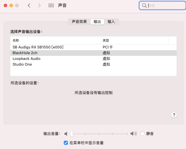

I replaced the SMBIOS and the sound card can't be driven. I didn't try many ways.
Now my system is the latest version of bigsur. I upgraded from a lower version: 10.13 or 10.14 I forgot.
How can I drive again? The current model is MAC mini8,1, while the previous model was imac19,2
I tried to change to 19,2 and still couldn't drive
Trying to add to EFI is no good
You have to install the kext to /library/extensions on Big Sur like people do with voodoohda. Big Sur removed some kext dependencies for this driver from the kernel artifact so this driver no longer works with kext injection from the bootloader.
Edited by ITzTravelInTime
5 hours ago, ITzTravelInTime said:
你必须在Big Sur上安装kext到/library/extension,就像人们对voodoohda所做的那样。Big Sur 从内核工件中删除了此驱动程序的一些 kext 依赖项,因此此驱动程序不再与引导加载程序中的 kext 注入一起使用。
Yes, I tried this operation.
1386687856_2022-04-017_04_59.png.645ab89245be731179cce2b87bcca2da.png1712476836_2022-04-017_04_38.thumb.png.8436038e044b379e6dd3126ea5264c3f.png

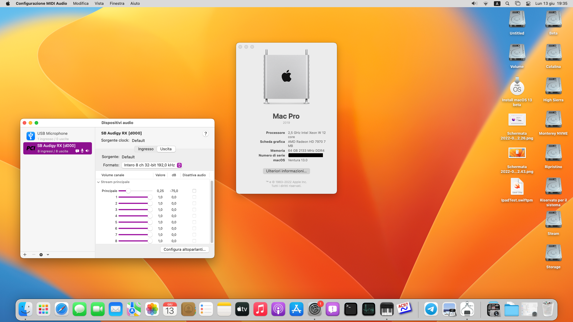

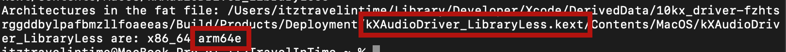

So guys i have news for you, i managed to re-use the work i have made to port the audio driver to PowerPC to port it to ARM64, this means that i have been able to make driver builds that should work on Apple Silicon Macs.
That said there is a major caveat that prevents us from testing it yet:
The driver is just made for PCI/PCIE only devices, and, as far as i am aware, even cards connected trought Thunderbolt adapters are seen as thunderbolt devices by macOS, this means that in order to test the driuver we need apple to release an Apple Silicon mac featuring pcie slots.
That said it's good news that i figured out how to port my custom sound card drivers to Apple Silicon, this means that i will be able to continue my projects in the future assuming that apple will release the rumored Apple Silicon Mac Pro.
For now i leave you this screenshot as a proof of what i did and will push the changes to my github repo for the kx audio driver soon.
2097694817_Schermata2022-09-15alle12_08_57.thumb.png.d0c627471bb7f7552a5eb848b539dc03.png

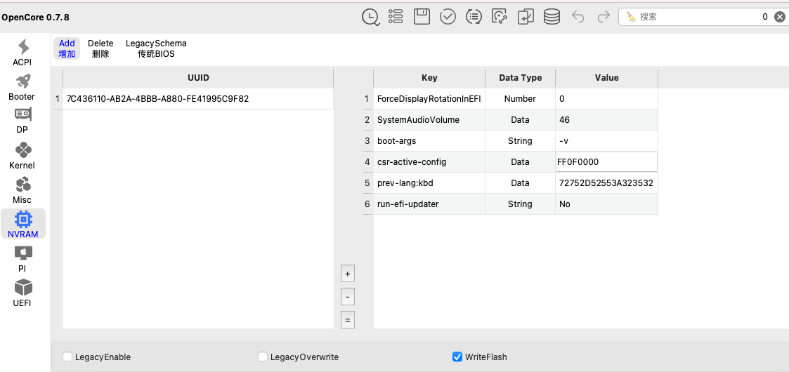

4 hours ago, ruslan61 said:
I couldn't run Audigy 2 ventura 13.0.1
sip ef0f0000
opencore 0.8.7
/Library/Extensions kext copy paste
what is the problem?
I have it working with oc 0.8.6, same sip value, maybe after copying the kext make sure that:
1) The pci device gets detected, use dpci manager for that.
2) Repair file system permits for the /library/extensions folder and perform a partial kextcache rebuild, to do that run those commands inside the terminal:
sudo -i
cd /Library/Extensions
chmod -R 755 ./
chown -R 0:0 ./
touch -f ./
kextcache -i /
kcditto
 and then reboot.
3) Retry with the libraryless build i have posted in one of my previous posts here.

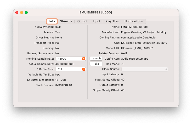

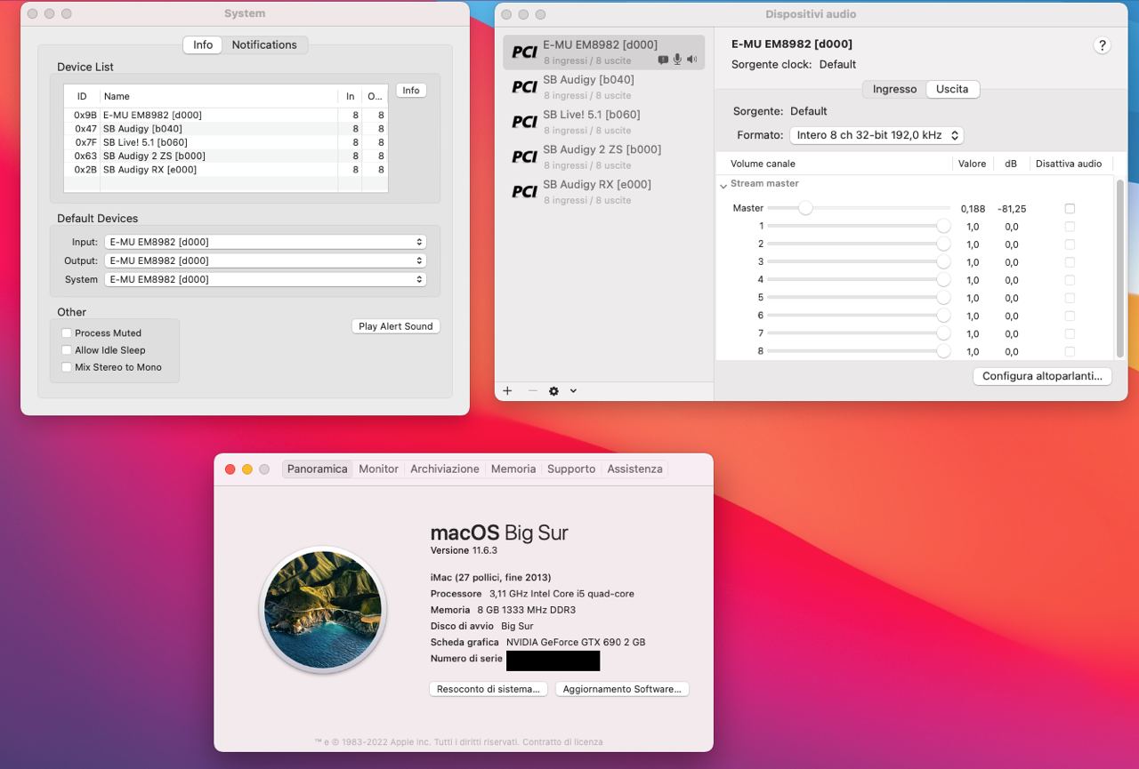

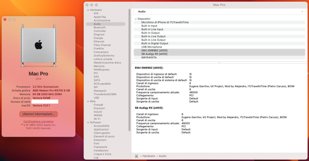

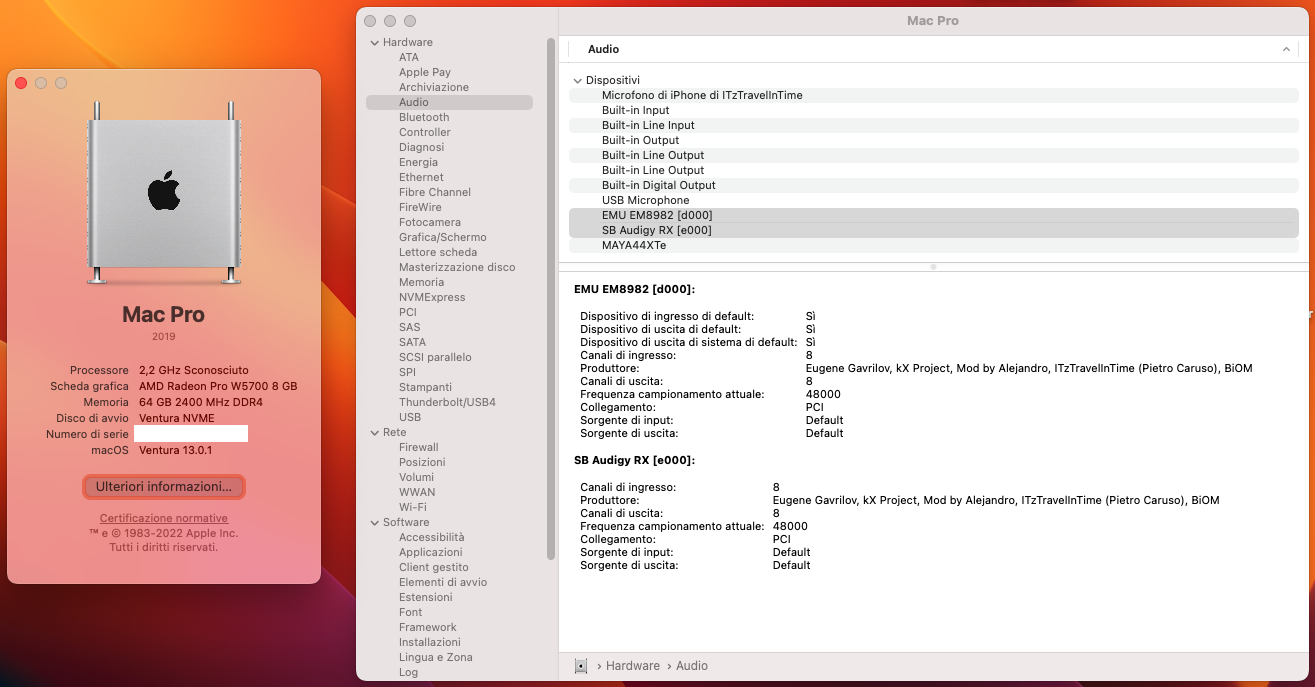

So after i got a second pcie sound card supported by the kx audio driver i made some more tests on macOS ventura with 2 sound cards, and i found out that my fix for multiple cards (and the one used by @>Alejandro in his current github source code) is no longer working, so i figured out a solution that will solve this problem once and for all.
All the info on the fix can be found in this commit: https://github.com/ITzTravelInTime/kx-audio-driver/commit/d32fe400612bb61d5974c46a3641e4b0656229f3
I am still working on that code, so it will be changes, but basically the bulk of the fix is that i am now overriding the getGlobalUniqueID from the IOAudioEngine class to calculate an unique id from scratch, using various information about the current sound card that the driver is using.
In the pictures you can see an exmple of this multiple cards fix working and what the new calculated UID value is.
BTW i have also made another important change in my driver fork, i have migrated from using custom functions implemented using x86 I/O ports instructions (or direct I/O memory space access for the PowerPC port) to now using the system-provvided I/O Read/Write functions, this not only allows for safer driver operation (delegating I/O comunication responsibility to the OS) but could allow for way better driver potability, potentially also allowing an ARM port in the future.
For now the driver seems to be working well even for inputs on the E-MU card, however there are still issues i have yet to understand how to fix, so would like to at least tackle those before ever pubblishing any new releases out. If you want i can also post some early build for you to test out.
Anyway, thank you for the attention and support.
1306133775_Screenshot2022-12-12alle01_27_45.thumb.png.7efc581d456a923fa646b887ebe8fd2c.png

If you use the setIndex function to get more than one sound card to show up, i can confidently say that it's broken on ventura and it will not work. According to some documentation attached to the open source release for apple's IOAudioFamily kext, overriding the audio engine's getGlobalUniqueID function, like i did , is the way to go to ensure that all the devices will show up. I recommend you to implement it too, it's and easy fix.

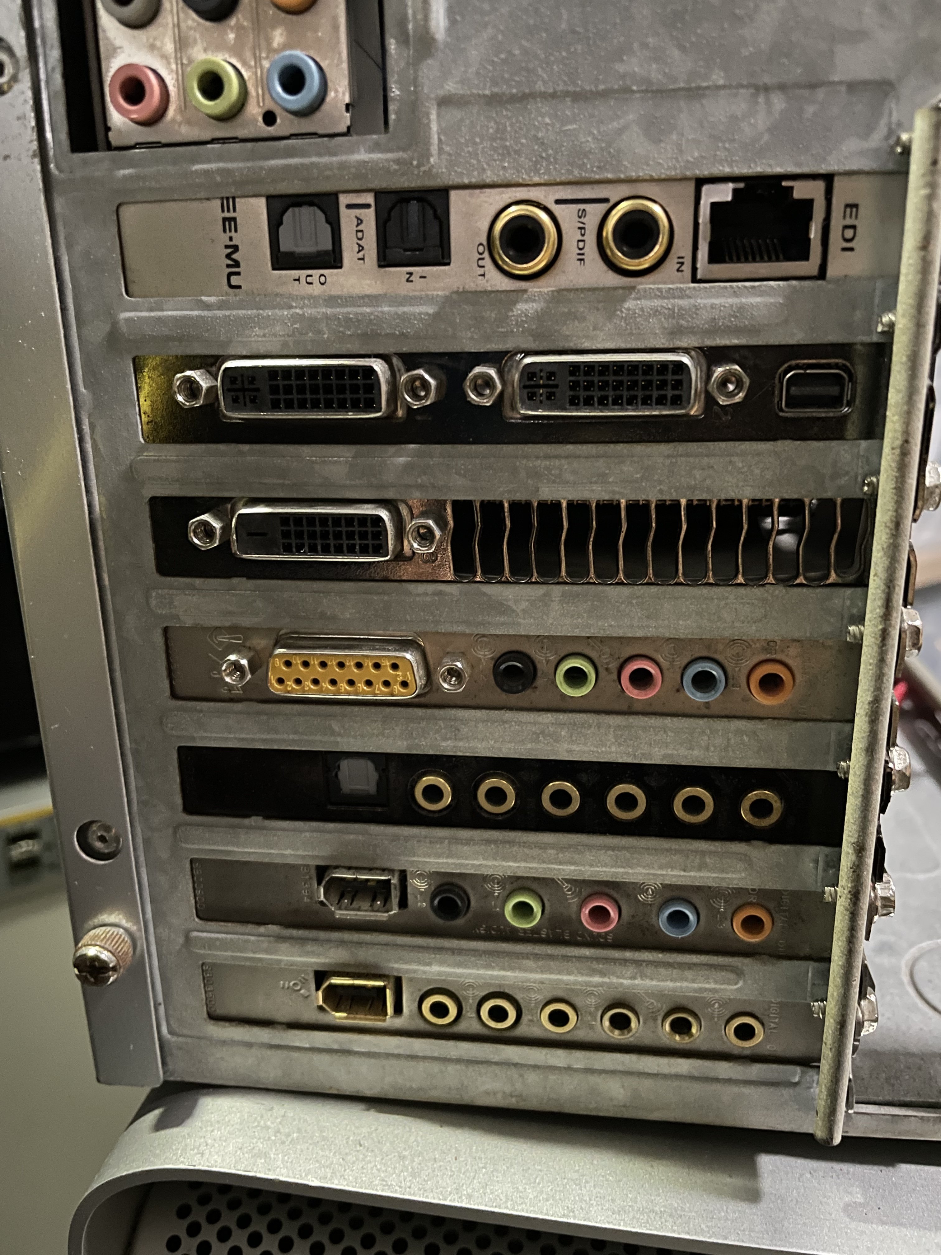

BTW i did some 5 cards testing today and everything worked as expected with this new driver build i made (see attached pictures).

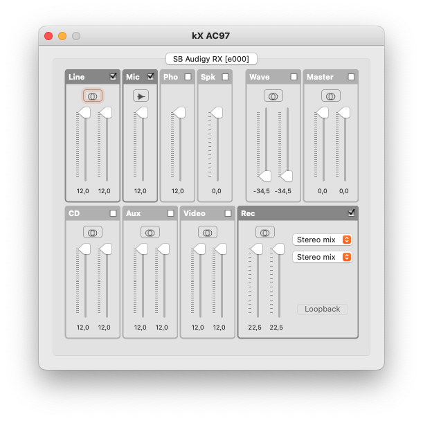

Update: i managed to fix the cracking sounds on the audigy rx but not the e-mu 1212m pcie (all running on the same pc, using the same driver, the only major difference is that the e-mu is attached to the 1616m dock, i am investigating this issue)
Anyway since it's ready to test, at least for audigy rx users, i have attached to this post the new driver build in 2 flawors (the normal one and the libraryless one that is more AMD CPUs friendly since it drops the usage of vector instructions).
Those binaries are compiled for High Sierra onwards, but they should work with some older versions too, test them and let me know, if you need it, i can compile the from snow leopard to get a more compatible binary.
To enable recording you must also setup the ac97 app like so (see the spoiler):
Spoiler
kXAudioDriver_LibraryLess.kext.zip kXAudioDriver.kext.zip
