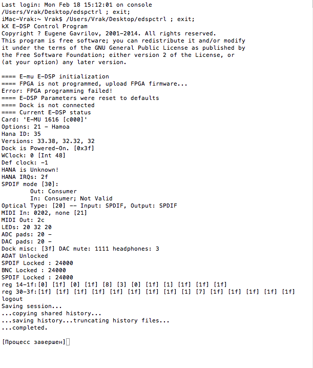

Vrak Posted February 13, 2019 Share Posted February 13, 2019 Hey. ITzTravelInTime Thank you for your excellent work. High Sierra system 10.13.6, E-mu 12 12 m pcie. made the installation of drivers from Eugene, could not boot! deleted the driver through safe mode (-x) and added YOUR kext to the clover loader (usb). When the system boots, you need to reset the settings in the terminal, as in the old version of the Eugene driver (edspctrl -reset), so that the sound appears! the sound sometimes drops (as I understand it because of the buffer, but it rarely happens), the sampling frequency 192 does not work (-kx_beta) !!! E-mu 12 12 m pcie is defined as E-MU EM8982. Thanks again to YOU and> Alejandro. I am an inexperienced hakintoshnik! Maybe I did something wrong, but I tried to convey the course of my actions and the result of your work !!! Alejandro Kext has not tested yet. Sorry for my google translate !!! Link to comment https://www.insanelymac.com/forum/topic/321954-kx-audio-driver-mod-sound-blaster-live-audigy-124rx-emu-edsp/page/13/#findComment-2663965 Share on other sites More sharing options...
ITzTravelInTime Posted February 13, 2019 Author Share Posted February 13, 2019 (edited) 1 hour ago, Vrak said: Hey. ITzTravelInTime Thank you for your excellent work. High Sierra system 10.13.6, E-mu 12 12 m pcie. made the installation of drivers from Eugene, could not boot! deleted the driver through safe mode (-x) and added YOUR kext to the clover loader (usb). When the system boots, you need to reset the settings in the terminal, as in the old version of the Eugene driver (edspctrl -reset), so that the sound appears! the sound sometimes drops (as I understand it because of the buffer, but it rarely happens), the sampling frequency 192 does not work (-kx_beta) !!! E-mu 12 12 m pcie is defined as E-MU EM8982. Thanks again to YOU and> Alejandro. I am an inexperienced hakintoshnik! Maybe I did something wrong, but I tried to convey the course of my actions and the result of your work !!! Alejandro Kext has not tested yet. Sorry for my google translate !!! 1) thank you for appreciating my work. 2) the edspctrl is something you will always need for emu cards. 3) the 192 is part of the kx_beta feature because it doesn't work and neither me or alejandro were able to find a way to make it work, but that's just a reasampleing, so you can't get better quality than 48khz with my actual driver, and the driver from alejandro is just supporting 44.1 and 48khz but at hw level without resapling on emu cards. 4) the model name is just cosmtic stuff and the important thing is that the card is properly working and also that model number you see as the card's name refers to the model of the card's pcb not of the actual sound card model. 5) i am working on a new driver based from the work of alejandro, it's working quite well and i have also created a setup to make an universal 32 + 64 bit version of the driver, currently is working mutch better than my actual driver, the only problems are to get recording to work right twaeking the settings inside the kxac97 app and a copuple of problems i am still having with my sound blaster audigy rx, which is suffering from some strange high pitched noise in the brackground for playback i couldn't figure out how to solve, but i have to do some other tests for some possible solutions Edited February 13, 2019 by ITzTravelInTime Link to comment https://www.insanelymac.com/forum/topic/321954-kx-audio-driver-mod-sound-blaster-live-audigy-124rx-emu-edsp/page/13/#findComment-2663970 Share on other sites More sharing options...

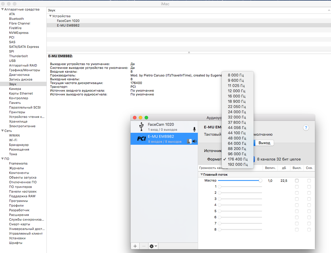

Vrak Posted February 14, 2019 Share Posted February 14, 2019 ITzTravelInTime Thanks for clarifying the points. I installed the Alejandro driver today. When watching a video on YouTube, there is a constant noise. Returned to your driver. Everything is normal !!! Link to comment https://www.insanelymac.com/forum/topic/321954-kx-audio-driver-mod-sound-blaster-live-audigy-124rx-emu-edsp/page/13/#findComment-2664036 Share on other sites More sharing options...
>Alejandro Posted February 15, 2019 Share Posted February 15, 2019 17 hours ago, Vrak said: I installed the Alejandro driver today. When watching a video on YouTube, there is a constant noise. I reduced the size of the buffer, and I had no problems. Now I have Audigy 2 zs and with it there is also no such problem. Probably I will have to increase the size of the buffer, to its previous size. 1 Link to comment https://www.insanelymac.com/forum/topic/321954-kx-audio-driver-mod-sound-blaster-live-audigy-124rx-emu-edsp/page/13/#findComment-2664113 Share on other sites More sharing options...
ITzTravelInTime Posted February 15, 2019 Author Share Posted February 15, 2019 On 2/14/2019 at 4:48 PM, Vrak said: ITzTravelInTime Thanks for clarifying the points. I installed the Alejandro driver today. When watching a video on YouTube, there is a constant noise. Returned to your driver. Everything is normal !!! i noted the noise also on one of my cards, i wonder if it's the case of the buffer, but on almost all my acrds seems to be fine, there is just some white noise if you set the volume really high Link to comment https://www.insanelymac.com/forum/topic/321954-kx-audio-driver-mod-sound-blaster-live-audigy-124rx-emu-edsp/page/13/#findComment-2664160 Share on other sites More sharing options...
ITzTravelInTime Posted February 15, 2019 Author Share Posted February 15, 2019 9 hours ago, >Alejandro said: I reduced the size of the buffer, and I had no problems. Now I have Audigy 2 zs and with it there is also no such problem. Probably I will have to increase the size of the buffer, to its previous size. i have some white noise with the audigy 1 sb0090 at high volume (but it's not mutch) and the audigy rx gives me some high pitched noise from the headphones out which is present at low volume too and that's really annoing, maybe going back to the previous code for the buffer could solve this i guess, but i wonder if the distortion fix will still work Link to comment https://www.insanelymac.com/forum/topic/321954-kx-audio-driver-mod-sound-blaster-live-audigy-124rx-emu-edsp/page/13/#findComment-2664161 Share on other sites More sharing options...
Vrak Posted February 15, 2019 Share Posted February 15, 2019 10 hours ago, >Alejandro said: I reduced the size of the buffer, and I had no problems. Now I have Audigy 2 zs and with it there is also no such problem. Probably I will have to increase the size of the buffer, to its previous size. Hello. Thank you for accepting participation as well !!! Maybe I incorrectly installed your kext? I launched install emu !!! and rebooted !!!I can install your program again !!! and check the crackle? Link to comment https://www.insanelymac.com/forum/topic/321954-kx-audio-driver-mod-sound-blaster-live-audigy-124rx-emu-edsp/page/13/#findComment-2664163 Share on other sites More sharing options...

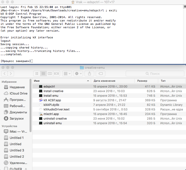

ITzTravelInTime Posted February 15, 2019 Author Share Posted February 15, 2019 1 minute ago, Vrak said: Hello. Thank you for accepting participation as well !!! Maybe I incorrectly installed your kext? I launched install emu !!! and rebooted !!!I can install your program again !!! and check the crackle? you can install his kext in the same way you install mine, you have just to do the edspctrl thing with the edspctrl which cames with his driver, that's it, we have just modded the same thing afterall Link to comment https://www.insanelymac.com/forum/topic/321954-kx-audio-driver-mod-sound-blaster-live-audigy-124rx-emu-edsp/page/13/#findComment-2664164 Share on other sites More sharing options...

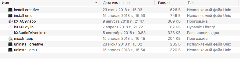

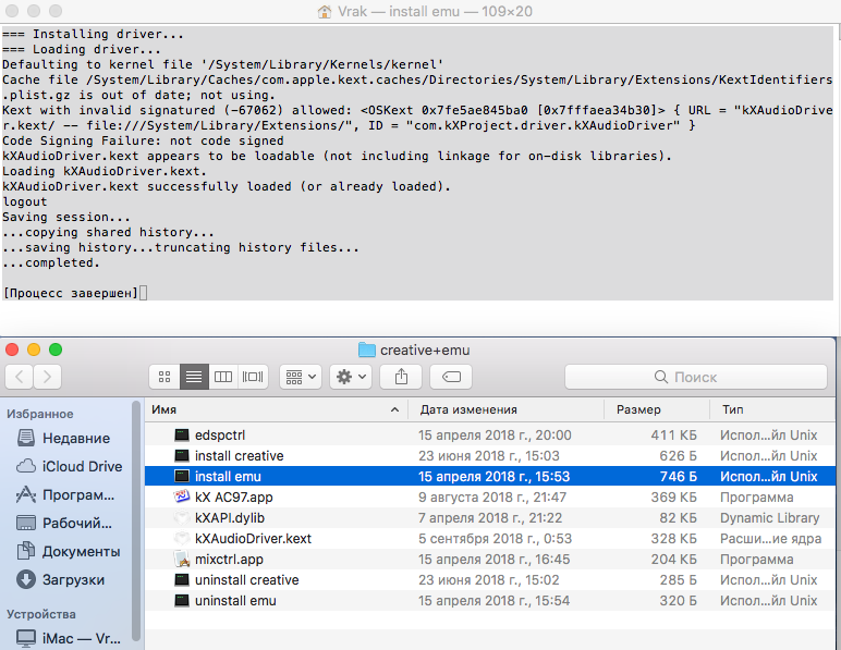

Vrak Posted February 15, 2019 Share Posted February 15, 2019 (edited) 27 minutes ago, ITzTravelInTime said: you can install his kext in the same way you install mine, you have just to do the edspctrl thing with the edspctrl which cames with his driver, that's it, we have just modded the same thing afterall I delete your kext through the Installer.sh- terminal, and from efi (usb) and reboot !!! and spend the installation kext Alejandro !!! Edited February 15, 2019 by Vrak Link to comment https://www.insanelymac.com/forum/topic/321954-kx-audio-driver-mod-sound-blaster-live-audigy-124rx-emu-edsp/page/13/#findComment-2664166 Share on other sites More sharing options...
Vrak Posted February 15, 2019 Share Posted February 15, 2019 installation install emu Link to comment https://www.insanelymac.com/forum/topic/321954-kx-audio-driver-mod-sound-blaster-live-audigy-124rx-emu-edsp/page/13/#findComment-2664167 Share on other sites More sharing options...

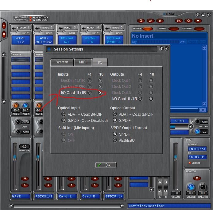

Vrak Posted February 18, 2019 Share Posted February 18, 2019 3 hours ago, >Alejandro said: I did not increase the buffer.) If I increase the size of the buffer back, the sound recording works poorly. I need to understand what the problem is and fix it. Unfortunately I do not have a microphone !!! I turn on one of the outputs to the input (autputs-input) and do not see any changes on the microphone display !!! mixctrl, as I understand it, does not work, as heard in Windows I / O Card 1L / 1R (mechanical switching), also at the output of +4 and -10 are not involved !!! Now increased playback speed !!! I do not know what it is connected with !!! before this was not so that the playback speed increased !!! Link to comment https://www.insanelymac.com/forum/topic/321954-kx-audio-driver-mod-sound-blaster-live-audigy-124rx-emu-edsp/page/13/#findComment-2664497 Share on other sites More sharing options...
ITzTravelInTime Posted February 18, 2019 Author Share Posted February 18, 2019 1 minute ago, Vrak said: Unfortunately I do not have a microphone !!! I turn on one of the outputs to the input (autputs-input) and do not see any changes on the microphone display !!! mixctrl, as I understand it, does not work, as heard in Windows I / O Card 1L / 1R (mechanical switching), also at the output of +4 and -10 are not involved !!! Now increased playback speed !!! I do not know what it is connected with !!! before this was not so that the playback speed increased !!! You should use alejandro's driver because the current version of my driver has several known issues and lacks of inputs, instead it should work better with iot's version, we are now working together to fix some of the problems Link to comment https://www.insanelymac.com/forum/topic/321954-kx-audio-driver-mod-sound-blaster-live-audigy-124rx-emu-edsp/page/13/#findComment-2664500 Share on other sites More sharing options...
>Alejandro Posted February 18, 2019 Share Posted February 18, 2019 (edited) 40 minutes ago, Vrak said: Unfortunately I do not have a microphone !!! I turn on one of the outputs to the input (autputs-input) and do not see any changes on the microphone display !!! mixctrl, as I understand it, does not work, as heard in Windows I / O Card 1L / 1R (mechanical switching), also at the output of +4 and -10 are not involved !!! Now increased playback speed !!! I do not know what it is connected with !!! before this was not so that the playback speed increased !!! Instead of a microphone, you can use a smartphone) Loopback is not the right solution. When was the speedupt playback, what was the frequency, 44100? It seems to me, I had this, if the frequency was 44.1 and turn on the PC. The relay doesn’t switch because emu 1212 has a IO card and not a dock, I couldn’t test it on my 1616. Thanks for testing! Edited February 18, 2019 by >Alejandro Link to comment https://www.insanelymac.com/forum/topic/321954-kx-audio-driver-mod-sound-blaster-live-audigy-124rx-emu-edsp/page/13/#findComment-2664504 Share on other sites More sharing options...
Vrak Posted February 18, 2019 Share Posted February 18, 2019 24 minutes ago, ITzTravelInTime said: You should use alejandro's driver because the current version of my driver has several known issues and lacks of inputs, instead it should work better with iot's version, we are now working together to fix some of the problems I set everything from here !!!https://www.hardwareheaven.com/community/threads/e-mu-1616-driver-working-inputs.247780/ Link to comment https://www.insanelymac.com/forum/topic/321954-kx-audio-driver-mod-sound-blaster-live-audigy-124rx-emu-edsp/page/13/#findComment-2664505 Share on other sites More sharing options...
