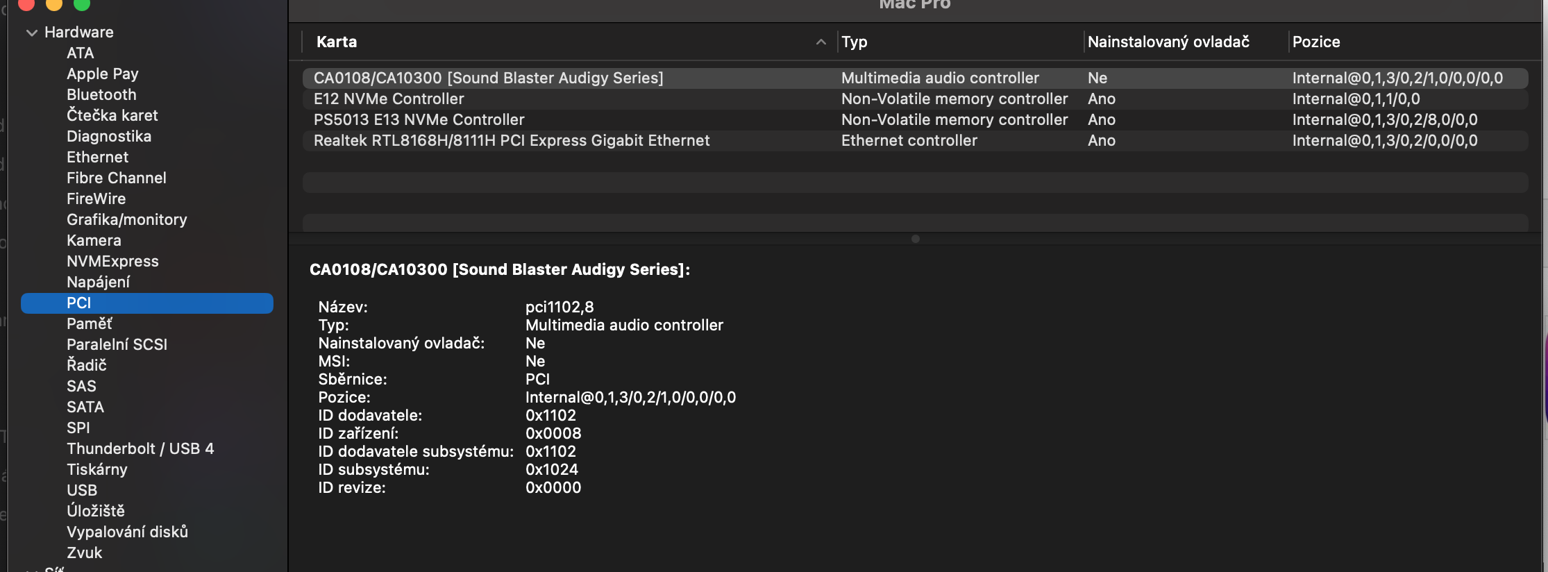

83427 Posted May 19, 2023 Share Posted May 19, 2023 (edited) Hola, is it possible this driver doesn't work on AMD Ryzen powered Hackintosh machines? I'm running this clover EFI: https://github.com/sileshn/Ryzentosh and I never had such problems with kext like this. It simply doesn't work. I see the audigy rx card in pcie devices but without driver loaded. Sound card works well in windows. I placed kext into both OpenCore kext folder and library extensions. Sure I also tried the trick with permissions some pages back. Of course without any difference. When I disabled SIP, system was very slow and I wasnt able to open settings and most of the apps - its freezing. So I dont even know it it helped to the driver somehow. My setup is Gigabyte B450 Aorus Elite, Ryzen 5800X, Radeon Rx6800 XT Edited May 19, 2023 by 83427 1 Link to comment https://www.insanelymac.com/forum/topic/321954-kx-audio-driver-mod-sound-blaster-live-audigy-124rx-emu-edsp/page/24/#findComment-2804786 Share on other sites More sharing options...

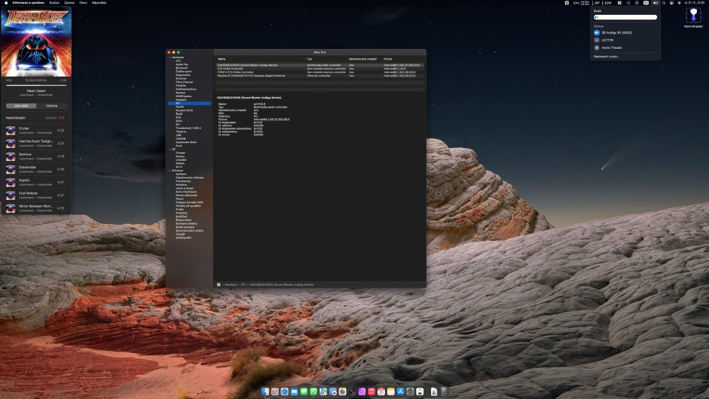

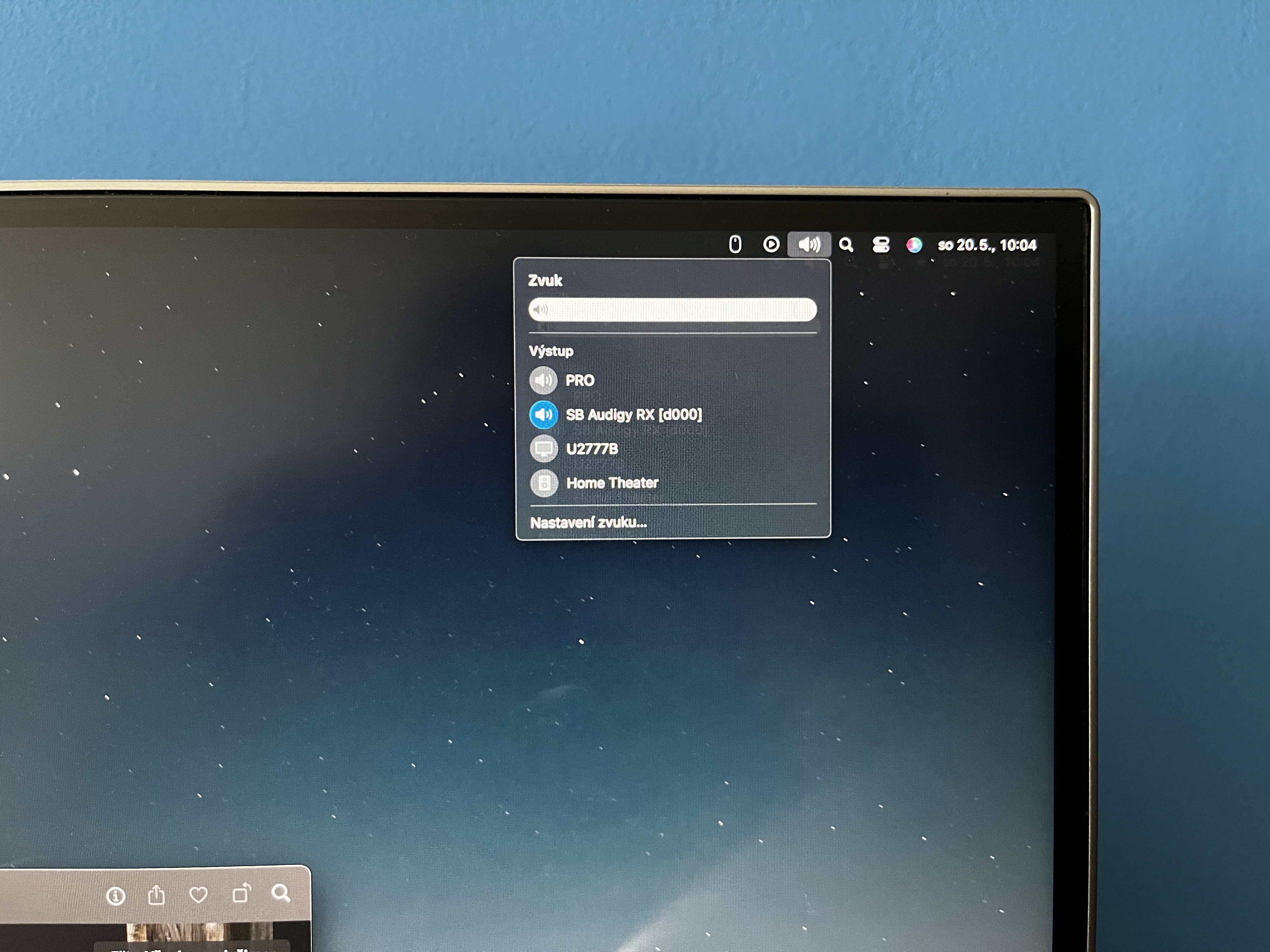

morfy Posted June 18, 2024 Share Posted June 18, 2024 On 4/16/2024 at 6:00 PM, leogel said: Did you try Sonoma 14.4.1? I try the kx audio driver on 14.4.1. It didn't work. I use the one one Page 23. which you was issue on December 27, 2022. Do you mind provide the newest driver? Thank you! I'm writing to you from Sonoma latest beta version and the audio works even if disturbed. I'm attaching some screenshots. Link to comment https://www.insanelymac.com/forum/topic/321954-kx-audio-driver-mod-sound-blaster-live-audigy-124rx-emu-edsp/page/24/#findComment-2821404 Share on other sites More sharing options...
leogel Posted July 3, 2024 Share Posted July 3, 2024 On 6/18/2024 at 4:59 AM, morfy said: Thank you very much! which driver are you using? Do you mind provide to me? Thank you! I'm writing to you from Sonoma latest beta version and the audio works even if disturbed. I'm attaching some screenshots. 1 Link to comment https://www.insanelymac.com/forum/topic/321954-kx-audio-driver-mod-sound-blaster-live-audigy-124rx-emu-edsp/page/24/#findComment-2822142 Share on other sites More sharing options...
