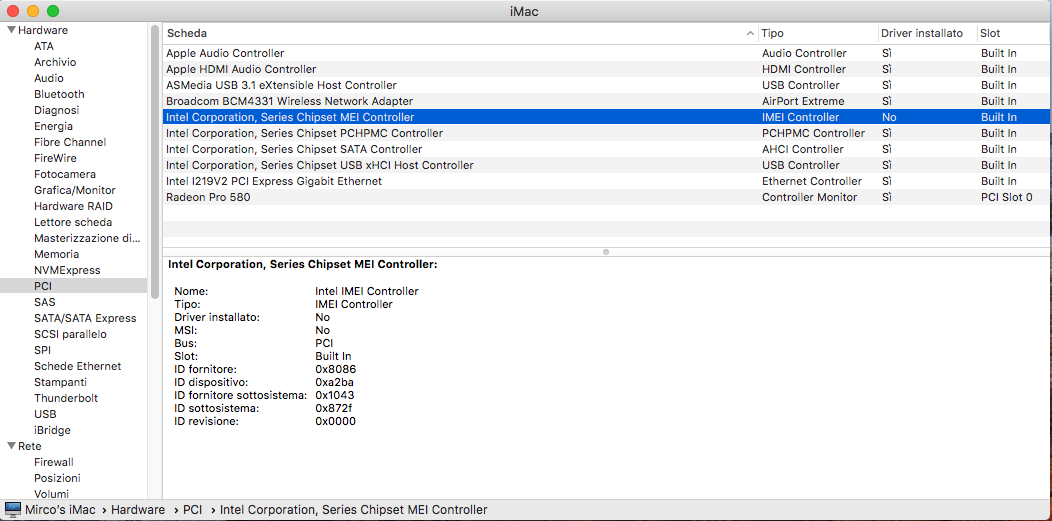

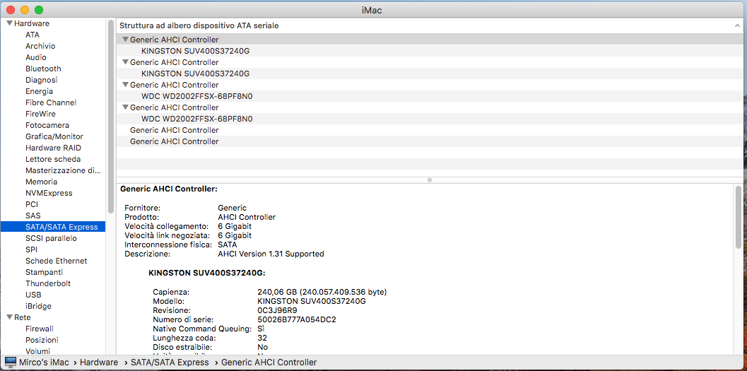

Check-IN Posted January 8, 2018 Share Posted January 8, 2018 Replace, Reboot, New ioreg with new files CLOVER.zip MaLd0n thanx for reply! I attach the new IO reg. Now i can see the PCI in System Profiler but, as You can see from the pics, the driver MEi in not installed (??) and the SATA AHCI Controller is GENERIC... I also attach a report of AIDA because I also installed a Thunderbolt EX3 card and I would like to enable the integrated Intel Hd 630 video card that is currently disabled. Let me know Thank you! Mirco’s iMac.ioreg.zip Report_ AIDA_.html.zip 1 Link to comment https://www.insanelymac.com/forum/topic/321872-guide-catalina-bigsur-monterey-on-mobos-serie-100-200-300-400-500-600-skylake-kabylake-coffeelake-cometlake-rocketlake-alderlake-dsdt/page/61/#findComment-2564551 Share on other sites More sharing options...

MaLd0n Posted January 8, 2018 Author Share Posted January 8, 2018 MaLd0n thanx for reply! I attach the new IO reg. Now i can see the PCI in System Profiler but, as You can see from the pics, the driver MEi in not installed (??) and the SATA AHCI Controller is GENERIC... I also attach a report of AIDA because I also installed a Thunderbolt EX3 card and I would like to enable the integrated Intel Hd 630 video card that is currently disabled. Let me know Thank you! DSDT.sata.zip Thunderbolt, u need a Windows, go to thunderbolt manufacturer page, install updates about ur Thunderbolt(in Windows), after it, work in mac, need only a patches for work better IMEI only load if u use intelhd graphics hi Maldon!! I'm sorry it took so long. Thank you! looks good 1 Link to comment https://www.insanelymac.com/forum/topic/321872-guide-catalina-bigsur-monterey-on-mobos-serie-100-200-300-400-500-600-skylake-kabylake-coffeelake-cometlake-rocketlake-alderlake-dsdt/page/61/#findComment-2564704 Share on other sites More sharing options...

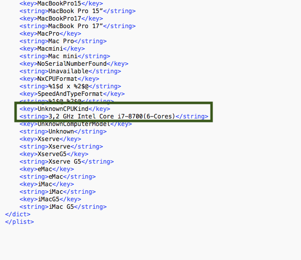

dingailin_11 Posted January 9, 2018 Share Posted January 9, 2018 Hello,Can you help me with my dsdt stuff? i7 8700K+Z370 gaming 5 also the system cant recognize the name of 8700K just 3.7GHZ unkown,any ideas to fix this? CLOVER.zip 1 Link to comment https://www.insanelymac.com/forum/topic/321872-guide-catalina-bigsur-monterey-on-mobos-serie-100-200-300-400-500-600-skylake-kabylake-coffeelake-cometlake-rocketlake-alderlake-dsdt/page/61/#findComment-2565085 Share on other sites More sharing options...
MaLd0n Posted January 9, 2018 Author Share Posted January 9, 2018 Hello,Can you help me with my dsdt stuff? i7 8700K+Z370 gaming 5 also the system cant recognize the name of 8700K just 3.7GHZ unkown,any ideas to fix this? CLOVER.zip unkown cpu run in terminal open . /System/Library/PrivateFrameworks/AppleSystemInfo.framework/Versions/A/Resources/English.lproj/ and edit.. 1 Link to comment https://www.insanelymac.com/forum/topic/321872-guide-catalina-bigsur-monterey-on-mobos-serie-100-200-300-400-500-600-skylake-kabylake-coffeelake-cometlake-rocketlake-alderlake-dsdt/page/61/#findComment-2565326 Share on other sites More sharing options...
