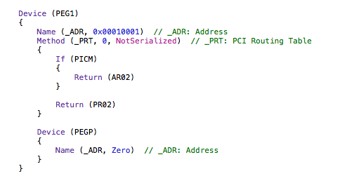

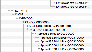

MaLd0n Posted January 4, 2018 Author Share Posted January 4, 2018 Hey Maldon, I've been using your DSDT for Z370-G for a while, everything was great until today it stopped loading Nvidia Web Driver. Removing the DSDT works but I can't recover from sleep. One change could be that I installed a PCI-E USB-C card. Here's my IOReg and Clover folder. Thanks! Files were too big so I uploaded them on Dropbox https://www.dropbox.com/sh/2n4ds7q3all0s6g/AAAAaG-KaxdkHW5p3OphGpYEa?dl=0 here, try without mod and add, just replace, test ur USBs CLOVER.zip check, dont use rename patch, u urename PEGP to GFX0(GFX0 is a Video device) and check... ur card usb-c stay inside peg1/pegp...u rename to gfx0 use only GFX0 to IGPU and NvidiaGraphicsFixup.kext rename PEG0/PEGP to PEG0/GFX0 on the fly for u 1 Link to comment Share on other sites More sharing options...

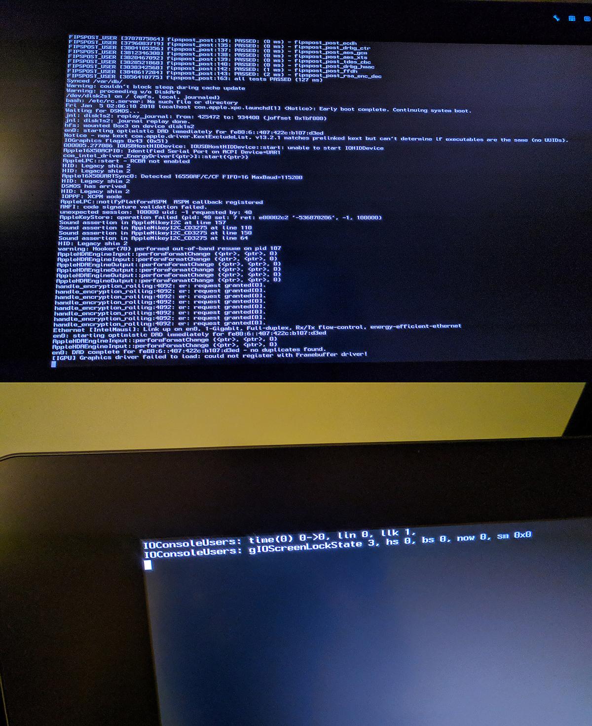

ryokun6 Posted January 4, 2018 Share Posted January 4, 2018 here, try without mod and add, just replace, test ur USBs CLOVER.zip check, dont use rename patch, u urename PEGP to GFX0(GFX0 is a Video device) and check... ur card usb-c stay inside peg1/pegp...u rename to gfx0 MaLd0n 2018-01-04 às 13.05.14.png MaLd0n 2018-01-04 às 13.05.34.png use only GFX0 to IGPU and NvidiaGraphicsFixup.kext rename PEG0/PEGP to PEG0/GFX0 on the fly for u Thanks! You're awesome. Sometimes boot hangs at gIOScreenLockState 3, do you know why? 1 Link to comment Share on other sites More sharing options...
MaLd0n Posted January 4, 2018 Author Share Posted January 4, 2018 Thanks! You're awesome. Sometimes boot hangs at gIOScreenLockState 3, do you know why? try config.plist.zip 2 Link to comment Share on other sites More sharing options...

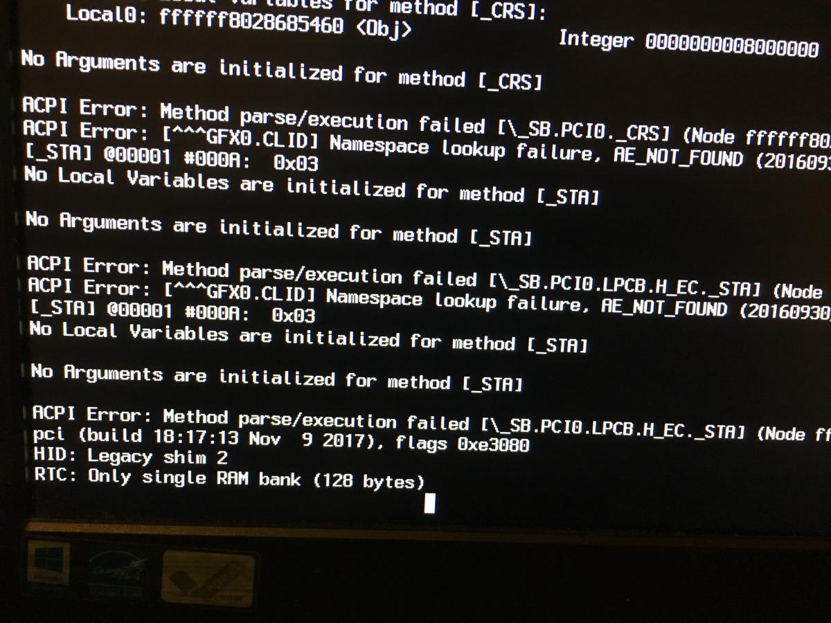

41089 Posted January 5, 2018 Share Posted January 5, 2018 second slot have same speed? or only first work a full speed? if work full speed, n problem u can use same DSDT for all, just change hardware Ive benchmarked the GPU and it runs on full speed so I'll keep it as is hmmmmmm. so the new clover folder gives me this IGPU error and then proceeds to a blank screen flashing those 2 lines every 5 seconds or so. Do I need to inject intel in clover to fix this? 1 Link to comment Share on other sites More sharing options...
MaLd0n Posted January 5, 2018 Author Share Posted January 5, 2018 Ive benchmarked the GPU and it runs on full speed so I'll keep it as is hmmmmmm. so the new clover folder gives me this IGPU error and then proceeds to a blank screen flashing those 2 lines every 5 seconds or so. Do I need to inject intel in clover to fix this? ye, inject intel, check here config.plist.zip in bios u have option to disable intelHD? Link to comment Share on other sites More sharing options...
