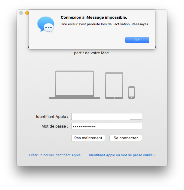

AkimoA Posted April 22, 2017 Share Posted April 22, 2017 Congratulations Dimitri , once again ! @gils the only thing bothering me since u at it , i was reading that on fx processors icloud/appstore works with no problems. did u generate MLB/ROM and try to login to iMessage ? ( or in Chameleon use meklorts FileNVRAM.kext in S/L/E and FileNVRAM.dylib in modules folder ) just out of curiosity . Link to comment https://www.insanelymac.com/forum/topic/321626-ryzen-macos-1012x-sierra-kernel-researchdevelopment-thread/page/7/#findComment-2409456 Share on other sites More sharing options...
Shaneee Posted April 22, 2017 Share Posted April 22, 2017 Bronya can you send my the El Cap source in a PM please? This kernel still boots my FX 4300 but still has the glitches. I wish to try fix this. Offtopic: AkimoA iCloud also worked OOB my my old Athlon. It is possible to get iMessage working but rather than the old FileNVMRAM files the latest Enoch includes a new module updated my Micky. 2 Link to comment https://www.insanelymac.com/forum/topic/321626-ryzen-macos-1012x-sierra-kernel-researchdevelopment-thread/page/7/#findComment-2409473 Share on other sites More sharing options...
gils83 Posted April 22, 2017 Share Posted April 22, 2017 Congratulations Dimitri , once again ! @gils the only thing bothering me since u at it , i was reading that on fx processors icloud/appstore works with no problems. did u generate MLB/ROM and try to login to iMessage ? ( or in Chameleon use meklorts FileNVRAM.kext in S/L/E and FileNVRAM.dylib in modules folder ) just out of curiosity . hello, iCloud works but no iMessage Bronya can you send my the El Cap source in a PM please? This kernel still boots my FX 4300 but still has the glitches. I wish to try fix this. Offtopic: AkimoA iCloud also worked OOB my my old Athlon. It is possible to get iMessage working but rather than the old FileNVMRAM files the latest Enoch includes a new module updated my Micky. link ? 2 Link to comment https://www.insanelymac.com/forum/topic/321626-ryzen-macos-1012x-sierra-kernel-researchdevelopment-thread/page/7/#findComment-2409762 Share on other sites More sharing options...
dj_sash Posted April 22, 2017 Share Posted April 22, 2017 Man tu es trop bon… You are too good I guess the calculation of launching a new RYZEN for working is coming hello, iCloud works but no iMessage link ? 1 Link to comment https://www.insanelymac.com/forum/topic/321626-ryzen-macos-1012x-sierra-kernel-researchdevelopment-thread/page/7/#findComment-2409966 Share on other sites More sharing options...

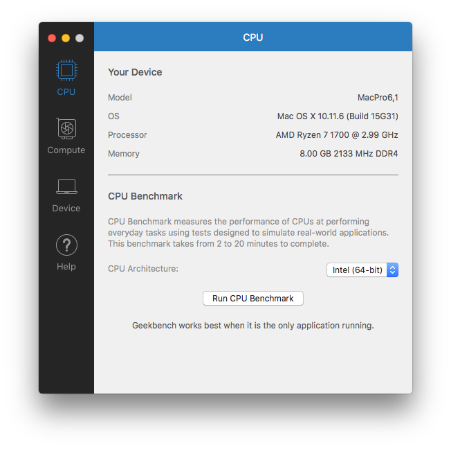

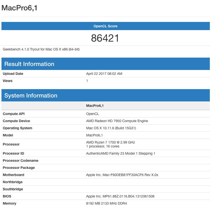

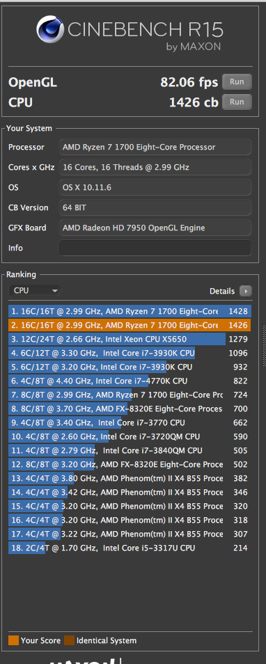

pandaDS3 Posted April 23, 2017 Share Posted April 23, 2017 no problem video why do you have 16 cores?? there are 8 cores on ryzen Link to comment https://www.insanelymac.com/forum/topic/321626-ryzen-macos-1012x-sierra-kernel-researchdevelopment-thread/page/7/#findComment-2410158 Share on other sites More sharing options...
gils83 Posted April 23, 2017 Share Posted April 23, 2017 OS X ne connait pas les cores SMT d'où 16c/16t en réalité, c'est bien 8c/16t OS X does not know the cores SMT where 16c / 16t is actually 8c / 16t Link to comment https://www.insanelymac.com/forum/topic/321626-ryzen-macos-1012x-sierra-kernel-researchdevelopment-thread/page/7/#findComment-2410179 Share on other sites More sharing options...

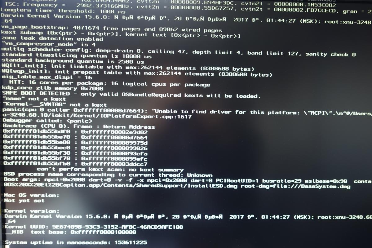

tete001 Posted April 23, 2017 Share Posted April 23, 2017 hi.. ryzen users ryzen 1800X, ga-ab350m-hd3 i tried maything Use "test2 boot" and 10.11.6 patch kernel(bronya) no module folder, and only nullcpupm.kext and fakesmc.kext (always flags) -v usekernelcache=no (test flags) cpus= 1or 8 , busratio=29 ,30,36 , DropSSDT=Yes Or no my problem can not see kernel log screen. because roll kexts loding message and monitor blackout and after 5 sec computer auto reset. this step is into 10.11.6 kernel. is this patch kernel problem? or my M/B problem? anyway this 10.11.6 disk connect other intel system. i can boot (it mean no problem my kernel patch: /system/library/kernels/kernel) anyone tested this kernel on 1800x CPU? i need information . another 1800x users experience. can you see kernel message? or panic message? i want see kernel panic messge.. because panic message means 1800x into kernel or loding kernel thank you read. i waiting another 1800x Users Report 1 Link to comment https://www.insanelymac.com/forum/topic/321626-ryzen-macos-1012x-sierra-kernel-researchdevelopment-thread/page/7/#findComment-2410488 Share on other sites More sharing options...
gils83 Posted April 23, 2017 Share Posted April 23, 2017 hi.. ryzen users ryzen 1800X, ga-ab350m-hd3 i tried maything Use "test2 boot" and 10.11.6 patch kernel(bronya) no module folder, and only nullcpupm.kext and fakesmc.kext (always flags) -v usekernelcache=no (test flags) cpus= 1or 8 , busratio=29 ,30,36 , DropSSDT=Yes Or no my problem can not see kernel log screen. because roll kexts loding message and monitor blackout and after 5 sec computer auto reset. this step is into 10.11.6 kernel. this patch kernel problem? or my M/B problem? anyway this 10.11.6 disk connect other intel system. i can boot (it mean no problem my kernel patch: /system/library/kernels/kernel) anyone tested this kernel on 1800x CPU? i need information . another 1800x users experience. can you see kernel message? or panic message? i want see kernel panic messge.. because panic message means 1800x into kernel or loding kernel thank you read. i waiting another 1800x Users Report 1800x=1700 post screen or video smartphone 1 Link to comment https://www.insanelymac.com/forum/topic/321626-ryzen-macos-1012x-sierra-kernel-researchdevelopment-thread/page/7/#findComment-2410542 Share on other sites More sharing options...
bigfanuser Posted April 23, 2017 Share Posted April 23, 2017 Need some guidance, attempting to install on x370 pro, 1700X. using chameleon r2667with Bronya boot using Bronya El Capitan kernel in /System/Library/Kernels/kernel kernel.plist in Extra/ FakeSMC, NullCPU... kext in Extra/Extensions/ am I missing anything else? Link to comment https://www.insanelymac.com/forum/topic/321626-ryzen-macos-1012x-sierra-kernel-researchdevelopment-thread/page/7/#findComment-2410548 Share on other sites More sharing options...
