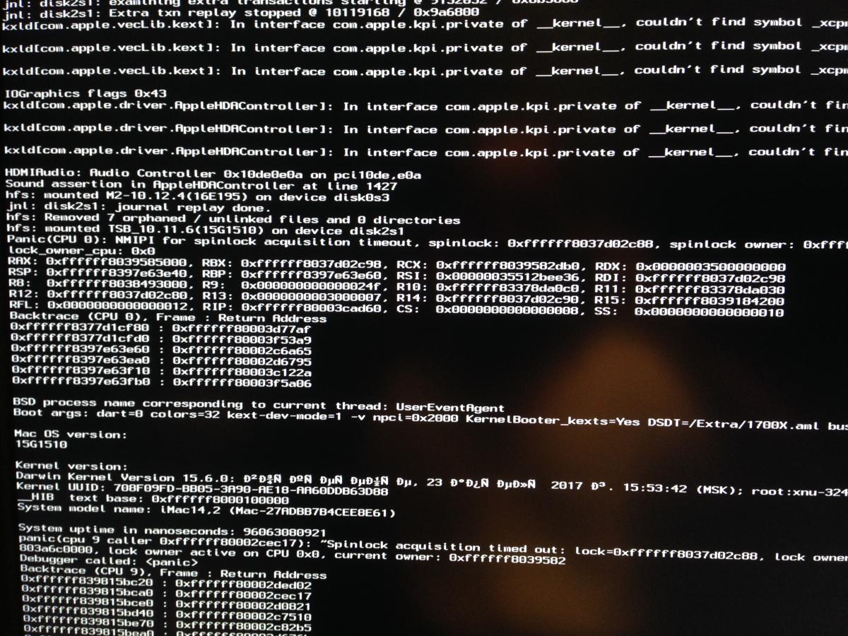

jsl Posted April 27, 2017 Share Posted April 27, 2017 (edited) This kernel no need flag KernelBooter_kets... kernel_rc2_ryzen.zip Thanks for this Ryzen RC2 kernel which can login desktop by Enoch r.2877, but it got KP by Boot RC2 for FX-6300 hackintosh. After repeated re-boot with flag: -f it can login desktop as by Enoch r.2877 for FX-6300 hackintosh at 10.12.4 now. But it took longer time to login the desktop due to "busy timeout (0) (60S): AppleACPICPU........" error during booting. So I expect it can work in Ryzen hackintosh soon later if I get one for testing ! Edited April 28, 2017 by jsl Link to comment https://www.insanelymac.com/forum/topic/321626-ryzen-macos-1012x-sierra-kernel-researchdevelopment-thread/page/12/#findComment-2413464 Share on other sites More sharing options...

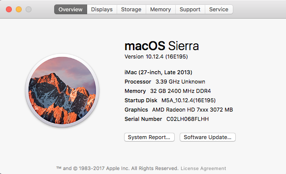

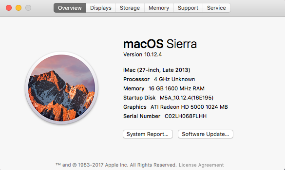

Blackzenza Posted April 29, 2017 Share Posted April 29, 2017 Sierra SUCCESSS! thanks @Bronya and all the community support! everything works smoothly except for TRIM ENABLE for my SDD. Not so bad anyway 4 Link to comment https://www.insanelymac.com/forum/topic/321626-ryzen-macos-1012x-sierra-kernel-researchdevelopment-thread/page/12/#findComment-2414232 Share on other sites More sharing options...

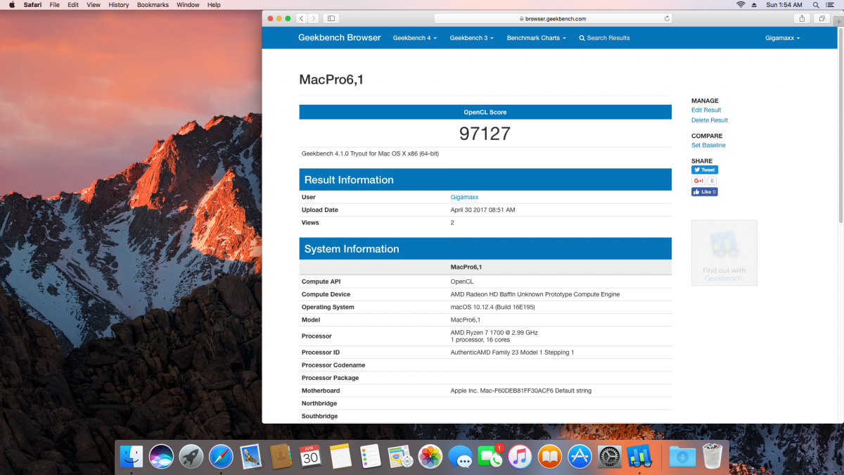

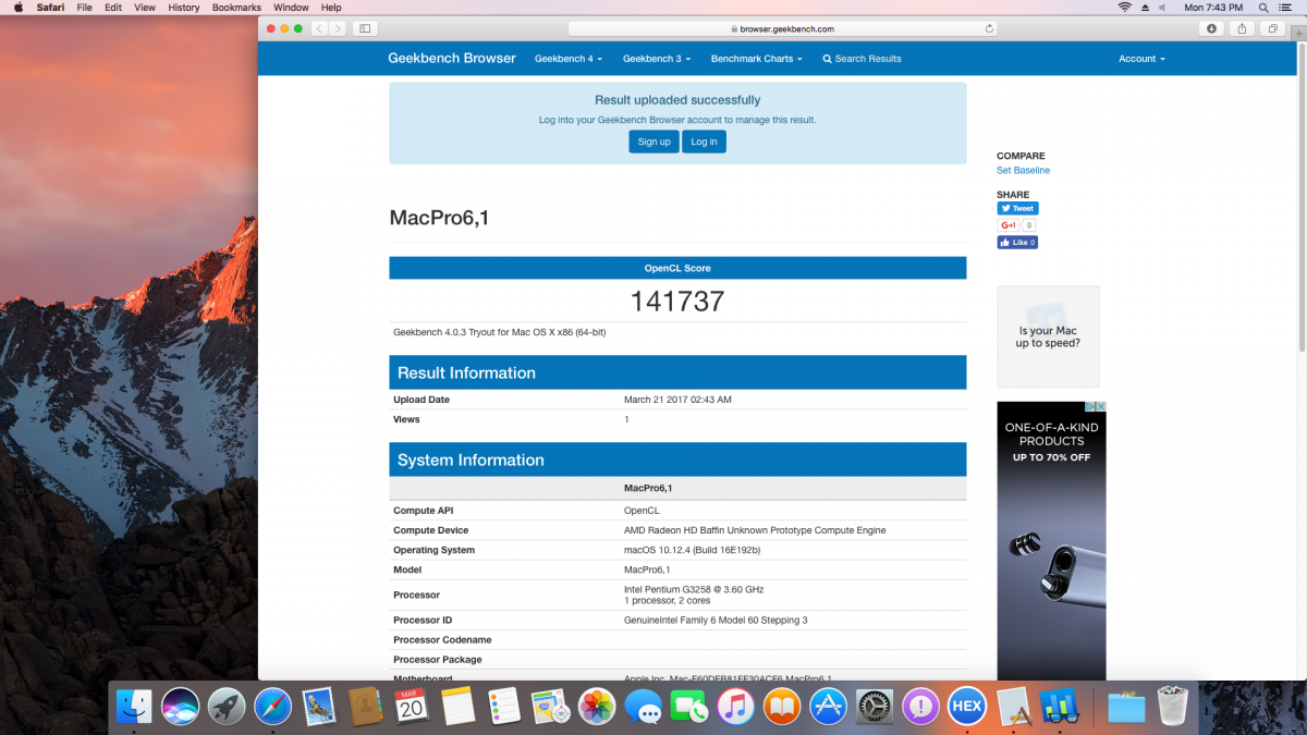

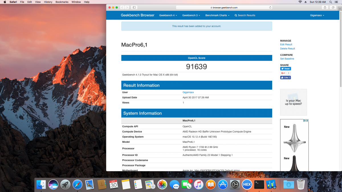

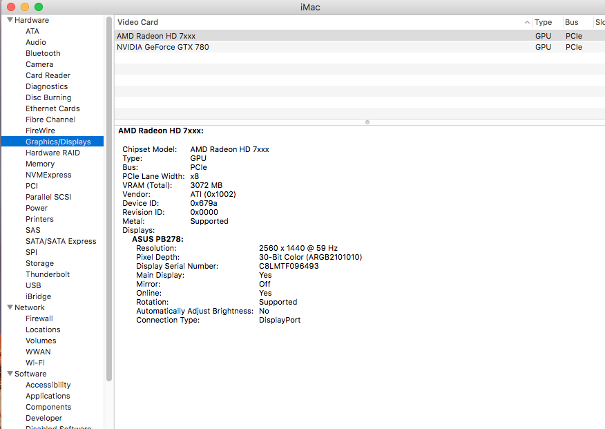

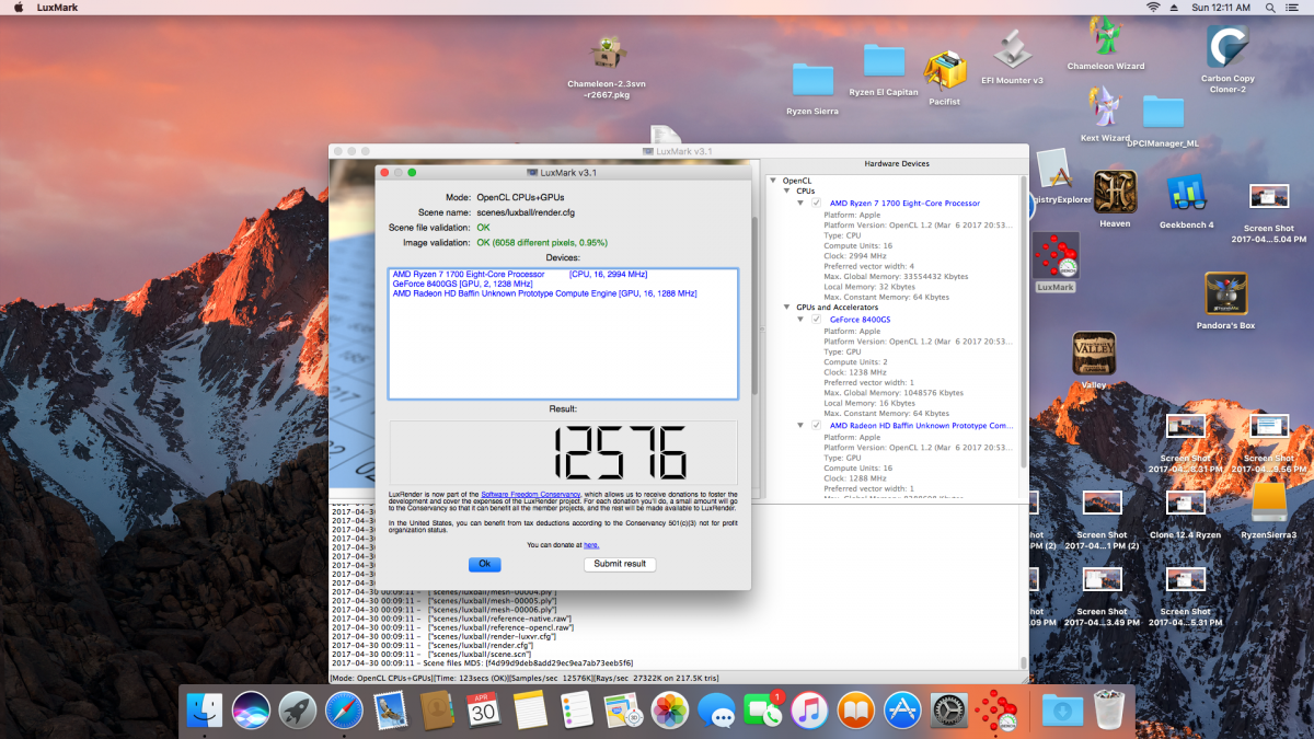

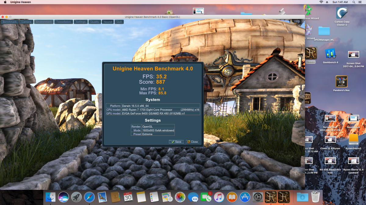

Gigamaxx Posted April 30, 2017 Share Posted April 30, 2017 Good News, RX 480 works on Ryzen Sierra! With helper card on first test. RX 480 CU fix works! Unfortunately the Helper card takes up 8 lanes and cuts down on the performance of RX (8 vs 16) PCI lanes. My Pentium g3258 RX 480 for comparison. I'll try it in number one slot, get ready for the black screen after boot. Thank You Bronya, This is great! Some minor bugs but its a new platform so time will smooth these things out. This is Awesome! 4 Link to comment https://www.insanelymac.com/forum/topic/321626-ryzen-macos-1012x-sierra-kernel-researchdevelopment-thread/page/12/#findComment-2414754 Share on other sites More sharing options...

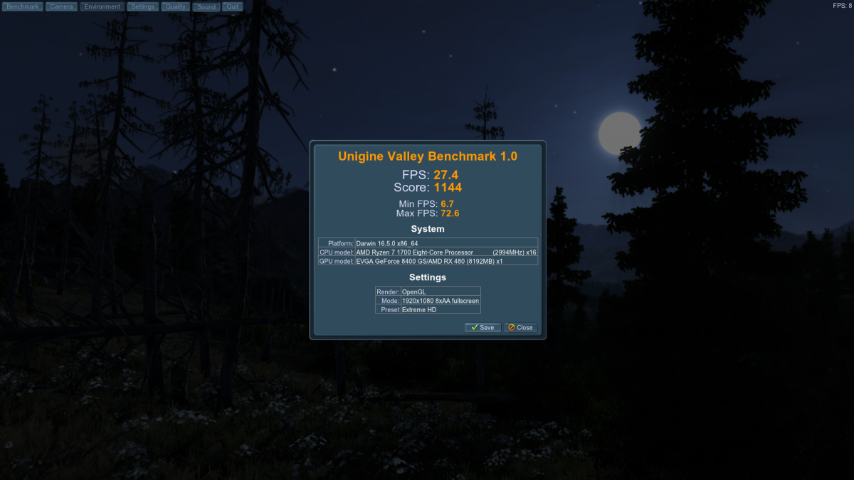

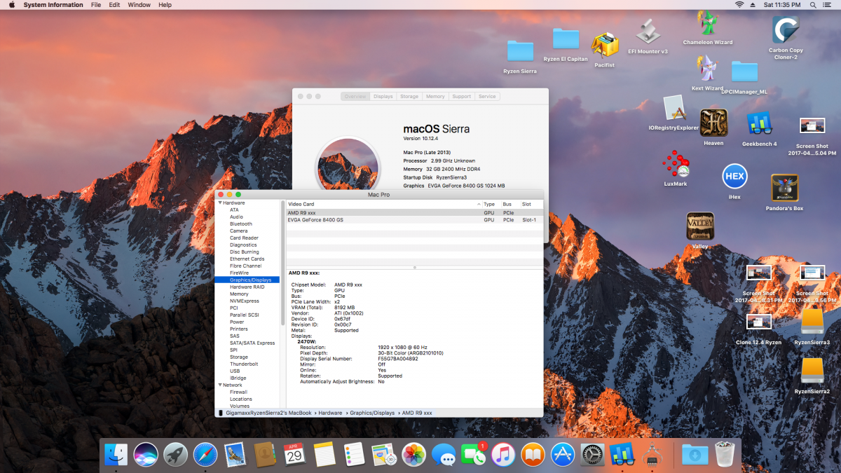

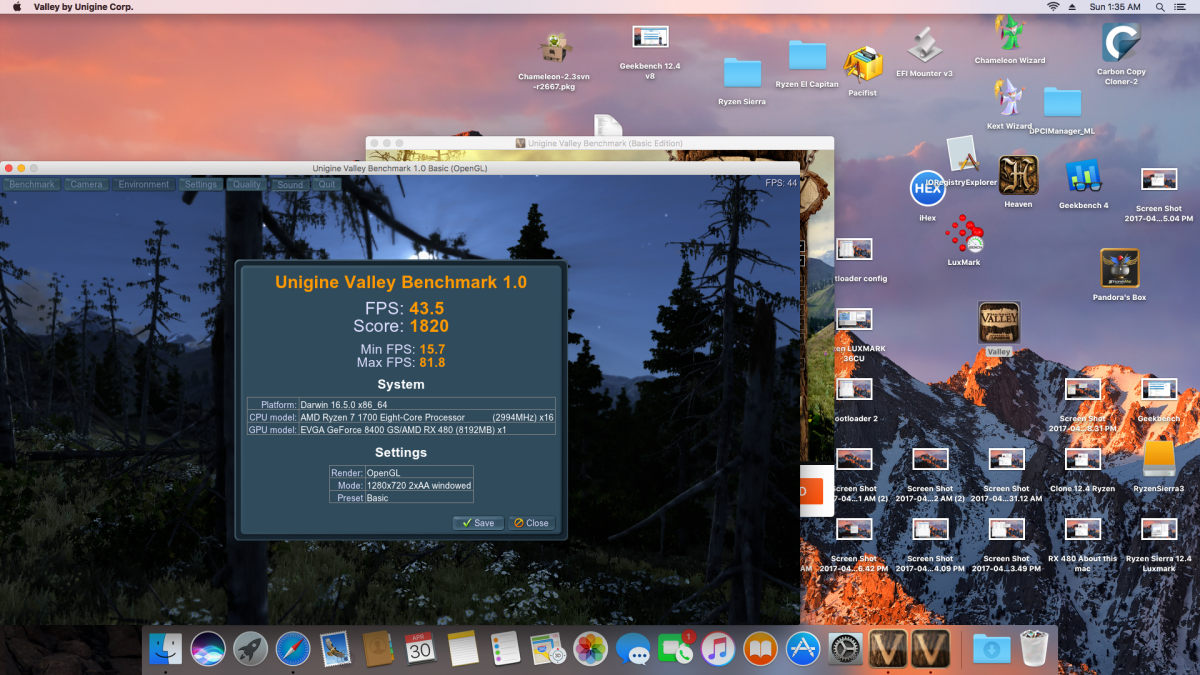

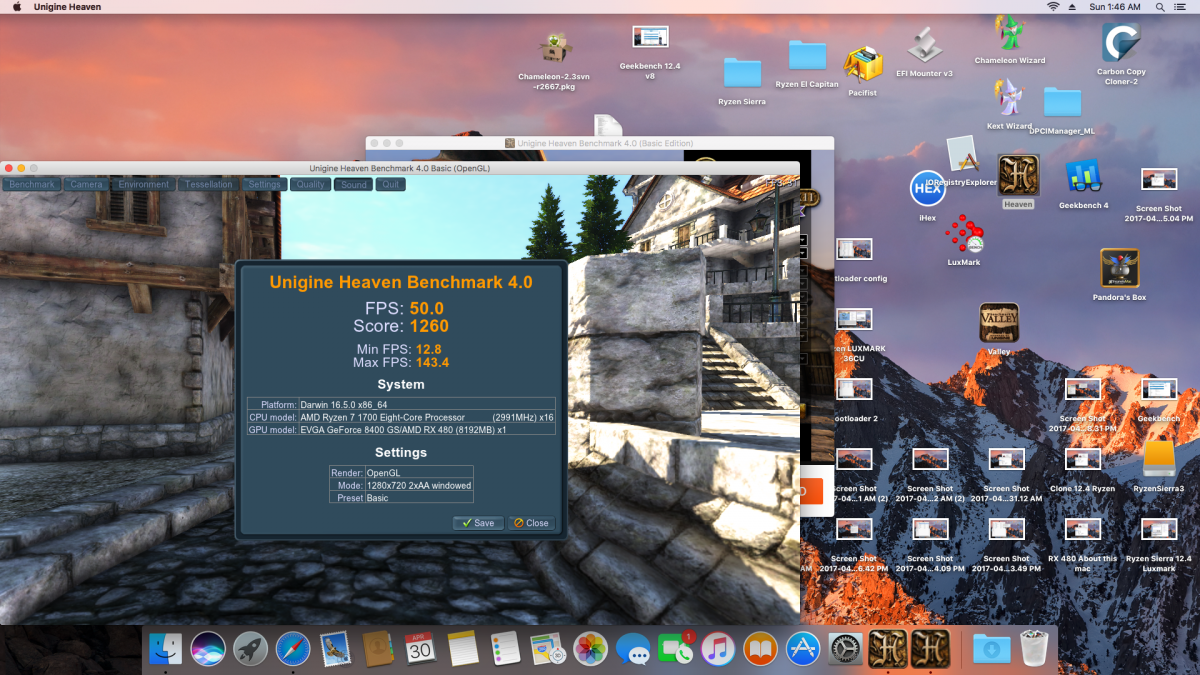

Gigamaxx Posted April 30, 2017 Share Posted April 30, 2017 I was able to get Black screen with RX in Slot0, yeah! I put the Nvidia in slot 1 but it doesn't work. Slot 0 Nvidia 8400gs 1gb, and Slot 1 RX 480 8gb XFX reference model. No crashes in Uningine benchmarks, or Geekbench. Using the VGA port of the Nvidia 8400gs and setting my GUI or screen resolution to 1920x1080 makes the VGA drop out and the RX HDMI take over. VGA has the Landscape screen and RX has the tool bars. 1 Link to comment https://www.insanelymac.com/forum/topic/321626-ryzen-macos-1012x-sierra-kernel-researchdevelopment-thread/page/12/#findComment-2414786 Share on other sites More sharing options...

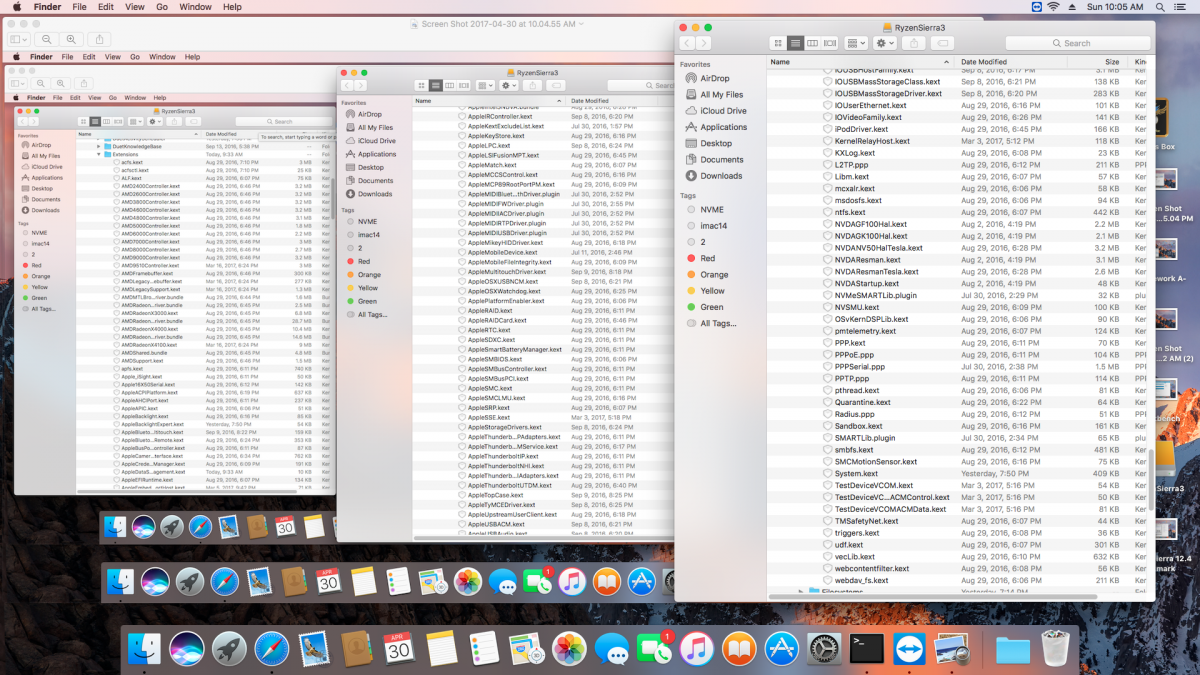

Gigamaxx Posted April 30, 2017 Share Posted April 30, 2017 Here's a screnshot of my extensions folder S/L/E, no Nullcpupower or Fakesmckext? This things running without them placed there, and not too shabby. Link to comment https://www.insanelymac.com/forum/topic/321626-ryzen-macos-1012x-sierra-kernel-researchdevelopment-thread/page/12/#findComment-2415009 Share on other sites More sharing options...
Shaneee Posted April 30, 2017 Share Posted April 30, 2017 NullCPU isn't needed normally as AppleIntelCPUPowerManagement is blacklisted in the kernel. And depending on Bronya's source the kernel has a built in decryptor which is why it's working without FakeSMC 4 Link to comment https://www.insanelymac.com/forum/topic/321626-ryzen-macos-1012x-sierra-kernel-researchdevelopment-thread/page/12/#findComment-2415029 Share on other sites More sharing options...
spakk Posted April 30, 2017 Share Posted April 30, 2017 Here's a screnshot of my extensions folder S/L/E, no Nullcpupower or Fakesmckext? This things running without them placed there, and not too shabby. look in your E/E folder, there you will find the FakeSMC and Nullpower etc. 1 Link to comment https://www.insanelymac.com/forum/topic/321626-ryzen-macos-1012x-sierra-kernel-researchdevelopment-thread/page/12/#findComment-2415044 Share on other sites More sharing options...
Gigamaxx Posted April 30, 2017 Share Posted April 30, 2017 look in your E/E folder, there you will find the FakeSMC and Nullpower etc. Yes, are they loading from the extra folder? Is the Voodoo 8 core loading as well? The boot as I mentioned has a lot going on or in and takes close to 2 minutes. Here's my IORegistry I don't see FakeSMCclient or NullCPUPower kexts? Link to comment https://www.insanelymac.com/forum/topic/321626-ryzen-macos-1012x-sierra-kernel-researchdevelopment-thread/page/12/#findComment-2415051 Share on other sites More sharing options...
AkimoA Posted May 1, 2017 Share Posted May 1, 2017 on top , even if u try an older kernel before the decrypter found its way inside. the latest Enoch 2877 has the FakeSMC /decrypted binaries also included and the embedded Kernel patcher (kernelbooter_kexts) from Enoch allows u using /Extra/Extensions Folder from Chameleon again so a valid prelinkedkernel (pseudo kextcache ) isnt necessary to begin with. aslong u boot with UseKernelCache=No.. ( nothing new but just to mentioned it again since so many newbies will pop up now ). i was reading as well for the sierra kernel, bronya embedded this feature (kernelbooter_kexts) inside , needs testing and proper documentation somewhere before it gets lost . fyi for tests : the boot flag to skip the enoch embedded kernelpatcher SkipKP=Yes ( not sure though if this affects bronyas patch as well thats why it needs testing ) 2 Link to comment https://www.insanelymac.com/forum/topic/321626-ryzen-macos-1012x-sierra-kernel-researchdevelopment-thread/page/12/#findComment-2415299 Share on other sites More sharing options...
