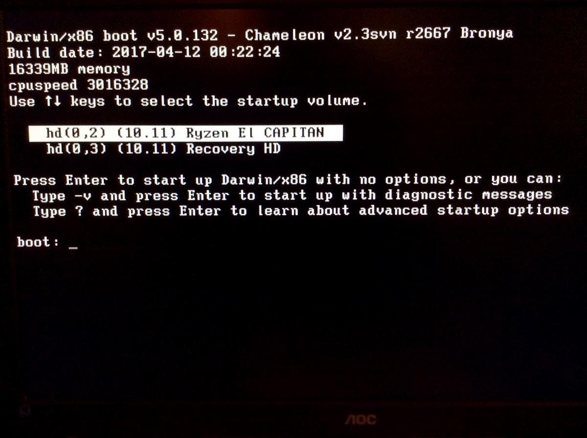

gils83 Posted April 23, 2017 Share Posted April 23, 2017 Need some guidance, attempting to install on x370 pro, 1700X. using chameleon r2667with Bronya boot using Bronya El Capitan kernel in /System/Library/Kernels/kernel kernel.plist in Extra/ FakeSMC, NullCPU... kext in Extra/Extensions/ am I missing anything else? good ! bonne direction boot flag: busratio=34 -v -f -s PCIRootUID=1 msibase=0x90 wth -s consol 3.2 : fsck -fy (reset bibliothèque) and exit after edit: deleted: IOBluetoothFamily.kext IOBluetoothHIDDriver.kext reedit: for test activate iommu in the bios au pire, installer Paragon HSF for windows and teemvierwer, je pourrai jeter un oeil sur votre arborescence Link to comment https://www.insanelymac.com/forum/topic/321626-ryzen-macos-1012x-sierra-kernel-researchdevelopment-thread/page/8/#findComment-2410563 Share on other sites More sharing options...

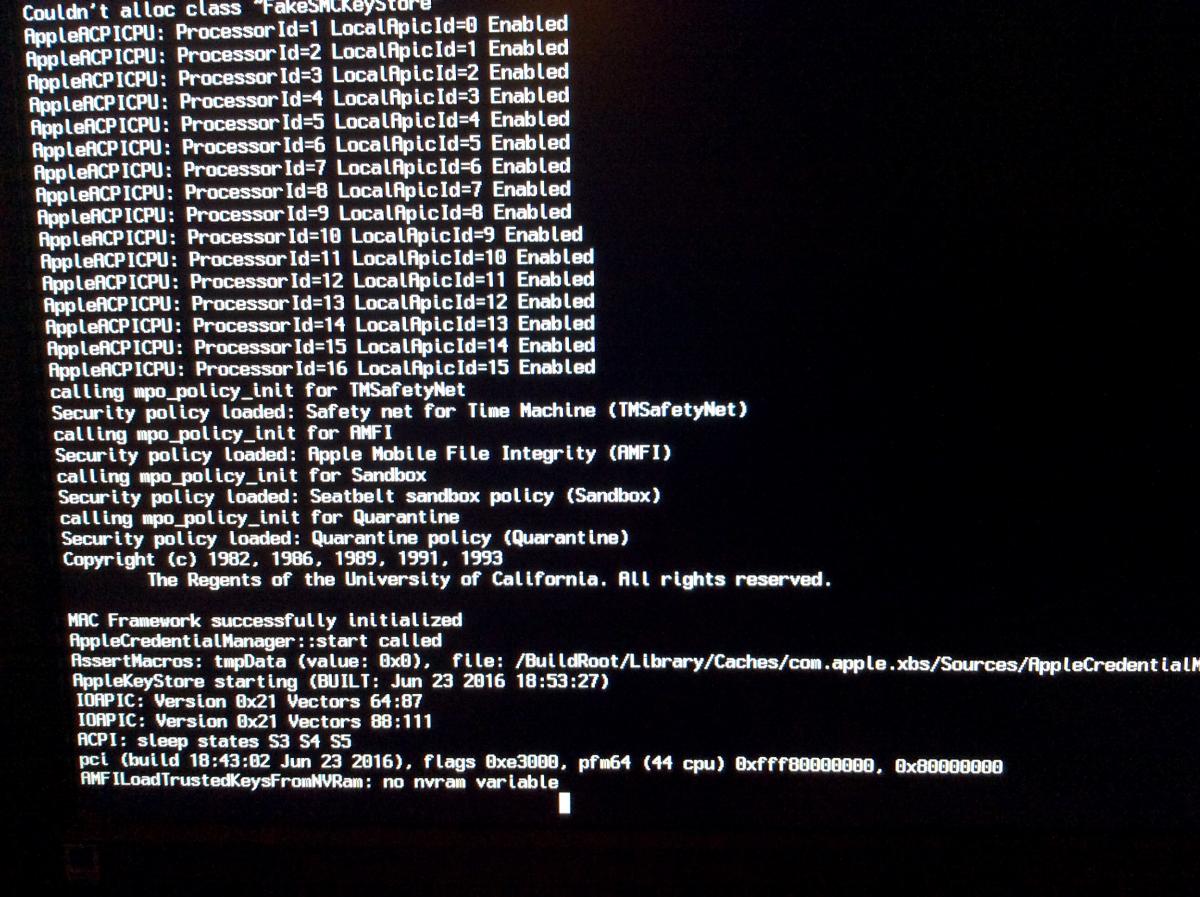

Gigamaxx Posted April 23, 2017 Share Posted April 23, 2017 New El Capitan and new bootloader Enoch three new errors. Link to comment https://www.insanelymac.com/forum/topic/321626-ryzen-macos-1012x-sierra-kernel-researchdevelopment-thread/page/8/#findComment-2410574 Share on other sites More sharing options...

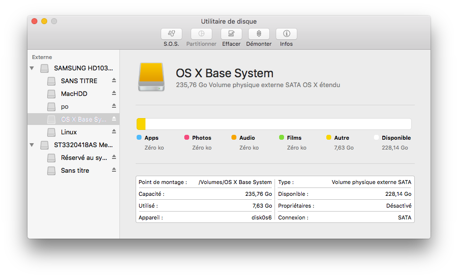

gils83 Posted April 23, 2017 Share Posted April 23, 2017 create partition HDD installer, via USB = no works 1 Link to comment https://www.insanelymac.com/forum/topic/321626-ryzen-macos-1012x-sierra-kernel-researchdevelopment-thread/page/8/#findComment-2410580 Share on other sites More sharing options...

Bronya Posted April 23, 2017 Share Posted April 23, 2017 Need some guidance, attempting to install on x370 pro, 1700X. using chameleon r2667with Bronya boot using Bronya El Capitan kernel in /System/Library/Kernels/kernel kernel.plist in Extra/ FakeSMC, NullCPU... kext in Extra/Extensions/ am I missing anything else? Hi ! You should add folder "Extensions" in folder /System/Library ! 2 Link to comment https://www.insanelymac.com/forum/topic/321626-ryzen-macos-1012x-sierra-kernel-researchdevelopment-thread/page/8/#findComment-2410679 Share on other sites More sharing options...

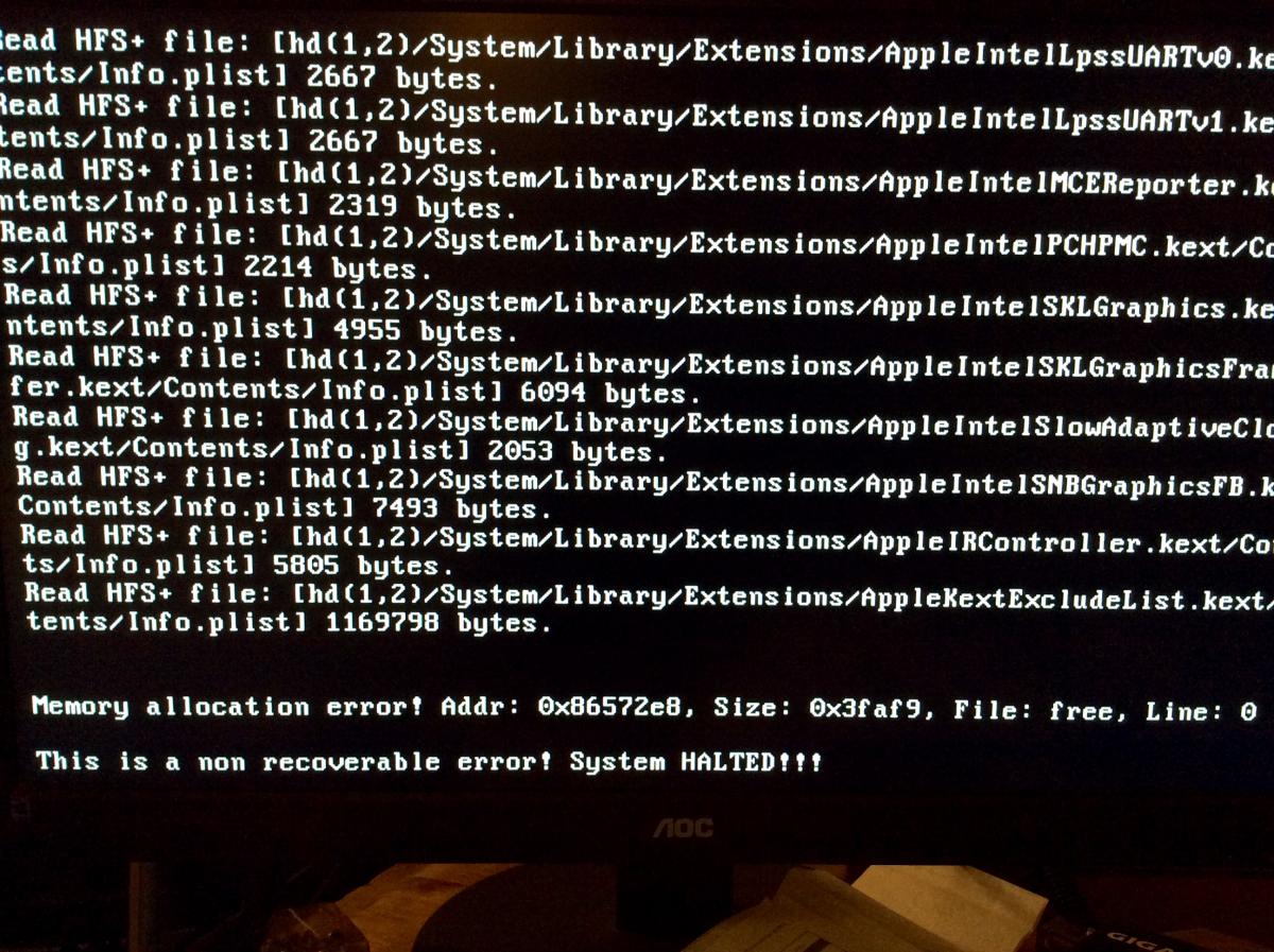

Gigamaxx Posted April 23, 2017 Share Posted April 23, 2017 Bootloader on Ssd but same memory allocation error. 1 Link to comment https://www.insanelymac.com/forum/topic/321626-ryzen-macos-1012x-sierra-kernel-researchdevelopment-thread/page/8/#findComment-2410680 Share on other sites More sharing options...

bigfanuser Posted April 23, 2017 Share Posted April 23, 2017 Hi ! You should add folder "Extensions" in folder /System/Library ! I added Extensions, now /System/Library/Extensions which only contains FakeSMC and NullCPUPowerManagement kext. Still getting same error. Link to comment https://www.insanelymac.com/forum/topic/321626-ryzen-macos-1012x-sierra-kernel-researchdevelopment-thread/page/8/#findComment-2410694 Share on other sites More sharing options...
Bronya Posted April 23, 2017 Share Posted April 23, 2017 I added Extensions, now /System/Library/Extensions which only contains FakeSMC and NullCPUPowerManagement kext. Still getting same error. No ! You should add full Extensions ! Link to comment https://www.insanelymac.com/forum/topic/321626-ryzen-macos-1012x-sierra-kernel-researchdevelopment-thread/page/8/#findComment-2410700 Share on other sites More sharing options...
bigfanuser Posted April 23, 2017 Share Posted April 23, 2017 No ! You should add full Extensions ! Sorry for stupid question, what do you mean by "full" extensions? I currently have: /System/Library/Extensions/FakeSMC.kext /System/Library/Extensions/NullCPUPowerManagement.kext Link to comment https://www.insanelymac.com/forum/topic/321626-ryzen-macos-1012x-sierra-kernel-researchdevelopment-thread/page/8/#findComment-2410719 Share on other sites More sharing options...
Bronya Posted April 23, 2017 Share Posted April 23, 2017 Sorry for stupid question, what do you mean by "full" extensions? I currently have: /System/Library/Extensions/FakeSMC.kext /System/Library/Extensions/NullCPUPowerManagement.kext "Full" - it is all kexts in Extensions ! 1 Link to comment https://www.insanelymac.com/forum/topic/321626-ryzen-macos-1012x-sierra-kernel-researchdevelopment-thread/page/8/#findComment-2410727 Share on other sites More sharing options...

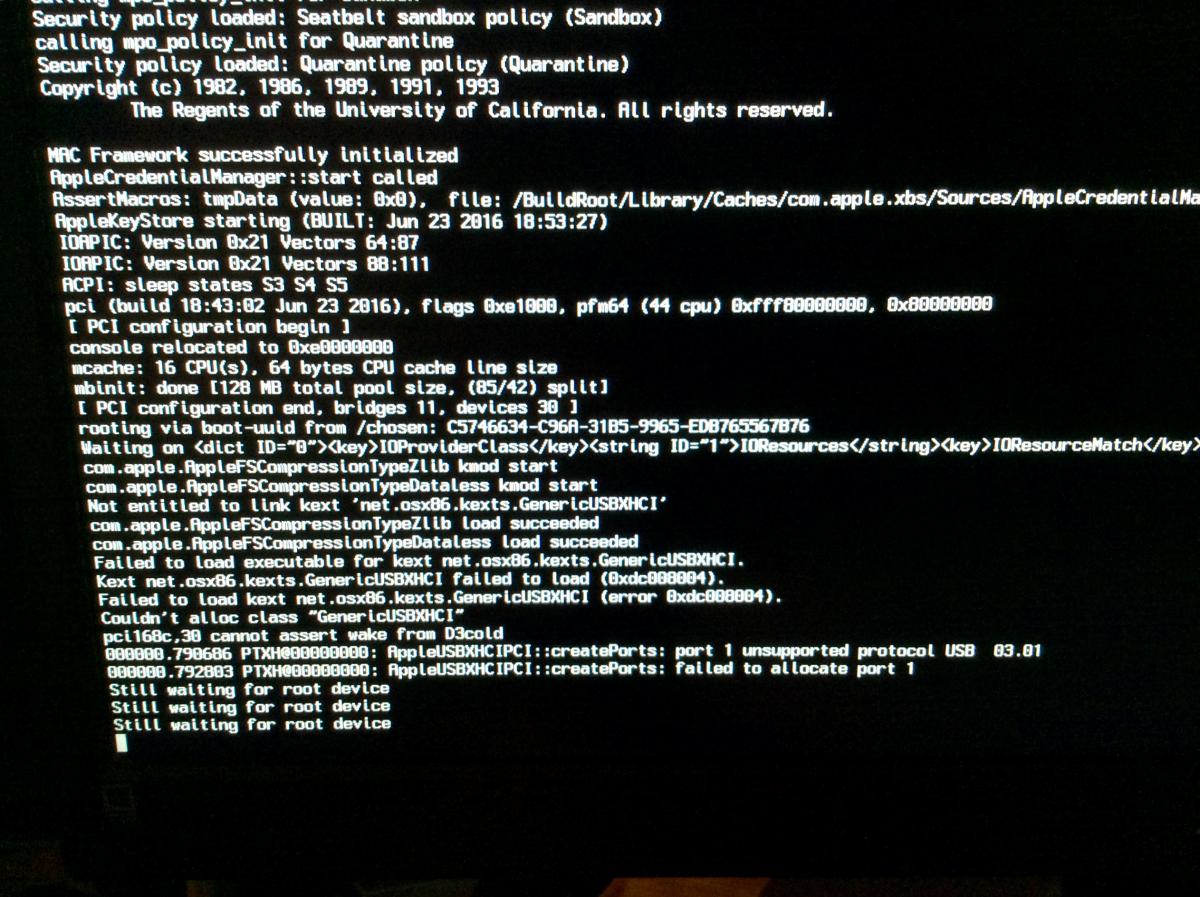

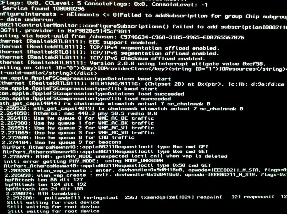

Gigamaxx Posted April 24, 2017 Share Posted April 24, 2017 Still Waiting for Root Device? I made it to WiFi, but the root device error keeps showing up. Any thoughts. Link to comment https://www.insanelymac.com/forum/topic/321626-ryzen-macos-1012x-sierra-kernel-researchdevelopment-thread/page/8/#findComment-2410874 Share on other sites More sharing options...
Bronya Posted April 24, 2017 Share Posted April 24, 2017 Still Waiting for Root Device? I made it to WiFi, but the root device error keeps showing up. Any thoughts.Hi ! You should install driver for hard disk .Or you can change in BIOS ide to ahci . 1 Link to comment https://www.insanelymac.com/forum/topic/321626-ryzen-macos-1012x-sierra-kernel-researchdevelopment-thread/page/8/#findComment-2410896 Share on other sites More sharing options...
Gigamaxx Posted April 24, 2017 Share Posted April 24, 2017 Hi ! You should install driver for hard disk . Or you can change in BIOS ide to ahci[quote Thank you, I was reading it could be USB related. I was using a USB/sata converter and. Ow I'm connected to sata and it's working better, no more error message. I got past that, now I'm stuck on Bluetooth or after loading it. It's real close to booting. I changed out my graphics card for a Nvidia gt710 that was the initial problem. I booted into recovery and noticed the ATI was listed as unsupported. I edited info.plist of 7000controller and 4000kext but still had issues. As soon as I put the Nvidia card in and used Nvidia_disable it started to boot further. GraphicsEnabler=No and I got even further. Not sure if you can watch video it's from an iPad. trim.213040EF-B5CA-44A4-B176-175C2DC7F557.MOV Link to comment https://www.insanelymac.com/forum/topic/321626-ryzen-macos-1012x-sierra-kernel-researchdevelopment-thread/page/8/#findComment-2410964 Share on other sites More sharing options...

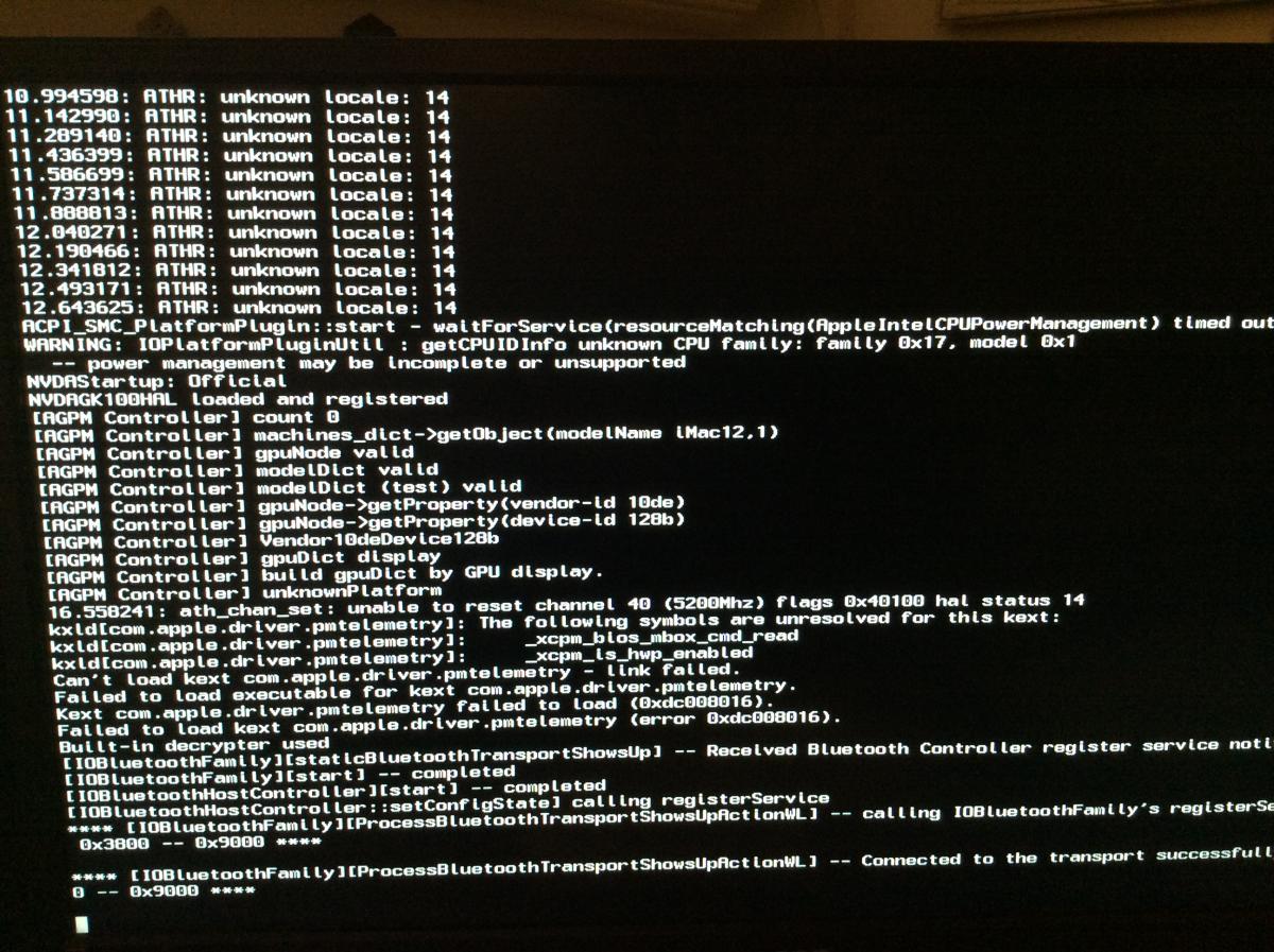

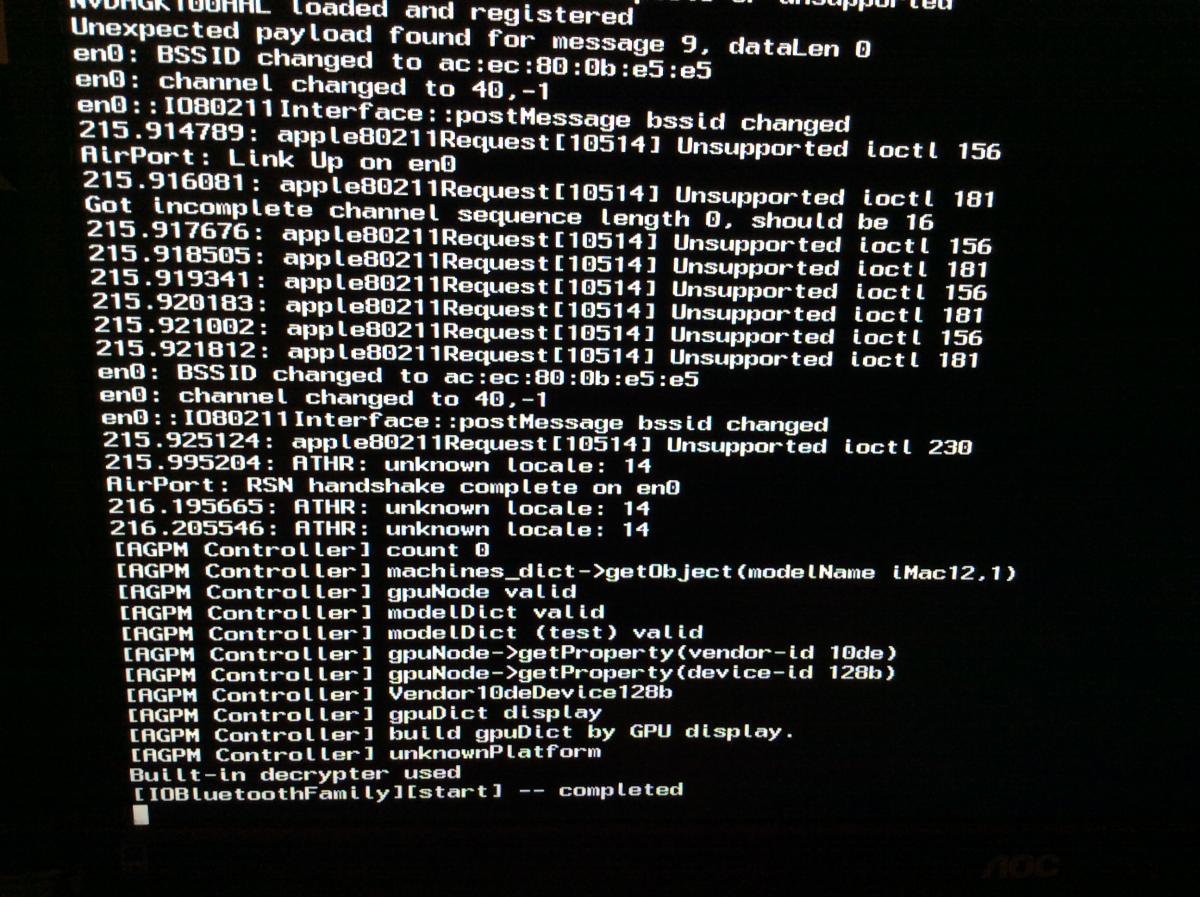

Gigamaxx Posted April 24, 2017 Share Posted April 24, 2017 use PCIRootUID=1 msibase=0x90 ? what graphic card ? AtiPorts= ?? AtiConfig=?? bla bla bla etc........ I installed Nvidia gt710 and got past the graphics hurdle. Now I'm stuck on Bluetooth. The graphics card ATI is ID 0x68111002, Clover automatically detects it as HD 7xxx without inject ATI, and as R9 270x if use inject ATI. It is not supported in chameleon so I tried editing the info.lists in the appropriate kexts and changed the 0x68101002 to 0x68111002. That still didn't do the trick so I put the Nvidia card in and now I'm making progress in the boot process. The ATI card works fine if using clover never had an issue with it not working oob. I have used PCIRootUID, along with many other combinations. When I use the -s "single user" command it always gets Darwin Kp error. I've tried the flags you provided and they aren't working for me 100%. I find I get further in boot process if I don't use -f -F or -s. I also found that if I use debug0x144 I get a debugger erro, but if I use debug 0x100 (clover style ) it works without panic. Link to comment https://www.insanelymac.com/forum/topic/321626-ryzen-macos-1012x-sierra-kernel-researchdevelopment-thread/page/8/#findComment-2410977 Share on other sites More sharing options...
Shaneee Posted April 24, 2017 Share Posted April 24, 2017 I installed Nvidia gt710 and got past the graphics hurdle. Now I'm stuck on Bluetooth. That'll need nv_disable=1 until web drivers are installed. 1 Link to comment https://www.insanelymac.com/forum/topic/321626-ryzen-macos-1012x-sierra-kernel-researchdevelopment-thread/page/8/#findComment-2410985 Share on other sites More sharing options...

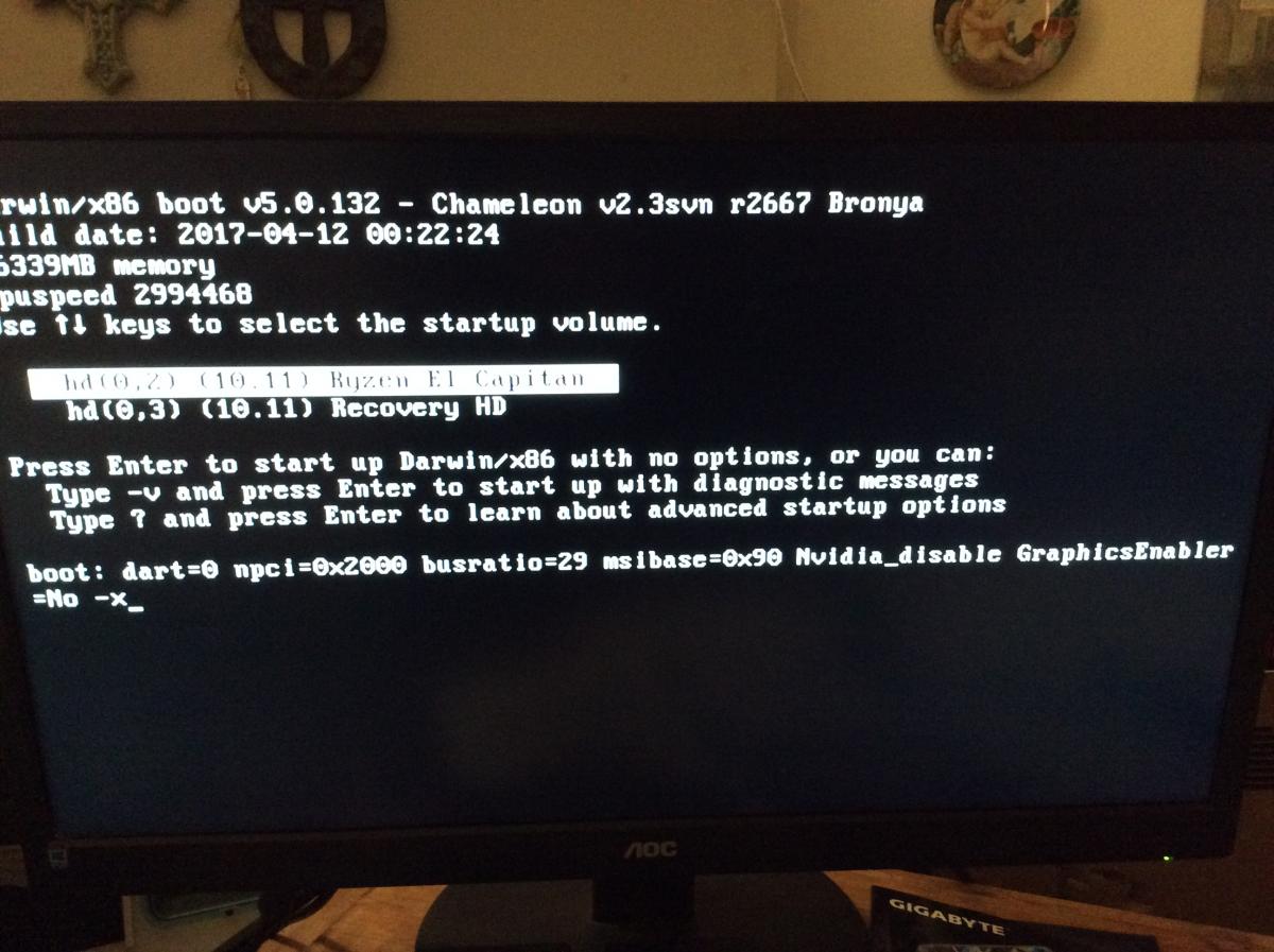

Gigamaxx Posted April 24, 2017 Share Posted April 24, 2017 Thanks, I'm also using GraphicsEnabler=No whichmay be why I got the 720 to load, or at least partial support. Link to comment https://www.insanelymac.com/forum/topic/321626-ryzen-macos-1012x-sierra-kernel-researchdevelopment-thread/page/8/#findComment-2410989 Share on other sites More sharing options...
