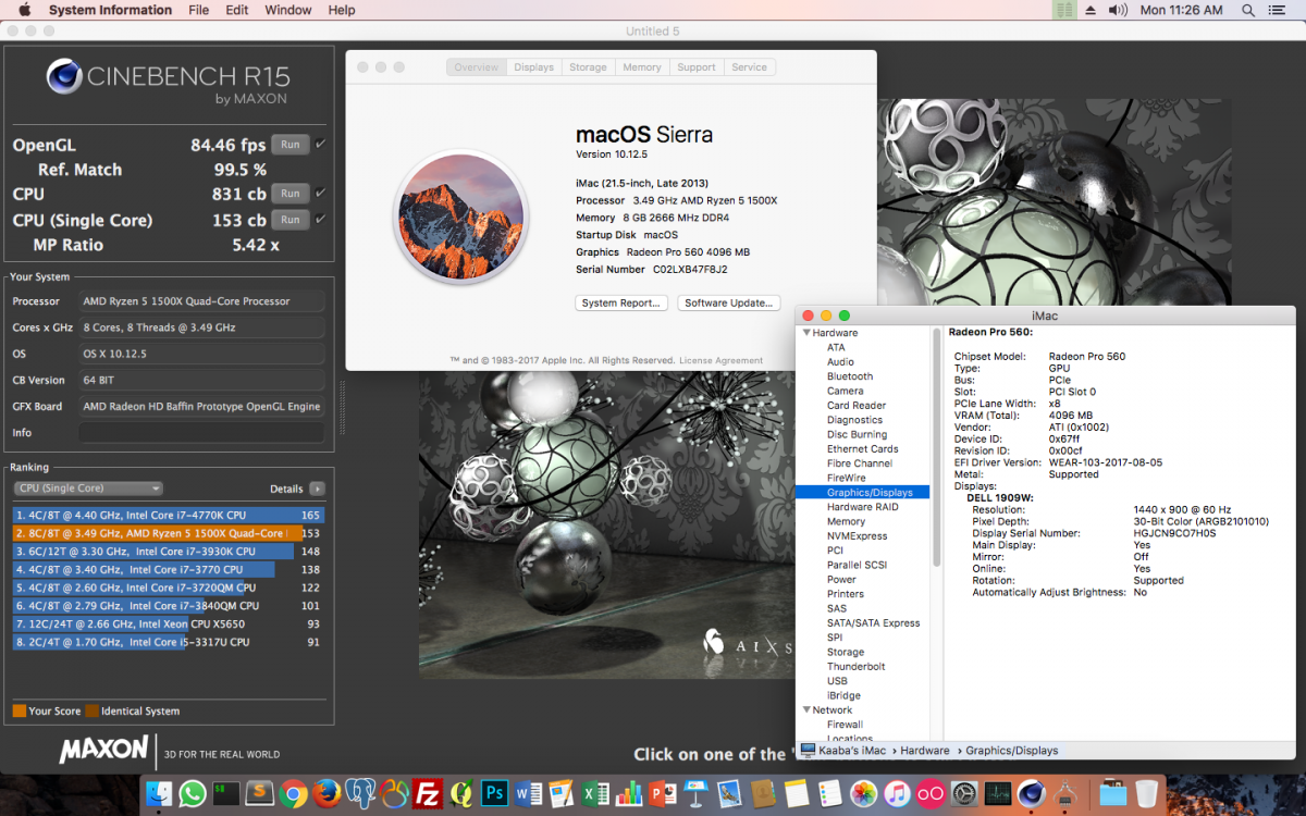

sembrex Posted August 14, 2017 Share Posted August 14, 2017 Hi guys, i have a runing Sierra 10.12.5 with Ryzen 5 1500X and Radeon RX 560. Here i share details about software, hardware and settings i use Hardware:Board : ASRock AB350 Pro4CPU : AMD Ryzen 5 1500X 4C/8T @3.5GHzGPU : Sapphire Radeon RX 560 4GB OCMemory : Corsair LPX Vengeance 2x4GB DDR4 2666MHzDisplay : Dell 1909Wb 1440x900@60HzHDD : WDC Blue 1TB + Seagate Barracuda 1TBStandard USB mouse and keyboard Software:OS Image : SierraAMD v4 (10.12.5)Bootloader : Clover_v2.4k_r4152 Configurations:BIOS : SMT : Enable Super I/O : Disable XMP : Enable Virtualization : Enable Clover : config.plist Kexts: Lilu.kext -> EFI/CLOVER/kexts/Other WhateverGreen.kext -> EFI/CLOVER/kexts/Other Modified kext: /S/L/E/AMD9510Controller.kext//Contents/Info.plist from: <key>IOPCIMatch</key> <string>0x67EF1002</string> to: <key>IOPCIMatch</key> <string>0x67FF1002</string> Benchmark: - Cinebench R15 - Geekbench 4 CPU . : https://browser.geekbench.com/v4/cpu/3697268 Compute : https://browser.geekbench.com/v4/compute/1015156 Link to comment https://www.insanelymac.com/forum/topic/321626-ryzen-macos-1012x-sierra-kernel-researchdevelopment-thread/page/27/#findComment-2478758 Share on other sites More sharing options...

crashmymac Posted August 14, 2017 Share Posted August 14, 2017 THE RX 560 BOOTS WITH ACCELERATION! HOLY MOLY! I AM SO HAPPY. GOT TO THIS TO WORK. NOW TO BUILD A SECOND AMD RIG! THANK YOU EVERYONE! ONE LETTER IN A KEXT IOPCI WHO KNEW! Link to comment https://www.insanelymac.com/forum/topic/321626-ryzen-macos-1012x-sierra-kernel-researchdevelopment-thread/page/27/#findComment-2478919 Share on other sites More sharing options...
