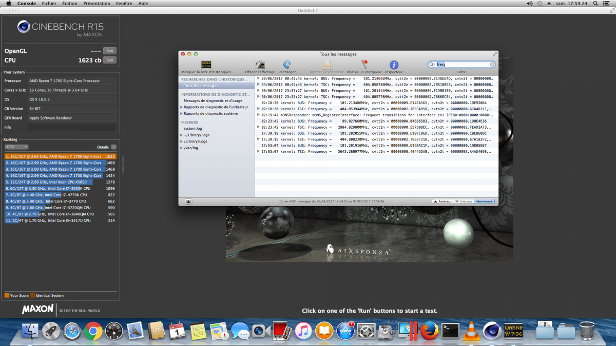

If you don't mind me  asking,What video card are you running? If it's nvidia: whats your FPS on cinebench?
Please check Post #85 and #90 at
http://www.insanelymac.com/forum/topic/324195-nvidia-web-driver-updates-for-macos-high-sierra-update-06052017/page-5
 For Ryzen hackintosh only AMD 7950, 6870, or 5770 are recommended at present.
Currently my Ryzen 1700X hackintosh is using AMD 7950 which performs very well from 10.9.5 to 10.12.6.
Nvidia GTX 980 or GTX-680 performed very poor in my Ryzen 1700X hackintosh as the previous posts shown.

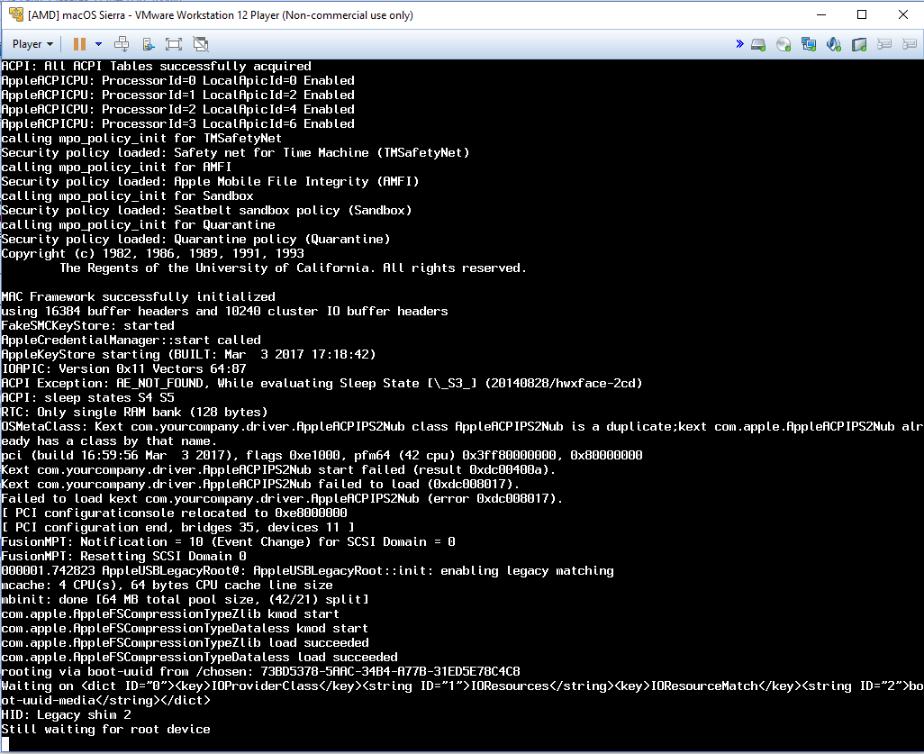

Hi Guys,
Trying to install osx sierra on vmware with my ryzen 1600. Can't get past this section on install process.
Any ideas?
"STILL WAITING FOR ROOT DEVICE" error usually defer to the boot disk being disconnected or unreachable.
If you are installing from an USB, try adding USB kexts to the (I guess) /system/library/extensions folder on your installation disk and repair permissions.
I would make an .ISO of the installation disk and mount it to the virtual machine.
use HDD installer (sata)  ;)

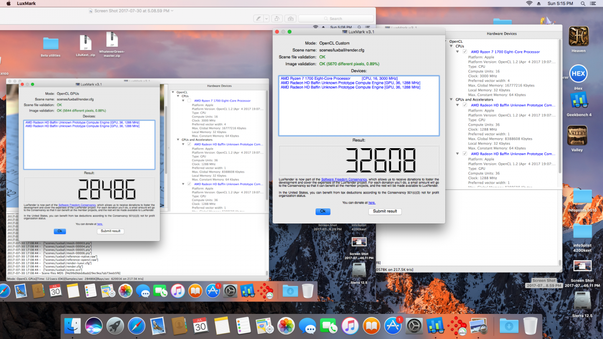

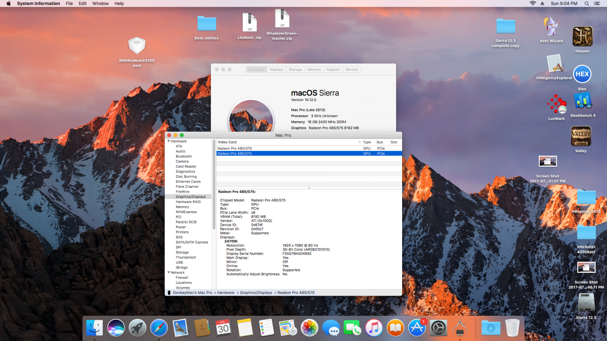

Clover injection does nothing, Inject ATI + FB + Ports.
Do you mean a kext to patch with a Fake ID ?
Yes, a fake ID or an info.plist "find and replace" method. I just edit the info.plists of 9510controller and 4100kext. I also, fixed the CU to 36 from 16.
The best for overall performance are AMD HD7xxx, HD8xxx, R9 270, 280x cards. Older native Nvidia cards work well too GTX780?. In Sierra 12.5 I am able to run my RX 480 alone without helper card using the lilu/Greenkext combo but performance is not optimal in open gl.
Nvidia cards with web drivers are not doing well at all, around 50% or less performance vs Intel systems.
