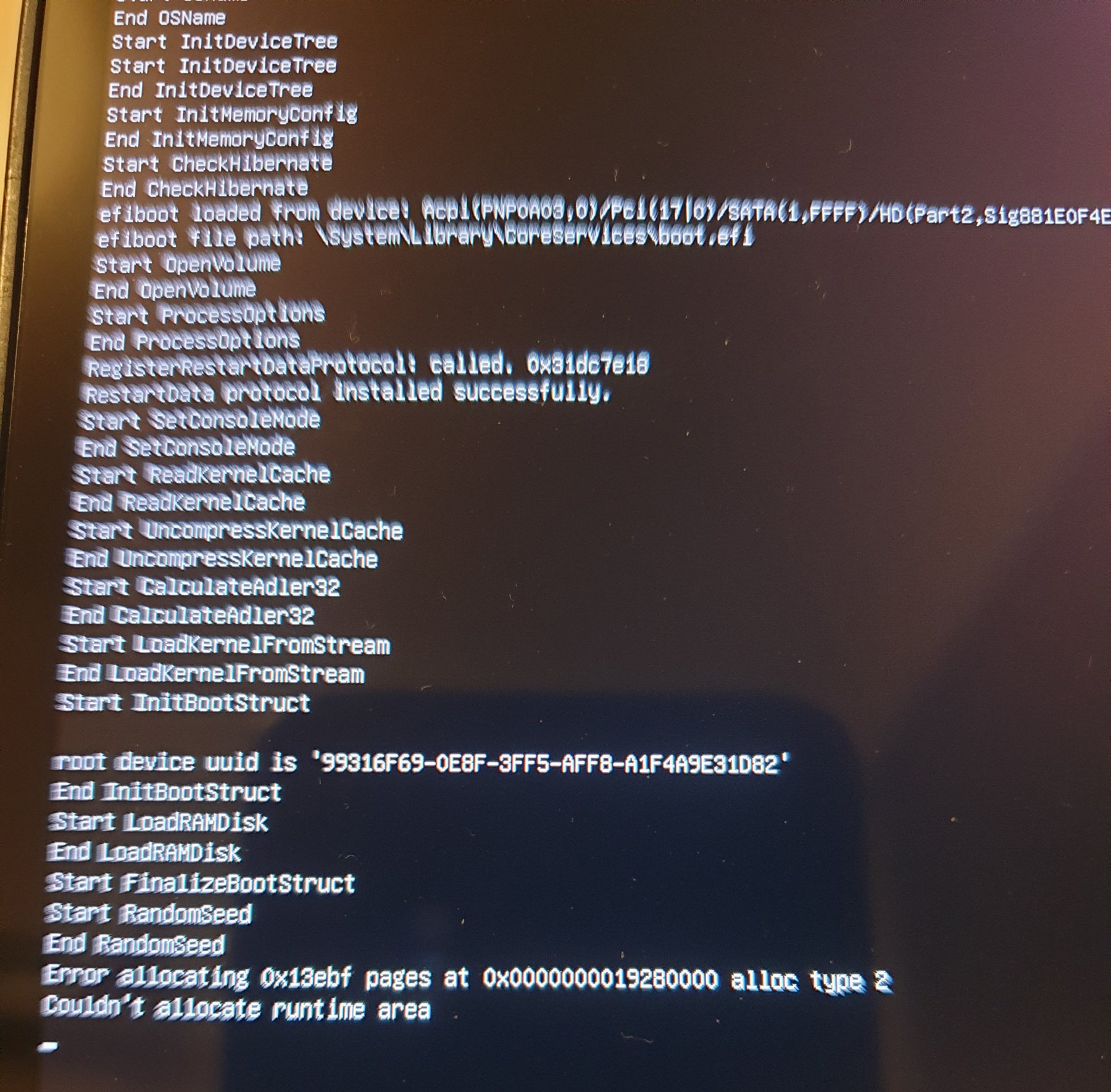

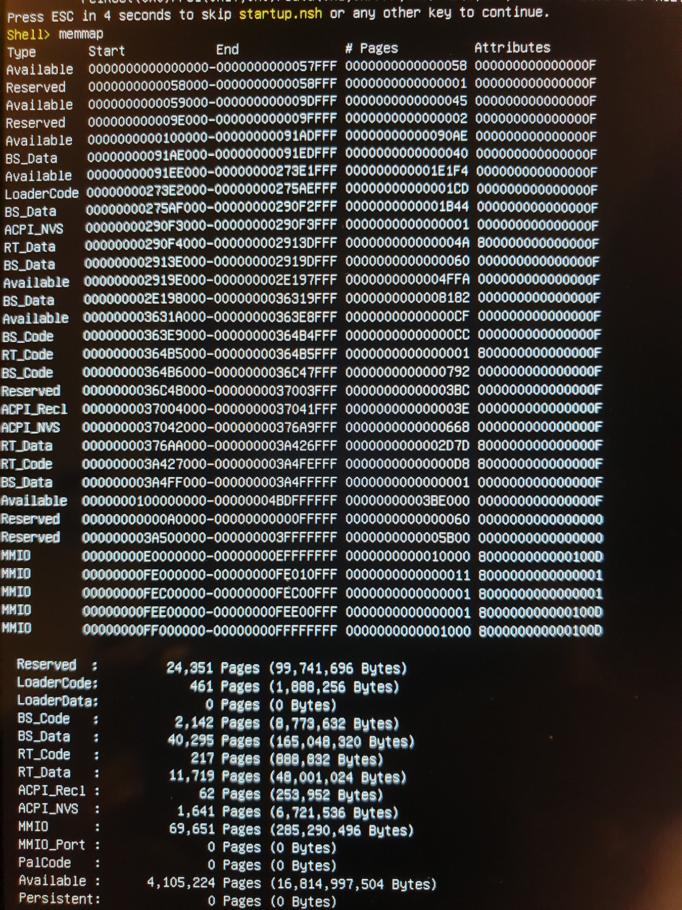

MrJD Posted April 23, 2019 Share Posted April 23, 2019 (edited) Hello all. First up thank you Chris and everyone for this amazing resource. I've learned a ton about this installation through here and I think I'm pretty close to getting a successful install but I keep hitting the same brick wall. I've performed this 3 times over the last few days, erasing the SSD each time and re-creating the install media too. I created the 10.14 installer USB using my existing Hackintosh. (Does this matter?) I have a three year old DELL XPS 9550, i7 6700HQ, 16GB RAM, with 2.5inch Kingston SSD. Intel HD graphics 530. I updated my BIOS to the latest version supplied in the repository. I have also adjusted all the settings in my BIOS as per the guidelines in the installation doc. I followed the Tutorial_10.14.md on github and managed to get all the way through to the end of step 3. I connected to the internet and everything seemed to be working perfectly - please see attached image of completed install (About this mac page). I created the EFI folder on the system drive and copied across the clover folder from the installer. The problem comes when I attempt to reboot and I get the dreaded runtime area allocation problem. I have attached this error and my memmap output. The error comes from when I try and boot off the internal SSD but at this point I've also try booting off the USB installer again and have the same problem. I then go back to my old Hackintosh and edit the UEFI64 drives on that USB drive with all variables suggested within the readme file (CLOVER/drivers64UEFI/other) concerning this Aptiofix problem. I've also read the various suggestions in the 58 pages of this post and tried the suggestions where others have had success. I feel like there must be something obvious I've missed but I can't see it. So having spent a few days on it I have started asking myself these questions: 1. Do you think the best option would be to reinstall again using a slide value of 73 (I calculated this based on the two screenshot figures) together with the OsxAptioFixDrv2. Is this correct and how would I go about editing the config.plist and copying the driver files to that folder? 2. Do I need to clear my CMOS / Reload custom BIOS settings each time I want this USB stick to boot/make changes as one other person has suggested in this post because I cannot get it to work now. On the past few installations I had to remove the SSD, reformat it in my Hackintosh and then put it back in fresh. 3. Should I try an earlier BIOS or should I try installing High Sierra or earlier? Are any earlier versions more likely to work? I'm currently running Yosemite on my desktop so El Capitan or higher would already be a step up for me! 4. Could it be a problem with my hardware? I've tried using two different SSDs. One is a 256GB Samsung PM871b, the other is the Kingston 240GB SSD. Many thanks for your help everyone Edited April 24, 2019 by MrJD Link to comment https://www.insanelymac.com/forum/topic/319764-guide-dell-xps-15-9550-mojave-1014-1015-quick-installation/page/58/#findComment-2671151 Share on other sites More sharing options...
Krim404 Posted April 24, 2019 Author Share Posted April 24, 2019 10 hours ago, MrJD said: Hello all. First up thank you Chris and everyone for this amazing resource. I've learned a ton about this installation through here and I think I'm pretty close to getting a successful install but I keep hitting the same brick wall. I've performed this 3 times over the last few days, erasing the SSD each time and re-creating the install media too. Has nothing to do with the SSD. Install with slide value or use the other fixes. See troubleshooting (Step 7) Link to comment https://www.insanelymac.com/forum/topic/319764-guide-dell-xps-15-9550-mojave-1014-1015-quick-installation/page/58/#findComment-2671210 Share on other sites More sharing options...
MrJD Posted April 24, 2019 Share Posted April 24, 2019 48 minutes ago, wmchris said: Has nothing to do with the SSD. Install with slide value or use the other fixes. See troubleshooting (Step 7) Thanks for the reply Chris. So you are suggesting a fresh install with Fix2 and slide value? Does the slide value of 73 look correct to you? This what I calculated from the above memmap and error code. Link to comment https://www.insanelymac.com/forum/topic/319764-guide-dell-xps-15-9550-mojave-1014-1015-quick-installation/page/58/#findComment-2671213 Share on other sites More sharing options...
MrJD Posted April 24, 2019 Share Posted April 24, 2019 4 hours ago, MrJD said: Thanks for the reply Chris. So you are suggesting a fresh install with Fix2 and slide value? Does the slide value of 73 look correct to you? This what I calculated from the above memmap and error code. Got it working Chris. Thanks. so for any confused noobies like me. I installed everything using your installer files. Once I had booted into OSX I rebooted and ran the memmap via shell (within the clover bootup). I calculated my Slide number using this and the previous error code that I was encountering above. I then went back into the OSX, booting off the internal SSD and mounted the EFI and installed the clover files from your package and finally changed the slide number to 73 within the config.plist. I then rebooted and it worked. I've done several reboots and it appears to be working so I'll continue with steps 4-7 and hopefully have a working hackintosh. Thanks all. Link to comment https://www.insanelymac.com/forum/topic/319764-guide-dell-xps-15-9550-mojave-1014-1015-quick-installation/page/58/#findComment-2671265 Share on other sites More sharing options...
