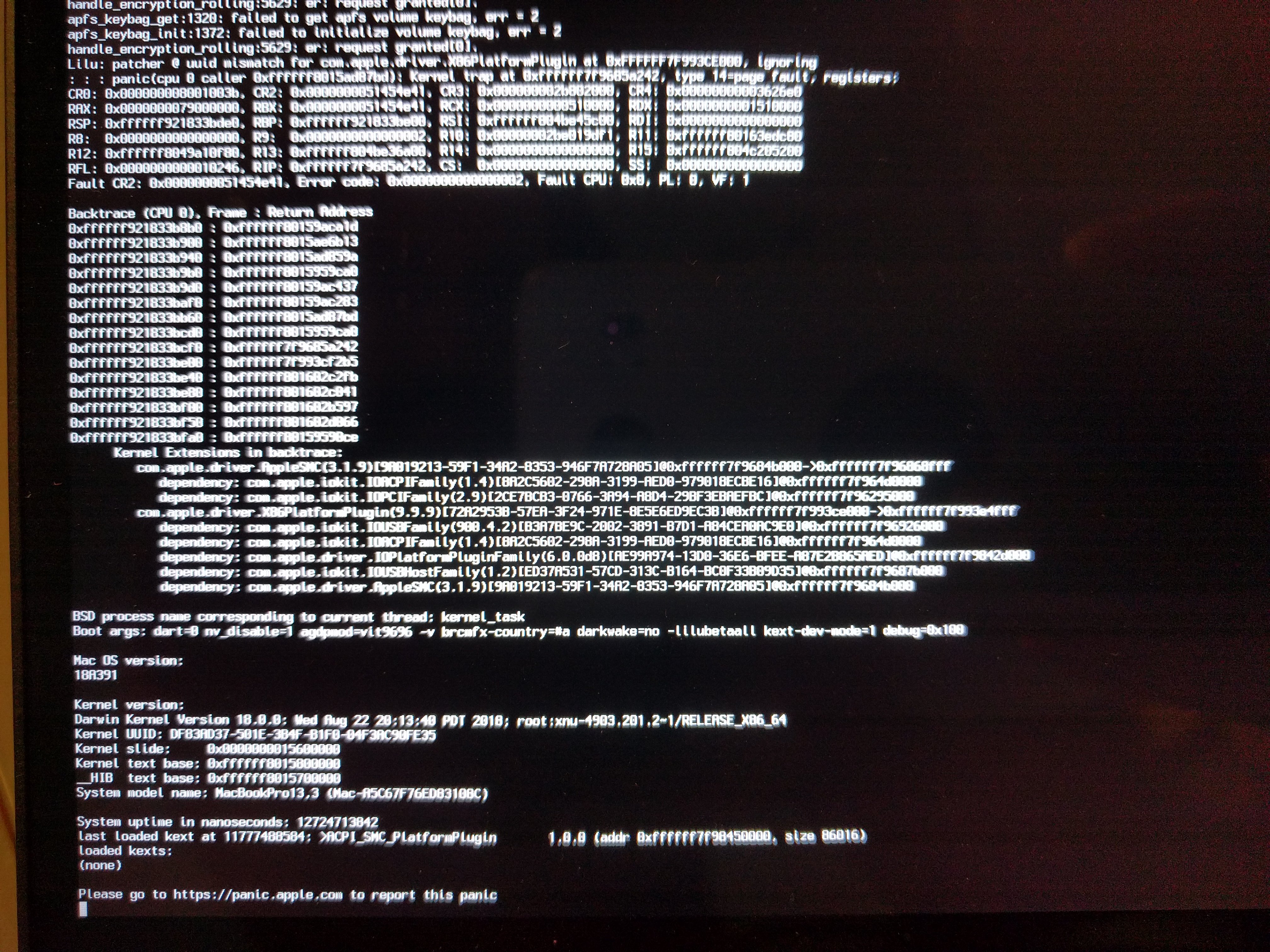

Rajveer86 Posted October 4, 2018 Share Posted October 4, 2018 I too am having a problem with the newer 10.14 Github package, my upgraded 10.14 install works with the older one though. It looks like I'm getting a panic but I've no idea how to debug this, does anybody have any ideas what might be the cause? Link to comment https://www.insanelymac.com/forum/topic/319764-guide-dell-xps-15-9550-mojave-1014-1015-quick-installation/page/54/#findComment-2638796 Share on other sites More sharing options...
Krim404 Posted October 4, 2018 Author Share Posted October 4, 2018 20 minutes ago, Rajveer86 said: I too am having a problem with the newer 10.14 Github package, my upgraded 10.14 install works with the older one though. It looks like I'm getting a panic but I've no idea how to debug this, does anybody have any ideas what might be the cause? see one line above the kernel panic - lilu is unable to apply the patch to the x86PlatformPlugin. Is it possible you have an old lilu.kext running? Link to comment https://www.insanelymac.com/forum/topic/319764-guide-dell-xps-15-9550-mojave-1014-1015-quick-installation/page/54/#findComment-2638799 Share on other sites More sharing options...
phaberest Posted October 4, 2018 Share Posted October 4, 2018 32 minutes ago, Rajveer86 said: It looks like I'm getting a panic but I've no idea how to debug this, does anybody have any ideas what might be the cause? It is exactly the same issue I am having when I try to boot from the new CLOVER folder. I'm afraid there might be a problem with direct updates from 10.13, I'm going to a clean reinstall. Link to comment https://www.insanelymac.com/forum/topic/319764-guide-dell-xps-15-9550-mojave-1014-1015-quick-installation/page/54/#findComment-2638803 Share on other sites More sharing options...
Krim404 Posted October 4, 2018 Author Share Posted October 4, 2018 (edited) 11 minutes ago, phaberest said: It is exactly the same issue I am having when I try to boot from the new CLOVER folder. I'm afraid there might be a problem with direct updates from 10.13, I'm going to a clean reinstall. would be strange, i did the normal upgrade path on all machines. Please try to debug it, so we can fix it. Just to make sure: you were able to boot into the installer, but you're not able to boot in the installed os? EDIT: @phaberest why do you still have the X86PlatformPluginInjector.kext in your /L/E? Edited October 4, 2018 by wmchris 1 Link to comment https://www.insanelymac.com/forum/topic/319764-guide-dell-xps-15-9550-mojave-1014-1015-quick-installation/page/54/#findComment-2638804 Share on other sites More sharing options...
Rajveer86 Posted October 4, 2018 Share Posted October 4, 2018 (edited) 1 hour ago, wmchris said: see one line above the kernel panic - lilu is unable to apply the patch to the x86PlatformPlugin. Is it possible you have an old lilu.kext running? I've had a recent one for a while now - before I upgraded to 10.14 I manually updated a number of kexts (specifically the ones from this post) so I had a newer version than from the 10.13 Github package, then I installed 10.14 and everything worked well. I'm currently trying to boot with the new 10.14 Github package which has an even newer Lilu.kext, the only thing that's different is my config.plist has a few custom Clover settings (my own slide, default volume and my own SMBIOS settings). EDIT: 1 hour ago, wmchris said: EDIT: @phaberest why do you still have the X86PlatformPluginInjector.kext in your /L/E? Oh wait, I also have it there, should I remove it? EDIT 2: Ok I removed it and it boots up now with the new package, brilliant! Thank you so much! I totally can't remember how that kext got there though, but you've saved me a lot of effort! Just for my own curiosity and learning, why did we have to remove it? It looks like it injects unknown CPU information in to MacOS or something, so is 10.14 compatible with our CPUs by default? Edited October 4, 2018 by Rajveer86 1 Link to comment https://www.insanelymac.com/forum/topic/319764-guide-dell-xps-15-9550-mojave-1014-1015-quick-installation/page/54/#findComment-2638813 Share on other sites More sharing options...
phaberest Posted October 5, 2018 Share Posted October 5, 2018 Damn, I got late to the party! Just completed the reinstall and everything works fine now. Thanks @wmchris, another gold! Can't believe it was all about one kext, I totally missed it! Link to comment https://www.insanelymac.com/forum/topic/319764-guide-dell-xps-15-9550-mojave-1014-1015-quick-installation/page/54/#findComment-2638829 Share on other sites More sharing options...
Krim404 Posted October 5, 2018 Author Share Posted October 5, 2018 The kext was from 10.13. it got replaced with another kext, which is not mandatory, too. 10.14 should be compatible with the cpu but some reported to have better battery life with the kext and they don’t do any harm... unless you try to patch the same file twice. Link to comment https://www.insanelymac.com/forum/topic/319764-guide-dell-xps-15-9550-mojave-1014-1015-quick-installation/page/54/#findComment-2638872 Share on other sites More sharing options...

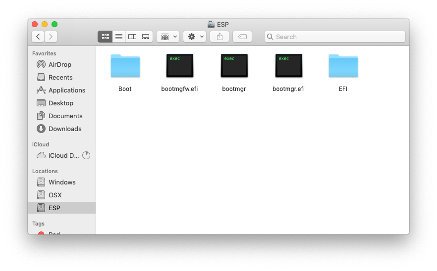

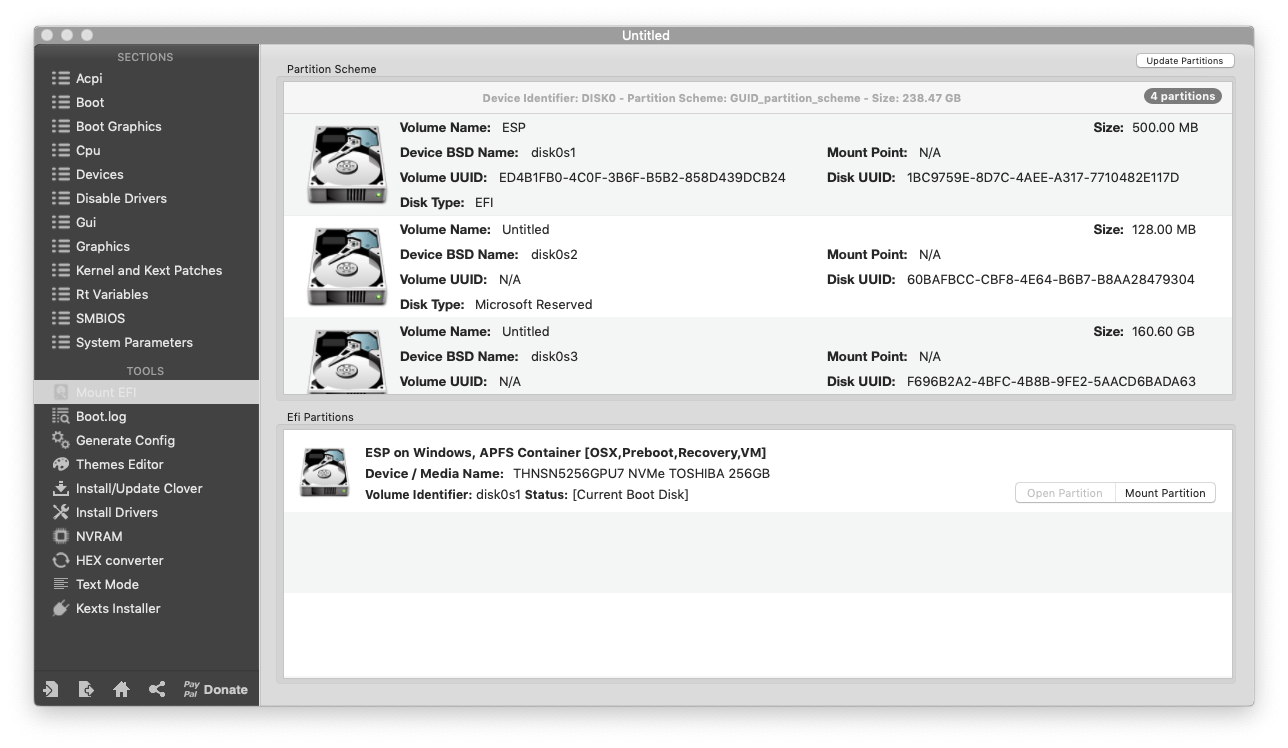

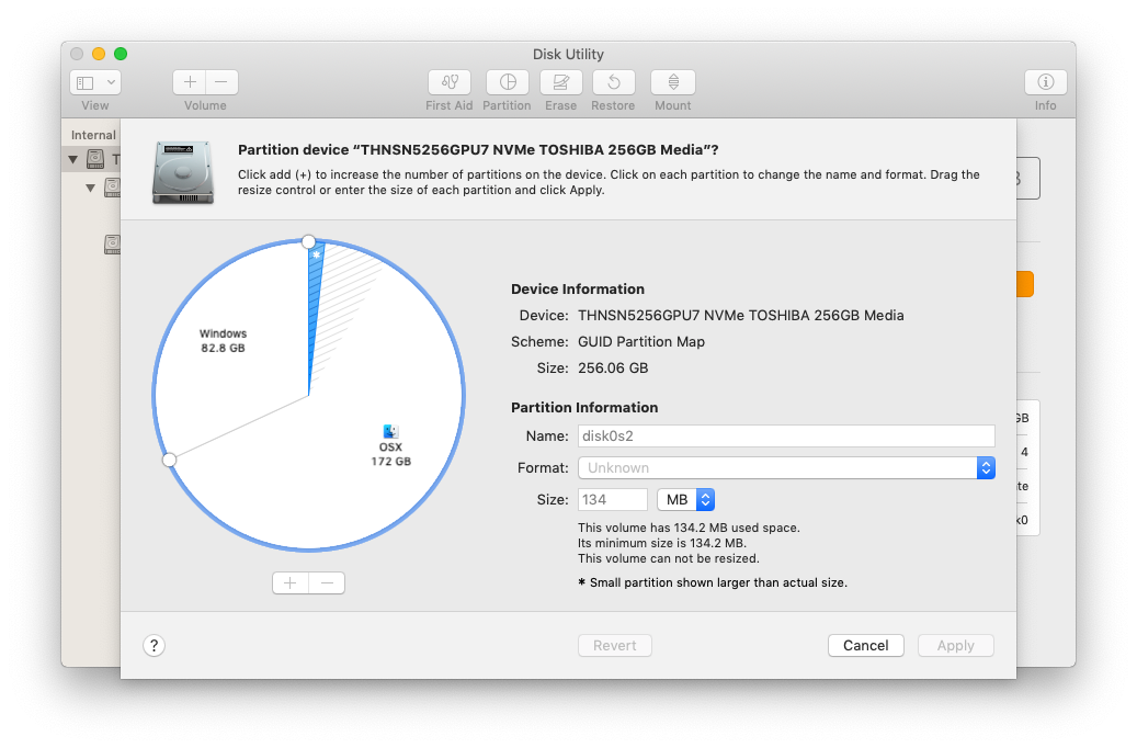

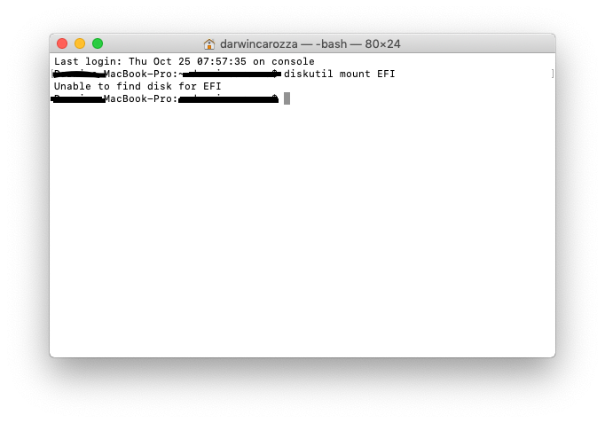

dcarozza6 Posted October 25, 2018 Share Posted October 25, 2018 Hey, first off, thanks for this guide. It's super helpful, and the discussion is also helping to solve some of my problems. The only thing I can't seem to figure out is Step 3, installing Clover on my internal hard drive. My first problem was with "diskutil mount EFI". When I do this without the USB plugged in, it says "Unable to find disk for EFI". If I try it WITH the USB it says that the drive can't be mounted. I know that other people who had this problem were using different tools from TonyMac and such, however, I have used all of the tools listed in the guide, as well as following each step carefully. I tried to just skip past this step, but when I try to install Clover onto my internal drive, I choose "Install Clover in ESP" and "Install RC-Scripts on Target Device." Everything installs successfully, and then I copy the contents of 10.14/Clover over, and restart, and it won't boot without the USB, and once I am in the USB, everything I just described is as if it never happened. Does anyone have any ideas? It seems that I have to figure out the issue of mounting the EFI. Link to comment https://www.insanelymac.com/forum/topic/319764-guide-dell-xps-15-9550-mojave-1014-1015-quick-installation/page/54/#findComment-2642919 Share on other sites More sharing options...
Mr.C Posted October 25, 2018 Share Posted October 25, 2018 4 hours ago, dcarozza6 said: Hey, first off, thanks for this guide. It's super helpful, and the discussion is also helping to solve some of my problems. The only thing I can't seem to figure out is Step 3, installing Clover on my internal hard drive. My first problem was with "diskutil mount EFI". When I do this without the USB plugged in, it says "Unable to find disk for EFI". If I try it WITH the USB it says that the drive can't be mounted. I know that other people who had this problem were using different tools from TonyMac and such, however, I have used all of the tools listed in the guide, as well as following each step carefully. I tried to just skip past this step, but when I try to install Clover onto my internal drive, I choose "Install Clover in ESP" and "Install RC-Scripts on Target Device." Everything installs successfully, and then I copy the contents of 10.14/Clover over, and restart, and it won't boot without the USB, and once I am in the USB, everything I just described is as if it never happened. Does anyone have any ideas? It seems that I have to figure out the issue of mounting the EFI. Try to mount it with CloverConfigurator. wmchris's repo contains it in /Additional/Tools/ Link to comment https://www.insanelymac.com/forum/topic/319764-guide-dell-xps-15-9550-mojave-1014-1015-quick-installation/page/54/#findComment-2642953 Share on other sites More sharing options...
dcarozza6 Posted October 25, 2018 Share Posted October 25, 2018 (edited) 6 hours ago, Mr.C said: Try to mount it with CloverConfigurator. wmchris's repo contains it in /Additional/Tools/ Thanks for your response. So I tried doing that and mounted the EFI shown in my screenshot, however, I still continue to get the same error, even after copying over the contents of the Clover folder. I've also attached a screenshot of what the ESP drive looks like. I managed to get iMessage and iCloud working, I would just like to be able to boot from the internal drive. If it matters, I also have a second partition that I'd eventually install Windows on. I have attached what that looks like in Disk Utility. Edited October 25, 2018 by dcarozza6 Link to comment https://www.insanelymac.com/forum/topic/319764-guide-dell-xps-15-9550-mojave-1014-1015-quick-installation/page/54/#findComment-2643002 Share on other sites More sharing options...
Mr.C Posted October 25, 2018 Share Posted October 25, 2018 (edited) 5 hours ago, dcarozza6 said: Thanks for your response. So I tried doing that and mounted the EFI shown in my screenshot, however, I still continue to get the same error, even after copying over the contents of the Clover folder. I've also attached a screenshot of what the ESP drive looks like. I managed to get iMessage and iCloud working, I would just like to be able to boot from the internal drive. If it matters, I also have a second partition that I'd eventually install Windows on. I have attached what that looks like in Disk Utility. hmmm... interesting. So after you choose ESP option, can you select your OS partition with the "Change Install location" button? pic You followed the tutorial correctly right? Especially this part: "If you want to multiboot with Windows 10, then you'll have to create a second partition, too (also HFS! Dont use FAT or it will not boot! You have to reformat it when installing Windows)." Edited October 25, 2018 by Mr.C there wa a dumb question in it Link to comment https://www.insanelymac.com/forum/topic/319764-guide-dell-xps-15-9550-mojave-1014-1015-quick-installation/page/54/#findComment-2643047 Share on other sites More sharing options...
