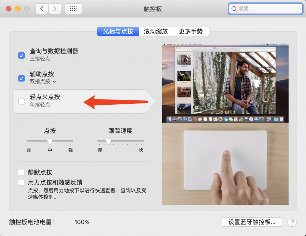

Krim404 Posted September 22, 2018 Author Share Posted September 22, 2018 (edited) On 9/21/2018 at 7:48 AM, nabeelmoeen said: not complaining though, since the rest of it is smoother than it has ever been does the physical click work well for you? i still have the issue, that physical clicks are most of the time unreliable (which makes drag and drop pretty impossible for me). Also the hidd process gets a high cpu load whenever i move the cursor (>50%), normal is 0,6% @alex.daoud Edited September 22, 2018 by wmchris Link to comment https://www.insanelymac.com/forum/topic/319764-guide-dell-xps-15-9550-mojave-1014-1015-quick-installation/page/52/#findComment-2636088 Share on other sites More sharing options...
alex.daoud Posted September 22, 2018 Share Posted September 22, 2018 4 hours ago, wmchris said: does the physical click work well for you? i still have the issue, that physical clicks are most of the time unreliable (which makes drag and drop pretty impossible for me). Also the hidd process gets a high cpu load whenever i move the cursor (>50%), normal is 0,6% @alex.daoud Physical click issue sounds strange, does it do it regardless of configuration options in the sys prefs? The CPU issue just came to light today - I'm not sure whats causing it as it isnt happening on my machine but I'll be looking into it. Link to comment https://www.insanelymac.com/forum/topic/319764-guide-dell-xps-15-9550-mojave-1014-1015-quick-installation/page/52/#findComment-2636164 Share on other sites More sharing options...
Krim404 Posted September 22, 2018 Author Share Posted September 22, 2018 (edited) 37 minutes ago, alex.daoud said: Physical click issue sounds strange, does it do it regardless of configuration options in the sys prefs? The CPU issue just came to light today - I'm not sure whats causing it as it isnt happening on my machine but I'll be looking into it. sysprefs doesnt change the click behaviour for me. more detailed issue: physical clicks work about 30% of the time. The rest either the mouse button up or the mouse button down event is not registered in a timely manner. takes 1-3seconds to fix itself. * physical clicks are not registered (nothing happens), this only happens after at least one successful click in the past few seconds * a drag and drop / highlighting is not released and will continue even without any button pressed -> will be freed after a short amount of time after the actual button up event * hammering the physical click will make it worse (counter-intuitive ;-) ) * taps work like intended, dont seem to interrupt the physical click "timer" i have the issue on two different dell xps 15 models, so i doubt it has anything to do with faulty hardware (and it works well with voodoops2) Edited September 22, 2018 by wmchris 2 Link to comment https://www.insanelymac.com/forum/topic/319764-guide-dell-xps-15-9550-mojave-1014-1015-quick-installation/page/52/#findComment-2636168 Share on other sites More sharing options...
nabeelmoeen Posted September 22, 2018 Share Posted September 22, 2018 9 hours ago, wmchris said: does the physical click work well for you? i still have the issue, that physical clicks are most of the time unreliable (which makes drag and drop pretty impossible for me). Also the hidd process gets a high cpu load whenever i move the cursor (>50%), normal is 0,6% @alex.daoud Will check and confirm. I don't use physical click generally though. I have enabled the "three finger" drag and drop from the Accessibility system preference Link to comment https://www.insanelymac.com/forum/topic/319764-guide-dell-xps-15-9550-mojave-1014-1015-quick-installation/page/52/#findComment-2636210 Share on other sites More sharing options...
gujiangjiang Posted September 22, 2018 Share Posted September 22, 2018 10 hours ago, wmchris said: does the physical click work well for you? i still have the issue, that physical clicks are most of the time unreliable (which makes drag and drop pretty impossible for me). Also the hidd process gets a high cpu load whenever i move the cursor (>50%), normal is 0,6% @alex.daoud I have same problem with physical click on XPS15 and XiaomiPro15.6. It just unreliable and i think it maybe 50% will catch my click and 50% will ignore my click. Here are the system preference. Physical Clink was the 3-rd option Unchecked and test and you will find the same phenomenon. Thanks for alex's great drviers for I2C devices. Link to comment https://www.insanelymac.com/forum/topic/319764-guide-dell-xps-15-9550-mojave-1014-1015-quick-installation/page/52/#findComment-2636213 Share on other sites More sharing options...

Lockzi Posted September 27, 2018 Share Posted September 27, 2018 Hey Guys, just wanted to quickly check here before I report a bug and troubleshoot with the developer. I've switched to VoodooI2C v 2.1.4 today, and if I draw a circle with the mousepointer using the trackpad continuously I can see how it teleports in the last known direction of the circle - exactly every second, which makes it impossible to do a circle. Same thing can be observed if you slowly scroll on this page. The scroll will be jumpy at every second. I have added the DSDT files as per hvolkoff's initial discussion Is anyone else seeing this on our machines? Are everyone else still using the SSDT-I2CX.aml and SSDT-XOSI.aml from the linked post or has the development of the kext changed so it's no longer needed? Link to comment https://www.insanelymac.com/forum/topic/319764-guide-dell-xps-15-9550-mojave-1014-1015-quick-installation/page/52/#findComment-2637286 Share on other sites More sharing options...
Tiberio Galbiati Posted September 27, 2018 Share Posted September 27, 2018 (edited) 4 hours ago, Lockzi said: Hey Guys, just wanted to quickly check here before I report a bug and troubleshoot with the developer. I've switched to VoodooI2C v 2.1.4 today, and if I draw a circle with the mousepointer using the trackpad continuously I can see how it teleports in the last known direction of the circle - exactly every second, which makes it impossible to do a circle. Is anyone else seeing this on our machines? Are everyone else still using the SSDT-I2CX.aml and SSDT-XOSI.aml from the linked post or has the development of the kext changed so it's no longer needed? Hello, I'm experiencing the same issue, but only after sleep. In my case the cursor jumps randomly, I can reproduce the issue moving the cursor or in a straight line or making circles. I'm using VoodooI2C v2.1 with SSDT from the git repo and patched with SSDT-I2CX.aml and SSDT-XOSI.aml from the same post. I really don't know the cause, so now I'm going to update to the last version and I'll tell you Edited September 27, 2018 by Tiberio Galbiati fix Link to comment https://www.insanelymac.com/forum/topic/319764-guide-dell-xps-15-9550-mojave-1014-1015-quick-installation/page/52/#findComment-2637326 Share on other sites More sharing options...
Lockzi Posted September 28, 2018 Share Posted September 28, 2018 9 hours ago, Tiberio Galbiati said: Hello, I'm experiencing the same issue, but only after sleep. In my case the cursor jumps randomly, I can reproduce the issue moving the cursor or in a straight line or making circles. I'm using VoodooI2C v2.1 with SSDT from the git repo and patched with SSDT-I2CX.aml and SSDT-XOSI.aml from the same post. I really don't know the cause, so now I'm going to update to the last version and I'll tell you So then I am guessing it is something with our implementation. I have not realized nor confirmed that it occurs after sleep. Interesting, will check it out. It seems like it has something to do with the GPIO pins for trackpad interrupts? Maybe I should try rolling back the GPIO patches and use VoodooI2Cs polling method instead... Link to comment https://www.insanelymac.com/forum/topic/319764-guide-dell-xps-15-9550-mojave-1014-1015-quick-installation/page/52/#findComment-2637373 Share on other sites More sharing options...
alex.daoud Posted September 28, 2018 Share Posted September 28, 2018 2 hours ago, Lockzi said: So then I am guessing it is something with our implementation. I have not realized nor confirmed that it occurs after sleep. Interesting, will check it out. It seems like it has something to do with the GPIO pins for trackpad interrupts? Maybe I should try rolling back the GPIO patches and use VoodooI2Cs polling method instead... APCIBatteryManager is known to clash with VoodooI2C and cause jittery movement. Try removing it if you have it and check if that improves things. Link to comment https://www.insanelymac.com/forum/topic/319764-guide-dell-xps-15-9550-mojave-1014-1015-quick-installation/page/52/#findComment-2637403 Share on other sites More sharing options...
Lockzi Posted September 28, 2018 Share Posted September 28, 2018 5 hours ago, alex.daoud said: APCIBatteryManager is known to clash with VoodooI2C and cause jittery movement. Try removing it if you have it and check if that improves things. Hello Alex, I can confirm that I was using APCIBatteryManager. After disabling it I still have the same issue, so it's not even after sleep. Should I go through with the troubleshoot procedure you've listed on Github? Link to comment https://www.insanelymac.com/forum/topic/319764-guide-dell-xps-15-9550-mojave-1014-1015-quick-installation/page/52/#findComment-2637460 Share on other sites More sharing options...
