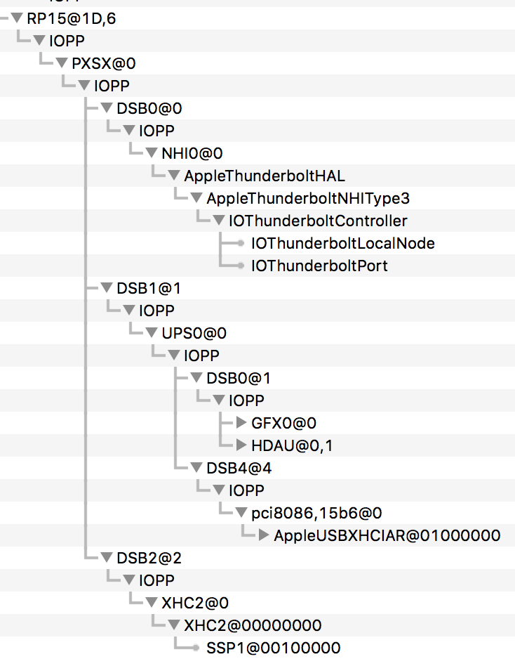

dpassmor Posted March 23, 2018 Share Posted March 23, 2018 (edited) Apologies if this has already been discussed before. I bought a Gigabyte AORUS 1080 Gaming Box-- essentially a Thunderbolt 3 external Nvidia GPU, which has 3 USB 3.0 ports and 100W of power delivery so it also makes a decent docking station. Good news: I had to make some tweaks to my SSDT-TB and install the Nvidia web drivers, but when plugged in at boot, the box works flawlessly. The built-in laptop display is the main display, external displays pop up (I attached a 4K DisplayPort and 2560x1440 HDMI monitor and both were full res), and the USB ports and power delivery work great. Curiously it doesn't show up under the NHI0 device, but on a different bus. Bad news: If you want to turn off the laptop display, you can't just close the lid, it does nothing. I have to turn off Intel graphics injection and set a FakeID, essentially disabling the built-in display. Gonna look for a work-around as this is annoying. Worse news: Hot-plugging does not work. Unplugging the box crashes the laptop. If I build an ACPI device tree and set the bus/devices as removable, I get a PCI-Express icon in the menu bar, with the option to turn off the display controller, audio controller, or USB controller. Picking any option crashes the laptop. Booting and then plugging in the box brings up the PCI-Express icon with the same three choices, but no drivers load for the Nvidia card or USB controller. Okay news: Apple is set to include better eGPU support in 10.3.4, so I may be able to make this work. Of course, they're only supporting Radeon cards but maybe we'll get lucky. Edited March 23, 2018 by dpassmor Link to comment https://www.insanelymac.com/forum/topic/319764-guide-dell-xps-15-9550-mojave-1014-1015-quick-installation/page/47/#findComment-2605159 Share on other sites More sharing options...

TheRacerMaster Posted March 27, 2018 Share Posted March 27, 2018 For those interested in working on Thunderbolt, some ACPI/UEFI stuff was recently open-sourced (part of EDK2 MinPlatformPkg): https://github.com/tianocore/edk2-platforms/commit/62f1e1e58965702030f722dcdf6de58998cf08a1 1 1 Link to comment https://www.insanelymac.com/forum/topic/319764-guide-dell-xps-15-9550-mojave-1014-1015-quick-installation/page/47/#findComment-2605934 Share on other sites More sharing options...
goodwin_c Posted March 27, 2018 Share Posted March 27, 2018 3 hours ago, TheRacerMaster said: For those interested in working on Thunderbolt, some ACPI/UEFI stuff was recently open-sourced (part of EDK2 MinPlatformPkg): https://github.com/tianocore/edk2-platforms/commit/62f1e1e58965702030f722dcdf6de58998cf08a1 Hmm, very interesting. Big tnx for pointing on this! Will try to check on free hours. 1 Link to comment https://www.insanelymac.com/forum/topic/319764-guide-dell-xps-15-9550-mojave-1014-1015-quick-installation/page/47/#findComment-2605969 Share on other sites More sharing options...

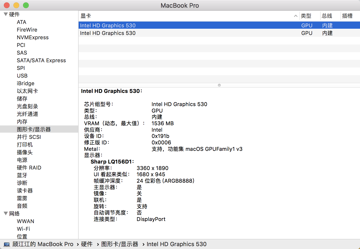

gujiangjiang Posted March 30, 2018 Share Posted March 30, 2018 (edited) When updated to 10.13.4 it show 2 Intel GPU in system preferences panel. How to deal with it. Edited March 30, 2018 by gujiangjiang Link to comment https://www.insanelymac.com/forum/topic/319764-guide-dell-xps-15-9550-mojave-1014-1015-quick-installation/page/47/#findComment-2606283 Share on other sites More sharing options...
TheRacerMaster Posted March 30, 2018 Share Posted March 30, 2018 Update Clover. I believe this was fixed in r4414. 1 1 Link to comment https://www.insanelymac.com/forum/topic/319764-guide-dell-xps-15-9550-mojave-1014-1015-quick-installation/page/47/#findComment-2606287 Share on other sites More sharing options...
gujiangjiang Posted March 30, 2018 Share Posted March 30, 2018 Update Clover. I believe this was fixed in r4414.Much thanks to you and thanks for you to help with CoreDisplayFixup to deal with 10.13.4.从我的 iPhone 发送,使用 Tapatalk Link to comment https://www.insanelymac.com/forum/topic/319764-guide-dell-xps-15-9550-mojave-1014-1015-quick-installation/page/47/#findComment-2606288 Share on other sites More sharing options...
