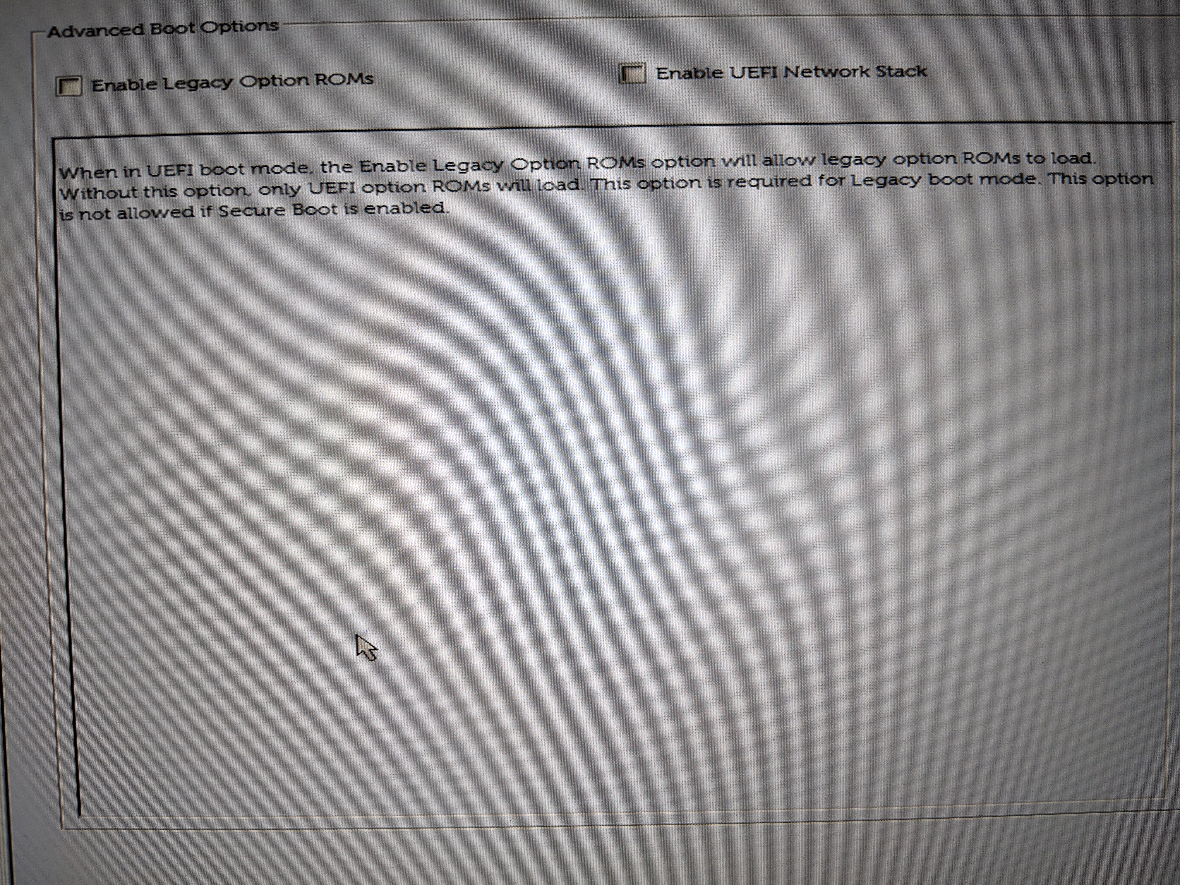

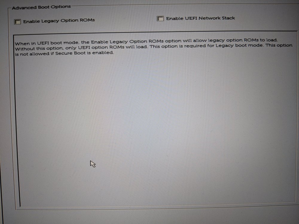

bratwurstinhalator Posted September 2, 2018 Share Posted September 2, 2018 (edited) 22 minutes ago, savvamitrofanov said: Also disable CSM (legacy boot) in BIOS settings. As I saw in your drivers list - CSM present I have disabled it now. Edited September 2, 2018 by bratwurstinhalator Link to comment https://www.insanelymac.com/forum/topic/317290-filevault-2/page/18/#findComment-2632980 Share on other sites More sharing options...
vit9696 Posted September 2, 2018 Author Share Posted September 2, 2018 Yes, that should do the trick in Dell. To be completely sure it may be worth running drivers in UEFI Shell and checking the list for BIOS[INT 10] entry. It should disappear. Our main idea with Savva now is to apply several patches on boot.efi (Clover supports making them on the fly) to see where exactly it hangs by e.g. forcing an instant reboot. Will you be around for an hour or two to run these tests? Also, I think it is best to move to PM not to distract other people. Link to comment https://www.insanelymac.com/forum/topic/317290-filevault-2/page/18/#findComment-2632981 Share on other sites More sharing options...

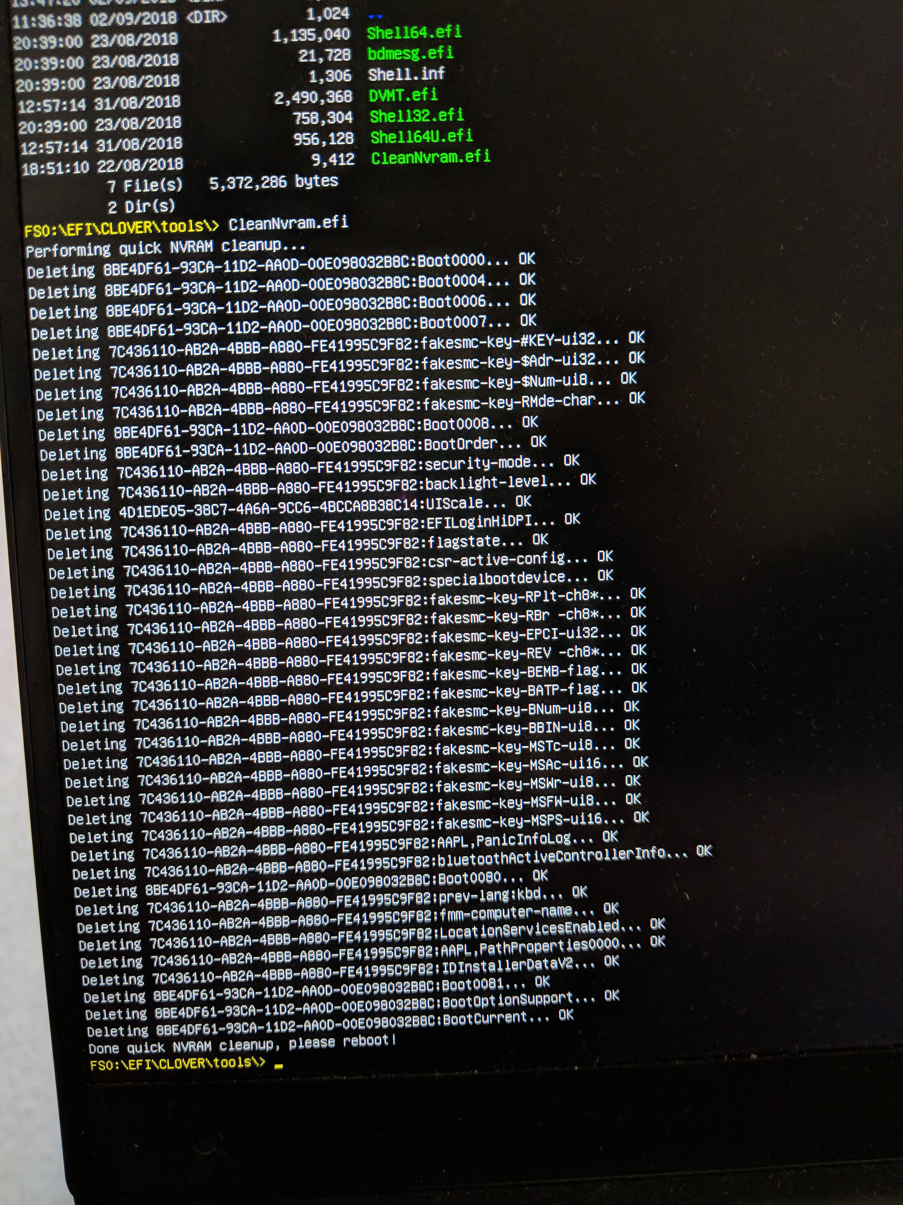

JorgeMax Posted September 5, 2018 Share Posted September 5, 2018 On 9/2/2018 at 9:00 AM, bratwurstinhalator said: Thank you for taking a look at the source code. I executed CleanNvram and it removed quite a view variables. However, I still can't boot. Symptoms have not changed. Hello Friend. How did you run "CleanNvram.efi"? Any command? I just put it in the Clover tools folder and I rebooted the machine and ran the shell, digiteil "CleanNvram.efi", but without success, it does not accept the command I typed Link to comment https://www.insanelymac.com/forum/topic/317290-filevault-2/page/18/#findComment-2633394 Share on other sites More sharing options...
bratwurstinhalator Posted September 5, 2018 Share Posted September 5, 2018 15 minutes ago, JorgeMax said: Hello Friend. How did you run "CleanNvram.efi"? Any command? I just put it in the Clover tools folder and I rebooted the machine and ran the shell, digiteil "CleanNvram.efi", but without success, it does not accept the command I typed You need to select the filesystem, e.g. by typing FS0: and then use cd to go into the directory that contains CleanNvram.efi. 1 Link to comment https://www.insanelymac.com/forum/topic/317290-filevault-2/page/18/#findComment-2633396 Share on other sites More sharing options...
