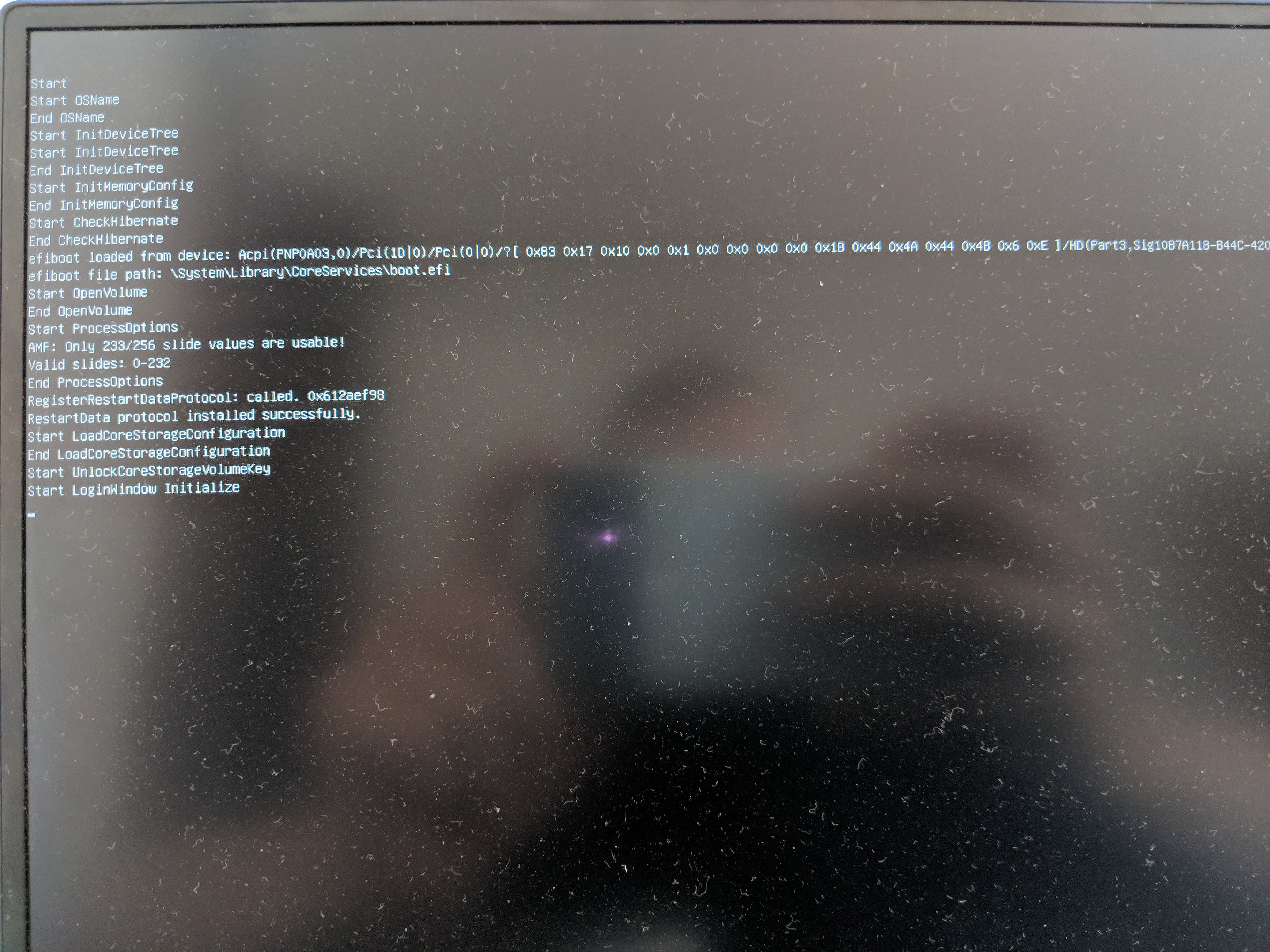

However, I nerver saw "Start LoginWindow Initialize". Could you send a pic ?
If I'll get that far I will gladly tell you if it works :D
Attached pic is a photo of the output i get when I try to boot FileVault Rescue.

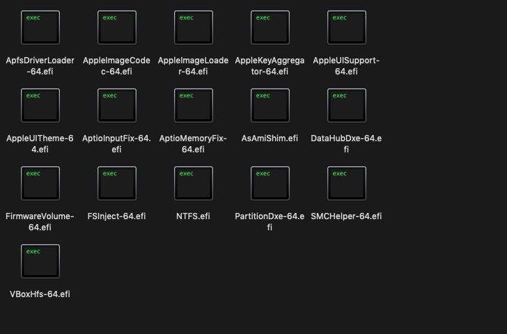

Here's everything I'm using.
Could you try to remove those USBKB & Mouse drivers and also add AsAmiShim?
AsAmiShim.efi
AptioInputFix-64.efi

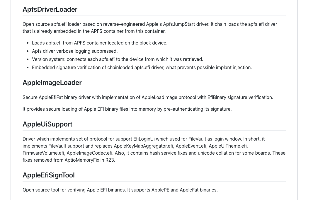

Remove HashServiceFix-64.efi, FirmwareVolume-64.efi, EnglishDxe-64.efi, AppleUITheme-64.efi, AppleKeyMapAggregator.efi, AppleKeyAggregator-64.efi and AppleImageCodec-64.efi. AppleUiSupport replaces those drivers. Also remove OsxAptioFixDrv-64.efi and update AptioMemoryFix from https://github.com/acidanthera/AptioFixPkg/releases/download/R23/AptioFix-R23-RELEASE.zip and update AppleUiSupport from https://github.com/acidanthera/AppleSupportPkg/releases/download/2.0.3/AppleSupport-v2.0.3-RELEASE.zip
If you use apfs - replace apfs.efi with apfsdriverloader from https://github.com/acidanthera/AppleSupportPkg/releases/download/2.0.3/AppleSupport-v2.0.3-RELEASE.zip
It is possible that, EfiLoginUI doesn't start due to broken FirmwareVolume injector implementation inside Clover. It breaks FirmwareVolume protocol at all by overriding it without keeping original functions pointers usage. So, try with AppleUiSupport with changes which I described above.
Edited by savvamitrofanov

I now have the weird effect that I need to press keyboard keys multiple times until something happens.
I still do not get past "Start LoginWindow Initialize".
Really appreciate your help with this since I don't understand whats going on due to the lack of logs! I updated my signature with hardware details.

Also remove asamishim - it is pre-release version of aptioinputfix, and remove appleimageloader

Also, I thought AppleImageLoader is needed to get rid of the UI being stuck until you press a key... Is that included in the AppleUISupport, as well? Or...am I missing something? To be honest, I'm not sure what that one is for. The one that made a difference for me was AppleImageLoader. But I'm thinking of cleaning up my drivers a little bit if there are unused ones there (such as AsAmiShim).
AppleImageLoader used for fat binaries support. AppleUiSupport - for FileVault UI.
However I documented it inside README on github

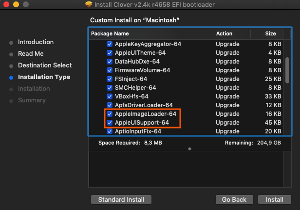

@bratwurstinhalator,
Please update AptioMemoryFix and AppleUiSupport as I mention above
  • Like 3
Crystal clear and very well documented. Many thanks. :)

Sorry it took me so long go get here.
Problem still persists.
In case it matters: I'm trying to use FileVault on my Dell XPS 13 laptop. I'm using this Clover configuration: https://github.com/the-darkvoid/XPS9360-macOS/tree/master/CLOVER

6 minutes ago, bratwurstinhalator said:
I updated Aptiofix to R23 AppleUiSupport to version 2.0.3.
UEFI driver directory now looks like this:
Apfs-64.efi
AppleKeyFeeder.efi
AppleUiSupport-64.efi
AptioMemoryFix-64.efi
DataHubDxe-64.efi
FSInject-64.efi
Fat-64.efi
HFSPlus.efi
NvmExpressDxe-64.efi
SMCHelper-64.efi
UsbKbDxe-64.efi (re-added in case the built in keyboard does not react)
Do you still need FAT-64? I mean....most people wanna get rid of their fat. You probably don't wanna keep it around. Also, I don't know what that AppleKeyFeeder is... Never used it.
Also, I know this might sound like a "duuh" kinda thing...But it can happen to anyone. Make sure you're booting from the right EFI partition (if you have multiple ones). :)
Otherwise you might be changing stuff till morning, and they won't have any effect if you're not actually booting from that disk.
Edited by arsradu
Hmm problem with FileVault rescue mode. FileVault rescue mode adds recovery-boot-mode variable into nvram, which used to provide nested boot.efi load. It works like: AptioMemoryFix catch boot.efi, then boot.efi reads recovery-boot-mode variable and then load boot.efi from recovery partition, and here old implementation like OsxAptioFix catches again new boot.efi and broke all the boot process. vit9696 fixed nested booting inside his driver, but if I remember - Clover still contain workarounds, which possible broke this feature.
Wait a bit, I'll revise Clover code

I have a fresh installation of macOS on the internal SSD. I have not installed Clover on the SSD, yet. I'm still using a pen drive for booting and I'm doing changes to the pen drive with another computer, so it is ensured all changes take effect instantly.
Very interesting stuff
"  if (!gDriversFlags.AptioMemFixLoaded) {
    DeleteNvramVariable(L"recovery-boot-mode", &gEfiAppleBootGuid);
Clover doesn't touch this variable if AptioMemoryFix loaded, so problem inside something different
Try to reset nvram with tool CleanNvram from https://github.com/acidanthera/AptioFixPkg from UEFI shell
