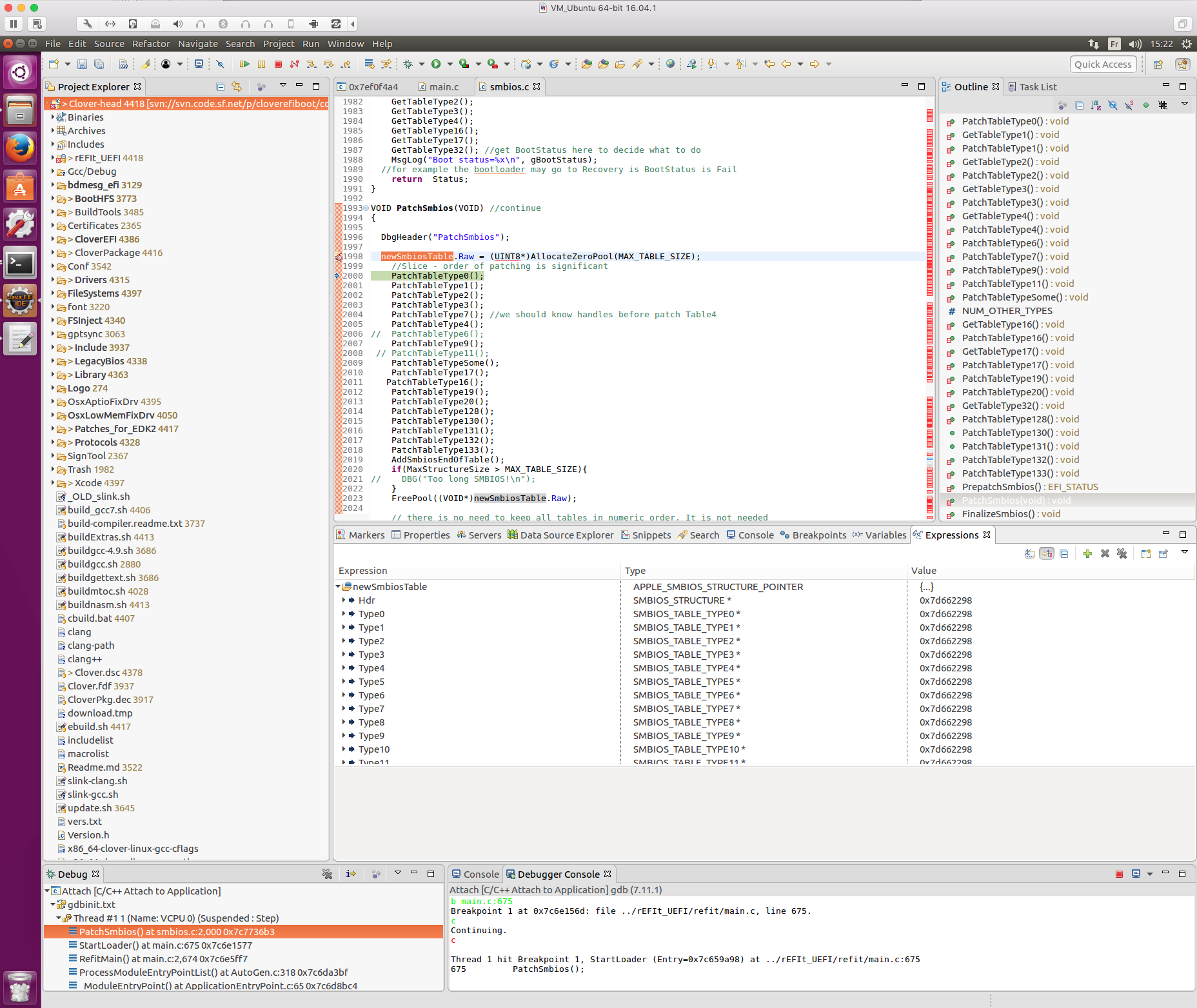

Slice Posted April 20, 2018 Share Posted April 20, 2018 31 minutes ago, Jief_Machak said: The bug I found is : in smbios.c GetTableType16(), at the end, add : // VMWare report 64 memory slots !!! MAX_RAM_SLOTS is currently 24. Crash is PatchTable17. if ( TotalCount > MAX_RAM_SLOTS ) TotalCount = MAX_RAM_SLOTS; Accepted to 4445. Link to comment https://www.insanelymac.com/forum/topic/317290-filevault-2/page/13/#findComment-2610811 Share on other sites More sharing options...
