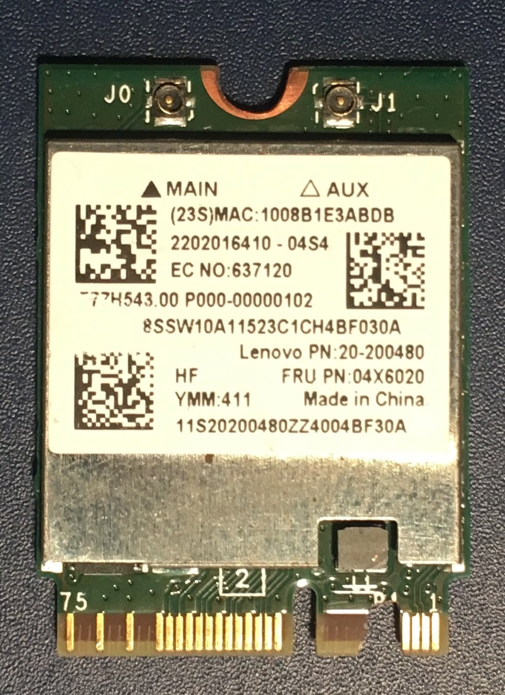

nijhawank Posted November 29, 2018 Share Posted November 29, 2018 Can somebody help me answer this question? I have a T460 (not T460s or T460p) that has Intel Wireless-AC 8260NGW. I see BCM94352Z (Dell DW1560) as the best-recommended replacement WiFi Card at various places. However, before ordering I wanted to ensure compatibility. Per https://wikidevi.com/wiki/Dell_Wireless_1560_(DW1560) it seems to have a U.FL Antenna Connectors. But 8260NGW has MHF4 Antenna Connectors per https://wikidevi.com/wiki/Intel_Dual_Band_Wireless-AC_8260_(8260NGW) So I wanted to know if people who have used DW1560 in their T460, did they use some kind of adapters for the antenna connectors or is the information wrong in wikidevi.com? I also know that there's another variation of BCM94352Z (Lenovo 04X6020). This has MHF4 per https://wikidevi.com/wiki/Foxconn_T77H543.00 but seems to have a different socket connector. 8260NGW and DW1560 are like this... 04X6020 has like this... 1 Link to comment https://www.insanelymac.com/forum/topic/315451-guide-lenovo-t460t470-macos-with-clover-and-opencore/page/28/#findComment-2650504 Share on other sites More sharing options...
tluck Posted December 2, 2018 Author Share Posted December 2, 2018 (edited) i used BCM4352Z NGFF M.2 (aka Dell DW1560). i dont remember what the slot looks like. to see if the 2nd cutout is needed or not to install the card. depending on the slot requirement, then maybe the 2nd card would work as well? Edited December 2, 2018 by tluck Link to comment https://www.insanelymac.com/forum/topic/315451-guide-lenovo-t460t470-macos-with-clover-and-opencore/page/28/#findComment-2651481 Share on other sites More sharing options...
verleihnix Posted December 3, 2018 Share Posted December 3, 2018 (edited) 14 hours ago, tluck said: i used BCM4352Z NGFF M.2 (aka Dell DW1560). i dont remember what the slot looks like. to see if the 2nd cutout is needed or not to install the card. depending on the slot requirement, then maybe the 2nd card would work as well? The 2nd cutout is needed. You can do it with a small jigsaw. There are a few who did it. Be careful, it is your own risk. I am using a org Apple WIFI BCM94360CS2 with adapter. The bottom cover has a small dent, which I can live with. Therefore the complete WIFI and bluetooth Kext and Patches are not needed. Handoff, Continuity and Apple Watch unlock is working. Edited December 3, 2018 by verleihnix Link to comment https://www.insanelymac.com/forum/topic/315451-guide-lenovo-t460t470-macos-with-clover-and-opencore/page/28/#findComment-2651574 Share on other sites More sharing options...

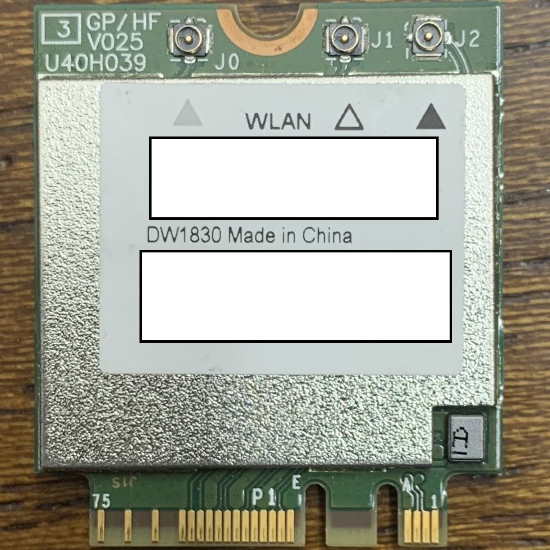

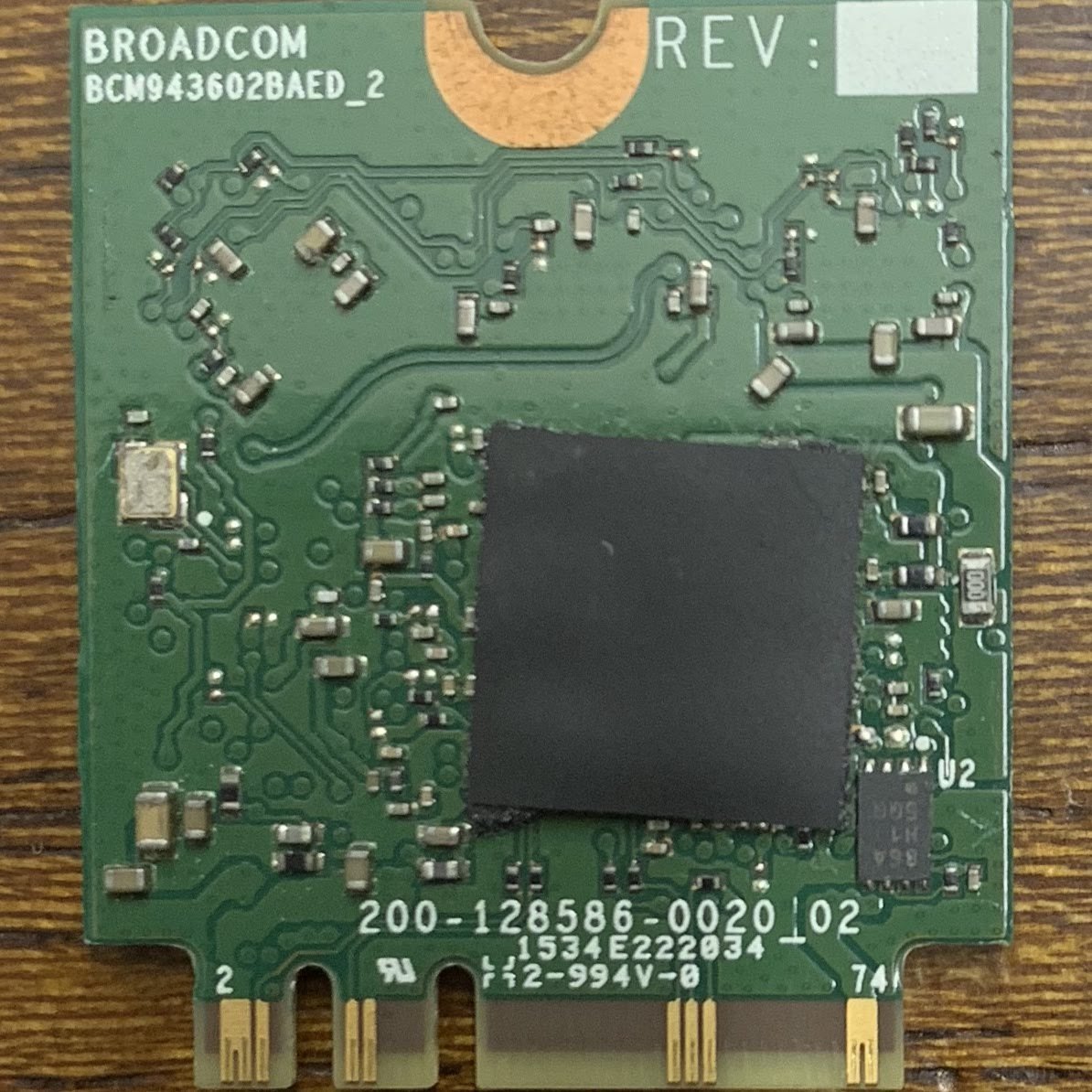

nijhawank Posted December 12, 2018 Share Posted December 12, 2018 I recently bought this dw1830 over ebay. The card works but I'm wondering what is this black patch on the back side. The seller said its used item removed from another laptop but do you think it's some bad/quick fixing hidden behind the patch. I've not tried removing the patch because otherwise the card is working but I'm thinking of quick/dirty fixing which might reveal after some use.Do you think I should take this up with the seller? I'm saying this because something similar happened some time ago when I ordered a laptop keyboard from ebay. It said and looked brand new, worked well for couple of weeks and then went completely dead. Link to comment https://www.insanelymac.com/forum/topic/315451-guide-lenovo-t460t470-macos-with-clover-and-opencore/page/28/#findComment-2653493 Share on other sites More sharing options...

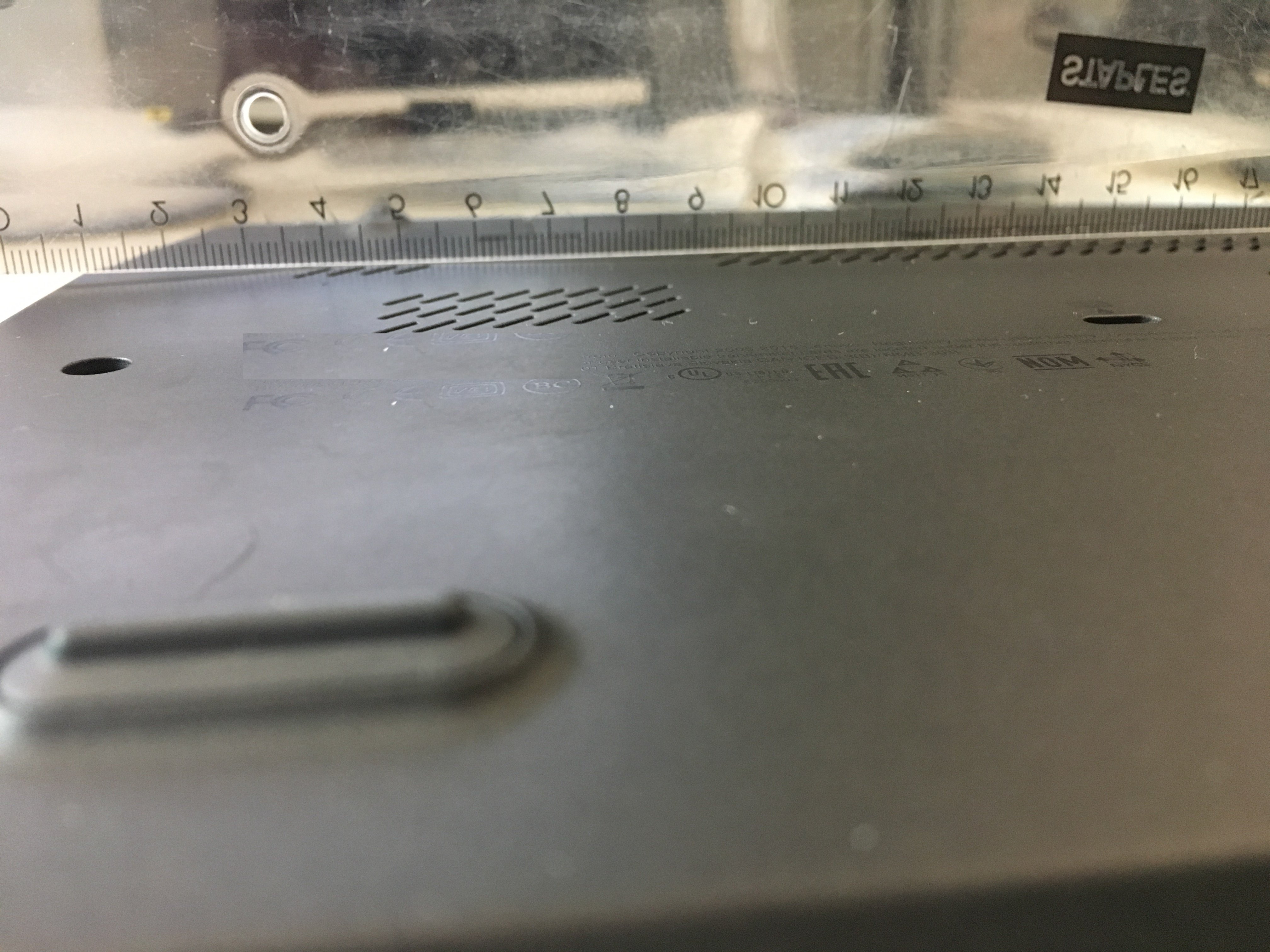

jamesy829 Posted December 12, 2018 Share Posted December 12, 2018 On 12/3/2018 at 2:46 AM, verleihnix said: The 2nd cutout is needed. You can do it with a small jigsaw. There are a few who did it. Be careful, it is your own risk. I am using a org Apple WIFI BCM94360CS2 with adapter. The bottom cover has a small dent, which I can live with. Therefore the complete WIFI and bluetooth Kext and Patches are not needed. Handoff, Continuity and Apple Watch unlock is working. 3 Hey @verleihnix I would like to take your approach of using the original Apple WIFI BCM94360CS2, I found this on eBay - https://www.ebay.ca/itm/Wireless-AC-Wifi-Bluetooth-Card-BCM94360CS2-For-MacBook-Air-13-A1465-A1466-GW/273112300004?hash=item3f96c2f9e4:g:iOAAAOSwn~JaqySc:rk:4:pf:0 I was wondering if this works and what adapter are you referring to? Something like this - https://www.ebay.ca/itm/BCM94360CS2-Card-To-NGFF-M-2-Key-A-E-Adapter-For-Mac-OS-and-Hackintosh/391512537270?hash=item5b27f738b6:g:wIEAAOSw42JZGAtx:rk:2:pf:0 It says on the description it doesn't fit on laptop so I was not sure. Thanks! Link to comment https://www.insanelymac.com/forum/topic/315451-guide-lenovo-t460t470-macos-with-clover-and-opencore/page/28/#findComment-2653494 Share on other sites More sharing options...
