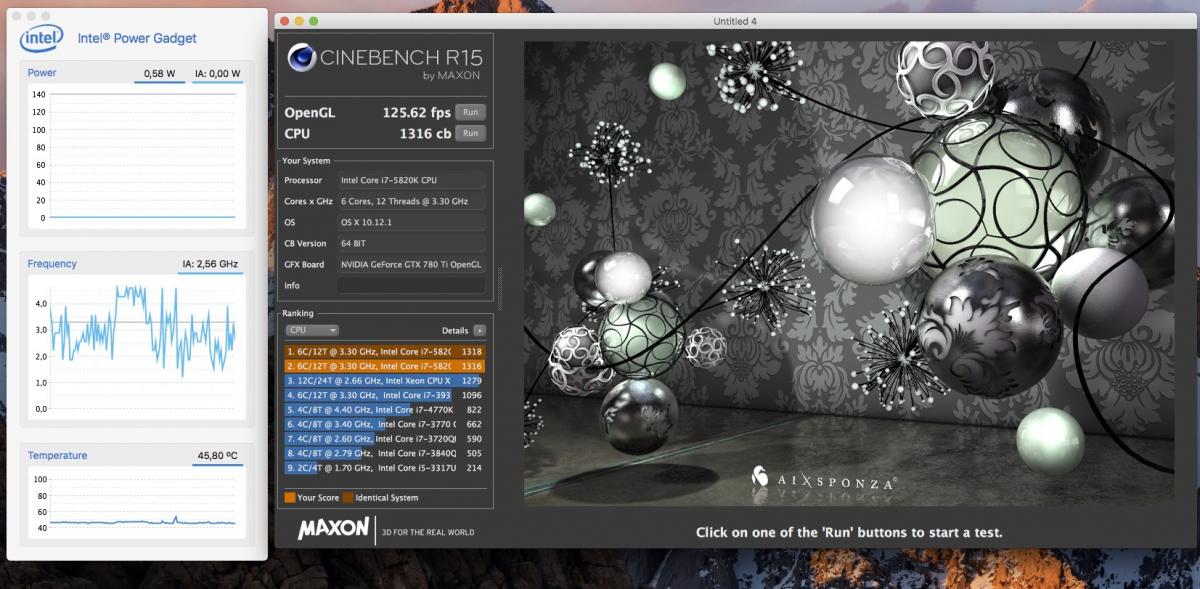

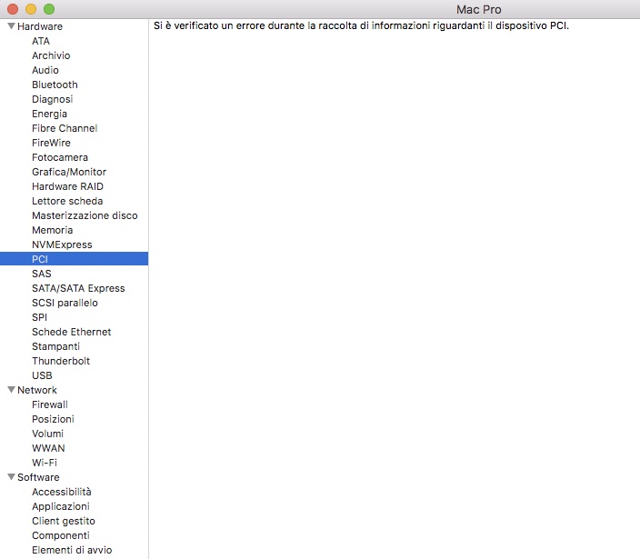

NeXtor Posted December 2, 2016 Share Posted December 2, 2016 I also have problems with intel power gadget: I created a new SSDT with MACPRO6,1 and frequencyvector iMac14,2 -Turbo 4600 Everything seems to work properly, but in the system information - pci cards I do not find anything I am attaching my configuration, can you tell me if everything is correct? DarwinDumper : DarwinDumper_3.0.2_02.12_17.42.09_MacPro6,1_AMI_X64_3949_Sierra_16B2555_gabriele 17.45.42.zip IoJones log : Gabriele’s Mac Pro.zip EFI : http://jmp.sh/IYyVnj9 AppleIntelInfo.kext v2.0 Copyright © 2012-2016 Pike R. Alpha. All rights reserved enableHWP................................: 0 Settings: ------------------------------------------ logMSRs..................................: 1 logIGPU..................................: 0 logCStates...............................: 1 logIPGStyle..............................: 1 InitialTSC...............................: 0x1875ee55a0ff (814 MHz) MWAIT C-States...........................: 8480 Processor Brandstring....................: Intel(R) Core(TM) i7-5820K CPU @ 3.30GHz Processor Signature..................... : 0x306F2 ------------------------------------------ - Family............................... : 6 - Stepping............................. : 2 - Model................................ : 0x3F (63) Model Specific Registers (MSRs) ------------------------------------------ MSR_CORE_THREAD_COUNT............(0x35) : 0xFFFFFF806BFC1F00 ------------------------------------------ - Core Count........................... : 6 - Thread Count......................... : 12 MSR_PLATFORM_INFO................(0xCE) : 0x20080C3BF3812100 ------------------------------------------ - Maximum Non-Turbo Ratio.............. : 0x21 (3300 MHz) - Ratio Limit for Turbo Mode........... : 1 (programmable) - TDP Limit for Turbo Mode............. : 1 (programmable) - Low Power Mode Support............... : 1 (LPM supported) - Number of ConfigTDP Levels........... : 1 (additional TDP level(s) available) - Maximum Efficiency Ratio............. : 12 - Minimum Operating Ratio.............. : 8 MSR_PMG_CST_CONFIG_CONTROL.......(0xE2) : 0x400 ------------------------------------------ - I/O MWAIT Redirection Enable......... : 1 (enabled, IO read of MSR(0xE4) mapped to MWAIT) - CFG Lock............................. : 0 (MSR not locked) - C3 State Auto Demotion............... : 0 (disabled/unsupported) - C1 State Auto Demotion............... : 0 (disabled/unsupported) - C3 State Undemotion.................. : 0 (disabled/unsupported) - C1 State Undemotion.................. : 0 (disabled/unsupported) - Package C-State Auto Demotion........ : 0 (disabled/unsupported) - Package C-State Undemotion........... : 0 (disabled/unsupported) MSR_PMG_IO_CAPTURE_BASE..........(0xE4) : 0x10414 ------------------------------------------ - LVL_2 Base Address................... : 0x414 - C-state Range........................ : 1 (C6 is the max C-State to include) IA32_MPERF.......................(0xE7) : 0x7816B94448 IA32_APERF.......................(0xE8) : 0xA56B947C59 MSR_FLEX_RATIO...................(0x194) : 0xE0000 ------------------------------------------ MSR_IA32_PERF_STATUS.............(0x198) : 0x29F900002E00 ------------------------------------------ - Current Performance State Value...... : 0x2E00 (4600 MHz) MSR_IA32_PERF_CONTROL............(0x199) : 0xFF00 ------------------------------------------ - Target performance State Value....... : 0xFF00 (25500 MHz) - Intel Dynamic Acceleration........... : 0 (IDA engaged) IA32_CLOCK_MODULATION............(0x19A) : 0x0 IA32_THERM_INTERRUPT.............(0x19B) : 0x0 IA32_THERM_STATUS................(0x19C) : 0x88400000 ------------------------------------------ - Thermal Status....................... : 0 - Thermal Log.......................... : 0 - PROCHOT # or FORCEPR# event.......... : 0 - PROCHOT # or FORCEPR# log............ : 0 - Critical Temperature Status.......... : 0 - Critical Temperature log............. : 0 - Thermal Threshold #1 Status.......... : 0 - Thermal Threshold #1 log............. : 0 - Thermal Threshold #2 Status.......... : 0 - Thermal Threshold #2 log............. : 0 - Power Limitation Status.............. : 0 - Power Limitation log................. : 0 - Current Limit Status................. : 0 - Current Limit log.................... : 0 - Cross Domain Limit Status............ : 0 - Cross Domain Limit log............... : 0 - Digital Readout...................... : 64 - Resolution in Degrees Celsius........ : 1 - Reading Valid........................ : 1 (valid) MSR_THERM2_CTL...................(0x19D) : 0x0 IA32_MISC_ENABLES................(0x1A0) : 0x840089 ------------------------------------------ - Fast-Strings......................... : 1 (enabled) - FOPCODE compatibility mode Enable.... : 0 - Automatic Thermal Control Circuit.... : 1 (enabled) - Split-lock Disable................... : 0 - Performance Monitoring............... : 1 (available) - Bus Lock On Cache Line Splits Disable : 0 - Hardware prefetch Disable............ : 0 - Processor Event Based Sampling....... : 0 (PEBS supported) - GV1/2 legacy Enable.................. : 0 - Enhanced Intel SpeedStep Technology.. : 0 (disabled) - MONITOR FSM.......................... : 1 (MONITOR/MWAIT supported) - Adjacent sector prefetch Disable..... : 0 - CFG Lock............................. : 0 (MSR not locked) - xTPR Message Disable................. : 1 (disabled) MSR_TEMPERATURE_TARGET...........(0x1A2) : 0x670A00 ------------------------------------------ - Turbo Attenuation Units.............. : 0 - Temperature Target................... : 103 - TCC Activation Offset................ : 0 MSR_MISC_PWR_MGMT................(0x1AA) : 0x400000 ------------------------------------------ - EIST Hardware Coordination........... : 0 (hardware coordination enabled) - Energy/Performance Bias support...... : 1 - Energy/Performance Bias.............. : 0 (disabled/MSR not visible to software) - Thermal Interrupt Coordination Enable : 1 (thermal interrupt routed to all cores) MSR_TURBO_RATIO_LIMIT............(0x1AD) : 0x22222E2E2E2E2E2E ------------------------------------------ - Maximum Ratio Limit for C01.......... : 2E (4600 MHz) - Maximum Ratio Limit for C02.......... : 2E (4600 MHz) - Maximum Ratio Limit for C03.......... : 2E (4600 MHz) - Maximum Ratio Limit for C04.......... : 2E (4600 MHz) - Maximum Ratio Limit for C05.......... : 2E (4600 MHz) - Maximum Ratio Limit for C06.......... : 2E (4600 MHz) IA32_ENERGY_PERF_BIAS............(0x1B0) : 0x0 MSR_POWER_CTL....................(0x1FC) : 0x29040059 ------------------------------------------ - Bi-Directional Processor Hot..........: 1 (enabled) - C1E Enable............................: 0 (disabled) MSR_RAPL_POWER_UNIT..............(0x606) : 0xA0E03 ------------------------------------------ - Power Units.......................... : 3 (1/8 Watt) - Energy Status Units.................. : 14 (61 micro-Joules) - Time Units .......................... : 10 (976.6 micro-Seconds) MSR_PKG_POWER_LIMIT..............(0x610) : 0x7FFF80015FFF8 ------------------------------------------ - Package Power Limit #1............... : 4095 Watt - Enable Power Limit #1................ : 1 (enabled) - Package Clamping Limitation #1....... : 1 (allow going below OS-requested P/T state during Time Window for Power Limit #1) - Time Window for Power Limit #1....... : 10 (2560 milli-Seconds) - Package Power Limit #2............... : 4095 Watt - Enable Power Limit #2................ : 1 (enabled) - Package Clamping Limitation #2....... : 1 (allow going below OS-requested P/T state setting Time Window for Power Limit #2) - Time Window for Power Limit #2....... : 3 (20 milli-Seconds) - Lock................................. : 0 (MSR not locked) MSR_PKG_ENERGY_STATUS............(0x611) : 0x5E38F1 ------------------------------------------ - Total Energy Consumed................ : 376 Joules (Watt = Joules / seconds) MSR_PKG_POWER_INFO...............(0x614) : 0x1280460 ------------------------------------------ - Thermal Spec Power................... : 140 Watt - Minimum Power........................ : 0 - Maximum Power........................ : 0 - Maximum Time Window.................. : 0 MSR_PP0_POWER_LIMIT..............(0x638) : 0x0 MSR_PP0_ENERGY_STATUS............(0x639) : 0x0 MSR_TURBO_ACTIVATION_RATIO.......(0x64C) : 0x0 MSR_CONFIG_TDP_NOMINAL...........(0x648) : 0x21 MSR_CONFIG_TDP_LEVEL1............(0x649) : 0x940000001E0460 MSR_CONFIG_TDP_LEVEL2............(0x64a) : 0x94000000000000 MSR_CONFIG_TDP_CONTROL...........(0x64b) : 0x0 MSR_TURBO_ACTIVATION_RATIO.......(0x64c) : 0x0 MSR_PKGC6_IRTL...................(0x60b) : 0x0 MSR_PKG_C2_RESIDENCY.............(0x60d) : 0x0 MSR_PKG_C6_RESIDENCY.............(0x3f9) : 0x0 IA32_TSC_DEADLINE................(0x6E0) : 0x1875F0F425B9 CPU Ratio Info: ------------------------------------------ Base Clock Frequency (BLCK)............. : 100 MHz Maximum Efficiency Ratio/Frequency.......: 12 (1200 MHz) Maximum non-Turbo Ratio/Frequency........: 33 (3300 MHz) Maximum Turbo Ratio/Frequency............: 46 (4600 MHz) P-State ratio * 100 = Frequency in MHz ------------------------------------------ CPU P-States [ (12) 43 46 ] CPU C6-Cores [ 1 3 5 7 9 11 ] CPU P-States [ (12) 19 43 46 ] CPU C6-Cores [ 0 1 2 3 4 5 6 7 8 9 10 11 ] CPU P-States [ (12) 19 23 43 46 ] CPU P-States [ (12) 19 23 43 45 46 ] CPU P-States [ (12) 19 23 32 43 45 46 ] CPU P-States [ (12) 19 23 25 32 43 45 46 ] CPU P-States [ (12) 19 21 23 25 32 43 45 46 ] CPU P-States [ (12) 19 21 23 24 25 32 43 45 46 ] CPU P-States [ 12 19 21 23 24 25 29 32 43 45 (46) ] CPU P-States [ 12 19 21 23 24 25 28 29 32 43 45 (46) ] CPU P-States [ (12) 19 21 22 23 24 25 28 29 32 43 45 46 ] CPU P-States [ (12) 19 21 22 23 24 25 27 28 29 32 43 45 46 ] CPU P-States [ (12) 19 21 22 23 24 25 27 28 29 32 35 43 45 46 ] CPU P-States [ (12) 19 21 22 23 24 25 27 28 29 32 34 35 43 45 46 ] CPU P-States [ (12) 19 21 22 23 24 25 27 28 29 32 34 35 36 43 45 46 ] CPU P-States [ 12 19 21 22 23 24 25 27 28 29 32 34 35 36 38 43 45 (46) ] CPU P-States [ (12) 19 21 22 23 24 25 27 28 29 31 32 34 35 36 38 43 45 46 ] CPU P-States [ (12) 19 21 22 23 24 25 27 28 29 31 32 34 35 36 38 39 43 45 46 ] CPU P-States [ 12 19 21 22 23 24 25 27 28 29 31 32 34 35 36 38 39 40 43 45 (46) ] CPU P-States [ (12) 19 21 22 23 24 25 27 28 29 31 32 34 35 36 37 38 39 40 43 45 46 ] CPU P-States [ 12 19 21 22 23 24 25 27 28 29 31 32 34 35 36 37 38 39 40 41 43 45 (46) ] CPU P-States [ 12 19 21 22 23 24 25 27 28 29 31 32 34 35 36 37 38 39 40 41 43 44 45 (46) ] CPU P-States [ 12 19 21 22 23 24 25 27 28 29 31 32 34 35 36 37 38 39 40 41 42 43 44 45 (46) ] CPU P-States [ (12) 19 21 22 23 24 25 26 27 28 29 31 32 34 35 36 37 38 39 40 41 42 43 44 45 46 ] CPU P-States [ 12 19 21 22 23 24 25 26 27 28 29 31 32 33 34 35 36 37 38 39 40 41 42 43 44 45 (46) ] CPU P-States [ (12) 19 21 22 23 24 25 26 27 28 29 30 31 32 33 34 35 36 37 38 39 40 41 42 43 44 45 46 ] CPU P-States [ (12) 19 20 21 22 23 24 25 26 27 28 29 30 31 32 33 34 35 36 37 38 39 40 41 42 43 44 45 46 ] Link to comment https://www.insanelymac.com/forum/topic/313296-guide-mac-osx-1012-and-1013-with-x99-broadwell-e-family-and-haswell-e-family/page/26/#findComment-2328078 Share on other sites More sharing options...

Fergarth Posted December 2, 2016 Share Posted December 2, 2016 I also have problems with intel power gadget: Everything seems to work properly, but in the system information - pci cards I do not find anything With Ai Overclock Tuner to manual, (or even change other overclock settings in the Uefi Bios), you have the same speed in all colors, but Intel Power Gadjet no longer quantifies the Power line.In order to see PCI Devices in "About this Mac", you need a DSDT exclusively made for your Board and other Hardware you have. User Nmano helped many of us create the DSDT. So I am also building a system. I am currently directly installing to a SSD from my old Hackintosh. Basically the system will be - ASUS Deluxe II X99 - Intel Core I7 6900k Processor - 2 x 16 Gb DDR4 RAM - 1 x 256 Gb Samsung 840 Evo So my questions: Is it advisable to install from my old Hack or better to use a USB installer? I will use a unlocked bios, anyone has a EFI folder could use as a starting point? ASUS released a new bios version 1401.... is it save to patch with exiting UEFIpatch? If I were to do it, I would undoubtedly create a new installation. If you install the new Bios from the Asus site, you will no longer have Bios unlocked, unless you know how to unlock it again. Now I'm not in the Hack, but in mobile phone, but then I put my last EFI to post installation with everything working, if you choose to do new install. But yes, it is advisable to continue reading this whole topic. There are lots of info, plists, patchs, Efis, from users with Asus boards. Link to comment https://www.insanelymac.com/forum/topic/313296-guide-mac-osx-1012-and-1013-with-x99-broadwell-e-family-and-haswell-e-family/page/26/#findComment-2328089 Share on other sites More sharing options...

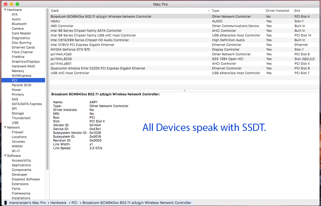

Mike Ranger Posted December 3, 2016 Share Posted December 3, 2016 Dear Forum mates.... this is a really helpful start for me.... I will do as advised but will take a couple of days for sure.... Aiii..... I never created my own SSDT.aml...... thats another challenge I did not forsee.... Well.... I guess figuring out these things is the fun part right? I read something about a PikerAlpha script for that.... I will investigate.... hopefully the script can be used without any further magic to be applied Cheers, Mike 1 Link to comment https://www.insanelymac.com/forum/topic/313296-guide-mac-osx-1012-and-1013-with-x99-broadwell-e-family-and-haswell-e-family/page/26/#findComment-2328422 Share on other sites More sharing options...

Fergarth Posted December 3, 2016 Share Posted December 3, 2016 Dear Forum mates.... this is a really helpful start for me.... I will do as advised but will take a couple of days for sure.... Aiii..... I never created my own SSDT.aml...... thats another challenge I did not forsee.... Well.... I guess figuring out these things is the fun part right? I read something about a PikerAlpha script for that.... I will investigate.... hopefully the script can be used without any further magic to be applied Cheers, Mike To generate your own SSDT, download the latest ssdtPRGen.sh beta by entering the following command in terminal: curl -o ~/ssdtPRGen.sh https://raw.githubusercontent.com/Piker-Alpha/ssdtPRGen.sh/Beta/ssdtPRGen.sh After the download is done, run these two commands on the terminal: chmod +x ~/ssdtPRGen.sh sudo ./ssdtPRGen.sh -x 1 Follow the instructions answering n, n. To access the generated ssdt.aml, open Finder and in menubar choose Go/Go to Folder and type: ~/Library/ssdtPRGen/ Mount EFI partition and copy the ssdt.aml to EFI/EFI/CLOVER/ACPI/patched. More info here: https://github.com/Piker-Alpha/ssdtPRGen.sh/blob/Beta/README.md To add freqvectors read this: https://github.com/Piker-Alpha/freqVectorsEdit.sh 1 Link to comment https://www.insanelymac.com/forum/topic/313296-guide-mac-osx-1012-and-1013-with-x99-broadwell-e-family-and-haswell-e-family/page/26/#findComment-2328464 Share on other sites More sharing options...
mfc88 Posted December 3, 2016 Share Posted December 3, 2016 In order to generate your SSDT, you can download the latest ssdtPRGen.sh beta by entering the following command in terminal: curl -o ~/ssdtPRGen.sh https://raw.githubusercontent.com/Piker-Alpha/ssdtPRGen.sh/Beta/ssdtPRGen.sh After the Sript donwload, run this in terminal: sudo ./ssdtPRGen.sh -x 1 Then follow the instructions answering N, N. Open Finder and in menubar choose Go/Go to Folder... Type ~/Library/ssdtPRGen/ to acess the generated ssdt.aml Mount EFI partition and copy the ssdt.aml to EFI/EFI/CLOVER/ACPI/patched. More info here: https://github.com/Piker-Alpha/ssdtPRGen.sh/blob/Beta/README.md To add freqvectors read this: https://github.com/Piker-Alpha/freqVectorsEdit.sh After you download (curl) you'll want to run this necessary command to make the file executable by the user (else, you'll get the "permission denied" error): chmod +x ~/ssdtPRGen.sh 1 Link to comment https://www.insanelymac.com/forum/topic/313296-guide-mac-osx-1012-and-1013-with-x99-broadwell-e-family-and-haswell-e-family/page/26/#findComment-2328498 Share on other sites More sharing options...

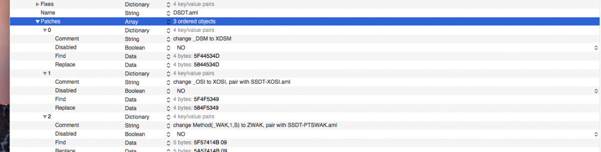

nmano Posted December 5, 2016 Author Share Posted December 5, 2016 #X99_Gold pack #X99 DSDT with sleep+SSDT with devices patches. #ACPI/DSDT/Patches and add DTGP in config.plist #Add your SSDT files in EFI(Make your Devices and patches) #Restart #Open MaciASL.app patch to DSDT /just compile and sleep #Drop your DSDT in EFI #Restart #Now DSDT and SSDT hack devices and make sleep. #I made X99_Injector LPC.kext this kext no need any LPC patch. #Don't forget to like posts #too many restart but Fixed. #test each ssdt (you have to rename api-path) #check your path (IOACPIPlane:/_SB/PCI0@0/HDEF@1b0000) #I made 18 SSDT #If you want SSDT with sleep ask rehapman He is king. #Enjoy. X99_Gold.zip 3 Link to comment https://www.insanelymac.com/forum/topic/313296-guide-mac-osx-1012-and-1013-with-x99-broadwell-e-family-and-haswell-e-family/page/26/#findComment-2329416 Share on other sites More sharing options...
Mike Ranger Posted December 5, 2016 Share Posted December 5, 2016 @nmano: Are you suggesting this is a universal solution for all X99 boards for 10.12? What do I need to consider for my setup if I go your path? Processor: i7 6900K Board: Asus Deluxe II X99 Graphics: Gigabyte 980Ti RAM: 2x 16 Gb DDR 4 SSD: Samsung 850 Evo 256 Gb Thanks, Mikel 1 Link to comment https://www.insanelymac.com/forum/topic/313296-guide-mac-osx-1012-and-1013-with-x99-broadwell-e-family-and-haswell-e-family/page/26/#findComment-2329554 Share on other sites More sharing options...
NeXtor Posted December 5, 2016 Share Posted December 5, 2016 I'm lost at line 4. I'm sorry but I'm a beginner on dsdt and co. let's start: #X99_Gold pack #X99 DSDT with sleep+SSDT with devices patches. #ACPI/DSDT/Patches and add DTGP in config.plist Should I include in my config.plist the following patches from your config.plist ?: DSDT Patches AddDTGP And FixTMR The Drop Tables DropOEM KextsToPatch KernelToPatch _________________________________________ #Add your SSDT files in EFI(Make your Devices and patches) #Restart Now in the efi folder which SSDT files I need to add? The only SSDT I have is that I generated for p and c states. MaciASL 1.4 can not open your SSDT files. Only MaciASL 1.3 succeeds but returns errors during processing in "external method". _________________________________________ #Open MaciASL.app patch to DSDT /just comfile and sleep #Drop your DSDT in EFI #Restart #Now DSDT and SSDT hack devices and make sleep. Should I apply the patch "X99_comfile and sleep" to original DSDT extracted with clover? Now, the new files into the efi folder overwriting the old? _________________________________________ #I made X99_Injector LPC.kext this kext no need any LPC patch. #Don't forget to like posts #too many restart but Fixed. #test each ssdt (you have to rename api-path) #check your path (IOACPIPlane:/_SB/PCI0@0/HDEF@1b0000) #I made 18 SSDT #If you want SSDT with sleep ask rehapman He is king. #Enjoy. X99_Gold.zip "X99_Injector LPC.kext" in the efi folder. How many things I did wrong if not all? 1 Link to comment https://www.insanelymac.com/forum/topic/313296-guide-mac-osx-1012-and-1013-with-x99-broadwell-e-family-and-haswell-e-family/page/26/#findComment-2329590 Share on other sites More sharing options...
Fergarth Posted December 5, 2016 Share Posted December 5, 2016 nmano notices more of DSDT, SSDT and MaciasL than we all together, but has the strange habit of dropping the bomb and then disappear lol. Do not misunderstand nmano, I was kidding, because it is not true and you have helped many of us to have a DSDT, but if you can, explain in more detail what we should do if you please. Greetings nmano 1 Link to comment https://www.insanelymac.com/forum/topic/313296-guide-mac-osx-1012-and-1013-with-x99-broadwell-e-family-and-haswell-e-family/page/26/#findComment-2329674 Share on other sites More sharing options...
