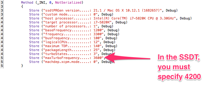

By the way, if I disable EIST, turbo is automatically turned off in the BIOS, as the turbo sub EIST
So I do not know your motherboard
In principle it is necessary to activate the turbo mode (can be CPU TJMAX for you)
Enable C6
In the SSDT, you must specify 4200
Так что я не знаю , ваша материнская плата
в принципе необходимо активировать режим турбо (может быть CPU TJMax для вас)
Enable C6
В SSDT, необходимо указать 4200
i changed to 4200 SSDT

you have to generate a new ssdt because your actual one has not turbo set as you want (@4200 I mean)
Also you have to set to 1 xcpm always in your ssdt
then, you could try my second config.plist with three patches active

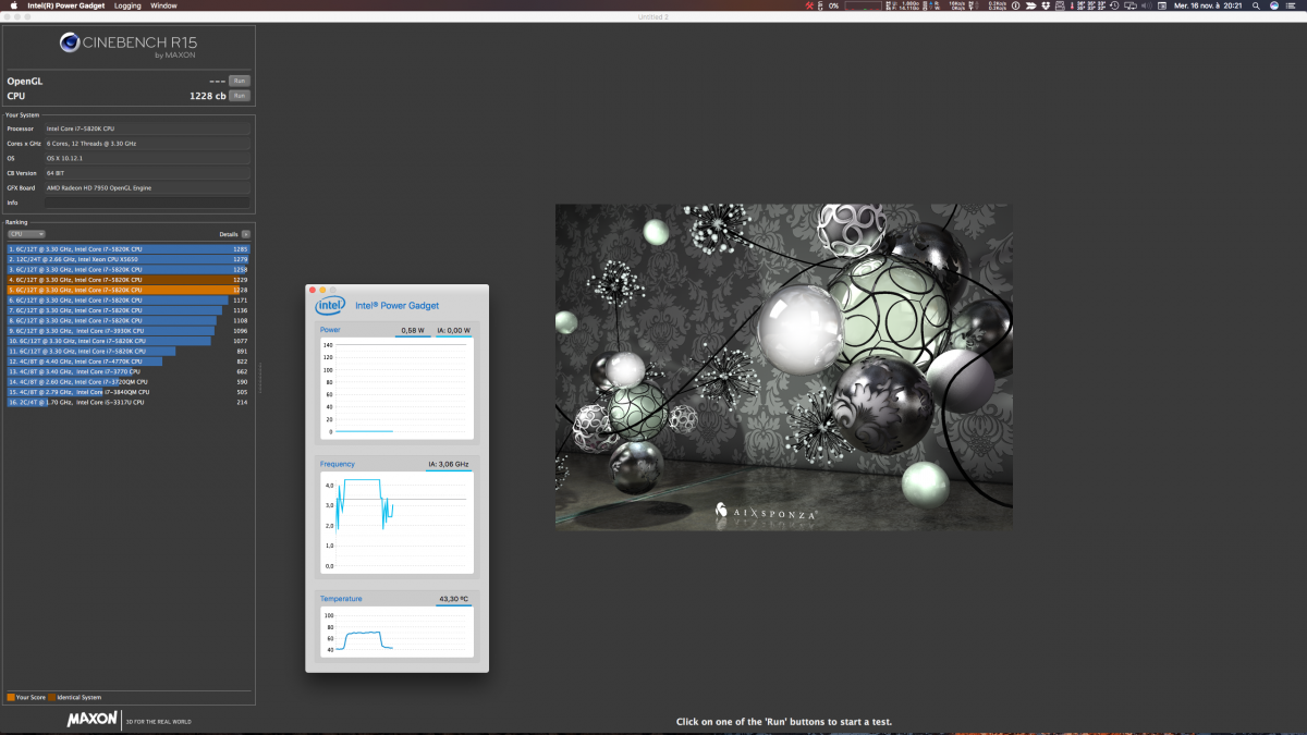

no work........ eist on/off, anyway
new generated ssdt - https://1drv.ms/u/s!ArLPkmcocLJiqHJEVCfeJPJ6qMKX
Probably have to write on the forum EVGA so they added functionality
this ssdt is good
try it with this config a do a test with Geekbench or similar
config.plist 2.zip
if it is not working I don't know why..
in this condition you should not have anymore applecpuintelpowermanagement listed in kextstat
have you also used frequency vector.sh always from piker alpha GitHub?
you could also try to start without ssdt and test it
but maybe all of this is unrelated

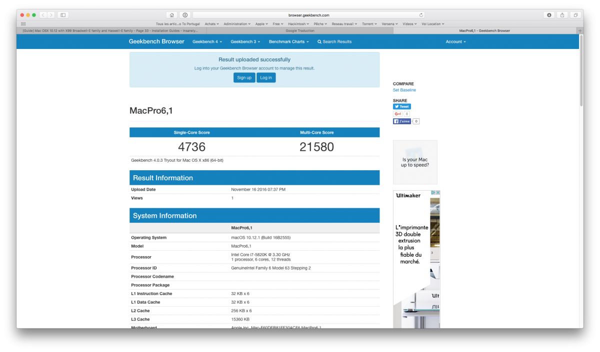

nullcpu = 3800 single, 16700 multi
with windows 1282
Yes i used last version frequency vector.sh for mac pro 6.1

yes, a little differences it is normal..no too much as I see here
but in windows you are at x48... with turbo
in my case difference from OS X and windows is about 10% less in osx
