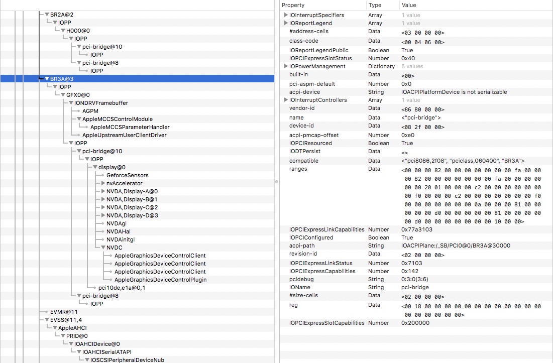

These are the files that I have developed. I still have some problems.
SSDT files in EFI: attachicon.gifpatched.zip
KEXT files in EFI: attachicon.gifkexts.zip
Config.plist: attachicon.gifconfig.plist.zip
This is what I see in pci cards: attachicon.gifpci.jpg
As you can see the video card is not there, as well as other devices

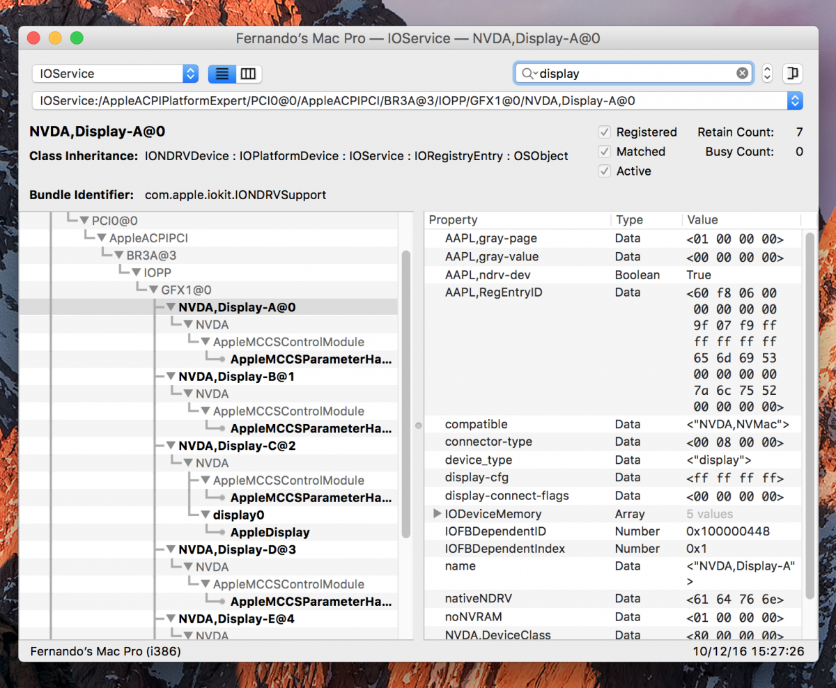

But PCI Cards is empty. Only if I change BR3A.GFX0 / _ADR from Zero to 0x00050000 it recognizes the cards except the video card...

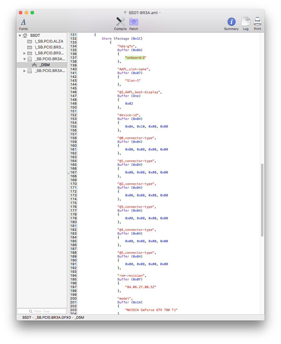

Remove All SSDT
Try this
SSDT-BR3A.aml.zip
Remove All SSDT
Try this
PCI Cards empty.

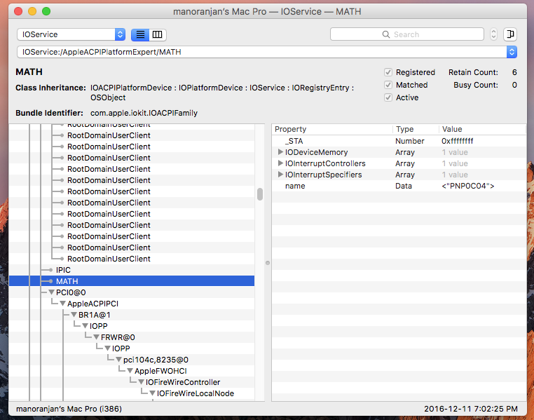

#Patch MATH
#patch over your DSDT
# Maintained by:N.Mano
#MATH
into device label FPU set_label begin MATH end;
into_all all code_regex FPU replaceall_matched begin MATH end;
nmano this patch acts on what?
Its like original apple.

I tried the first time with a kext already compiled and it did not work on my system. I only managed it to work, when it was compiled by me with Xcode :yes:
I'm trying everything but the video card will not be recognized properly.
I changed the SSDT / Device to GFX0 or GFX1 but nothing.
I also restored the "AppleGraphicsControl.kext" previously patched with AGDPFix and I added the Brumbaer's GDP Patch in config.plist
IOREG:
IOREG:
Original (extracted with Clover F4): attachicon.gifDSDT-ORIG.aml.zip
Patched with "x99_comfile and sleep + MATH": attachicon.gifDSDT.aml.zip
SSDT: attachicon.gifSSDT.aml.zip
SSDT-BR3A: attachicon.gifSSDT-BR3A.aml.zip

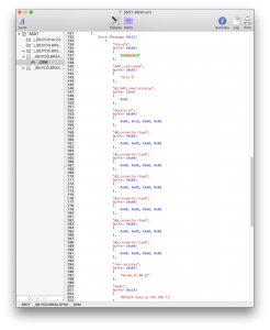

Try this DSDT and SSDT
Archive.zip

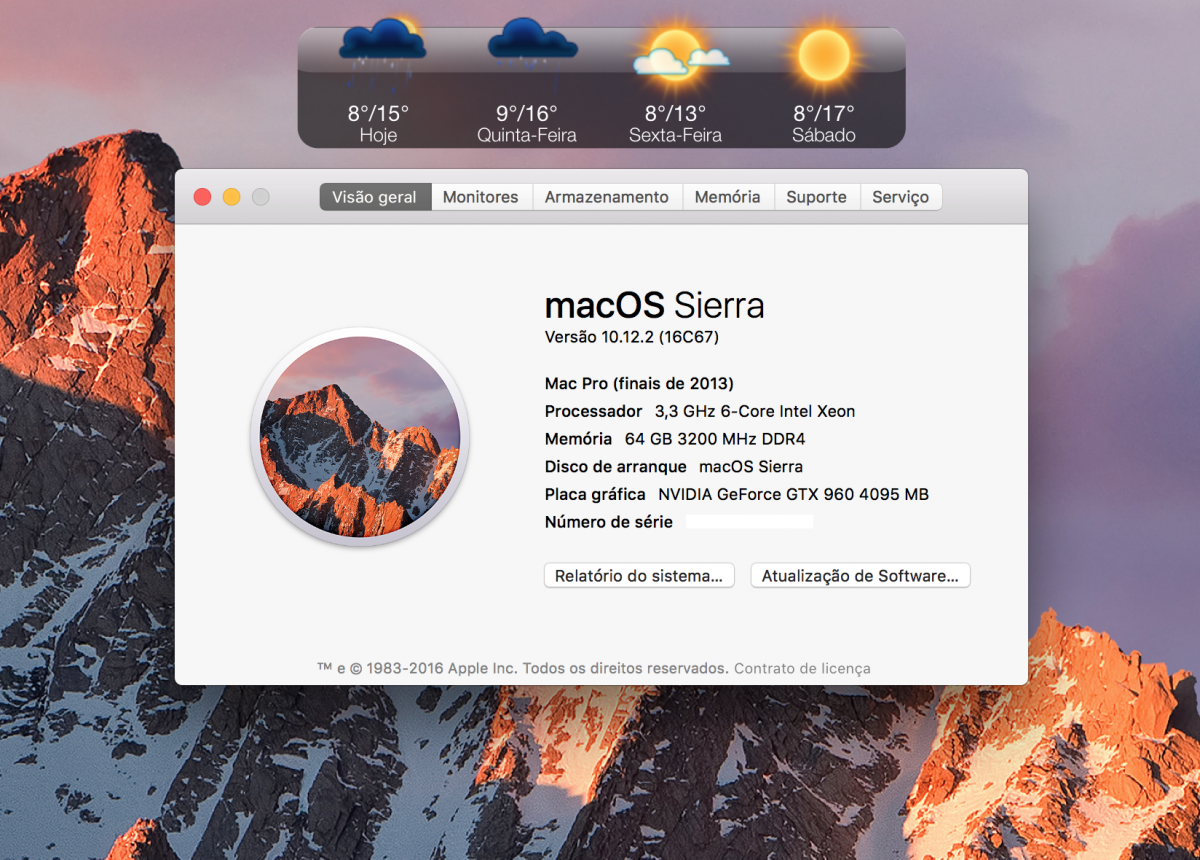

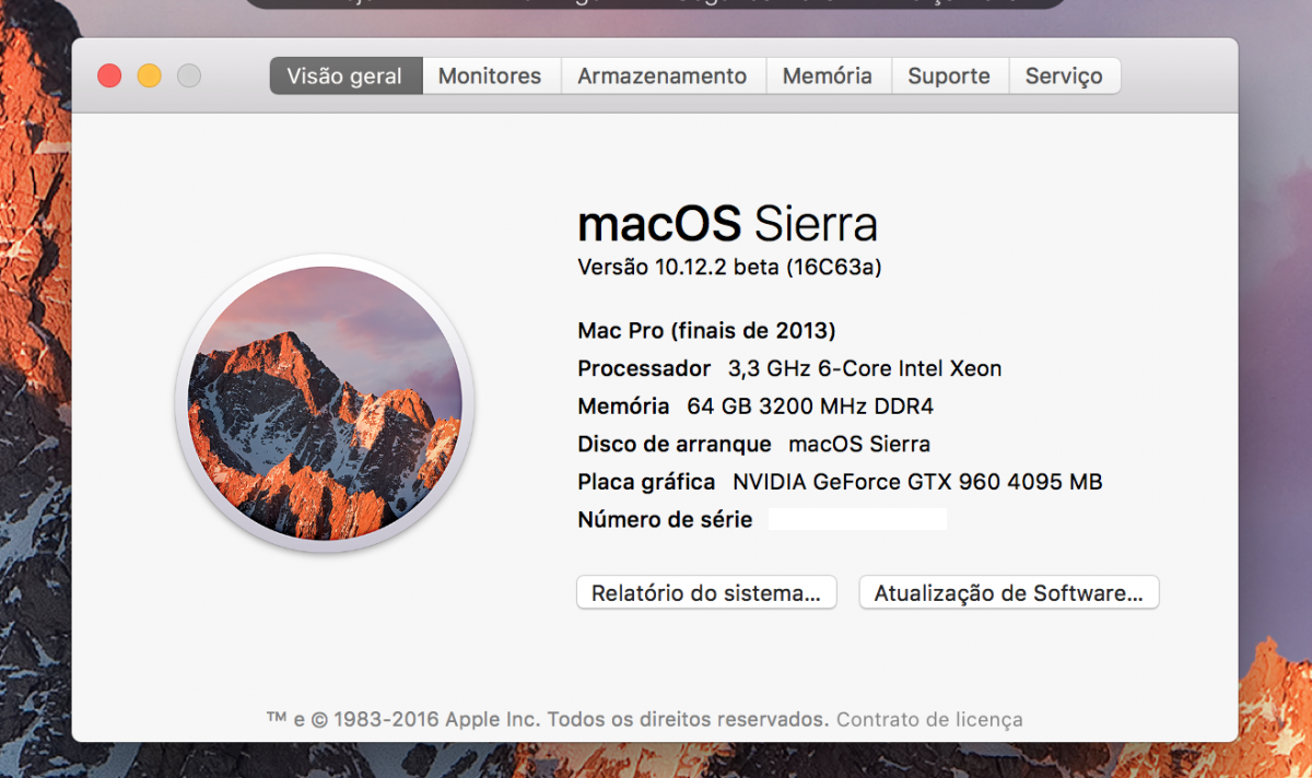

Update to 10.12.02 Final without any problem, failure or stress. After changing the GFX0 to GFX1, no patch was needed. Finished the black screen. I just did the Nvidia Web Driver update. For the updates to come out perfect, with everything working, I only need to solve the wifi problem with IO80211Family.kext but I'm already working on it and I think I have the solution.
Thanks PMheart :yes:
