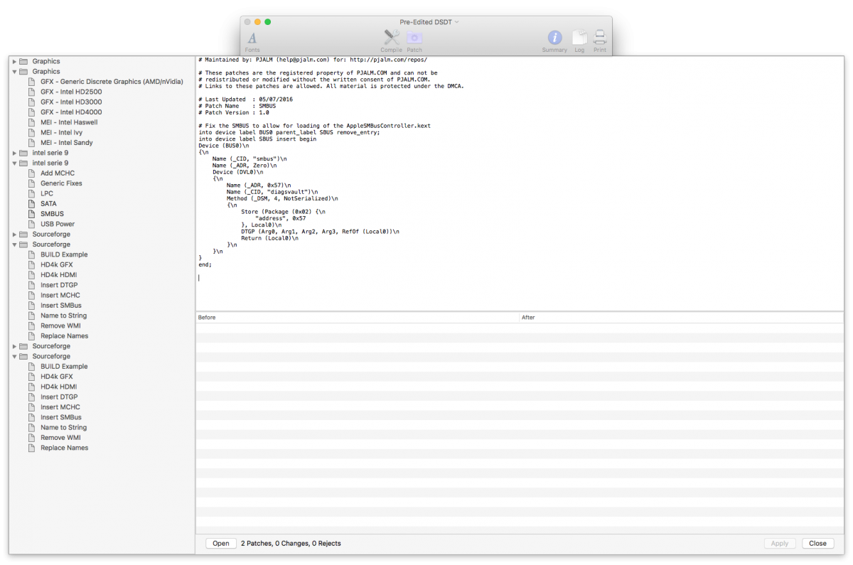

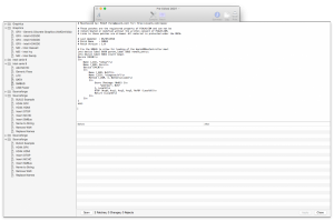

Here's how I create my DSDT

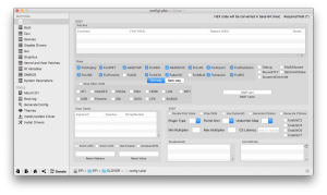

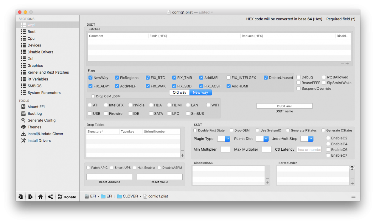

1 I use the automatic clover patch in the config.plist (pict 1 and 2)

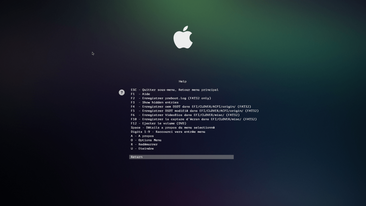

2 when I'm on clover, I save the patched DSDT (F5) (pict 3)

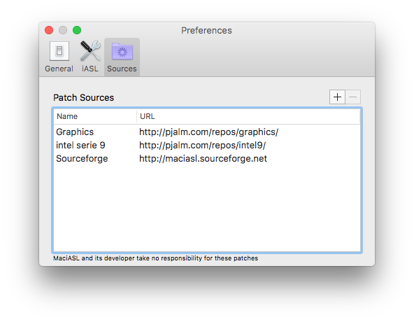

3 I use the patches in Maciasl (pict 4 and 5)

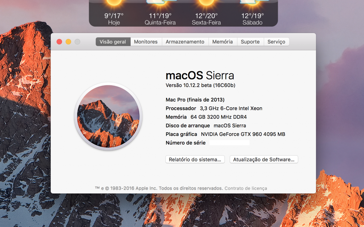

I've been analyzing the nmano´s plist, which has about 5 SSDTs and leaves me a little confused...

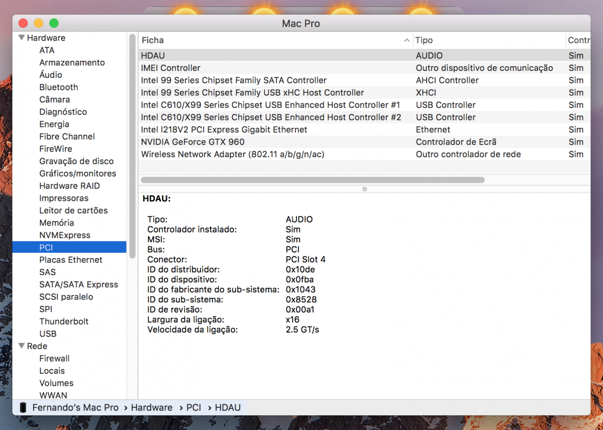

Okay, I have a DSDT that shows all the devices on "About this Mac - PCI".
After having done several tests, I concluded that my Sleep always works, but does not always wake up in the same way. Sometimes he wakes up and asks for the password and sometimes he restarts, and of course, I do not know the cause of this behavior!
So what should I do? Apply patches to Sleep on the DSDT I already have, or create a new SSDT just for sleep? And what specific patches should i apply?

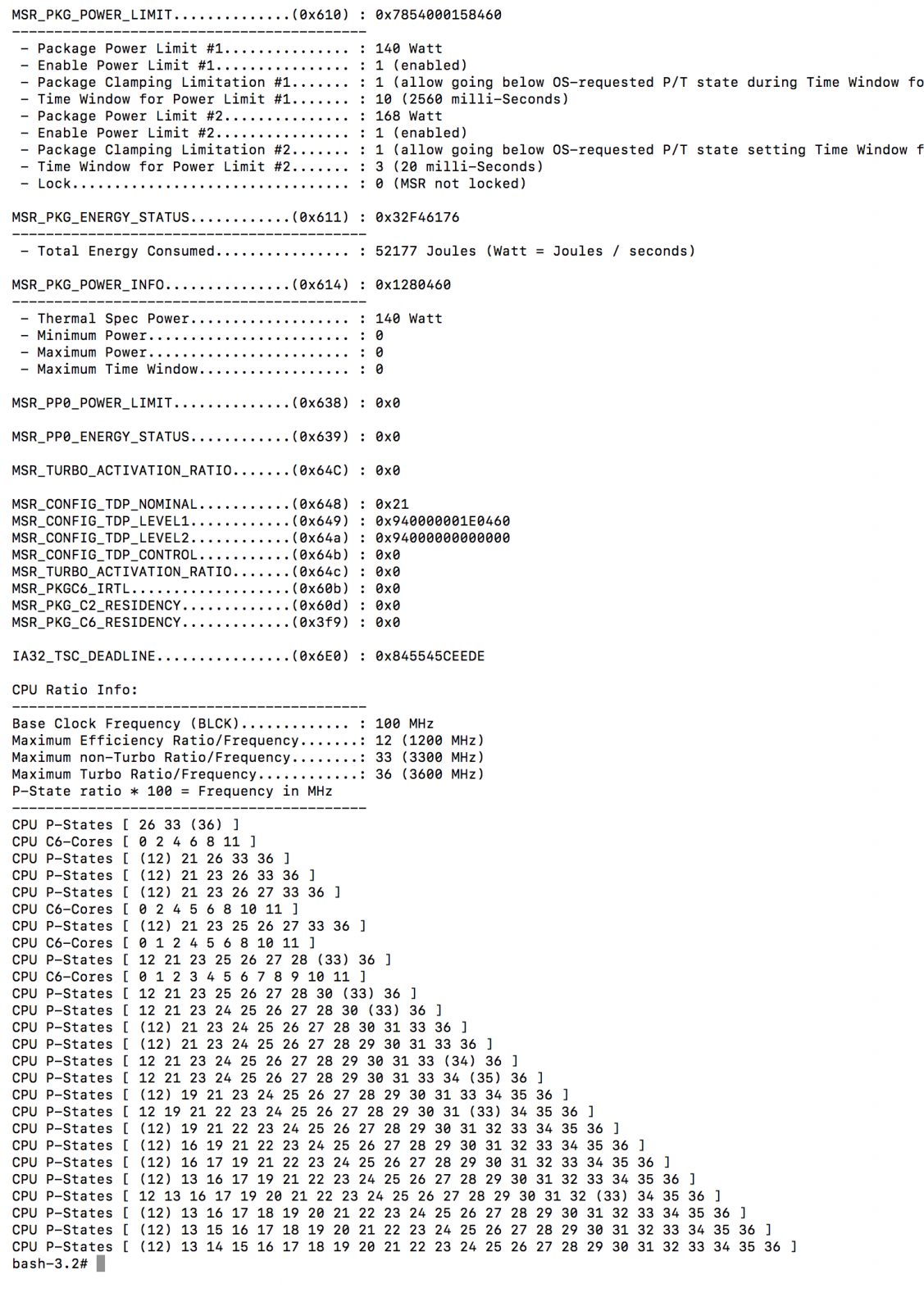

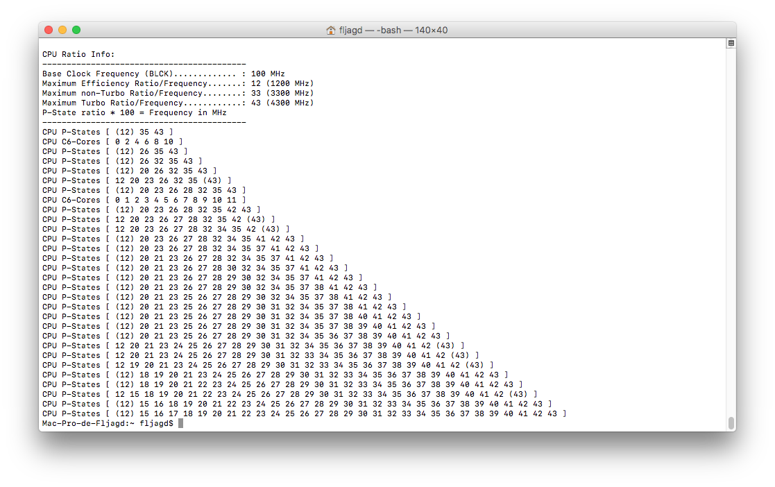

Got asked several times about AppleIntelInfo.kext and noticed that there really isn't any SUPER clear instructions on how to download, compile, and run AppleIntelInfo (to check CPU states), so here you go, start to finish:
1. Install Xcode from the App store: Click here
2. Download AppleIntelInfo source code: Click here
3. Unzip the AppleIntelInfo-master folder to your desktop, open it up, and double click AppleIntelInfo.xcodeproj (if you get a warning dialog box, just hit "Open")...
4. Click the "Build then run current scheme" button (looks like the play button or a sideways triangle; it'll be the button that is to the left of the square):
5. You'll notice that we have 3 warnings (you may not get any if you're running 10.11). Click the "warning" icon and you'll see some "issues" on the left. Click on the "Validate Project Settings" issue and a dialog box comes up, then click "Perform Changes":
6. The other two issues basically state that the target system (in my case, 10.12) is different than the compiled version (10.11). All you need to do is under "macOS Deployment Target," set it to 10.12 :
7. Click the "Build" button again and you should get a "Build succeeded" message without any errors:
8. To find where the file was saved. In Xcode, go to "Preferences", then go to the "Locations" tab and look under "Derived Data," then click the grey/white arrow icon:
9. This will open a folder, now you'll want to click "Derived Data", then "AppleIntelInfo-cxjl...", then "Build", then "Products", then "Debug". Inside Debug will be your compiled AppleIntelInfo.kext:
10. Place the compiled AppleIntelInfo.kext on to your desktop and run these commands (copy and paste) into a terminal window:
Type in your OS X login password after running this:
sudo -s
Then...
chown -R 0:0 ~/Desktop/AppleIntelInfo.kext
chmod -R 755 ~/Desktop/AppleIntelInfo.kext
kextload ~/Desktop/AppleIntelInfo.kext
Run this command at least 10 times (once every 10 seconds--to make it quick, just hit the arrow up key on your keyboard to reload the last shell command):
cat /tmp/AppleIntelInfo.dat
What it should look like:
After the 10th time or so you'll notice the C and P-States will stop populating:
