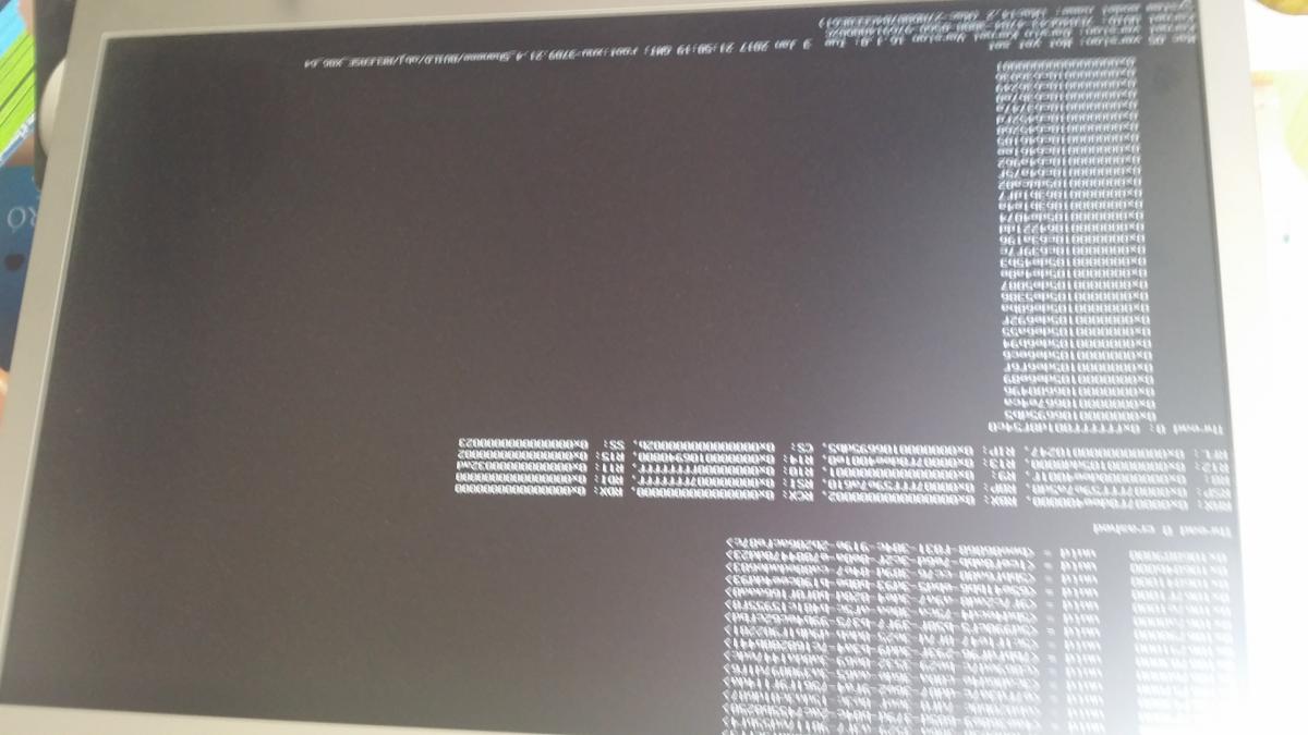

Haskasael Dominus Posted January 10, 2017 Share Posted January 10, 2017 Can someone with FX please test. I know it doesn't work on older CPUs yet. Shaneee with you kernel I have KP using USB ports, ( usb 3.0, 2.0 1.0) Link to comment https://www.insanelymac.com/forum/topic/312714-amd-macos-1012x-sierra-kernel-testing-release-for-help-use-the-help-topic/page/20/#findComment-2347427 Share on other sites More sharing options...
spakk Posted January 10, 2017 Share Posted January 10, 2017 Shaneee with you kernel I have KP using USB ports, ( usb 3.0, 2.0 1.0) The structure of Shaneee's source differs massively to the previous amd kernel sources and possibly also to bronya's source structure. It is my opinion, you should install and test Shaneee's kernel, which is very close to built on a original vanillia kernel, on a freshly installed and unchanged macos version. Do not make modifications in S/L/Extensions. For USB Slots problems, use only the USB drivers from rehabman or a modified dsdt.aml Edit: The drivers that can cause boot problems on amd cpus were suppressed by shane in the source, my opinion. If a problematic driver should lead to boot problems, remove this driver step by step. 1 Link to comment https://www.insanelymac.com/forum/topic/312714-amd-macos-1012x-sierra-kernel-testing-release-for-help-use-the-help-topic/page/20/#findComment-2347442 Share on other sites More sharing options...
lucky5 Posted January 10, 2017 Share Posted January 10, 2017 Shaneee with you kernel I have KP using USB ports, ( usb 3.0, 2.0 1.0) I am getting the same error randomly while opening a folder or while opening system preference etc and yesterday I accidentally removed usb without ejecting it and the same KP error cropped up. I am using bronya's kernel. Link to comment https://www.insanelymac.com/forum/topic/312714-amd-macos-1012x-sierra-kernel-testing-release-for-help-use-the-help-topic/page/20/#findComment-2347458 Share on other sites More sharing options...

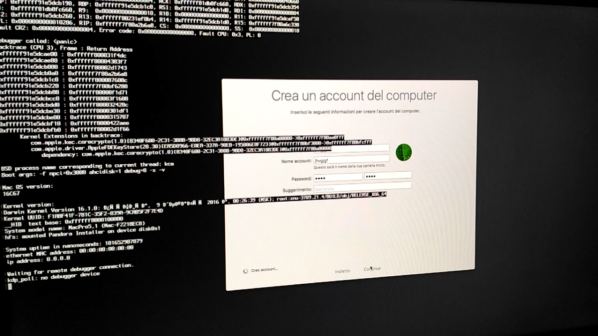

Dude6688 Posted January 13, 2017 Share Posted January 13, 2017 Some weeks ago i properly installed Sierra 10.12.2 on my AMD pc, but unfortunately my hard disk burned out. Today I successfully reinstalled Sierra on a new HD but after creating the personal account during the first setup I got this KP. I hope you can help me, thanks in advance. Link to comment https://www.insanelymac.com/forum/topic/312714-amd-macos-1012x-sierra-kernel-testing-release-for-help-use-the-help-topic/page/20/#findComment-2348916 Share on other sites More sharing options...
lucky5 Posted January 14, 2017 Share Posted January 14, 2017 Some weeks ago i properly installed Sierra 10.12.2 on my AMD pc, but unfortunately my hard disk burned out. Today I successfully reinstalled Sierra on a new HD but after creating the personal account during the first setup I got this KP. I hope you can help me, thanks in advance. Try this fix provided by Shanee https://www.dropbox.com/s/wf1t0wotg8cbvql/Account_KP_Fix.zip?dl=0 Link to comment https://www.insanelymac.com/forum/topic/312714-amd-macos-1012x-sierra-kernel-testing-release-for-help-use-the-help-topic/page/20/#findComment-2349038 Share on other sites More sharing options...

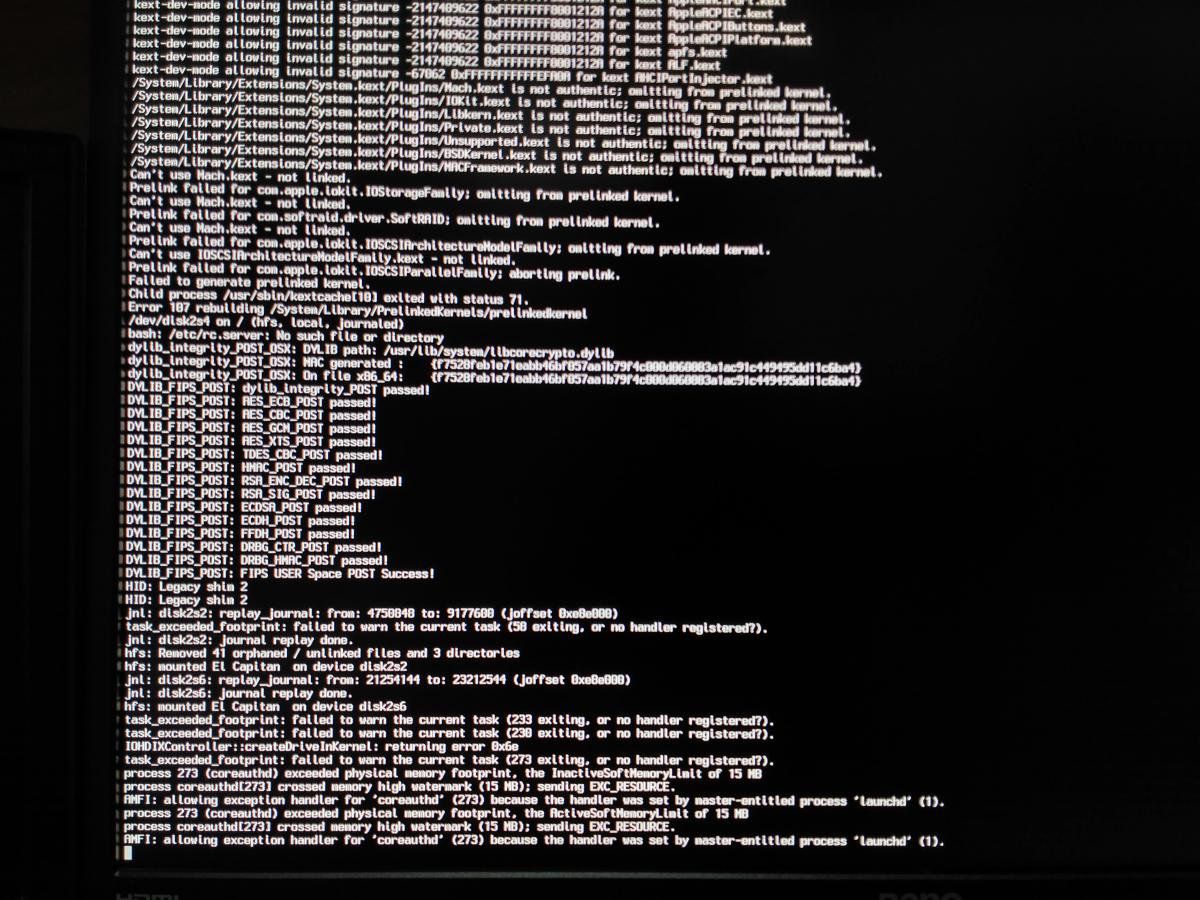

Dude6688 Posted January 14, 2017 Share Posted January 14, 2017 Try this fix provided by Shanee https://www.dropbox.com/s/wf1t0wotg8cbvql/Account_KP_Fix.zip?dl=0 With the fix I can't boot anymore into the first setup, and It's stuck at this point: Link to comment https://www.insanelymac.com/forum/topic/312714-amd-macos-1012x-sierra-kernel-testing-release-for-help-use-the-help-topic/page/20/#findComment-2349068 Share on other sites More sharing options...
spakk Posted January 14, 2017 Share Posted January 14, 2017 With the fix I can't boot anymore into the first setup, and It's stuck at this point: Dude6688 You have problems with the build of the prelinked kernel, read the lines in your boot message on the picture Hello people, please take note of the basic rules and for such things, which use the help toppic, this site is intended exclusively for kernel developement and should not be filled with installation problems thanks for the understanding. I will move later some posts into the help toppic Link to comment https://www.insanelymac.com/forum/topic/312714-amd-macos-1012x-sierra-kernel-testing-release-for-help-use-the-help-topic/page/20/#findComment-2349071 Share on other sites More sharing options...

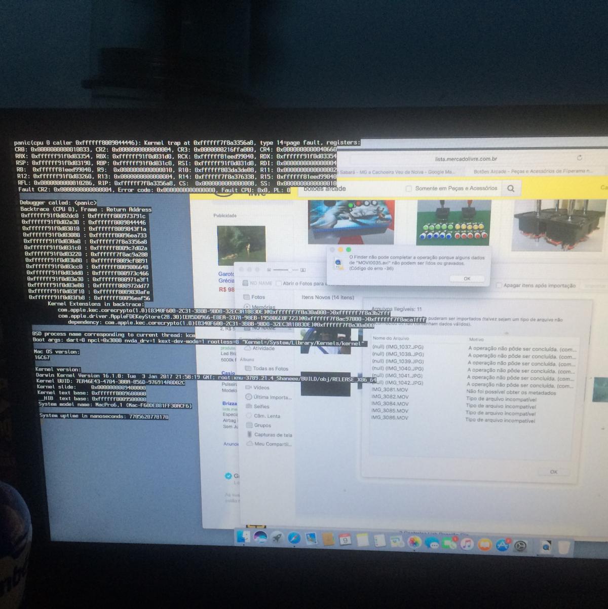

LordSith82 Posted January 15, 2017 Share Posted January 15, 2017 Can someone with FX please test. I know it doesn't work on older CPUs yet. Hello Shaneee, anche you check this? I've used your kernel but, in photos, when I use red eye correction the application closed. I attach my error log, maybe a kernel problem? Thank you. Link to comment https://www.insanelymac.com/forum/topic/312714-amd-macos-1012x-sierra-kernel-testing-release-for-help-use-the-help-topic/page/20/#findComment-2349951 Share on other sites More sharing options...
Shaneee Posted January 15, 2017 Share Posted January 15, 2017 Try this kernel. Built against the new 10.12.2 sources, Shaneee_10_12_2.zip 5 Link to comment https://www.insanelymac.com/forum/topic/312714-amd-macos-1012x-sierra-kernel-testing-release-for-help-use-the-help-topic/page/20/#findComment-2350097 Share on other sites More sharing options...

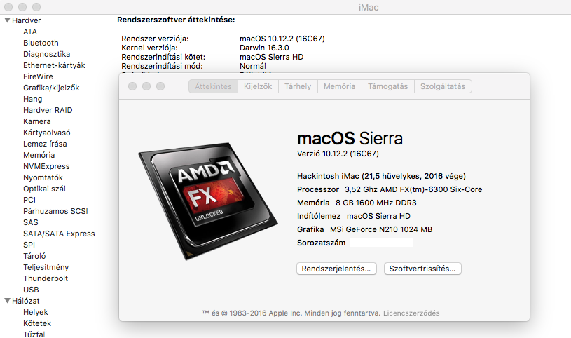

jsl Posted January 16, 2017 Share Posted January 16, 2017 Try this kernel. Built against the new 10.12.2 sources, Thanks for this new FX kernel which works perfectly at 10.12.3 in my FX-6300 hackintosh. It has better power management for wake-up from sleep than previous ones provided by you or Bronya. sysctl-10.12.3.txt 2 Link to comment https://www.insanelymac.com/forum/topic/312714-amd-macos-1012x-sierra-kernel-testing-release-for-help-use-the-help-topic/page/20/#findComment-2350236 Share on other sites More sharing options...
