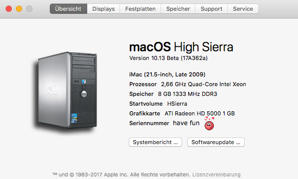

MacPeet Posted September 20, 2017 Author Share Posted September 20, 2017 @Deanor30 Yes, my Optiplex780 works with High Sierra and with APFS (SSD). @Aaronation Yes, my HD5450, HD6570, HD5770, ... all need the rollback of the four Kext from the Sierra. Link to comment Share on other sites More sharing options...
chris1111 Posted September 20, 2017 Share Posted September 20, 2017 @Deanor30 Yes, my Optiplex780 works with High Sierra and with APFS (SSD). dell780_HS_GM.png bios.png @Aaronation Yes, my HD5450, HD6570, HD5770, ... all need the rollback of the four Kext from the Sierra. I'm lucky in my bad luck because my Radeon HD 5450 2Gig is dead Lucky to have in Injector iGPU still have two other Radeon HD that works OOB only Inject ID Clover without any rollback kexts. 10.6 to 10.13 I have one ASUS Radeon HD 5450 1 Gig and one Visontek 5450 512 mb working I put it when I want to use Snow Leopard EDIT** My only issue with the Radeon HD 5450 is the sleep and wake I try everything possible The good news now with SSDT patch method my two GPU works on Dual Display with the Radeon 5450 Link to comment Share on other sites More sharing options...

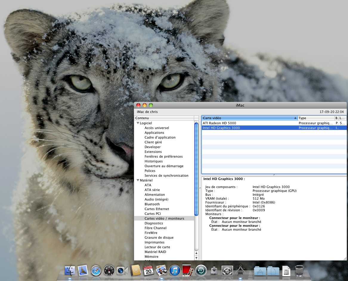

chris1111 Posted September 21, 2017 Share Posted September 21, 2017 No monitor attached to the HD3000? No on Snow Leopard only the Radeon HD 5450 attach but in Sierra and High Sierra the both monitor works Maybe I need to find the right SMBIOS for make it work in snow because the kext Intel HD 3000 is Load and enable Link to comment Share on other sites More sharing options...

chris1111 Posted September 21, 2017 Share Posted September 21, 2017 But that's your ATI card. How did you manage to enable HD3000 without attaching a display? Intel HD 3000 is injected by Clover long time ago commits by Sherlocks Just need Inject Intel My Dysplay is attaching in High Sierra and Sierra snow Leopard Only Radeon is attach because I think the Display Port HD 3000 is not enable in 10.6.8? But the Intel HD 3000 is load but the screen not open, only the screen of the Graphics card Link to comment Share on other sites More sharing options...
Guest ricoc90 Posted September 21, 2017 Share Posted September 21, 2017 Intel HD 3000 is injected by Clover long time ago commits by Sherlocks Just need Inject Intel My Dysplay is attaching in High Sierra and Sierra snow Leopard Only Radeon is attach Yeah I know, but for me the HD3000 only shows in macOS when I booted from it (with monitor attached) but in snow leopard you booted from the HD5450, right? But the HD3000 is showing in the display list in your screenshot. How is the performance in Sierra and high Sierra? For me when I boot with a monitor on both the HD3000 and GT 710, the GT 710 is having some glitches after awhile Verstuurd vanaf mijn E5533 met Tapatalk Link to comment Share on other sites More sharing options...
