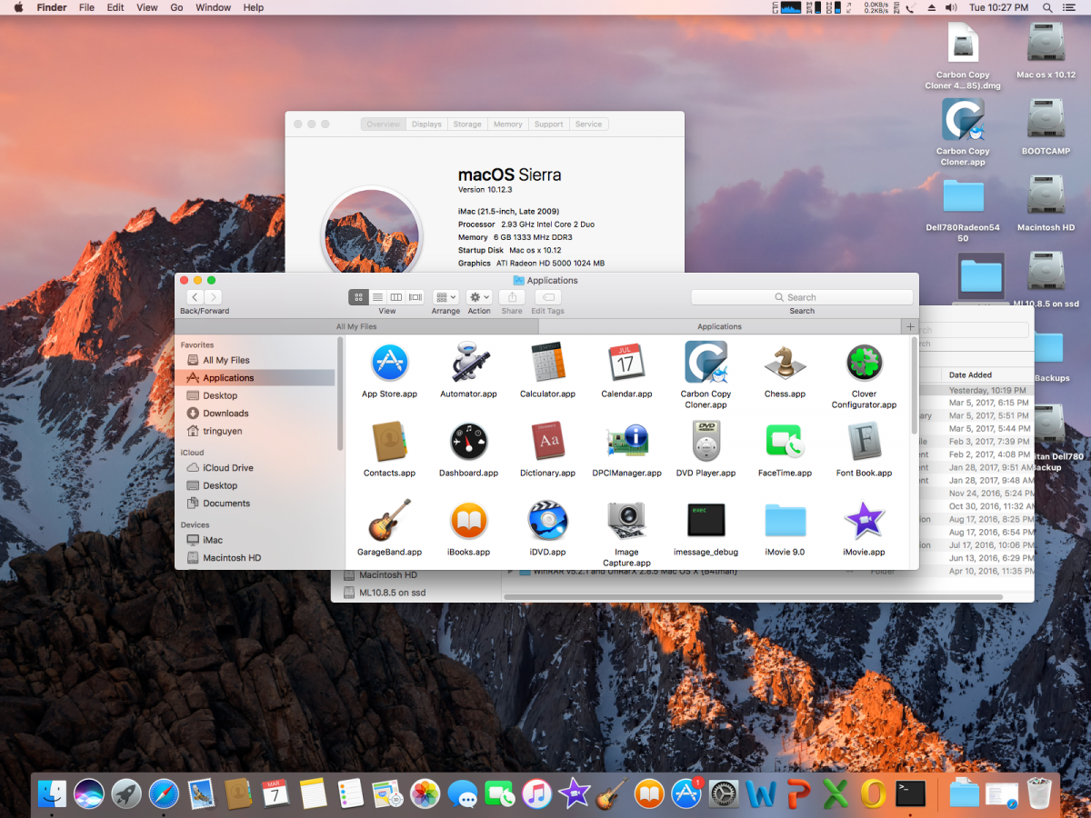

i have optiplex 780 SFF, Core 2 duo E8500, 8GB RAM HD5450 512MB. i have installed el capitan and everything works fine. now i have downloaded sierra from app store and followed the same guide for 780 but i am not able to install sierra. my pc get stuck at the start of installation screen. when i click on "disk utility" or "install mac os" nothing happens.
When switching from Capitan to Sierra:
Clover current version for Sierra support? Old Clover version of Capitan does not work with Sierra!
FakeSMC.kext current version for Sierra?
SIP disabled for installation (CsrActiveConfig in Clover on 0x67)?
Use your DSDT and config.plist from working Capitan for Sierra!
