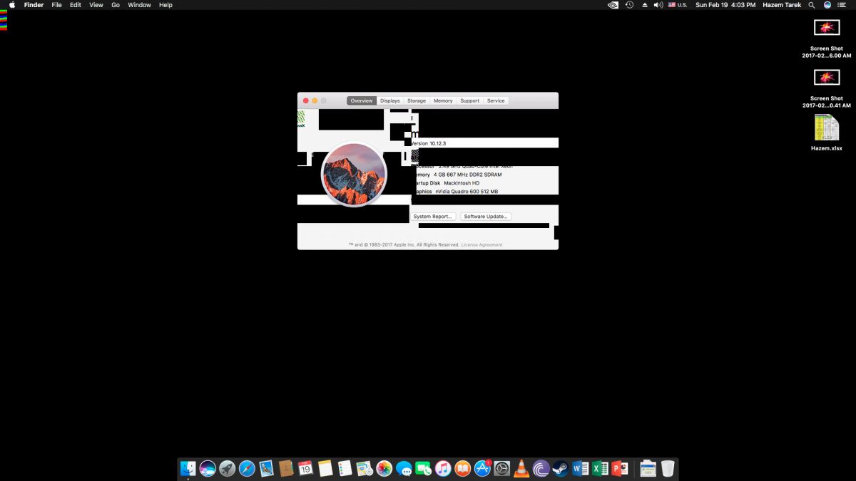

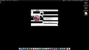

Hello guys. It was not so easy to install Sierra 10.12.2 on Optiplex 755, but I finally managed to finish this thing. This is my first hackintosh, which finally works and I can use everyday.
I have all of these things working :
Sound (VoodooHDA)
HD5450 1GB (DSDT)
E8400 C2D 3.0 GHz
4GB DDR2 667
500GB SEGATE SATA
Install Sierra following guide in 1 post but then use my pack for Optiplex 755.
Im using voodoohda, ive tried applehda and applealc and neither work. In VoodooHDA pack is readme file, I wrote how to remove noise and crackling in front green audio jack.
DSDT is probably form first post, but i had a lot of problems with bugs on startup, so Ive tried a lot of DSDT, this one is perfect. No bugs. Bug (cant click anything on screen) appeared only when wake from sleep, but I think its not the most important thing.
I cant remeber all of things made to config.plist, but as I say, everything is working.
With iMessage everyone knows what to do (real mac needed), if something changed pls tell me.
I attach my zip with all the files.
I used KextWizard, Clover 4003, Clover Vibrant.
Sierra Optiplex 755.zip

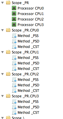

New version MaciASL can be ACPI6.1, DSDT-Editor can not do this.
DSDT for Optiplex always edit with DSDT-Editor!
Update:
10.12.4 DP Beta 3 16E163f works
I can change the layout id, compile and save with MaciASL, and layout id will show 15, and sound works.
But dsdt editor will not even open that same DSDT that i just edited.
Okay, I use the DSDT with layout ID12 in DSDT editor. Change 0C to OF. Hit compile, shows a bunch of errors, click fix errors.
Save as DSDT.aml. Then try to open with DSDT editor, and it will not open?
I never could understand DSDT editing. :(
Change 0C to OF??? Change 0C to 0F (zero F) !!!
post DSDT !
That was a Typing Error. I am changing 0C to 0F. I know hex code, but I can't type.   :lol:
If I edit with MaciASL it will work, but not open in dsdt editor.

@polyzargone
For the old computers (Optiplex) one does not need MaciASL with ACPI6.1.
I prefer working with DSDT editor, is clearer.
Only for newer hardware I work with MacASL and ACPI6.1.
No longer necessary for Optiplex. Here nothing will change in the direction of ACPI6.1 with Optiplex.
Once edited with MaciASL, then DSDT editor no longer works.
