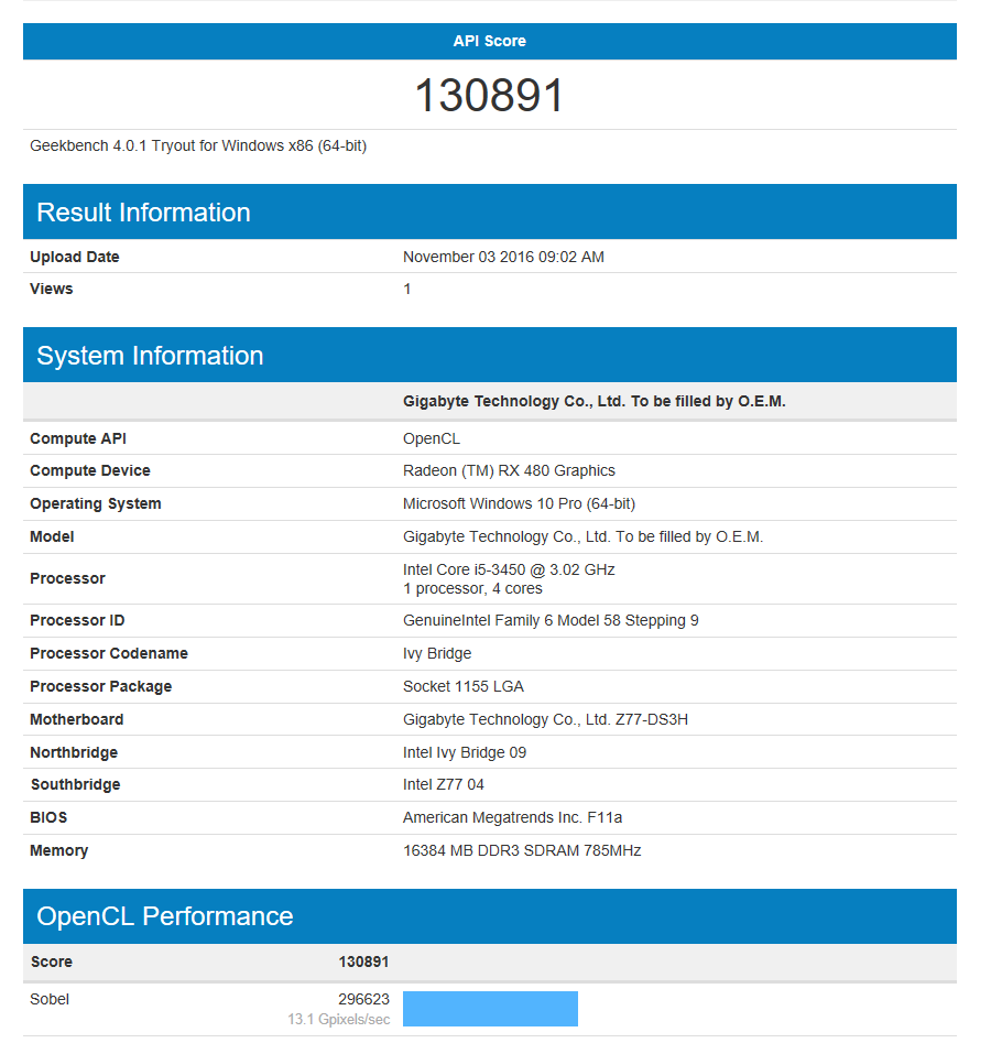

MattsCreative Posted November 2, 2016 Share Posted November 2, 2016 Try to run a compute benchmark on geekbench 4 and you will see... My RX480 does 93.000 on Mac OS and 125.000 on windows, so there is a big difference Cattura.PNG ya that is a bit low my 290x gets 169k https://browser.primatelabs.com/v4/compute/188880 Link to comment https://www.insanelymac.com/forum/topic/312582-amd-polaris-ids-on-sierra-high-sierra/page/10/#findComment-2312805 Share on other sites More sharing options...

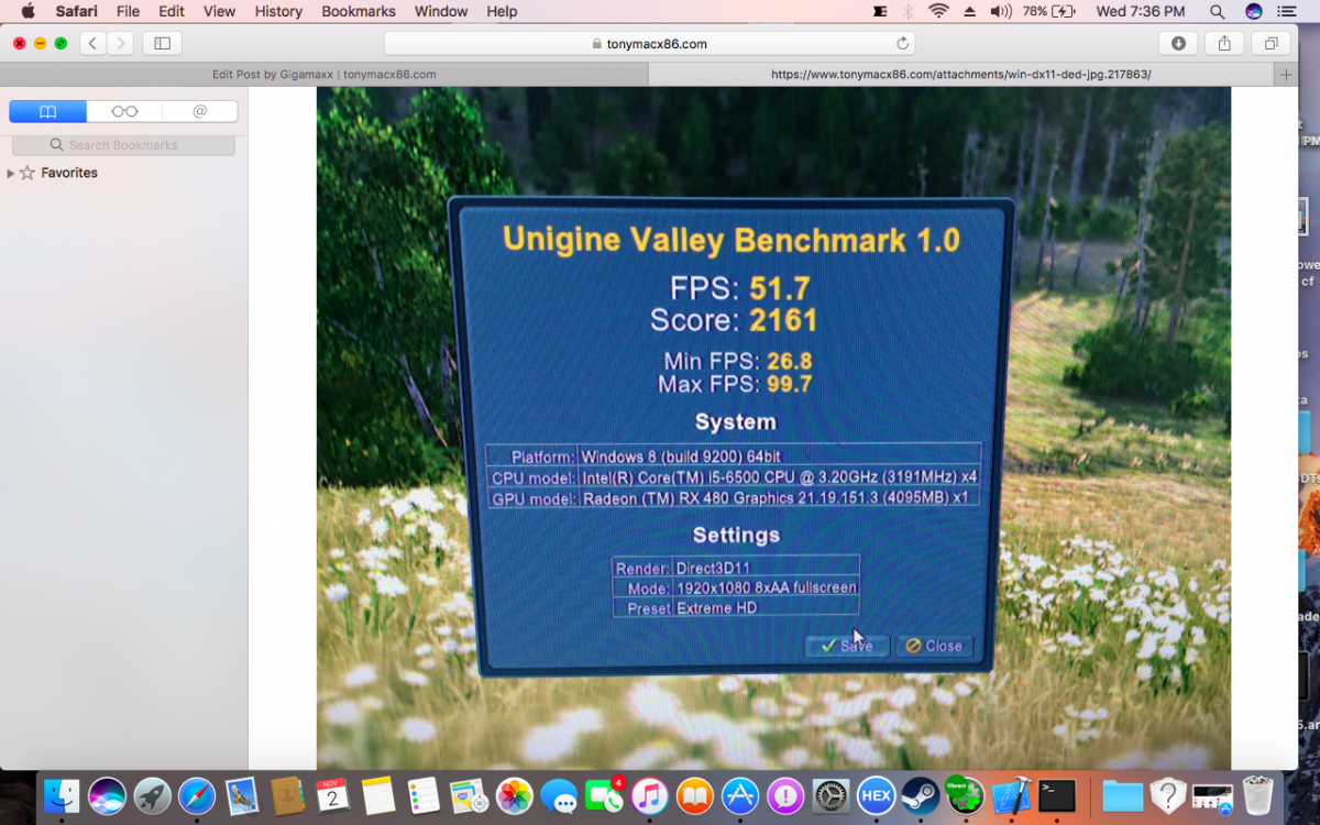

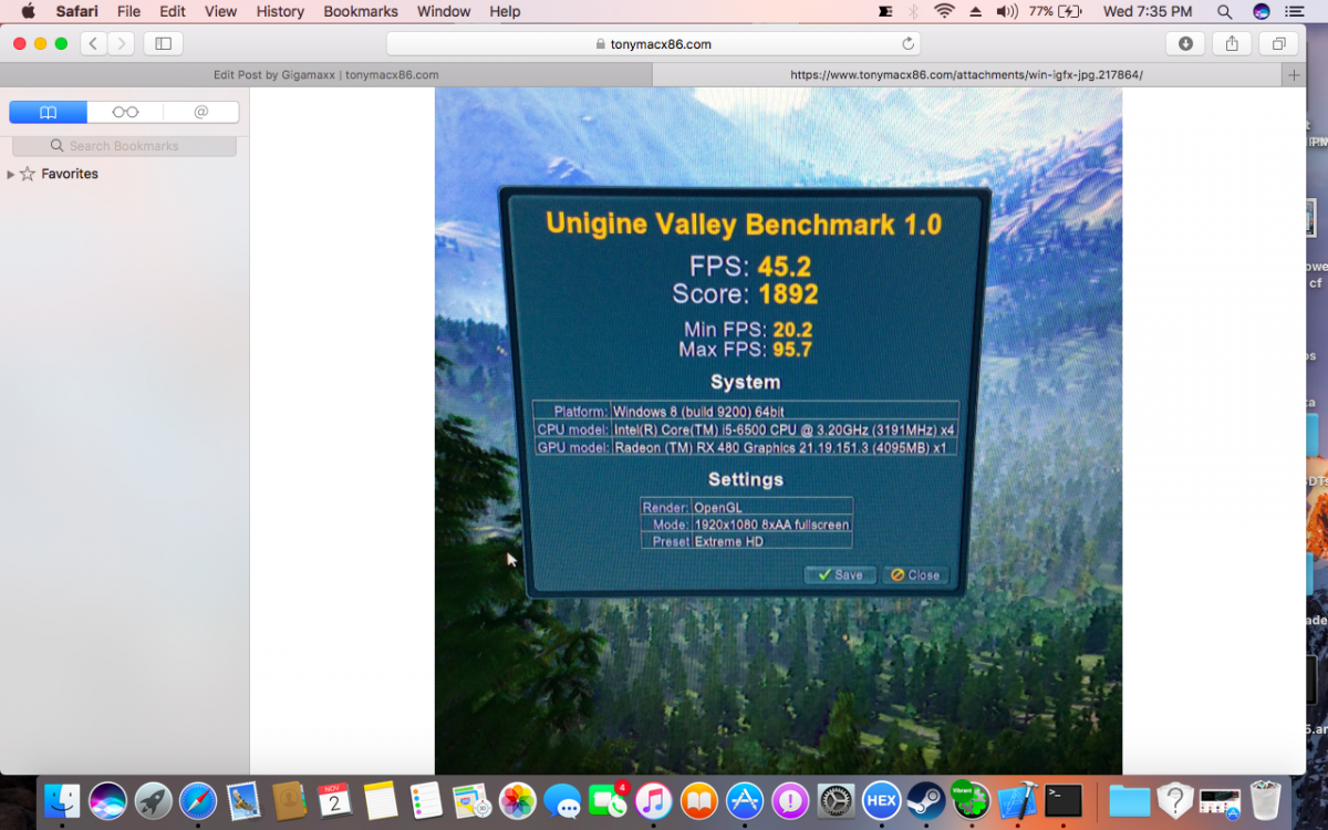

Gigamaxx Posted November 2, 2016 Share Posted November 2, 2016 Matteo, of course it "works", but not the right way And if you do a benchmark you will see low scores, because the GPU is not working properly. If you set your windows RX 480 up with integrated graphics and run the same benchmarks in open GL your scores will be very close. I posted comparative benchmarks and there was 40-50 point difference between a "Working Card" as you would call it in windows and the sierra "working card" that I mention. I ran a 1830 in Sierra and 1875 in Windows in open gl. So to say it only has half a frame buffer 67ef, or baffin is baffling to me because my rx 460 should be matching these scores but it falls way below. So as far as working as well as it does in windows 10 with direct X12, no but comparing apples to apples it runs right up there with windows in Unigine Valley extreme hd in open Gl format which is what we're limited to in Sierra. If you're waiting for the all inclusive "working' definition that may never be as it also effects other "working" AMD cards in Sierra. Nvidia cards are also having trouble in Sierra are they not? In fact, HD 530 has issues, Hd 4600 many graphics are not "Working" according to your high standard. From the list I provided, can you get an MSI 480 to even work nominally with metal, an Asus? Do you have a list of "Dysfunctionally working cards" in Sierra? This list will help people that want to try an RX in Sierra, and if they buy a Gigabyte or Asus 480 they may get frustrated because nobody mentioned a lack of compatibility. I started another thread but you moved it so where do I post? I remember you telling me that there was no Polaris 10 in sierra, and that the Baffin frame buffer was totally developed only to see the 4100ket show up a week later. Vega10 is now here as well in the 9500ControllerKext. I really can't wait to get a vega card "working" so you can tell me its not. If I didn't know better I would think you don't want RX cards to work so you're prior predictions can be taken as correct. I don't care about being riight or wrong, no progress was ever achieved without mistakes and more importantly admitting them. Can you? I bid you all ado! 1 Link to comment https://www.insanelymac.com/forum/topic/312582-amd-polaris-ids-on-sierra-high-sierra/page/10/#findComment-2312851 Share on other sites More sharing options...

Gigamaxx Posted November 2, 2016 Share Posted November 2, 2016 Working for me with modified AMDRadeonX4100.kext and baffin framebuffer in clover config What brand and model if you could please? you sir have everything 1000000% wrong let me help you out shall i : first the rx480 in os x on valley and heaven bench the same without or without the igpu as the igpu/rx480 do not stack in power or compute power next metal support does not and will never be depended on the brand of gpu it's all hardware and last please don't make these half assed post just don't .....please Do you know of anyone with a semi, or partially metal supported Gigabyte or asus rx 480? There are some cards that have not been able to get metal support with the kext change, can you disprove this? Nice of you to chime in though, do you have a RX card in testing? Link to comment https://www.insanelymac.com/forum/topic/312582-amd-polaris-ids-on-sierra-high-sierra/page/10/#findComment-2312913 Share on other sites More sharing options...

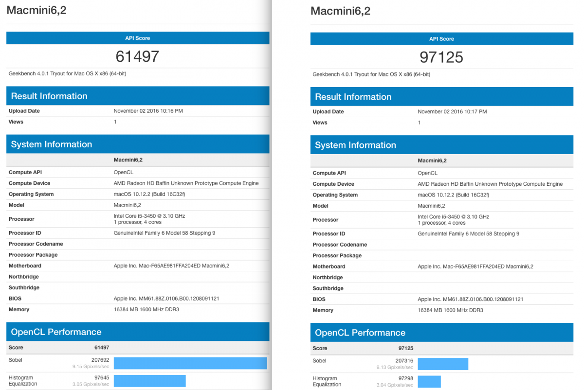

Nightf4ll Posted November 2, 2016 Share Posted November 2, 2016 Try to run a compute benchmark on geekbench 4 and you will see... My RX480 does 93.000 on Mac OS and 125.000 on windows, so there is a big difference Cattura.PNG damn, that seems hard.. its almost 30% difference. for some reason geekbench gives me inconsistent results, variating from 60 k to 97.. Link to comment https://www.insanelymac.com/forum/topic/312582-amd-polaris-ids-on-sierra-high-sierra/page/10/#findComment-2312925 Share on other sites More sharing options...
Ciro82 Posted November 2, 2016 Author Share Posted November 2, 2016 damn, that seems hard.. its almost 30% difference. for some reason geekbench gives me inconsistent results, variating from 60 k to 97.. As you can see, something is not working properly Link to comment https://www.insanelymac.com/forum/topic/312582-amd-polaris-ids-on-sierra-high-sierra/page/10/#findComment-2312928 Share on other sites More sharing options...
MattsCreative Posted November 2, 2016 Share Posted November 2, 2016 As you can see, something is not working properly ya on windows i get 190k so even for me it's a bit off Link to comment https://www.insanelymac.com/forum/topic/312582-amd-polaris-ids-on-sierra-high-sierra/page/10/#findComment-2312958 Share on other sites More sharing options...

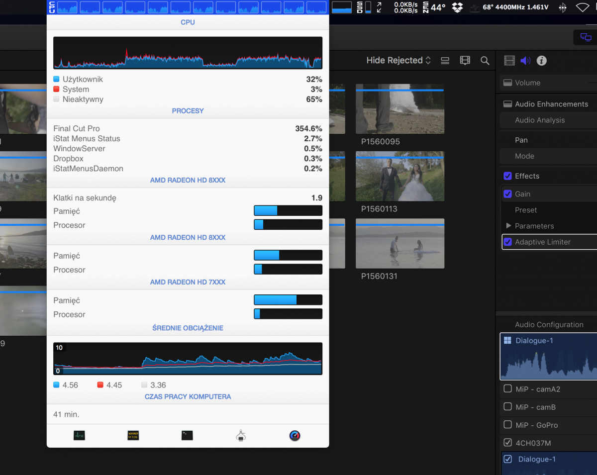

Matthew82 Posted November 2, 2016 Share Posted November 2, 2016 Little off-topic...When I updated system to 10.12.2 iStat menu start showing gpu processor usage when rendering project in FCPX (earlier only memory usage was show) Link to comment https://www.insanelymac.com/forum/topic/312582-amd-polaris-ids-on-sierra-high-sierra/page/10/#findComment-2312959 Share on other sites More sharing options...
MattsCreative Posted November 2, 2016 Share Posted November 2, 2016 Little off-topic...When I updated system to 10.12.2 iStat menu start showing gpu processor usage when rendering project in FCPX (earlier only memory usage was show) it's always done that for me i only use my gpu for video rendering 1 Link to comment https://www.insanelymac.com/forum/topic/312582-amd-polaris-ids-on-sierra-high-sierra/page/10/#findComment-2312962 Share on other sites More sharing options...

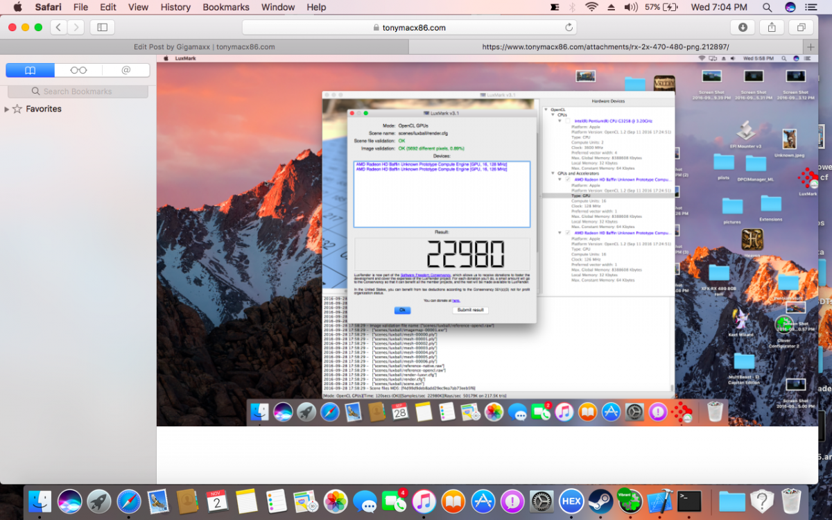

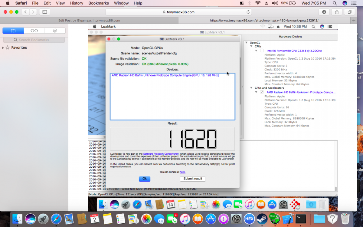

Gigamaxx Posted November 3, 2016 Share Posted November 3, 2016 damn, that seems hard.. its almost 30% difference. for some reason geekbench gives me inconsistent results, variating from 60 k to 97.. Screen Shot 2016-11-02 at 23.17.59.png Is it open CL? In open Cl Sierra only supports 16 compute units, whereas the RX 480 has 36. But this second pic is a crossfire of Sapphire RX 470 nitro and XFX RX 480 reference card. As you can see it doubled the score, but if all 36 compute units were running it would be much higher. In open GL the support is much more even. Windows DX11 Dedicated graphics card only Windows open GL Igpu/RX Sierra open GL igpu/RX There is a 3% difference in performance in open Gl formats between Windows and Sierra. 3% Vega 10 the AMD Fury Pro? Link to comment https://www.insanelymac.com/forum/topic/312582-amd-polaris-ids-on-sierra-high-sierra/page/10/#findComment-2313015 Share on other sites More sharing options...

Nightf4ll Posted November 3, 2016 Share Posted November 3, 2016 Is it open CL? In open Cl Sierra only supports 16 compute units, whereas the RX 480 has 36. But this second pic is a crossfire of Sapphire RX 470 nitro and XFX RX 480 reference card. As you can see it doubled the score, but if all 36 compute units were running it would be much higher. There is a 3% difference in performance in open Gl formats between Windows and Sierra. 3% so, there should be no difference between rx460 opencl tests?? Also, windows sounds more and more like the better option, too bad I installed it on the slower HD... os x development is really disappointing the last few years (since steve jobs died). Link to comment https://www.insanelymac.com/forum/topic/312582-amd-polaris-ids-on-sierra-high-sierra/page/10/#findComment-2313078 Share on other sites More sharing options...
