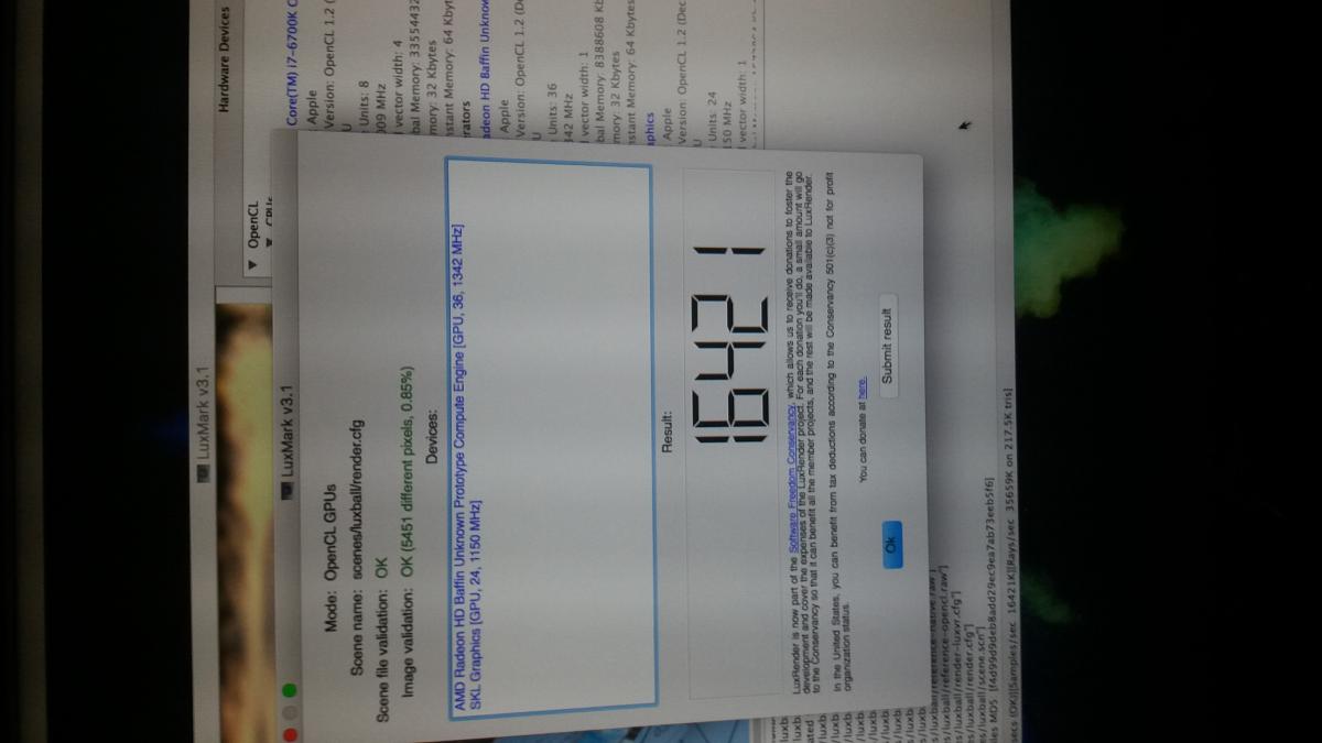

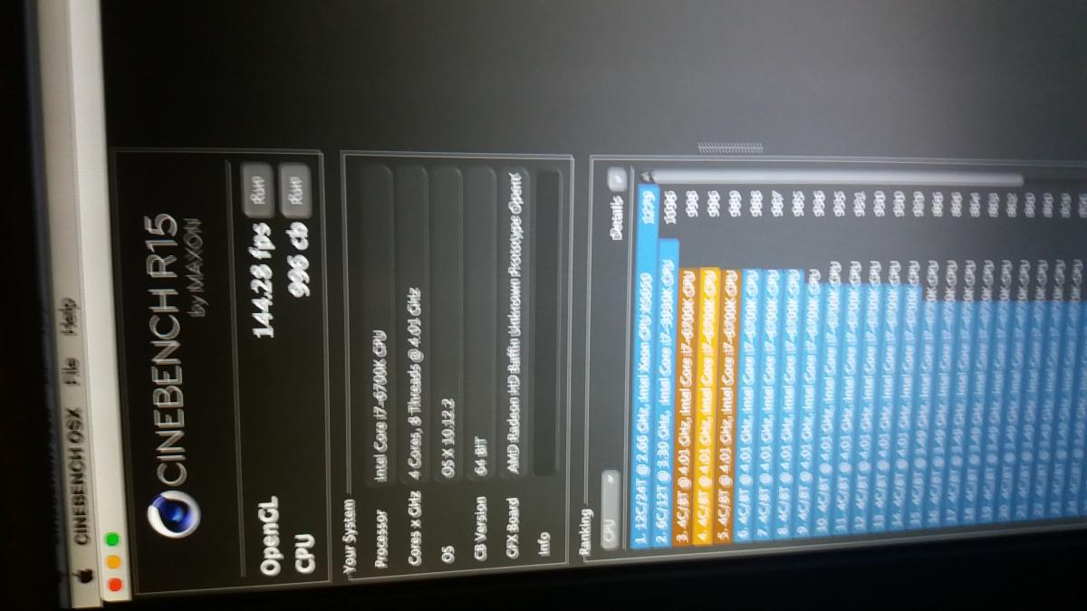

Pavo Posted January 27, 2017 Share Posted January 27, 2017 Updated to 10.12.4 removed the Power patch and RX 480 running very smooth using 0x67EF1002 fakeid 4 Link to comment https://www.insanelymac.com/forum/topic/312582-amd-polaris-ids-on-sierra-high-sierra/page/13/#findComment-2358422 Share on other sites More sharing options...

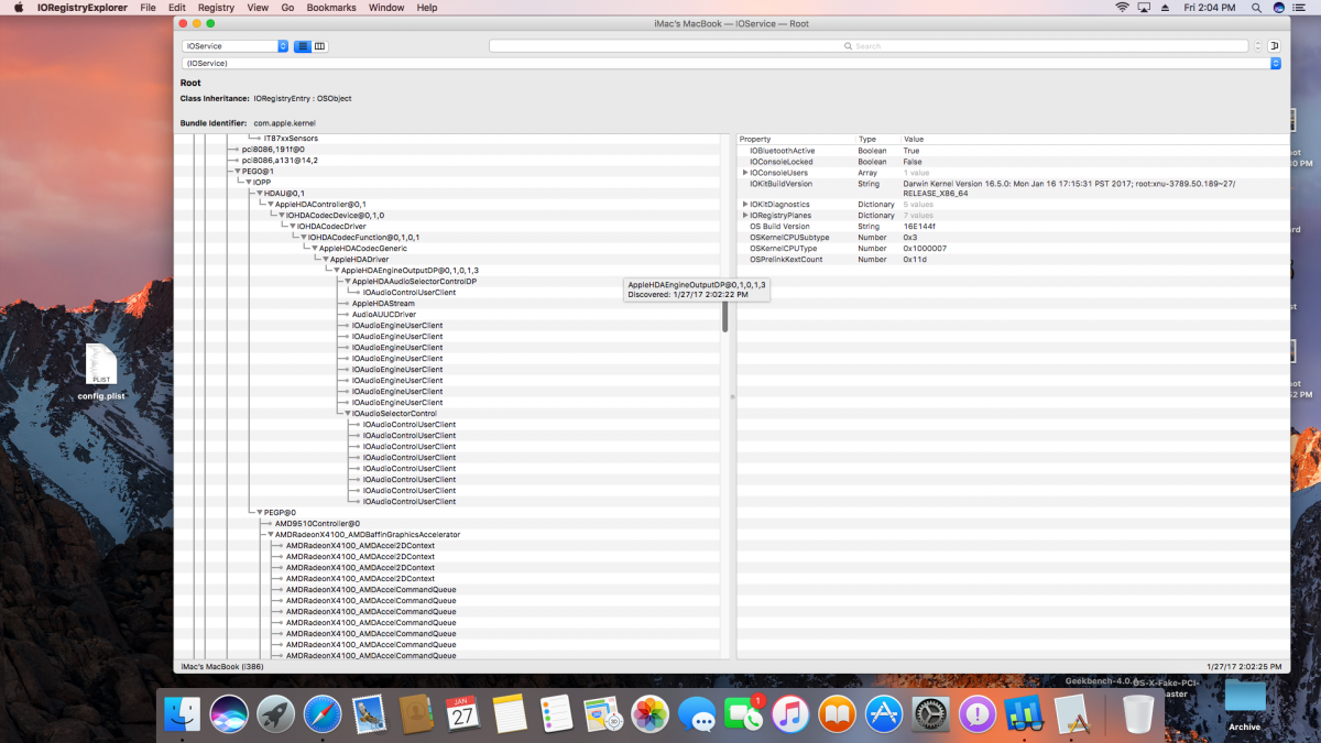

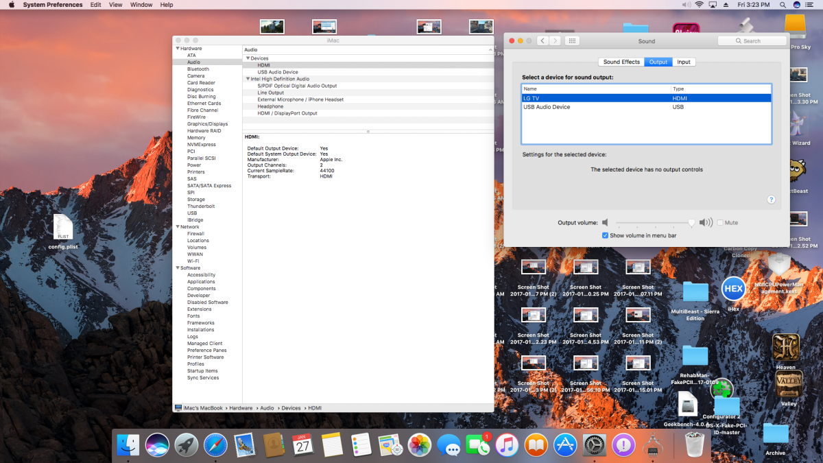

Gigamaxx Posted January 28, 2017 Share Posted January 28, 2017 I have sound through my HDMI port on my AMD XFX RX 480. It is running about one octave too low though, but its clear. Link to comment https://www.insanelymac.com/forum/topic/312582-amd-polaris-ids-on-sierra-high-sierra/page/13/#findComment-2358591 Share on other sites More sharing options...
