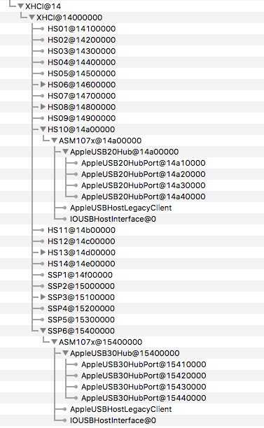

Try this with X99_Injector USB 3.kext
Change 15 Port Limit To 30 in XHCI Kext 10.12(99-series)
Find  00837D94 100F835A
Replace   00837D94 1F0F835A
Name     AppleUSBXHCIPCI
then some precisions
All USB ports are active (the power indicator is Alume)
Only the asmedia is not therefore support USB disk does not mount
the patch should be good but but not fully realized

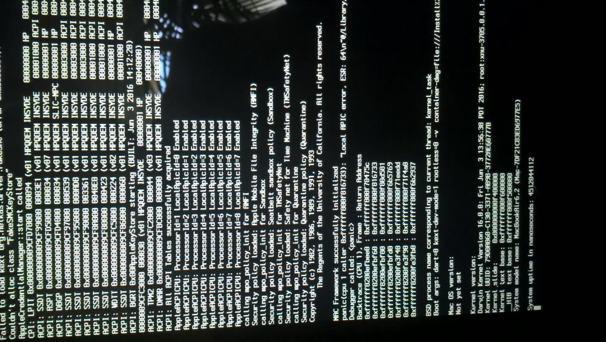

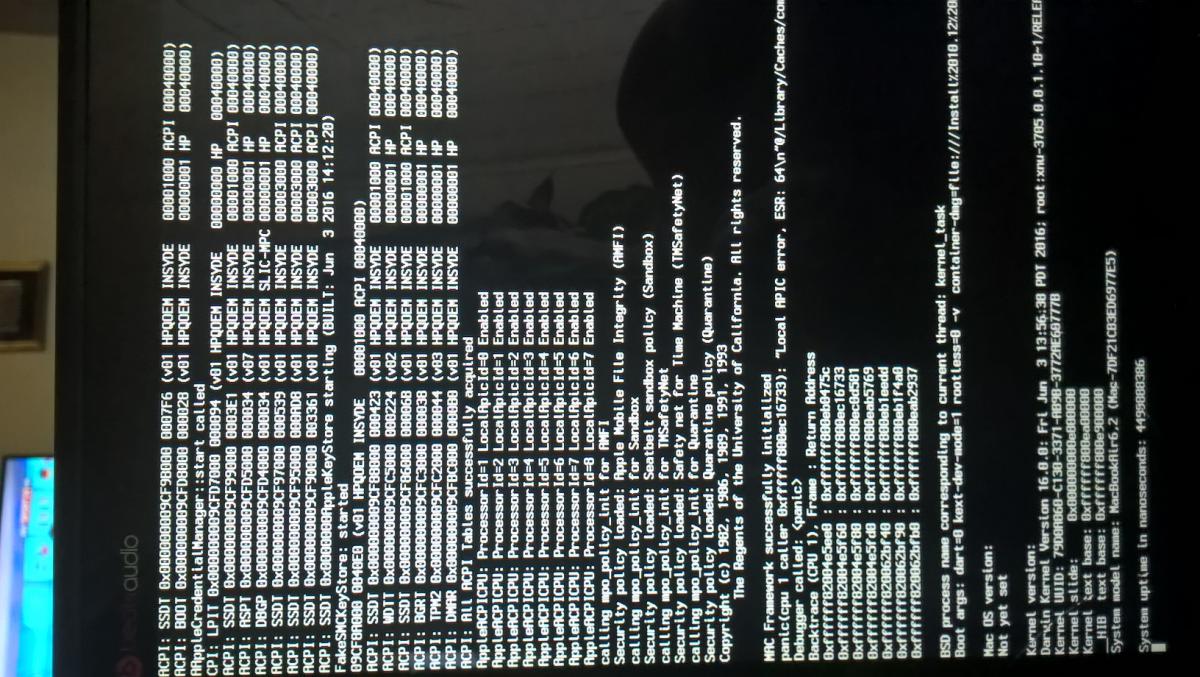

hi, thanks for suggestion,install with clover 3577 e fakesmc 2015-1230 rehabman
same result....panic ?????
Local APIC panic. Set config.plist/KernelAndKextPatches/KernelLapic=true.
