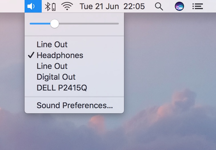

wern apfel Posted June 22, 2016 Share Posted June 22, 2016 Very cool the new volume slider, it supports inertia with apple devices we are talking about HDMI Audio here ? Are you sure ? Mine need a patch ... same as 10.11 (port 0x5 pipe 0x9 DP>HDMI) If the platform-id is matching your config you don't need any patch. Here HDMI-Audio works without a patch 3 Link to comment https://www.insanelymac.com/forum/topic/312521-pre-releases-macos-sierra/page/8/#findComment-2245193 Share on other sites More sharing options...
sebinouse Posted June 23, 2016 Share Posted June 23, 2016 Very cool the new volume slider, it supports inertia with apple devices vol_slider.jpg If the platform-id is matching your config you don't need any patch. Here HDMI-Audio works without a patch What audio method do you use ? Link to comment https://www.insanelymac.com/forum/topic/312521-pre-releases-macos-sierra/page/8/#findComment-2245346 Share on other sites More sharing options...
wern apfel Posted June 23, 2016 Share Posted June 23, 2016 What audio method do you use ? I'm not sure what you mean, i use a patched AppleHDA.kext and the platform-id, hda-gfx patch @dsdt If the platform-id is matching your config you don't need any patch. Here HDMI-Audio works without a patch With without any patch i mean no framebuffer patch, i'm sorry for the mistake. You have to try different platform-ids, not all have an HDMI connector-type. Link to comment https://www.insanelymac.com/forum/topic/312521-pre-releases-macos-sierra/page/8/#findComment-2245405 Share on other sites More sharing options...
sebinouse Posted June 23, 2016 Share Posted June 23, 2016 I'm not sure what you mean, i use a patched AppleHDA.kext and the platform-id, hda-gfx patch @dsdt With without any patch i mean no framebuffer patch, i'm sorry for the mistake. You have to try different platform-ids, not all have an HDMI connector-type. My HDMI audio is actually working fine with one framebuffer patch (+ platform-id & hda-gfx via SSDT injection) and AppleHDA untouched ! There might be different ways to achieve this ... Link to comment https://www.insanelymac.com/forum/topic/312521-pre-releases-macos-sierra/page/8/#findComment-2245425 Share on other sites More sharing options...

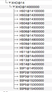

Fljagd Posted June 24, 2016 Share Posted June 24, 2016 with clover patch, there is the creation of additional usb but once on the desktop usb 3 are not all recognized is there a solution? Now I have two video cardshd 7950 oobgtx 960 with driver web Link to comment https://www.insanelymac.com/forum/topic/312521-pre-releases-macos-sierra/page/8/#findComment-2245580 Share on other sites More sharing options...

Luminadevapps Posted June 24, 2016 Share Posted June 24, 2016 with clover patch, there is the creation of additional usb but once on the desktop usb 3 are not all recognized is there a solution? Now I have two video cards hd 7950 oob gtx 960 with driver web Try this with X99_Injector USB 3.kext Change 15 Port Limit To 30 in XHCI Kext 10.12(99-series) Find 00837D94 100F835A Replace 00837D94 1F0F835A Name AppleUSBXHCIPCI Link to comment https://www.insanelymac.com/forum/topic/312521-pre-releases-macos-sierra/page/8/#findComment-2245610 Share on other sites More sharing options...

Fljagd Posted June 24, 2016 Share Posted June 24, 2016 Try this with X99_Injector USB 3.kext Change 15 Port Limit To 30 in XHCI Kext 10.12(99-series) Find 00837D94 100F835A Replace 00837D94 1F0F835A Name AppleUSBXHCIPCI it does not work Yet in all appears ioreg Link to comment https://www.insanelymac.com/forum/topic/312521-pre-releases-macos-sierra/page/8/#findComment-2245633 Share on other sites More sharing options...
