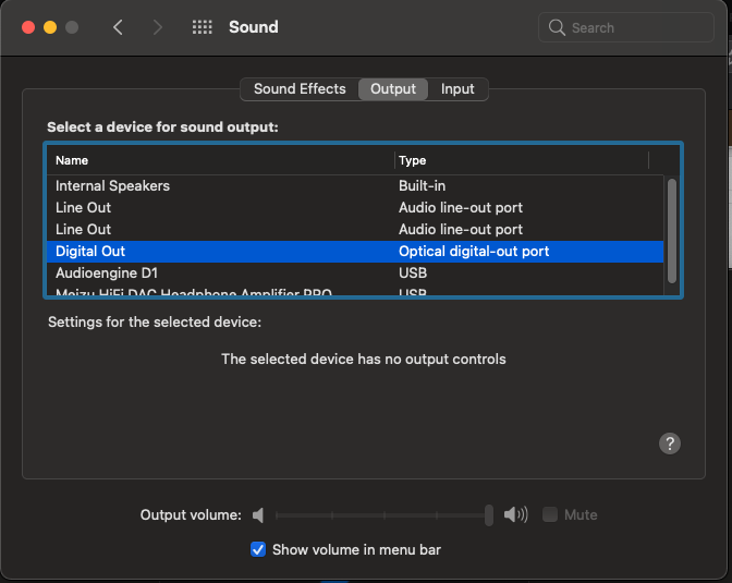

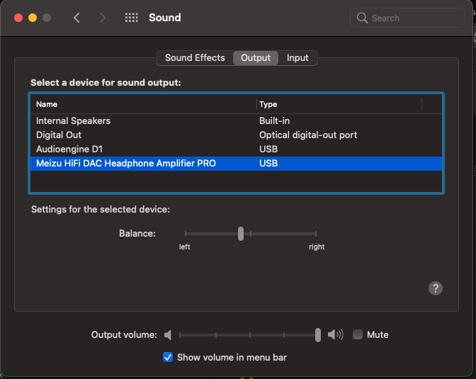

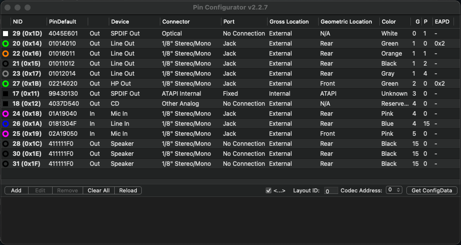

mengshi Posted May 14, 2021 Share Posted May 14, 2021 On 1/4/2021 at 7:52 AM, mengshi said: Just out of curiosity, I had a look at the XML of ID-99 and ID-7 - they look completely different! So I have no idea how or who got it to work (It was added in 1.1.2). I also took screenshots of the pin info from Hackintool of ID-7 vs ID-99 below: @MacPeet codec_dump.txt.zip Any thoughts ? This is inregarding ALC887 - id 1,7 etc vs id-99. id-99 SPDIF (digital out) works but USB sound doesn't, whereas id 1,7 etc - Digital out don't work but USB does. If only id-99 can somehow merge with id-1,7 etc. Link to comment Share on other sites More sharing options...
MacPeet Posted May 14, 2021 Share Posted May 14, 2021 @mengshi Your codec dump and id99 has SPDIF on 17-16 ID1 and ID7 have SPDIF at 30-6 try this with id 7 (30-6 changed to 17-16): AppleALC.kext.zip USB audio has nothing to do with AppleALC. Link to comment Share on other sites More sharing options...

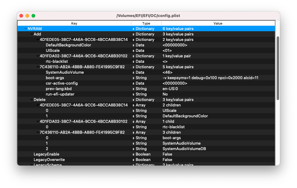

MacPeet Posted May 15, 2021 Share Posted May 15, 2021 The problem is known on some computers. Windows writes values into the nvram (SystemAudioVolume and SystemAudioVolumeDB) that macOS cannot work with. Use the cold start or try to enter SystemAudioVolume and SystemAudioVolumeDB in OC / nvram / Delete. Link to comment Share on other sites More sharing options...
SolidMecury Posted May 15, 2021 Share Posted May 15, 2021 Added under delete like you have suggested but still the issue persists. Could you check whether the keys have been added properly? Link to comment Share on other sites More sharing options...
MacPeet Posted May 15, 2021 Share Posted May 15, 2021 Type is Data Link to comment Share on other sites More sharing options...
SolidMecury Posted May 15, 2021 Share Posted May 15, 2021 I think it's data when the value need to be set like in Add. But with delete it must be the key so it has to be string. Am I wrong? Link to comment Share on other sites More sharing options...

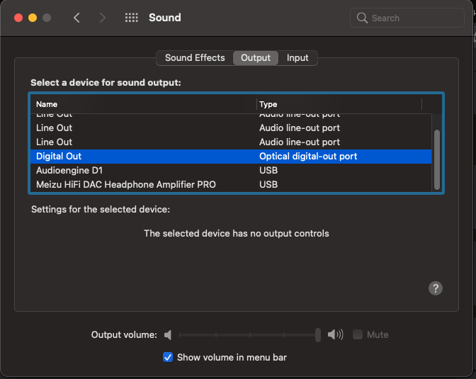

mengshi Posted May 15, 2021 Share Posted May 15, 2021 (edited) 18 hours ago, MacPeet said: @mengshi Your codec dump and id99 has SPDIF on 17-16 ID1 and ID7 have SPDIF at 30-6 try this with id 7 (30-6 changed to 17-16): AppleALC.kext.zip 1.19 MB · 1 download USB audio has nothing to do with AppleALC. @Macpeet Thanks so much but unfortunately it doesn't work. Let me show a few screencaps. 1. With unmodified AppleALC, id-1, digital out doesn't work. USB works and can detect both USB devices 2. With your modified AppleALC, id-7, digital doesn't work, both USB devices detected and work. Essentially behaves identical to id-1. 3. With unmodified AppleALC, id-99, digital out works, USB Audioengine D1 doesn't work (this device has both USB and optical SPDIF input -changing it to usb input doesn't work, optical input works), Meizu HiFi Dac USB works. Note the number of outputs changed. --------------------------------------- Pin configurator from codec dump: id-99 works the best. I can live with this. Thanks for helping. Edited May 15, 2021 by mengshi grammar Link to comment Share on other sites More sharing options...
