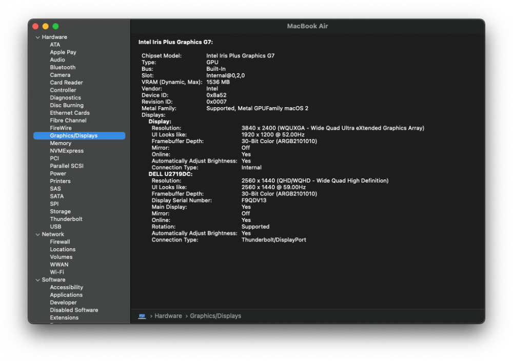

najeeb_anwer Posted February 1, 2021 Share Posted February 1, 2021 I have macOS 11.2 running on a Dell XPS 13 9300 (Ice Lake). I have a USB-C monitor connected via a USB-C cable that also supplies power to the system. It all seems to work fine until I try to use AppleALC. If I use any valid layout-id for ALC289 (the codec for this system), the system freezes after boot is complete but before the login window - but only if the USB-C monitor is connected. If I boot the system with just the internal display then the system does not freeze and AppleALC works fine. VoodooHDA works with the external monitor connected, but I would prefer to use AppleALC. I thought that the problem might be caused by the code in AppleALC/Whatevergreen that converts DP to HDMI for HDMI audio to work, so I disabled the HDMI patches but that did not make any difference. I would appreciate any help to figure this out. Or, if this is a problem with AppleALC dealing with USB-C monitors, I would be happy to try out test versions of AppleALC. Link to comment Share on other sites More sharing options...

najeeb_anwer Posted March 6, 2021 Share Posted March 6, 2021 On 2/1/2021 at 5:21 PM, najeeb_anwer said: I have macOS 11.2.1 running on a Dell XPS 13 9300 (Ice Lake). I have a USB-C monitor connected via a USB-C cable that also supplies power to the system. It all seems to work fine until I try to use AppleALC. If I use any valid layout-id for ALC289 (the codec for this system), the system freezes after boot is complete but before the login window - but only if the USB-C monitor is connected. If I boot the system with just the internal display then the system does not freeze and AppleALC works fine. VoodooHDA works with the external monitor connected, but I would prefer to use AppleALC. Hi everyone, how do I get help for this issue? Is there any additional information that I need to provide? Link to comment Share on other sites More sharing options...

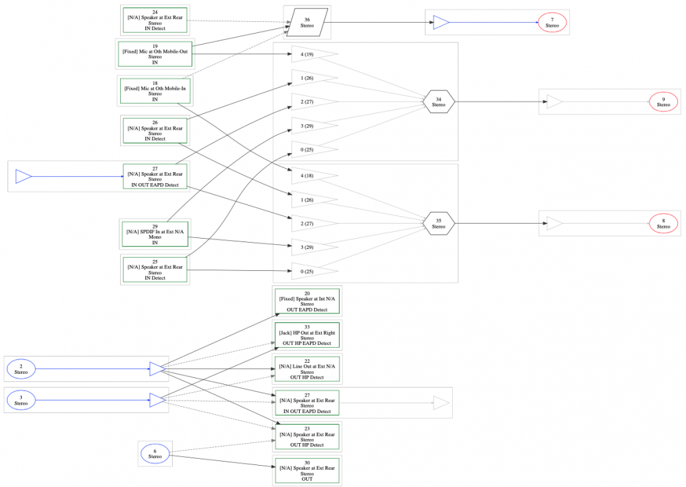

kaleaves Posted March 7, 2021 Share Posted March 7, 2021 Hi allSince my tablet combined jack is different form others so I am trying to build my own AppleALC.kext.During patch the applealc, Im not sure that I picked right node for my machine and hope someone would correct me.If I picked right node how can I edit the path in Platform.xml.Thx for your adviceDetails are belowI think my node:18 Internal Mic Boost Volume19 Internal Mic Boost Volume20 Speaker Playback Switch33 Headphone Playback Switch Verbs from Linux Codec Dump File: codec_dump.txt Codec: Realtek ALC3253 Address: 0 DevID: 283902501 (0x10ec0225) Jack Color Description Node PinDefault Original Verbs -------------------------------------------------------------------------------------------------------- Digital Unknown Mic at Oth Mobile-In 18 0x12 0xb7a60130 01271c30 01271d01 01271ea6 01271fb7 Digital Black Mic at Oth Mobile-Out 19 0x13 0xb8a61140 01371c40 01371d11 01371ea6 01371fb8 Analog Unknown Speaker at Int N/A 20 0x14 0x90170110 01471c10 01471d01 01471e17 01471f90 Unknown Unknown Line Out at Ext N/A 22 0x16 0x40000000 01671c00 01671d00 01671e00 01671f40 1/8 Black Speaker at Ext Rear 23 0x17 0x411111f0 01771cf0 01771d11 01771e11 01771f41 1/8 Black Speaker at Ext Rear 24 0x18 0x411111f0 01871cf0 01871d11 01871e11 01871f41 1/8 Black Speaker at Ext Rear 25 0x19 0x411111f0 01971cf0 01971d11 01971e11 01971f41 1/8 Black Speaker at Ext Rear 26 0x1a 0x411111f0 01a71cf0 01a71d11 01a71e11 01a71f41 Speaker at Ext Rear 0x1b 0x1b 1091637744 01b71cf0 01b71d11 01b71e11 01b71f41 Unknown Unknown SPDIF In at Ext N/A 29 0x1d 0x40c00001 01d71c01 01d71d00 01d71ec0 01d71f40 1/8 Black Speaker at Ext Rear 30 0x1e 0x411111f3 01e71cf3 01e71d11 01e71e11 01e71f41 1/8 Black HP Out at Ext Right 33 0x21 0x04211020 02171c20 02171d10 02171e21 02171f04 -------------------------------------------------------------------------------------------------------- Jack Color Description Node PinDefault Modified Verbs -------------------------------------------------------------------------------------------------------- Digital Unknown Mic at Oth Mobile-In 18 0x12 0xb7a60130 01271c30 01271d00 01271ea6 01271fb0 Digital Black Mic at Oth Mobile-Out 19 0x13 0xb8a61140 01371c40 01371d10 01371ea6 01371fb0 Analog Unknown Speaker at Int N/A 20 0x14 0x90170110 01471c10 01471d00 01471e17 01471f90 Unknown Unknown Line Out at Ext N/A 22 0x16 0x40000000 01671c50 01671d00 01671e00 01671f40 Unknown Unknown SPDIF In at Ext N/A 29 0x1d 0x40c00001 01d71c60 01d71d00 01d71ec0 01d71f40 1/8 Black Speaker at Ext Rear 30 0x1e 0x411111f3 01e71cf0 01e71d10 01e71e11 01e71f41 1/8 Black HP Out at Ext Right 33 0x21 0x04211020 02171c20 02171d10 02171e21 02171f00 -------------------------------------------------------------------------------------------------------- Link to comment Share on other sites More sharing options...

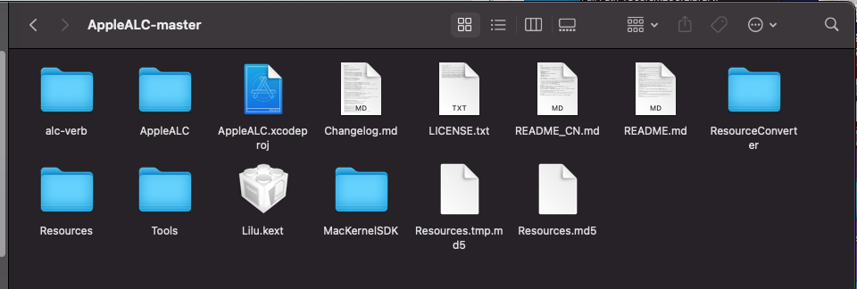

najeeb_anwer Posted March 15, 2021 Share Posted March 15, 2021 On 3/13/2021 at 3:54 AM, nmano said: I can't build latest AppleALC build success but red mark. I thing kern_resources.cpp missing please help Thanks Team. Here are the steps: 1) Get the source code for AppleALC: cd ~/Developer git clone https://github.com/acidanthera/AppleALC.git 2) Copy the latest Lilu.kext (debug version) into the AppleALC folder 3) Copy the MacKernelSDK folder (from https://github.com/acidanthera/MacKernelSDK) into the AppleALC folder 4) Start Xcode and open the AppleALC project. Ignore any warnings about MACOSX_DEPLOYMENT_TARGET. 5) Make sure you have active scheme set to "AppleALC -> My Mac" at the top. This selects the product to build. 6) From the Xcode menu, select "Product/Clean Build Folder" and then "Product/Build". 7) After a successful build, AppleALC.kext will be available in the "Products" folder in the Xcode Project Navigator - you can right-click and open the Finder window containing the created kext. Hope this helps 1 Link to comment Share on other sites More sharing options...

Rodion2010 Posted March 15, 2021 Share Posted March 15, 2021 5 hours ago, najeeb_anwer said: Here are the steps: save as script and run #!/bin/sh cd "$(dirname "$0")" git clone https://github.com/acidanthera/Lilu git clone https://github.com/acidanthera/MacKernelSDK git clone https://github.com/acidanthera/AppleALC cd MacKernelSDK git pull cd ../Lilu git pull ln -s ../MacKernelSDK MacKernelSDK xcodebuild xcodebuild -configuration Debug cd ../AppleALC git pull ln -s ../MacKernelSDK MacKernelSDK ln -s ../Lilu/build/Debug/Lilu.kext Lilu.kext xcodebuild Link to comment Share on other sites More sharing options...

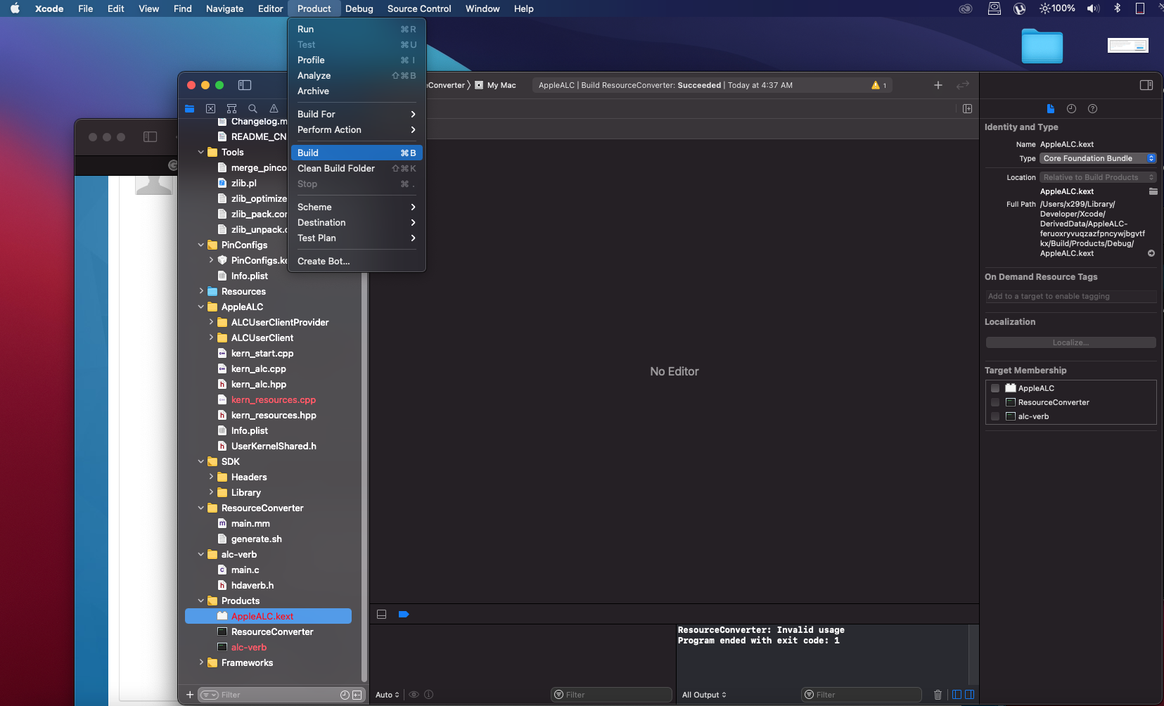

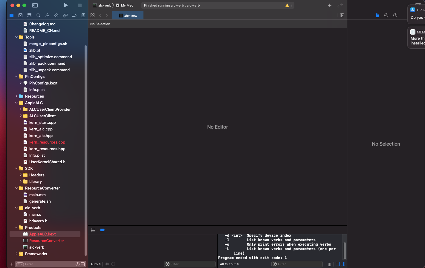

nmano Posted March 19, 2021 Share Posted March 19, 2021 On 3/15/2021 at 10:40 AM, najeeb_anwer said: Here are the steps: 1) Get the source code for AppleALC: cd ~/Developer git clone https://github.com/acidanthera/AppleALC.git 2) Copy the latest Lilu.kext (debug version) into the AppleALC folder 3) Copy the MacKernelSDK folder (from https://github.com/acidanthera/MacKernelSDK) into the AppleALC folder 4) Start Xcode and open the AppleALC project. Ignore any warnings about MACOSX_DEPLOYMENT_TARGET. 5) Make sure you have active scheme set to "AppleALC -> My Mac" at the top. This selects the product to build. 6) From the Xcode menu, select "Product/Clean Build Folder" and then "Product/Build". 7) After a successful build, AppleALC.kext will be available in the "Products" folder in the Xcode Project Navigator - you can right-click and open the Finder window containing the created kext. Hope this helps Hi My Friend I follow your steps 1-7 Still I can't build.please look my screen shot images. Thanks. Link to comment Share on other sites More sharing options...
najeeb_anwer Posted March 19, 2021 Share Posted March 19, 2021 (edited) 7 hours ago, nmano said: I follow your steps 1-7 Please make sure you follow step 5. According to your screen shot your active scheme is "ResourceConverter -> My Mac". Click on where it currently says ResourceConverter at the top of the Xcode window and select AppleALC instead. Edited March 19, 2021 by najeeb_anwer 1 Link to comment Share on other sites More sharing options...
nmano Posted March 20, 2021 Share Posted March 20, 2021 8 hours ago, najeeb_anwer said: Please make sure you follow step 5. According to your screen shot your active scheme is "ResourceConverter -> My Mac". Click on where it currently says ResourceConverter at the top of the Xcode window and select AppleALC instead. Thanks my friend I just found It.Its worked now. Thank you so much. Link to comment Share on other sites More sharing options...

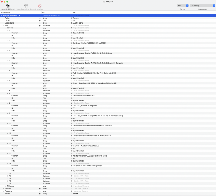

matgeo Posted April 20, 2021 Share Posted April 20, 2021 @MacPeet , can you help me with my alc256 on a Dell 5570 ? I'm tring to use applealc.kext only , without the need of ssdt and codeccommander. Problem is that audio from headphones is sometimes distorted (there is a high pitch noise) and cpu stays at max speed. Maybe the problem is the line in must be disabled ? or something else. Hope you can help me. codec_dump.txt BIG SUR.ioreg.zip Link to comment Share on other sites More sharing options...
MacPeet Posted April 20, 2021 Share Posted April 20, 2021 @matgeo You are using layoutID 21 (Hex 15). Please ask the developer of Codec ID 21, @Andres ZeroCross Link to comment Share on other sites More sharing options...
matgeo Posted April 20, 2021 Share Posted April 20, 2021 @MacPeet , best layoutUD for my codec is 11. But it doesn't work with @Andres ZeroCross codec. Link to comment Share on other sites More sharing options...
MacPeet Posted April 20, 2021 Share Posted April 20, 2021 @matgeo LayoutID 11 is not from me either, the developer is @Rockjesus LayoutID 21 is specially designed for the Dell 5570. Maybe better ask these developers! Maybe they have the same Dell. Sorry, but with the large selection of layoutIDs, I am not developing past the other developers. Your problem "CPU on max" may also be due to incorrect power management. Link to comment Share on other sites More sharing options...
