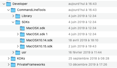

wern apfel Posted May 10, 2021 Share Posted May 10, 2021 1 hour ago, matxpa said: I don't have 10.6, 10.8 SDKs (since a long time i suppose) only 10.15 and 11.3. MacOSX.sdk and MacOSX11.sdk are two MacOSX11.3.sdk's links lrwxr-xr-x 1 root wheel 14 27 avr 10:49 MacOSX.sdk -> MacOSX11.3.sdk drwxr-xr-x 8 root wheel 256 27 avr 10:50 MacOSX10.15.sdk drwxr-xr-x 7 root wheel 224 16 mar 15:03 MacOSX11.3.sdk lrwxr-xr-x 1 root wheel 14 27 avr 10:48 MacOSX11.sdk -> MacOSX11.3.sdk Attached /Library/Developer/CommandLineTools/SDKs on SB 11.3.1 and /Library/Developer/CommandLineTools/SDKs on Mojave 10.14.6 And i checked WEG.xcodeproj with Xcode and "MACOSX_DEPLOYMENT_TARGET = 10.8;" don't avoid compilation with OCBuilder.app and with Xcode compilation is OK with same warnings as AppleALC but finished. May be AppleALC build constraints have changed or it's a BS 11.3.1 or Xcode 12.5 problem. MY BAD, I'm confused, AppleALC build is more than 10 minutes, I remember it was long but not so long. I'm not sure if you need these SDKs, maybe MacKernelSDK will replaced theml. AppleALC is not compatible with 10.6 Link to comment https://www.insanelymac.com/forum/topic/311293-applealc-%E2%80%94-dynamic-applehda-patching/page/209/#findComment-2757607 Share on other sites More sharing options...

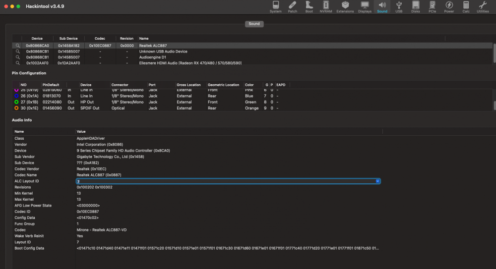

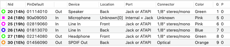

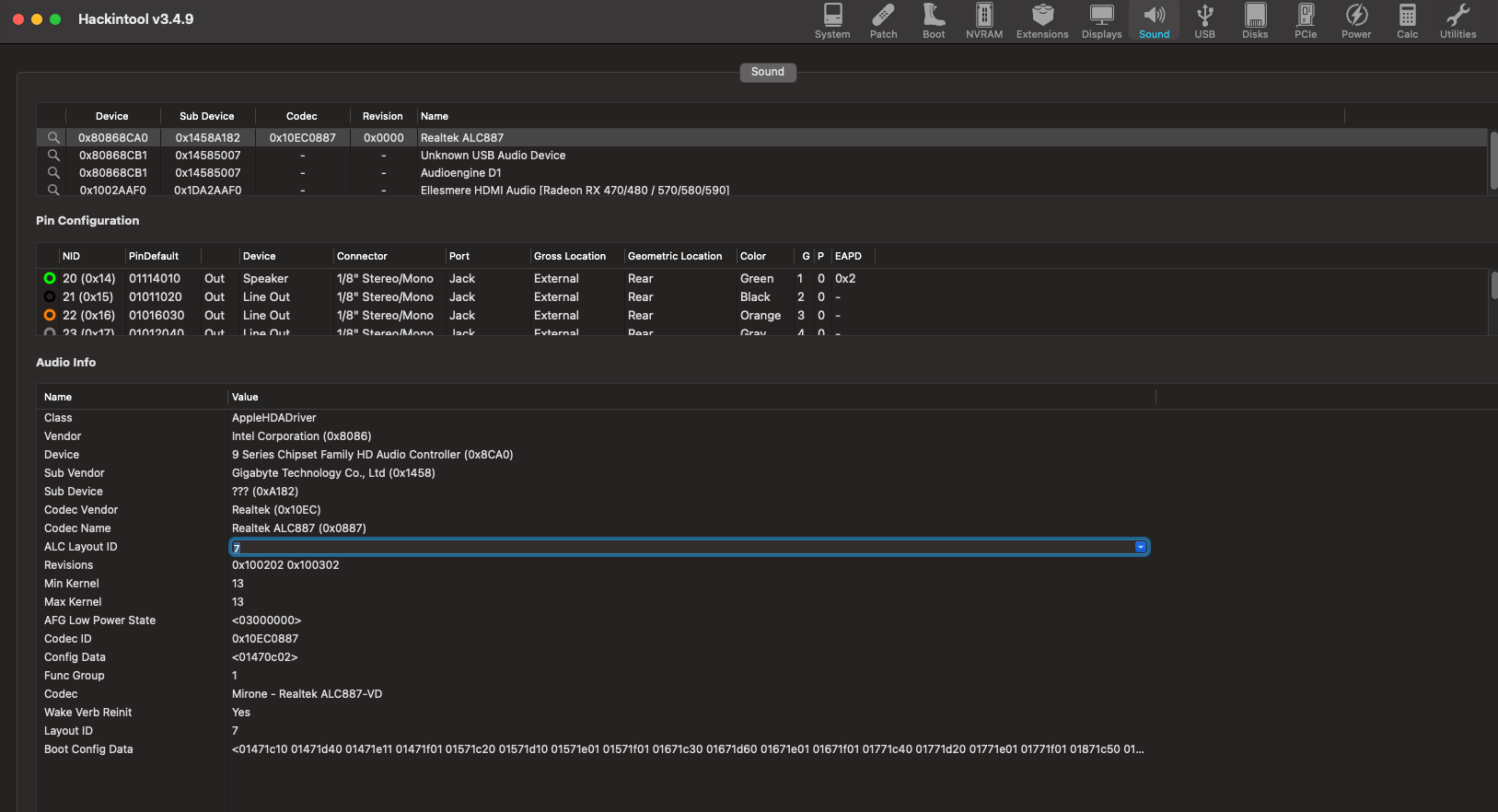

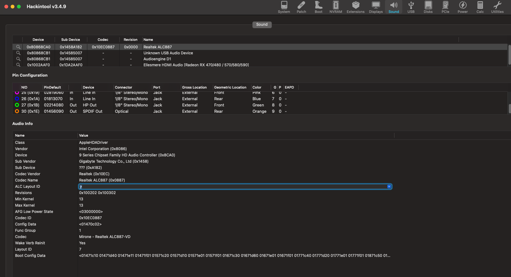

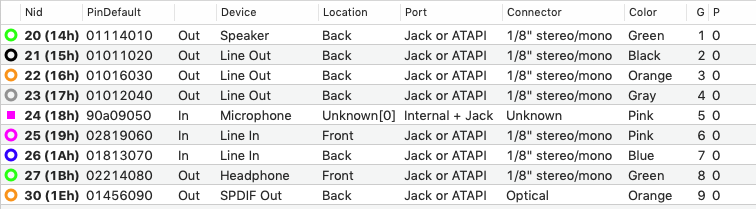

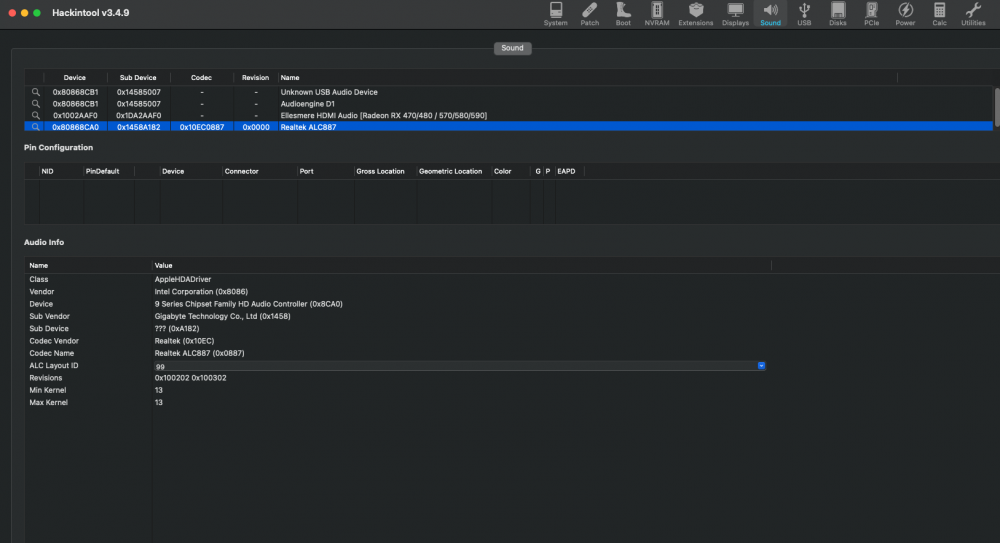

mengshi Posted May 14, 2021 Share Posted May 14, 2021 On 1/4/2021 at 7:52 AM, mengshi said: Just out of curiosity, I had a look at the XML of ID-99 and ID-7 - they look completely different! So I have no idea how or who got it to work (It was added in 1.1.2). I also took screenshots of the pin info from Hackintool of ID-7 vs ID-99 below: @MacPeet codec_dump.txt.zip Any thoughts ? This is inregarding ALC887 - id 1,7 etc vs id-99. id-99 SPDIF (digital out) works but USB sound doesn't, whereas id 1,7 etc - Digital out don't work but USB does. If only id-99 can somehow merge with id-1,7 etc. Link to comment https://www.insanelymac.com/forum/topic/311293-applealc-%E2%80%94-dynamic-applehda-patching/page/209/#findComment-2758001 Share on other sites More sharing options...
MacPeet Posted May 14, 2021 Share Posted May 14, 2021 @mengshi Your codec dump and id99 has SPDIF on 17-16 ID1 and ID7 have SPDIF at 30-6 try this with id 7 (30-6 changed to 17-16): AppleALC.kext.zip USB audio has nothing to do with AppleALC. Link to comment https://www.insanelymac.com/forum/topic/311293-applealc-%E2%80%94-dynamic-applehda-patching/page/209/#findComment-2758062 Share on other sites More sharing options...
