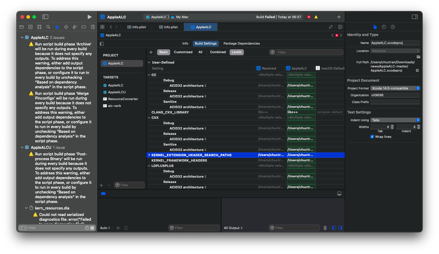

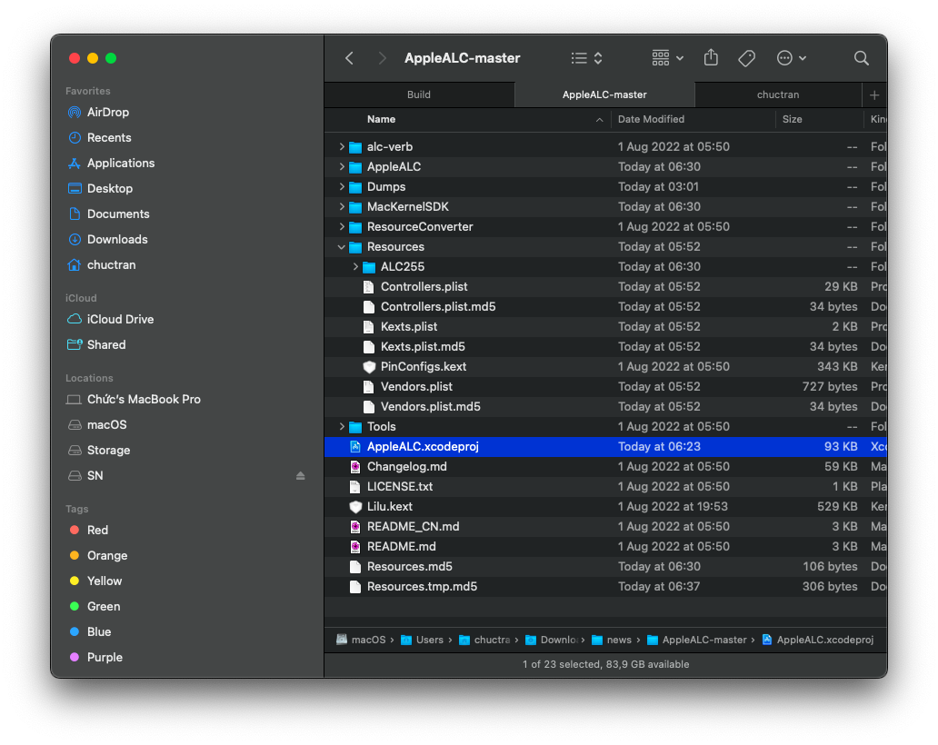

oldman20 Posted August 2, 2022 Share Posted August 2, 2022 I tried to Fix it myself but I can't get compile. Here are the files that I made codeverbs.txt layout71.xmlPlatforms71.xml Thank! Link to comment Share on other sites More sharing options...

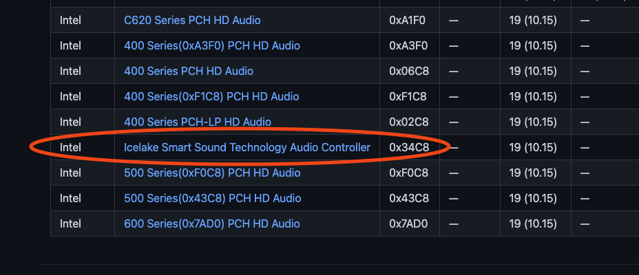

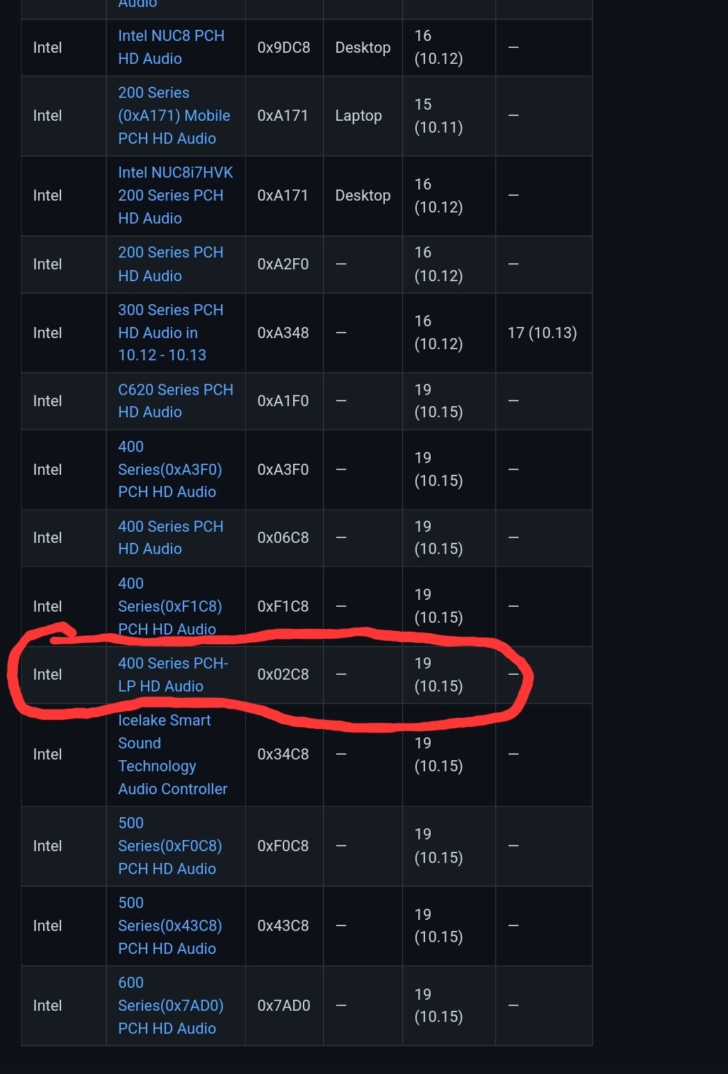

andreew75 Posted August 3, 2022 Share Posted August 3, 2022 11 hours ago, rafale77 said: Could you show us where you saw this declaration? This is the first I heard of it. https://github.com/acidanthera/AppleALC/wiki/Supported-codecs Link to comment Share on other sites More sharing options...
Slice Posted August 3, 2022 Share Posted August 3, 2022 1 hour ago, andreew75 said: https://github.com/acidanthera/AppleALC/wiki/Supported-codecs ACPI\VEN_ESSX&DEV_8336&SUBSYS_152D1262? Link to comment Share on other sites More sharing options...

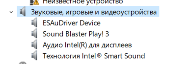

andreew75 Posted August 3, 2022 Share Posted August 3, 2022 7 hours ago, Slice said: ACPI\VEN_ESSX&DEV_8336&SUBSYS_152D1262? Yes, I have device ACPI\VEN_ESSX&DEV_8326&SUBSYS_27821A60 Also in audio devices there is this Slice, could any of this make the sound work? Sound Blaster Play this is an external sound card. Link to comment Share on other sites More sharing options...
rafale77 Posted August 3, 2022 Share Posted August 3, 2022 9 hours ago, andreew75 said: https://github.com/acidanthera/AppleALC/wiki/Supported-codecs Not to be nitpicking but this is not in Dortania. It is also a very specific device for the mobile line of Icelake which name their PCH codec SST likely because it has similar features and is different from the ones in desktop platforms which requires a separate driver as it is a separated device from the PCH codec. On mine SST is an I2C device and is completely unsupported by MacOS. Instead I am running on the 400 Series PCH HD audio. 1 Link to comment Share on other sites More sharing options...

andreew75 Posted August 5, 2022 Share Posted August 5, 2022 (edited) 23 hours ago, rafale77 said: What configuration/hardware are you trying to implement? I see such information that Windows shows me ESAuDriver Device ACPI\VEN_ESSX&DEV_8326&SUBSYS_27821A60 ACPI\ESSX8326 *ESSX8326 Intel(R) Display-Audio INTELAUDIO\FUNC_01&VEN_8086&DEV_280B&SUBSYS_80860101&REV_1000 INTELAUDIO\FUNC_01&VEN_8086&DEV_280B&SUBSYS_80860101 Intel Smart Sound Technology INTELAUDIO\CTLR_DEV_9DC8&LINKTYPE_03&DEVTYPE_04&VEN_8086&DEV_AE34&SUBSYS_02062782&REV_0001 Edited August 5, 2022 by andreew75 Link to comment Share on other sites More sharing options...
rafale77 Posted August 5, 2022 Share Posted August 5, 2022 (edited) 55 minutes ago, andreew75 said: I see such information that Windows shows me ESAuDriver Device ACPI\VEN_ESSX&DEV_8326&SUBSYS_27821A60 ACPI\ESSX8326 *ESSX8326 Intel(R) Display-Audio INTELAUDIO\FUNC_01&VEN_8086&DEV_280B&SUBSYS_80860101&REV_1000 INTELAUDIO\FUNC_01&VEN_8086&DEV_280B&SUBSYS_80860101 Intel Smart Sound Technology INTELAUDIO\CTLR_DEV_9DC8&LINKTYPE_03&DEVTYPE_04&VEN_8086&DEV_AE34&SUBSYS_02062782&REV_0001 You have both the intel onboard SST codec which is not supported by MacOS or AppleALC because it is an I2C device as @Slice was referring to and an Everest Semiconductor codec. I am pretty sure it isn't supported either. I am not sure how it is connected on the board as the I2S reference is making me think that it is not on the PCIe bus either. See here and here. Edited August 5, 2022 by rafale77 1 Link to comment Share on other sites More sharing options...
