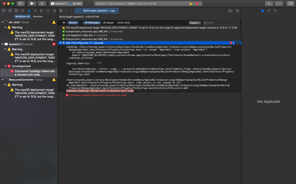

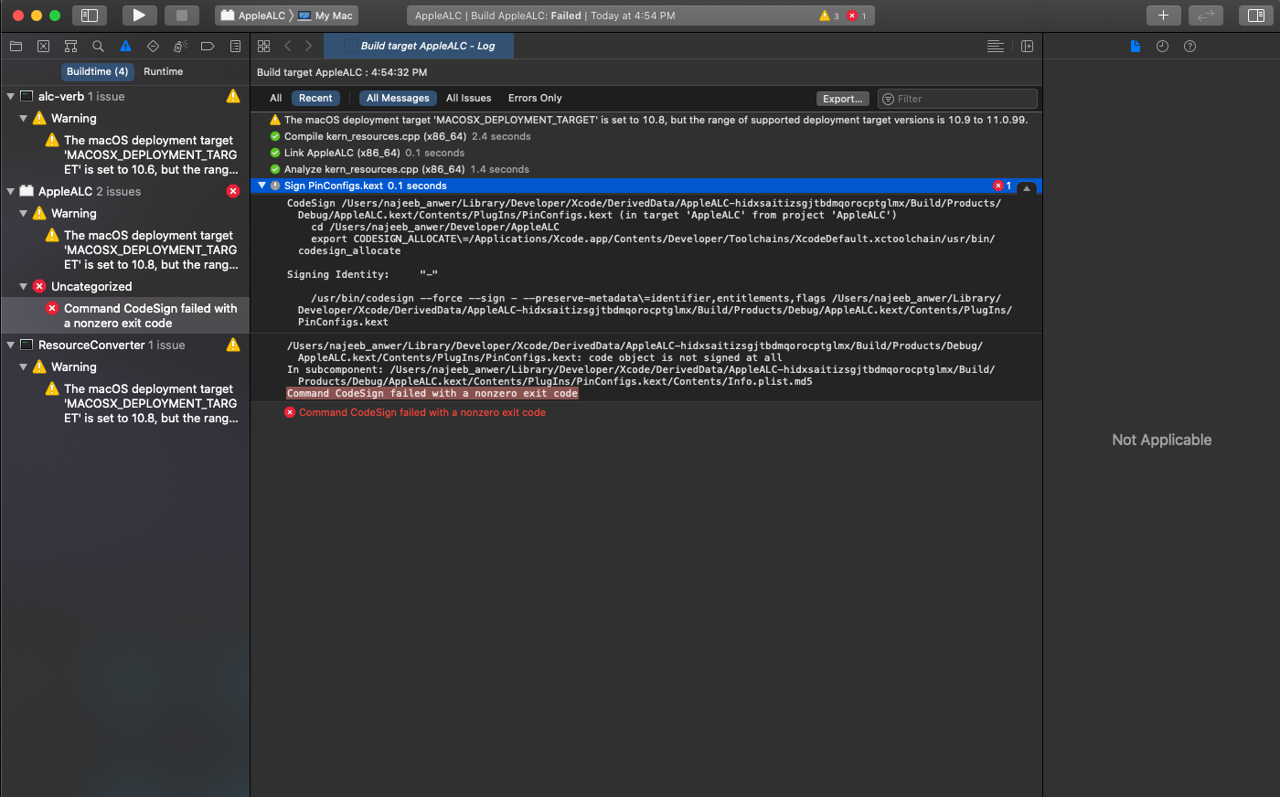

najeeb_anwer Posted November 27, 2020 Share Posted November 27, 2020 I am trying to build the latest version of AppleALC and I get this error: I have successfully built AppleALC in the past, so this is a new error. I have a valid developer certificate. I would appreciate any help to solve this. Link to comment https://www.insanelymac.com/forum/topic/311293-applealc-%E2%80%94-dynamic-applehda-patching/page/206/#findComment-2745668 Share on other sites More sharing options...
najeeb_anwer Posted November 28, 2020 Share Posted November 28, 2020 5 hours ago, najeeb_anwer said: I am trying to build the latest version of AppleALC and I get this error: I have successfully built AppleALC in the past, so this is a new error. I have a valid developer certificate. I would appreciate any help to solve this. It's okay - I figured out that it's best to ignore the Xcode suggestion to update the project settings which is what enables the code signing. Builds fine without the code signing. 1 Link to comment https://www.insanelymac.com/forum/topic/311293-applealc-%E2%80%94-dynamic-applehda-patching/page/206/#findComment-2745674 Share on other sites More sharing options...

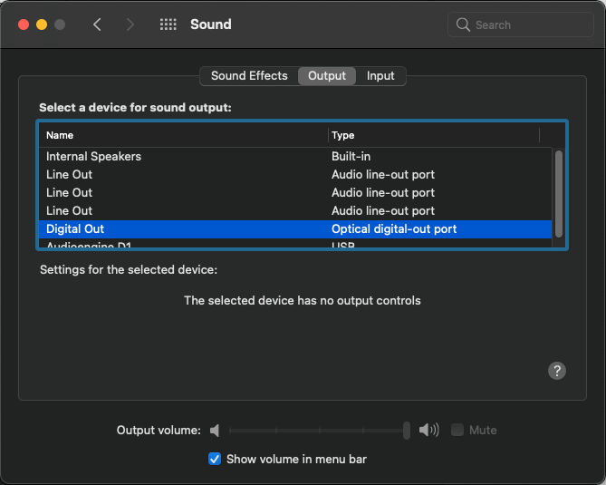

mengshi Posted December 27, 2020 Share Posted December 27, 2020 (edited) On 4/14/2020 at 10:05 PM, MacPeet said: @mengshi this ID 7: this is ID 99: Both have configured SPDIF-Out with nodes 30-6. Maybe ID 7 has a conflict with two "orange" ?! Please do a codec dump with a Linux Live version (example Ubuntu) for more details! This is better for a new codec for you. Sorry for this SUPER late reply. Finally got the codec dump. I would like to add that I have the AudioEngine D1 (DAC/headphone amp) plugged in to the USB port together with the SPDIF. The AudioEngine D1 can use either the USB or the SPDIF as sound input. It is powered off the USB. With ID-7, the USB works as a sound input but SPDIF doesn't (It does show up). With ID-99, SPDIF works as sound input but USB doesn't (It does show up). With ID-99: This shows up (This is with the headphone jack used. It auto-detects the front headphone jack and renames it as such). So Digital out works (SPDIF in ID-99) but USB AudioEngine D1 doesn't. With ID-7, all sound jack shows, USB works but SPDIF doesn't. Incidentally, USB and SPDIF BOTH works under Ubuntu ! ID-87 is strangely imperfect - the USB and Digital out both don't work. (My motherboard is the Gigabyte H97-HD3, ID-87 was created for Gigabyte Z97-HD3. Nearly identical motherboards apart from overclocking ability in chipsets only). Working analog jacks with working Digital out/SPDIF from ID-99 would be PERFECT. The second screen shot is from ID-87 as seen by my hackintosh. codec_dump.txt Edited December 27, 2020 by mengshi Added information Link to comment https://www.insanelymac.com/forum/topic/311293-applealc-%E2%80%94-dynamic-applehda-patching/page/206/#findComment-2747701 Share on other sites More sharing options...

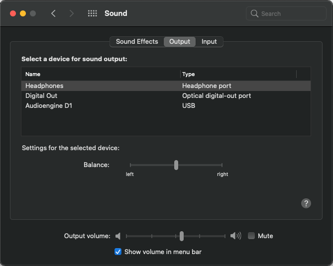

mengshi Posted January 1, 2021 Share Posted January 1, 2021 On 12/27/2020 at 9:26 AM, mengshi said: Sorry for this SUPER late reply. Finally got the codec dump. I would like to add that I have the AudioEngine D1 (DAC/headphone amp) plugged in to the USB port together with the SPDIF. The AudioEngine D1 can use either the USB or the SPDIF as sound input. It is powered off the USB. With ID-7, the USB works as a sound input but SPDIF doesn't (It does show up). With ID-99, SPDIF works as sound input but USB doesn't (It does show up). With ID-99: This shows up (This is with the headphone jack used. It auto-detects the front headphone jack and renames it as such). So Digital out works (SPDIF in ID-99) but USB AudioEngine D1 doesn't. With ID-7, all sound jack shows, USB works but SPDIF doesn't. Incidentally, USB and SPDIF BOTH works under Ubuntu ! ID-87 is strangely imperfect - the USB and Digital out both don't work. (My motherboard is the Gigabyte H97-HD3, ID-87 was created for Gigabyte Z97-HD3. Nearly identical motherboards apart from overclocking ability in chipsets only). Working analog jacks with working Digital out/SPDIF from ID-99 would be PERFECT. The second screen shot is from ID-87 as seen by my hackintosh. codec_dump.txt Waiting for MacPeet or those who really know this stuff to come back. LOL. I have found the link to the ALC887-VD datasheet. Some mention of nodes etc in there which I think may help. https://datasheetspdf.com/pdf-file/1408176/RealtekMicroelectronics/ALC887-VD/1 Link to comment https://www.insanelymac.com/forum/topic/311293-applealc-%E2%80%94-dynamic-applehda-patching/page/206/#findComment-2747982 Share on other sites More sharing options...
mengshi Posted January 3, 2021 Share Posted January 3, 2021 On 1/1/2021 at 9:20 AM, mengshi said: Waiting for MacPeet or those who really know this stuff to come back. LOL. I have found the link to the ALC887-VD datasheet. Some mention of nodes etc in there which I think may help. https://datasheetspdf.com/pdf-file/1408176/RealtekMicroelectronics/ALC887-VD/1 Just out of curiosity, I had a look at the XML of ID-99 and ID-7 - they look completely different! So I have no idea how or who got it to work (It was added in 1.1.2). I also took screenshots of the pin info from Hackintool of ID-7 vs ID-99 below: Link to comment https://www.insanelymac.com/forum/topic/311293-applealc-%E2%80%94-dynamic-applehda-patching/page/206/#findComment-2748144 Share on other sites More sharing options...

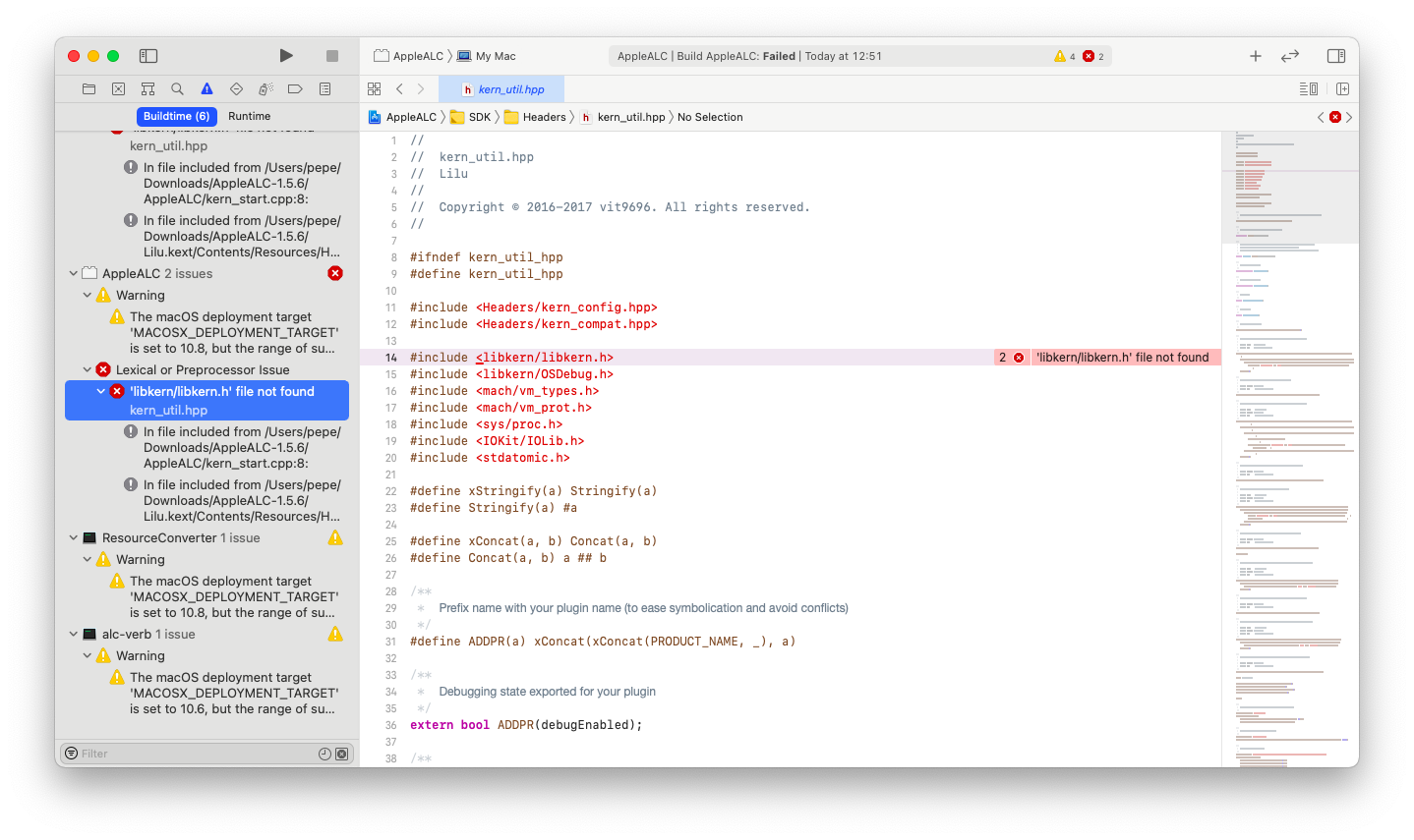

jl4c Posted January 11, 2021 Share Posted January 11, 2021 (edited) Guys, Am trying to build the last version of AppleALC in macOS Big Sur, but I get this error: Any suggestions? Edited January 11, 2021 by jl4c Link to comment https://www.insanelymac.com/forum/topic/311293-applealc-%E2%80%94-dynamic-applehda-patching/page/206/#findComment-2748666 Share on other sites More sharing options...
Brave__Starr Posted January 15, 2021 Share Posted January 15, 2021 On 1/11/2021 at 4:01 PM, jl4c said: Guys, Am trying to build the last version of AppleALC in macOS Big Sur, but I get this error: Any suggestions? I think you need to add the Kernel SDK from https://github.com/acidanthera/MacKernelSDK Link to comment https://www.insanelymac.com/forum/topic/311293-applealc-%E2%80%94-dynamic-applehda-patching/page/206/#findComment-2748905 Share on other sites More sharing options...
jl4c Posted January 16, 2021 Share Posted January 16, 2021 (edited) 16 hours ago, Brave__Starr said: I think you need to add the Kernel SDK from https://github.com/acidanthera/MacKernelSDK Thank you @Brave__Starr. Edited January 16, 2021 by jl4c Link to comment https://www.insanelymac.com/forum/topic/311293-applealc-%E2%80%94-dynamic-applehda-patching/page/206/#findComment-2748933 Share on other sites More sharing options...

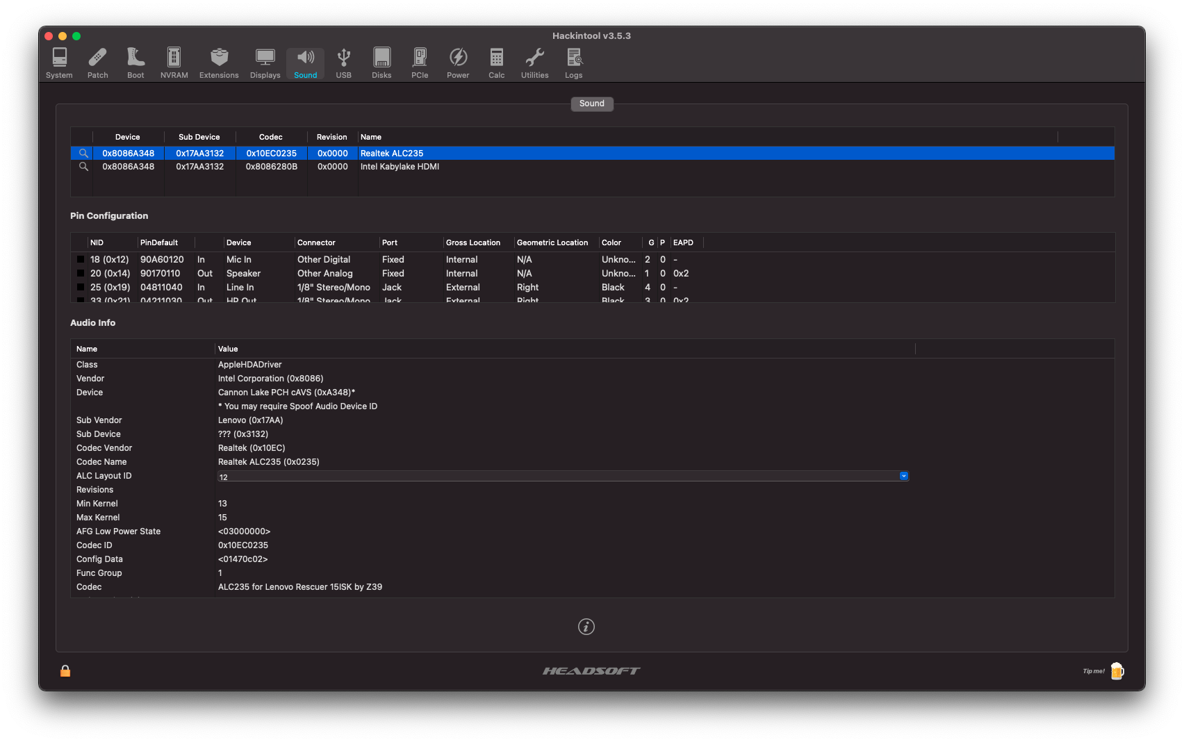

biscate Posted January 22, 2021 Share Posted January 22, 2021 (edited) Hello guys. Need help to build my AppleALC... or create a variation from the CX8400. My codec is similar to the CX8400, for HP Elitebook 1050 G1 (by tyufhl & kuque), but using layout 12 I have no mic and speakers sound (only headphones). No lucky trying to dump the codec using Linux (last Ubuntu live version), as explained in the AppleALC tutorial. Thanks Edited January 22, 2021 by biscate Link to comment https://www.insanelymac.com/forum/topic/311293-applealc-%E2%80%94-dynamic-applehda-patching/page/206/#findComment-2749280 Share on other sites More sharing options...
theroadw Posted January 25, 2021 Share Posted January 25, 2021 On 1/22/2021 at 7:43 AM, biscate said: Hello guys. Need help to build my AppleALC... or create a variation from the CX8400. My codec is similar to the CX8400, for HP Elitebook 1050 G1 (by tyufhl & kuque), but using layout 12 I have no mic and speakers sound (only headphones). No lucky trying to dump the codec using Linux (last Ubuntu live version), as explained in the AppleALC tutorial. Thanks Get VoodooHDA and run the getdump command and post your results. As a side note, I have the same codec and could never quite get it to work properly, my speaker out works for a few seconds then nothing, no errors, nothing, very strange. everything else worked fine though, and voodoohda works, so it must be something the apple driver is doing. Link to comment https://www.insanelymac.com/forum/topic/311293-applealc-%E2%80%94-dynamic-applehda-patching/page/206/#findComment-2749412 Share on other sites More sharing options...
biscate Posted January 30, 2021 Share Posted January 30, 2021 (edited) On 1/24/2021 at 11:03 PM, hugodlc said: Get VoodooHDA and run the getdump command and post your results. As a side note, I have the same codec and could never quite get it to work properly, my speaker out works for a few seconds then nothing, no errors, nothing, very strange. everything else worked fine though, and voodoohda works, so it must be something the apple driver is doing. Hey, @hugodlc, sorry for late response, had no email notification set. UPDATE Ok, I've installed VoodooHDA (with no errors) but got no audio devices after reboot. Verified that AppleALC was removed from kext folder and OC/kernel/add configurations. I notice Big Sur has no usr/local/bin/ folder, only usr/bin/ (usr/local/ is completelly empty). And, btw, how to dump the codec with VoodooHDA? Got partially VoodooHDA to work after follow solution 2 from olarila forum: Speakers: workiing Headphones: working Onboard mic: not working ---------------------------- Problem: kext doesn't work (usually when there's more than one audio card or the video card has HDMI audio). Solution: use solution 2 for kernel panic problem above. If you want to use both cards, create one entry for each card in IOKitPersonalities. Solution 2: edit Info.plist, replace the key IOPCIClassMatch by IOPCIPrimaryMatch and put the PCI ID of your audio card in string. ---------------------------- Device used: 0X34C88086 Device 0x34C88086.rtf Edited February 3, 2021 by biscate Link to comment https://www.insanelymac.com/forum/topic/311293-applealc-%E2%80%94-dynamic-applehda-patching/page/206/#findComment-2749758 Share on other sites More sharing options...

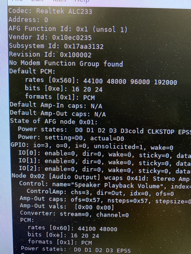

Hiko Posted February 16, 2021 Share Posted February 16, 2021 I am running Big Sur on Lenovo M920s, AppleALC installed and identified the Audio card as Realtek ALC235. It works fine with the internal speaker, but it doesn't work if I use the external speakers plugged into the rear jack. I boot into Linux and it shows me the audio card is actually ALC233. Link to comment https://www.insanelymac.com/forum/topic/311293-applealc-%E2%80%94-dynamic-applehda-patching/page/206/#findComment-2751274 Share on other sites More sharing options...
