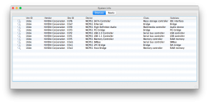

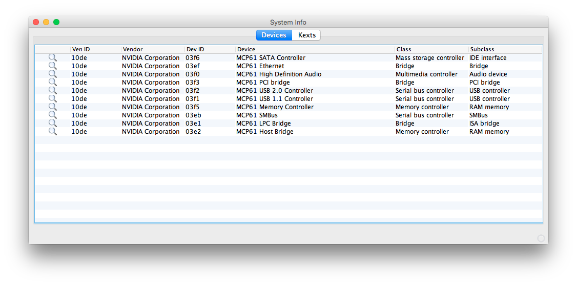

spakk Posted September 29, 2016 Share Posted September 29, 2016 start the SystemInfo.app and upload the image with all hardware-ID Link to comment https://www.insanelymac.com/forum/topic/311245-help-topic-amd-os-x-el-capitan-1011/page/25/#findComment-2288689 Share on other sites More sharing options...
BuIlDaLiBlE Posted September 29, 2016 Share Posted September 29, 2016 What can I do after installing nForceLAN package? I removed all kexts but it still hangs on "Still waiting root device". I don't want to reinstall - it takes about 3 hours. Nvm, will still reinstall. About Ethernet - I have GeForce 7025 / nForce 630 chipset. Link to comment https://www.insanelymac.com/forum/topic/311245-help-topic-amd-os-x-el-capitan-1011/page/25/#findComment-2288824 Share on other sites More sharing options...
spakk Posted September 29, 2016 Share Posted September 29, 2016 it gives me enormous difficulties to help you. when I ask you, to send me a picture of their hardware id. then I get little useful information from them. I know that the chipset "GeForce 7025 / nForce 630 chipset" is built into motherboard. if you need help then please should play with open cards, everything else is just a waste of time I ask for your understanding Link to comment https://www.insanelymac.com/forum/topic/311245-help-topic-amd-os-x-el-capitan-1011/page/25/#findComment-2288844 Share on other sites More sharing options...
BuIlDaLiBlE Posted September 29, 2016 Share Posted September 29, 2016 I don't have much experience with UNIX systems so don't blame me on that. I know you asked my hardware IDs but I can't boot and meanwhile I gave you all the info I could. I can name my motherboard while I install the OS X - GA-M68MT-S2 rev 1.3. Link to comment https://www.insanelymac.com/forum/topic/311245-help-topic-amd-os-x-el-capitan-1011/page/25/#findComment-2288845 Share on other sites More sharing options...

BuIlDaLiBlE Posted September 29, 2016 Share Posted September 29, 2016 Btw this is the info you wanted: 1 Link to comment https://www.insanelymac.com/forum/topic/311245-help-topic-amd-os-x-el-capitan-1011/page/25/#findComment-2289094 Share on other sites More sharing options...
