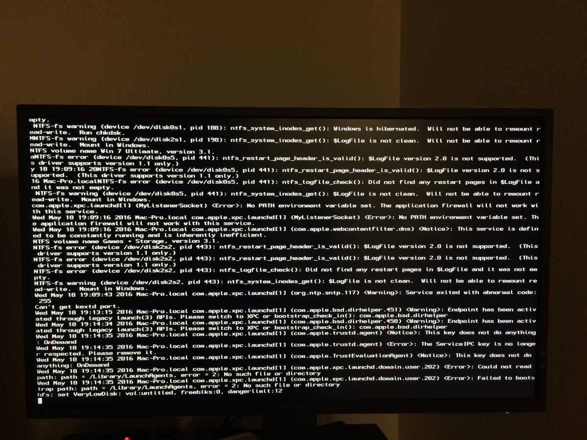

Zenshredder Posted May 19, 2016 Share Posted May 19, 2016 Hi guys, I've been at this since April 2015 trying to get my AMD machine to run OSX. My last attempt I had used Shane's method with El Capitan, and by some miracle of 3 AM witchcraft I got the installer to boot and install successfully, but the SSD I am using to run it wouldn't even boot into verbose mode. This was prior to me learning that I had to copy my Extras folder and kernel onto the installed disk itself so I scrapped my installer and went at it again because I thought I did something wrong, only to make the situation even worse because it wouldn't even boot past a line saying along the lines of "service ended with an abnormal code: 255". This time around I followed the steps that I remember using, but I still can't figure it out, I keep getting stuck in different places every time I try something. To help troubleshoot, here are the steps I've taken. - The OSX version I have installed on the Mac is 10.11.3 but I had used the 11.2 kernels Shane and Bronya created and used them to load it successfully that one times I cant imagine that's the issue - Followed Shane's tutorial step by step so I couldn't mess it up, I am using the Enoch version given in this folder - Kept getting USBEHCI/USB stop and restart loop, applied the USB fix v2 for my OS version -Added ASUS USB fix for keyboard functionality in the installer(I think it's 2 kexts, one of them is ACHIPortInjector? I'm not at my computer at the moment so I can't check, will edit this when I get home.) -Changed from kernel in Shane's folder for the tutorial to Bronya's 10.11.2 kernel Despite all of that, depending on what combination I do I get tons of different results, the picture linked below is with everything above applied to the installer. I hope I can get back to where I was and apply the next step so I can get to the real fun making all my stuff work in the OS! Thanks in advance for any and all help, I don't post much because I'm often trying different things instead of begging for help, but I really do appreciate it!! Link to comment https://www.insanelymac.com/forum/topic/311245-help-topic-amd-os-x-el-capitan-1011/page/20/#findComment-2239235 Share on other sites More sharing options...
spakk Posted May 20, 2016 Share Posted May 20, 2016 "..... VeryLowDisk ...." these describes the cause of your problem probably a drive, either your USB flash disk (with OS x installer) or one of your other HDD's is full or has bad sectors. Check your drives, possibly use another drive for example USB flash drive or HDD The procedure to locate and resolve the problems: ....If the disk has less than 4 GB of free space (only a rough estimate), then remove unnecessary data from your hdd and repair the Disk with Disk utility or with DiskWarrior. Under Windows operating system you can use MacDrive to repair the disk. If the HDD sectors are defective, then use another hdd and reinstall everything. If the USB flash disk should cause of the problem, then use another USB flash disk. Then it will works.. 1 Link to comment https://www.insanelymac.com/forum/topic/311245-help-topic-amd-os-x-el-capitan-1011/page/20/#findComment-2239303 Share on other sites More sharing options...

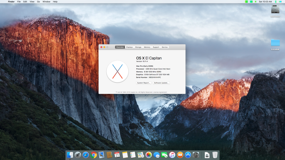

hoxz Posted May 20, 2016 Share Posted May 20, 2016 need help! i have success to get the installation screen with tutorial from shaneee + 10.11.4 installer my computer spec are Athlon x4 860k FM2+ ASRock FM2A68M-DG3 Team Extreme 4x2Gb PixelView GT220 1GB Seagate 80GB Sata II on now my problem my usb mouse won't work, i've tried with these files + tutorial there http://www.insanelymac.com/forum/files/file/521-usb-fix-for-el-capitan/but no changes any other way? Link to comment https://www.insanelymac.com/forum/topic/311245-help-topic-amd-os-x-el-capitan-1011/page/20/#findComment-2239322 Share on other sites More sharing options...
spakk Posted May 20, 2016 Share Posted May 20, 2016 need help! i have success to get the installation screen with tutorial from shaneee + 10.11.4 installer my computer spec are Athlon x4 860k FM2+ ASRock FM2A68M-DG3 Team Extreme 4x2Gb PixelView GT220 1GB Seagate 80GB Sata II on now my problem my usb mouse won't work, i've tried with these files + tutorial there http://www.insanelymac.com/forum/files/file/521-usb-fix-for-el-capitan/but no changes any other way? Have also followed these here, too? ===> ".....delete these drives from S/L/E ==> IOUSBFamily.kext, IOUSBMAssStorageDriver.kext, IOUSBMassStorageClass.kext, pmtelemetry.kext, AppleIntelCPUPowerManagement.kext and the AppleTyMCEDriver.kext install USB 3.0 GenericUSBXHCI.kext current vers. in to E/E then create the prelinked kernel! if you have everything installed as described above, what do you have installed in Extra/Extensions? Link to comment https://www.insanelymac.com/forum/topic/311245-help-topic-amd-os-x-el-capitan-1011/page/20/#findComment-2239372 Share on other sites More sharing options...
hoxz Posted May 20, 2016 Share Posted May 20, 2016 Have also followed these here, too? ===> ".....delete these drives from S/L/E ==> IOUSBFamily.kext, IOUSBMAssStorageDriver.kext, IOUSBMassStorageClass.kext, pmtelemetry.kext, AppleIntelCPUPowerManagement.kext and the AppleTyMCEDriver.kext install USB 3.0 GenericUSBXHCI.kext current vers. in to E/E then create the prelinked kernel! if you have everything installed as described above, what do you have installed in Extra/Extensions? thank you for reply, yes i have followed that too but nothing changes finally i had to use keyboard(PS/2) only and forced me to format the drive using my macbook by usb now my computer able to pass to the desktop, and mouse working since language select. my new problem is blank screen after boot without nv_disable=1.. i'm gonna figure it out thank you btw Link to comment https://www.insanelymac.com/forum/topic/311245-help-topic-amd-os-x-el-capitan-1011/page/20/#findComment-2239397 Share on other sites More sharing options...
Zenshredder Posted May 20, 2016 Share Posted May 20, 2016 "..... VeryLowDisk ...." these describes the cause of your problem probably a drive, either your USB flash disk (with OS x installer) or one of your other HDD's is full or has bad sectors. Check your drives, possibly use another drive for example USB flash drive or HDD The procedure to locate and resolve the problems: ....If the disk has less than 4 GB of free space (only a rough estimate), then remove unnecessary data from your hdd and repair the Disk with Disk utility or with DiskWarrior. Under Windows operating system you can use MacDrive to repair the disk. If the HDD sectors are defective, then use another hdd and reinstall everything. If the USB flash disk should cause of the problem, then use another USB flash disk. Then it will works.. Thanks a bunch! I will try this out when I get home tonight. I've probably made more than 20 attempts to create the USB installer but I hadn't even given a thought that either the flash drive itself or other disks on my system were the problem. Much appreciated, I will return with results tonight =) Link to comment https://www.insanelymac.com/forum/topic/311245-help-topic-amd-os-x-el-capitan-1011/page/20/#findComment-2239421 Share on other sites More sharing options...
spakk Posted May 20, 2016 Share Posted May 20, 2016 thank you for reply, yes i have followed that too but nothing changes finally i had to use keyboard(PS/2) only and forced me to format the drive using my macbook by usb now my computer able to pass to the desktop, and mouse working since language select. my new problem is blank screen after boot without nv_disable=1.. i'm gonna figure it out thank you btw upload your Extra folder, I think that missing mportant drivers. Link to comment https://www.insanelymac.com/forum/topic/311245-help-topic-amd-os-x-el-capitan-1011/page/20/#findComment-2239429 Share on other sites More sharing options...
hoxz Posted May 21, 2016 Share Posted May 21, 2016 upload your Extra folder, I think that missing mportant drivers. here is my extra folder, what i'am missing? Extra.zip Link to comment https://www.insanelymac.com/forum/topic/311245-help-topic-amd-os-x-el-capitan-1011/page/20/#findComment-2239442 Share on other sites More sharing options...
Zenshredder Posted May 21, 2016 Share Posted May 21, 2016 Hey Spakk, so I tried what you suggested, however the issue still remains =| I ran the verify and repair tools on both the installer and target disk in OSX, nothing came up. I even went as far as to reformat them to NTFS and scan them for bad sectors using Aomei Partition Assistant(great program by the way for Windows users) and still nothing. So I used a flash drive I've barely used to see if maybe I just wore out the flash cells in the old flash drive and even then the installer came up with the same damn error DX If I remember correctly, when I somehow magically did it right, those "can't get kextd port" entries weren't coming up. Neither were those last few lines of errors stating something ended with an abnormal code of 255, etc. Any further direction is appreciated! Link to comment https://www.insanelymac.com/forum/topic/311245-help-topic-amd-os-x-el-capitan-1011/page/20/#findComment-2239484 Share on other sites More sharing options...
spakk Posted May 21, 2016 Share Posted May 21, 2016 here is my extra folder, what i'am missing? @hoxz, check the appendix "Extra" folder, optionally create a raw DSDT and upload it here @Zenshredder, look in your message box ! Extra.zip 1 Link to comment https://www.insanelymac.com/forum/topic/311245-help-topic-amd-os-x-el-capitan-1011/page/20/#findComment-2239491 Share on other sites More sharing options...
hoxz Posted May 21, 2016 Share Posted May 21, 2016 @hoxz, check the appendix "Extra" folder, optionally create a raw DSDT and upload it here @Zenshredder, look in your message box ! put your extra to my computer, then change boot option from nv_disable=1 to nvda_drv=1 now it's working smooth and can use my native resolution thank you Spakk. it's time to waiting for kernel fix to get rid of that glitch icon 1 Link to comment https://www.insanelymac.com/forum/topic/311245-help-topic-amd-os-x-el-capitan-1011/page/20/#findComment-2239564 Share on other sites More sharing options...
