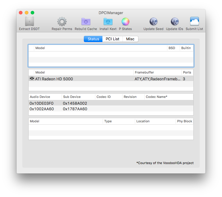

And what about audio? I installed VoodoHDA 2.8.8 which didn't work...

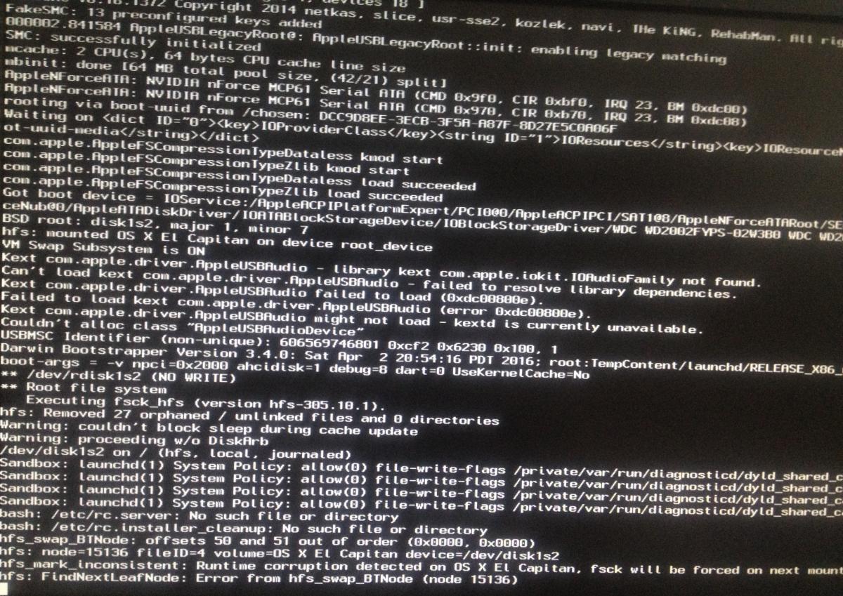

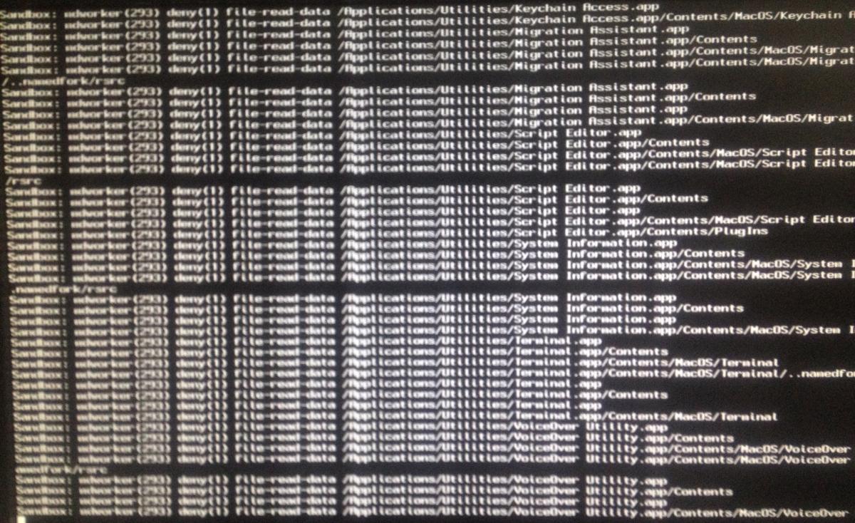

I tried updating to 10.11.6 but it stuck on what is shown in the first picture.
After rebooting it stuck on what is shown on the second picture. I used kernel that was from 10.11.5 installation, 'cuz RC4 just doesn't work.
Did you re-modify/replace and original Apple kexts after the update? Seems something got corrupted. Also your Audio is the same as me ALC662 so use these two files.
That's the thing - nope. Only changes I made was to AppleRTC and System.kext. Maybe I need updated kernel for 10.11.6?
Also thing to note is that I updated using Mac App Store. Is that okay?
My RC4 kernel works on 10.11.6 with the System.kext. It's what I'm using and our system are very similar.

@ BuIlDaLiBlE
problem your system stop on:
hfs: findnextleafnode: error from hfs_swap_btnode (node 15136)
hfs_swap_BTNode: Offsets 50 and 51 out of order (0x0000, 0x0000)
node 15136 ==> volume = OS X El Capitan device=/dev/disk1s2
fsck is necessary!
When the Single User boot sequence has finished, you’ll find a small command prompt at the bottom of the screen prefixed by a hash sign (#), when you see that type the following command exactly:
fsck -fy
Once fsck completes, if you see a “File system was modified” message, then you should run “fsck -fy” again until you see a message stating “The volume OS X El Capitan appears to be OK” – this is standard procedure of using fsck
Type “reboot” to leave Single User Mode and boot the Mac back into OS X
Edit:
if these problems are not resolved by fsck. possibly, a DSDTpatch can help?
I can't boot to run it.
How not? Use the kernel that was working for you before.
