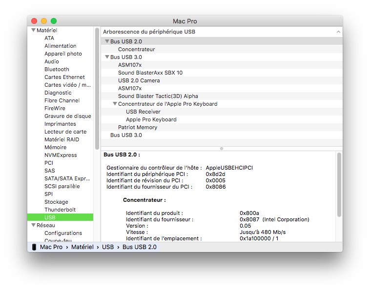

jamiethemorris Posted July 27, 2016 Share Posted July 27, 2016 Do I need the X79PlatformPlugin and LegacyUSBHub kexts in order for USB3 to work, or just X99_Injector? Link to comment https://www.insanelymac.com/forum/topic/309717-haswell-e-5820k-5930k-installation-guide-with-full-speedstep-working/page/6/#findComment-2258691 Share on other sites More sharing options...
Fljagd Posted July 27, 2016 Share Posted July 27, 2016 Do I need the X79PlatformPlugin and LegacyUSBHub kexts in order for USB3 to work, or just X99_Injector? I use only x99 injector and patch with clover Link to comment https://www.insanelymac.com/forum/topic/309717-haswell-e-5820k-5930k-installation-guide-with-full-speedstep-working/page/6/#findComment-2258743 Share on other sites More sharing options...

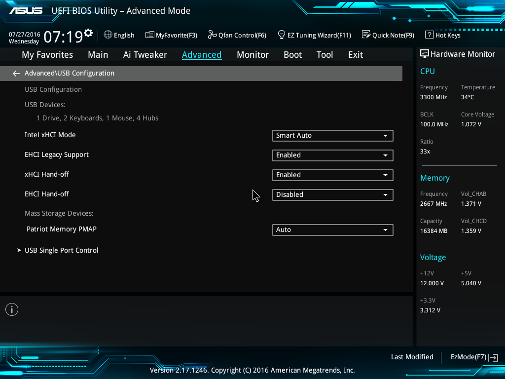

jamiethemorris Posted July 27, 2016 Share Posted July 27, 2016 I use only x99 injector and patch with clover Thanks, I'm dumb and probably should have just tested it. It's working though! Looks like El Capitan doesn't suffer from the XHCI interrupts that hurt performance like Yosemite did. I have XHCI set to enabled, should I or is it a good idea to set it to "Smart Auto" which only enables XHCI per-port based on whether it detects a USB3 device? Link to comment https://www.insanelymac.com/forum/topic/309717-haswell-e-5820k-5930k-installation-guide-with-full-speedstep-working/page/6/#findComment-2258752 Share on other sites More sharing options...
Fljagd Posted July 27, 2016 Share Posted July 27, 2016 My bios is in default Link to comment https://www.insanelymac.com/forum/topic/309717-haswell-e-5820k-5930k-installation-guide-with-full-speedstep-working/page/6/#findComment-2258754 Share on other sites More sharing options...
jamiethemorris Posted July 27, 2016 Share Posted July 27, 2016 My bios is in default Thanks, I'm gonna try this. I have a feeling my USB audio interfaces and such are going to bug out with USB3 permanently enabled. Link to comment https://www.insanelymac.com/forum/topic/309717-haswell-e-5820k-5930k-installation-guide-with-full-speedstep-working/page/6/#findComment-2258758 Share on other sites More sharing options...
