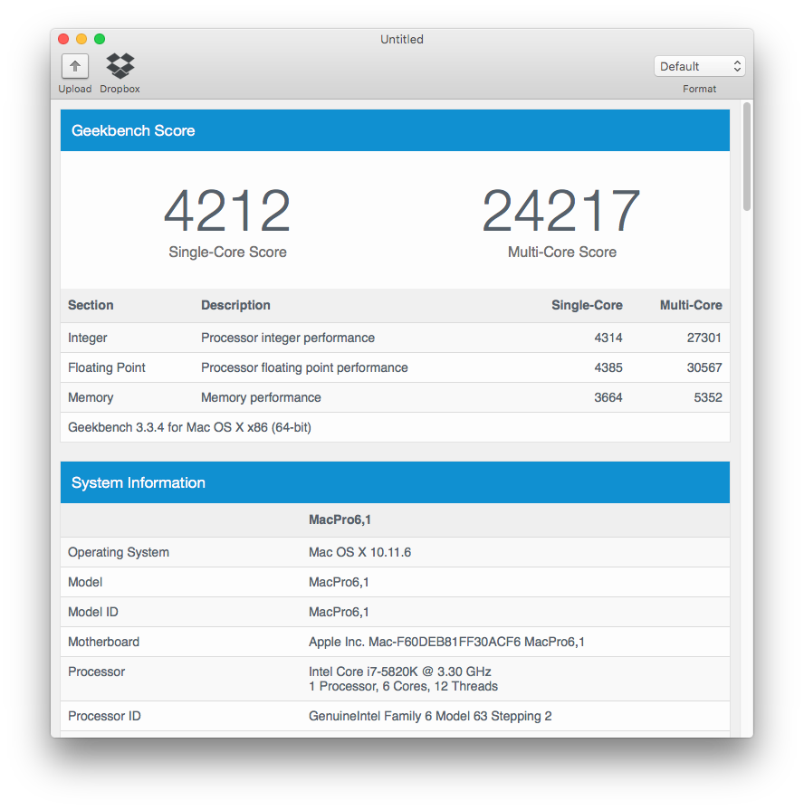

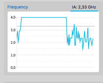

SammlerG Posted August 9, 2016 Share Posted August 9, 2016 yes, sysctl -n machdep.xcpm.mode returning 1 shows ist.And Intel power gadget shows 10W idle, and full load when running Geekbench.Scores are the same as before with FAKECPUID und NULLCPUPM.You can use a Hexeditor to find the Kernel HEX Code, then copy an paste the HEX string to clover and patch the location with the calculated HEX.Pike posted: 0x1bc276 replace 0xBB with 0xB3 (_cpuid_set_info:)for i7 6900k-> 0xBB - 0x08 = 0xB3 and so for Haswell-E i tried 0xBB - 0x03 = 0xB8and it worked for me same, but other position and HEX string, worked for Sierra. 2 Link to comment https://www.insanelymac.com/forum/topic/309717-haswell-e-5820k-5930k-installation-guide-with-full-speedstep-working/page/7/#findComment-2263452 Share on other sites More sharing options...
Fljagd Posted August 9, 2016 Share Posted August 9, 2016 same, but other position and HEX string, worked for Sierra. very wise I will look on that Link to comment https://www.insanelymac.com/forum/topic/309717-haswell-e-5820k-5930k-installation-guide-with-full-speedstep-working/page/7/#findComment-2263453 Share on other sites More sharing options...
AsusFreak Posted August 9, 2016 Share Posted August 9, 2016 Hmmm, what I see: Lose 5k in GB as CPU will no longer run max... No worries, just an observation. Link to comment https://www.insanelymac.com/forum/topic/309717-haswell-e-5820k-5930k-installation-guide-with-full-speedstep-working/page/7/#findComment-2263458 Share on other sites More sharing options...

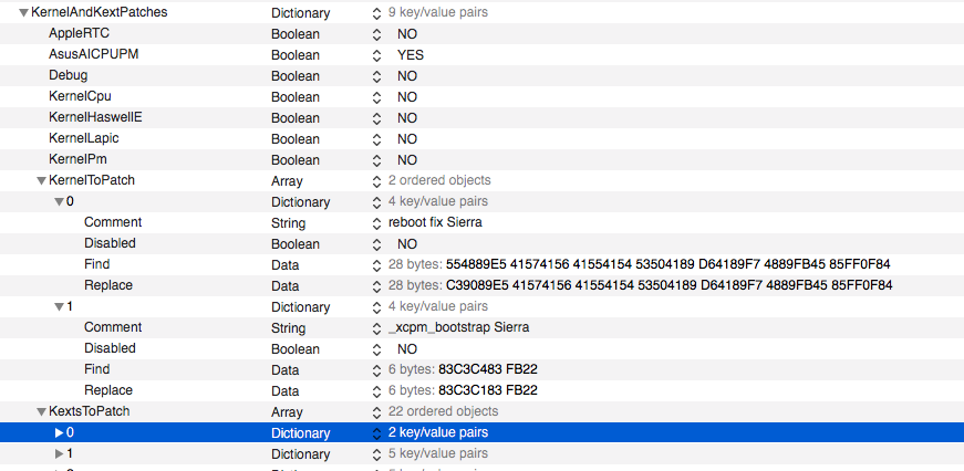

SammlerG Posted August 9, 2016 Share Posted August 9, 2016 <key>KernelToPatch</key> <array> <dict> <key>Comment</key> <string>_xcpm_bootstrap Sierra (c) Pike R. Alpha</string> <key>Disabled</key> <false/> <key>Find</key> <data> g8PEg/si </data> <key>Replace</key> <data> g8PBg/si </data> </dict> <dict> <key>Comment</key> <string>reboot fix Sierra (c) Pike R. Alpha</string> <key>Disabled</key> <false/> <key>Find</key> <data> VUiJ5UFXQVZBVUFUU1BBidZBifdIiftFhf8PhA== </data> <key>Replace</key> <data> w5CJ5UFXQVZBVUFUU1BBidZBifdIiftFhf8PhA== </data> </dict> <dict> <key>Comment</key> <string>_cpuid_set_info Sierra (c) Pike R. Alpha</string> <key>Disabled</key> <true/> <key>Find</key> <data> D7bEg8Dpg/hH </data> <key>Replace</key> <data> D7bEg8Dmg/hH </data> </dict> </array> this is for Sierra, i only need 2 of them, CPUid set is disabled. you need clover Rev 3661 or newer to patch your Kernel. Link to comment https://www.insanelymac.com/forum/topic/309717-haswell-e-5820k-5930k-installation-guide-with-full-speedstep-working/page/7/#findComment-2263461 Share on other sites More sharing options...
Fljagd Posted August 9, 2016 Share Posted August 9, 2016 <key>KernelToPatch</key> <array> <dict> <key>Comment</key> <string>_xcpm_bootstrap Sierra</string> <key>Disabled</key> <false/> <key>Find</key> <data> g8PEg/si </data> <key>Replace</key> <data> g8PBg/si </data> </dict> <dict> <key>Comment</key> <string>reboot fix Sierra</string> <key>Disabled</key> <false/> <key>Find</key> <data> VUiJ5UFXQVZBVUFUU1BBidZBifdIiftFhf8PhA== </data> <key>Replace</key> <data> w5CJ5UFXQVZBVUFUU1BBidZBifdIiftFhf8PhA== </data> </dict> <dict> <key>Comment</key> <string>_cpuid_set_info Sierra</string> <key>Disabled</key> <true/> <key>Find</key> <data> D7bEg8Dpg/hH </data> <key>Replace</key> <data> D7bEg8Dmg/hH </data> </dict> </array> great thanks a lot, Special mention for Pike Link to comment https://www.insanelymac.com/forum/topic/309717-haswell-e-5820k-5930k-installation-guide-with-full-speedstep-working/page/7/#findComment-2263476 Share on other sites More sharing options...
ergot Posted August 9, 2016 Share Posted August 9, 2016 <key>KernelToPatch</key> <array> <dict> <key>Comment</key> <string>_xcpm_bootstrap Sierra</string> <key>Disabled</key> <false/> <key>Find</key> <data> g8PEg/si </data> <key>Replace</key> <data> g8PBg/si </data> </dict> <dict> <key>Comment</key> <string>reboot fix Sierra</string> <key>Disabled</key> <false/> <key>Find</key> <data> VUiJ5UFXQVZBVUFUU1BBidZBifdIiftFhf8PhA== </data> <key>Replace</key> <data> w5CJ5UFXQVZBVUFUU1BBidZBifdIiftFhf8PhA== </data> </dict> <dict> <key>Comment</key> <string>_cpuid_set_info Sierra</string> <key>Disabled</key> <true/> <key>Find</key> <data> D7bEg8Dpg/hH </data> <key>Replace</key> <data> D7bEg8Dmg/hH </data> </dict> </array>this is for Sierra, i only need 2 of them, CPUid set is disabled.you need clover Rev 3661 or newer to patch your Kernel. Thanks! I will try this today, BTW how to add it to clover plist? I don't remember that I see in my clover configurator Kernel to patch section... Link to comment https://www.insanelymac.com/forum/topic/309717-haswell-e-5820k-5930k-installation-guide-with-full-speedstep-working/page/7/#findComment-2263500 Share on other sites More sharing options...
SammlerG Posted August 9, 2016 Share Posted August 9, 2016 @ergot you need clover Rev 3661 or newer to patch your Kernel. and newest clover config creator if you want to do this in HEX with clover. And remember, the format in the .plist file is Base64, and the format in clover config creator is HEX! Link to comment https://www.insanelymac.com/forum/topic/309717-haswell-e-5820k-5930k-installation-guide-with-full-speedstep-working/page/7/#findComment-2263525 Share on other sites More sharing options...
ergot Posted August 9, 2016 Share Posted August 9, 2016 @ergot and newest clover config creator if you want to do this in HEX with clover. And remember, the format in the .plist file is Base64, and the format in clover config creator is HEX! Thanks! I actually added it manually with PlistEdit I boot and I have it working,sysctl -n machdep.xcpm.mode show =1 WHEN I SEARCH IN CONSOL FOR XCPM I don't find it...is that OK?\BTW I have the latest clover. Sleep is working OK now, I cannot see the sleep settings in system pref but I can change it via terminal with sudo systemsetup -setcomputersleep (0-180) But when running peset -g system sleep show 1 (I choose 10min), also in system report under power it show 1 Is that a bug in SW or I am missing something? Thanks Link to comment https://www.insanelymac.com/forum/topic/309717-haswell-e-5820k-5930k-installation-guide-with-full-speedstep-working/page/7/#findComment-2263537 Share on other sites More sharing options...

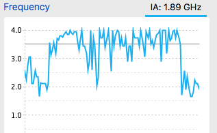

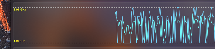

maleorderbride Posted August 11, 2016 Share Posted August 11, 2016 I added the three patches, removed Null, VoodooTSCSync, and it seems like the exact same performance as running just 10.11.6 without doing anything. I have a lower GB and random fluctuations in speed instead of sustained turbo. Can someone who has this "working" post their config.plist? Perhaps I am doing something wrong, but it also seems like there is something missing here. I would like to see GB/Cinebench scores with Intel Power Gadget readouts from anyone who says it is working. Don't get me wrong, it is possible to get good scores without doing anything in 10.11.6, but they are like 5% of the benchmarks and have wide variance. 1 Link to comment https://www.insanelymac.com/forum/topic/309717-haswell-e-5820k-5930k-installation-guide-with-full-speedstep-working/page/7/#findComment-2264205 Share on other sites More sharing options...
AsusFreak Posted August 11, 2016 Share Posted August 11, 2016 I added the three patches, removed Null, VoodooTSCSync, and it seems like the exact same performance as running just 10.11.6 without doing anything. I have a lower GB and random fluctuations in speed instead of sustained turbo. Can someone who has this "working" post their config.plist? Perhaps I am doing something wrong, but it also seems like there is something missing here. I would like to see GB/Cinebench scores with Intel Power Gadget readouts from anyone who says it is working. Don't get me wrong, it is possible to get good scores without doing anything in 10.11.6, but they are like 5% of the benchmarks and have wide variance. Yep, same here. Tested with both 10.11.6 and 10.12 DP4/DP5. Lost 5k on GB scores and can no longer max cpu. Haven't seen anyone post any real verification that it really works. Link to comment https://www.insanelymac.com/forum/topic/309717-haswell-e-5820k-5930k-installation-guide-with-full-speedstep-working/page/7/#findComment-2264206 Share on other sites More sharing options...
