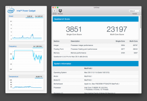

FrankPaulThe2nd Posted January 4, 2017 Share Posted January 4, 2017 Hi (again) guys, I wanted to share with you my config.plist, my geekbench score, along with some issues I have and hope someone would be so kind to help me in the process of fine tuning: STEPS DONE TO INSTALL EL CAPITAN 10.10.6: • To install I’ve followed the motionworks’ guide. • Then I’ve used some parts of the stinga11’s guide (this thread), to make USB 3.0 work (installing in S/L/E the x99_Injector.kext provided by him and applying in Clover the binary patch from arix98) and to make audio work (using his binary patch in Clover and installing in S/L/E the AppleHDA.kext provided by him). Unfortunately, the other stuff mentioned didn’t work for me (for sure I did something wrong ). • I’ve copy/pasted in Clover the kernel patches from Pike R. Alpha as kindly illustrated from SammlerG. • I’ve followed the “explained” version of the mentioned post from SammlerG, written by maleorderbride, with some other detailed steps to perform. Here I don’t know If I got everything correct: although Pike R. Alpha’s guide to his FrequencyVectorEdit.sh command is based on a SMBIOS of a MacPro6,1, when I’ve launched the command there were no option for a board-ID of a MacPro6,1. So I ended up using the one for the iMac14,2. BIOS SETTINGS (Default values except for the following): AI Tweaker • CPU Core Ratio –> Sync All Cores • Core Ratio Limit –> Auto Advanced • EIST –> Disabled • CPU C-States –> Enabled • EHCI Hand-off –> Enabled Boot • Launch CSM –> Disabled • OS Type –> Other OS CLOVER SETTINGS: See attached config.plist CLOVER DRIVERS AND KEXTS: drivers64UEFI • DataHubDxe-64 • EmuVariableUefi-64 • FSInject-64 • HFSPlus • OsxAptioFixDrv-64 • OsxFatBinaryDrv-64 kexts • FakeSMC MAC OS 10.11.6 KEXTS: • AppleHDA (brought by Stinga11 as for the #1 post) • FakeSMC with Plug-ins• X99_Injector (brought by Stinga11 as for the #1 post) AND FINALLY SOME QUESTIONS FOR YOU GUYS : • Sometimes I still have some KP on “cold” boot. But, when I reboot, it always goes fine. This is the most “unstable” thing of all my system. Attached a screenshot. Do you guys experienced something like that? • Sleep functions don’t work. If I put to sleep the system, It wakes up, but before reaching again my desktop, it does reboot. • I do not have SSDT in my EFI/Clover/ACPI/Patched. I didn’t find any difference with or without it. Is this a problem for the overall stability of the system? • Do you have some advice about BIOS or Clover settings, considering I’m about to reconnect my Windows 7 UEFI SSD and I’m not an OC guy? • Is there a better way of using the FrequecyVectorEdit.sh command other than with the iMac14,2, considering my hardware and that I have a MacPro6,1 SMBIOS definition? Besides these questions, any help or advice to refine my installation would be much appreciated. Thank you very much! An old noob config.plist.zip Link to comment https://www.insanelymac.com/forum/topic/309717-haswell-e-5820k-5930k-installation-guide-with-full-speedstep-working/page/15/#findComment-2344722 Share on other sites More sharing options...
Absolutelight Posted April 23, 2017 Share Posted April 23, 2017 Hi (again) guys, I wanted to share with you my config.plist, my geekbench score, along with some issues I have and hope someone would be so kind to help me in the process of fine tuning: Hello I make working 5930k 4200 mghz 27000 geek score (there is vectors mac 6.1 modfication was made and ssdt aml with "-a cpu0 -6300" flags) sleep works If u want acpi patched folder, config.plist and kexts folder - I can give Link to comment https://www.insanelymac.com/forum/topic/309717-haswell-e-5820k-5930k-installation-guide-with-full-speedstep-working/page/15/#findComment-2410769 Share on other sites More sharing options...
