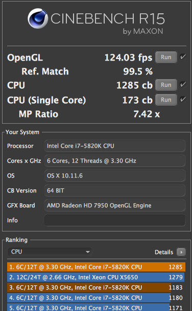

Mystroe Posted August 11, 2016 Share Posted August 11, 2016 Using Pike's methods as expounded by Samler and Maleorder. Many thanks! I'm running with SMBIOS 5.1 Speed doesn't drop off when system is idling.. not sure if I've got Pike's freqVectors running correctly Link to comment https://www.insanelymac.com/forum/topic/309717-haswell-e-5820k-5930k-installation-guide-with-full-speedstep-working/page/8/#findComment-2264566 Share on other sites More sharing options...
maleorderbride Posted August 11, 2016 Share Posted August 11, 2016 Mystroe, try using a MacPro6,1 SMBIOS (and re-doing the freqvector) if you want the temp and idle speed to drop more. Are you on 5,1 just to avoid the GFX0/1 unloading from AppleGraphicsControl? 1 Link to comment https://www.insanelymac.com/forum/topic/309717-haswell-e-5820k-5930k-installation-guide-with-full-speedstep-working/page/8/#findComment-2264587 Share on other sites More sharing options...

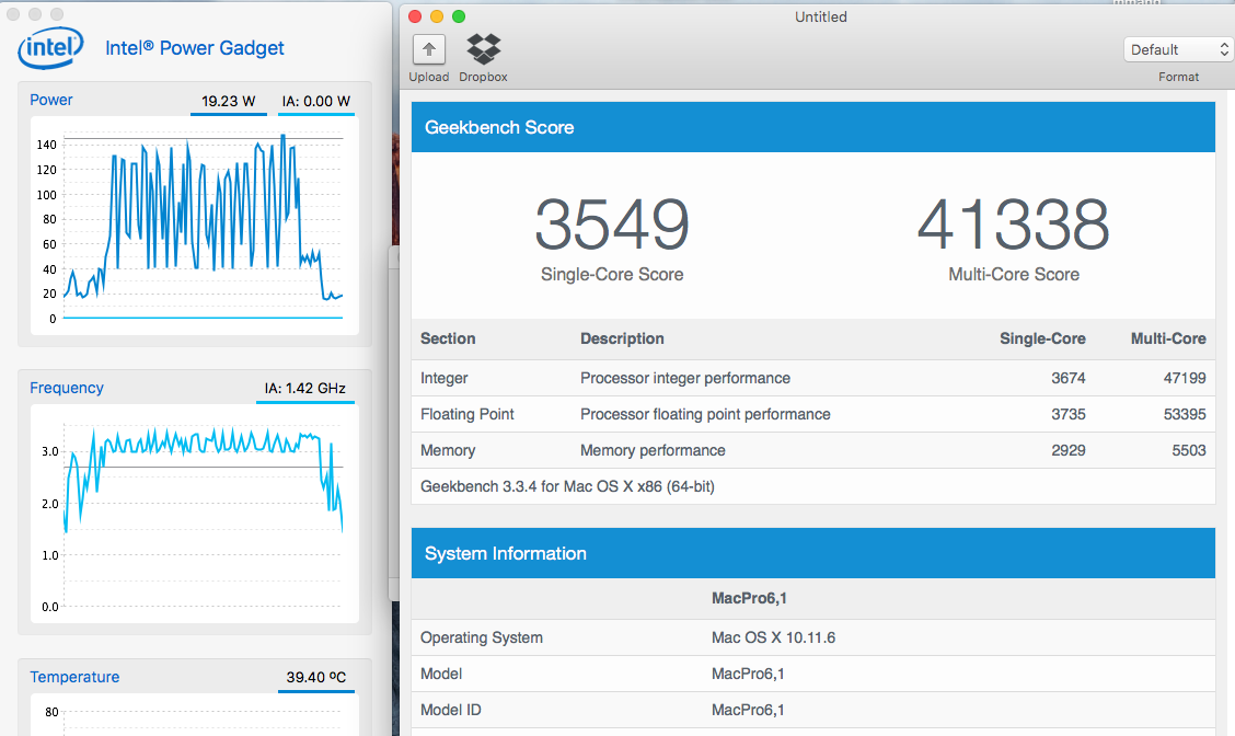

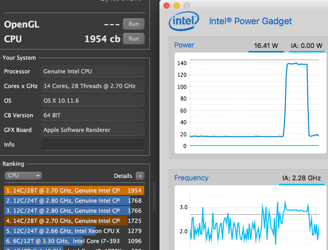

maleorderbride Posted August 12, 2016 Share Posted August 12, 2016 Has anyone worked this out for 10.11? Or are you all on 10.12? My post with instructions is for 10.11.6. @ergot, Did you install the latest version of Clover? I have only two builds, both Xeons, and this method results in full CPU performance in both. Although, oddly, for my 12-core 2.8Ghz Xeon, I am stuck at 3.1GHz (the max all core turbo) all the time. Link to comment https://www.insanelymac.com/forum/topic/309717-haswell-e-5820k-5930k-installation-guide-with-full-speedstep-working/page/8/#findComment-2264653 Share on other sites More sharing options...
dashbad Posted August 12, 2016 Share Posted August 12, 2016 yes, sysctl -n machdep.xcpm.mode returning 1 shows ist. And Intel power gadget shows 10W idle, and full load when running Geekbench. Scores are the same as before with FAKECPUID und NULLCPUPM. You can use a Hexeditor to find the Kernel HEX Code, then copy an paste the HEX string to clover and patch the location with the calculated HEX. Pike posted: 0x1bc276 replace 0xBB with 0xB3 (_cpuid_set_info:)for i7 6900k -> 0xBB - 0x08 = 0xB3 and so for Haswell-E i tried 0xBB - 0x03 = 0xB8 and it worked for me same, but other position and HEX string, worked for Sierra. Can you link to the pike post where he shows these replacements? All I can find on his blog is the post for Sierra which quotes different locations. How did you get the locations for 10.11.6? Link to comment https://www.insanelymac.com/forum/topic/309717-haswell-e-5820k-5930k-installation-guide-with-full-speedstep-working/page/8/#findComment-2264665 Share on other sites More sharing options...

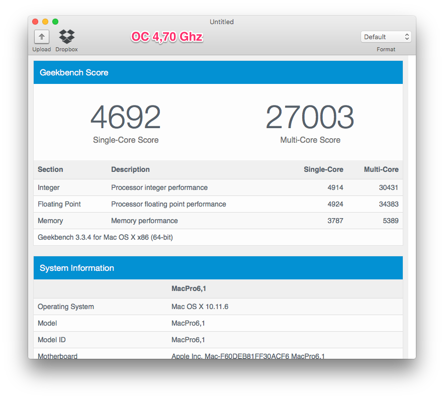

Fljagd Posted August 12, 2016 Share Posted August 12, 2016 What I appreciate with the patch PikerAlpha a better ability to OC (Turbo) a stability to the entire ordeal Link to comment https://www.insanelymac.com/forum/topic/309717-haswell-e-5820k-5930k-installation-guide-with-full-speedstep-working/page/8/#findComment-2264694 Share on other sites More sharing options...

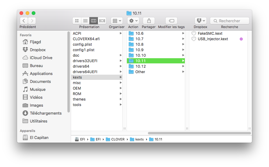

SammlerG Posted August 12, 2016 Share Posted August 12, 2016 Do you know what the equivalent would be for 10.10.5? no, for 10.10.5 i have no idea, and i don´t use 10.10.5. You are not going to believe this, but I have the same mother board (5960X) and you don´t need any USB kext. The USB ports works directly in 10.11.6 and last 10.12 I suspect this is happening in some other boards I don´t need: X99_Injector, AHCIPortInjector, AHCI_Intel_Generic_SATA, The OSX makes everything work correctly... Your Bluetooth won´t work, but you just need a tiny piece of kext to make it work... https://drive.google.com/folderview?id=0B31Tsmyt5KCuZG5VSDJJaW16Mlk&usp=sharing Best You are right, i don´t need the AHCI kexts. Thx! But without the USB injector, all my USB ports only work with 2.0 speed? And all connected devices shown under USB 2.0 Bus, the USB 3.0 Bus is empty? Link to comment https://www.insanelymac.com/forum/topic/309717-haswell-e-5820k-5930k-installation-guide-with-full-speedstep-working/page/8/#findComment-2264718 Share on other sites More sharing options...
Fljagd Posted August 12, 2016 Share Posted August 12, 2016 with 5820K not need voodootscSync since El Capitan Link to comment https://www.insanelymac.com/forum/topic/309717-haswell-e-5820k-5930k-installation-guide-with-full-speedstep-working/page/8/#findComment-2264721 Share on other sites More sharing options...
