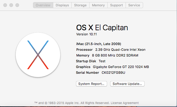

polyzargone Posted October 7, 2015 Share Posted October 7, 2015 Thanks, i did all that was suggested  : - used Chris's Installer - used your DSDT and config.plist (with CsrActiveConfig 0x3) - Clover v3270 instead v3259 - and i injected nVidia for QE/CI  Everything booted and worked fine (except for 2 USBs, of course, and i didn't test seep/wake and stby). But as soon as i tried to delete CPU info (and later change SMbios) from config.plist i got panics, waiting for root, or reboot loop.  Given that with your DSDT i don't have to use any other fixes for SATA operation, i can put it, finally, to AHCI and it mounts HDD right away,  is anyone willing to patch/compile my DSDT for that AHCI fix? I think that it is simple ICH9 to ICH10 thing...?  IMG_0658.jpg  I have extracted DSDT and all six SSDT's (with Linux Live CD), but as soon as i start fixing errors and compiling i get kernel panics. From ML, through Mav and Yose to El Capt. So obviously i still don't know how to do that. Anyone interested in helping with that? acpidump.zip  Well, I'm not sure to understand what you want. Is there any problem with the DSDT that prevent you from using it ?  Also, you said you have 2 USB ports not working. They should if you use USB_Injector.kext supplied in the post #1. If that's indeed the case, please confirm because it would mean that the kext is not completely ready .  Lastly, you said you change SMBios… For what ?  It's very important to use iMac10,1 SMBios because otherwise, the USB_Injector.kext won't work. It's specifically design for that particular SMBios. If you wish to change it, you have to edit the USB_Injector.kext/Contents/Info.plist and modify matching occurrences to whatever you want. Link to comment https://www.insanelymac.com/forum/topic/308097-guide-el-capitan-1011x-dell-optiplex-780-760-755-790-990/page/4/#findComment-2174529 Share on other sites More sharing options...

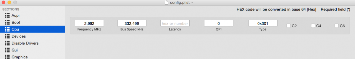

owbp Posted October 7, 2015 Share Posted October 7, 2015 @polyzargone,Thanks for your patience and sorry it's going this slow. I'll now install El Capitan from scratch, and report everything the same way I would if i had 780 or 760.   Well, I'm not sure to understand what you want. Is there any problem with the DSDT that prevent you from using it ? Not that i know, I just have in mind what Allan told me few months ago in this post, never to use any DSDT if hardware is different (CPU, RAM, Memory...)?    Also, you said you have 2 USB ports not working. They should if you use USB_Injector.kext supplied in the post #1. If that's indeed the case, please confirm because it would mean that the kext is not completely ready . I'll test it with your SMBios ASAP and report!   Lastly, you said you change SMBios… For what ? I have working MacPro3,1 (iMessage and all) so i thought i keep it, but ill test this on iMac10,1. Regarding that, can i change serial and board number in iMac 10,1 smbios? Will it affect  USB_Injector.kext or is it just important to keep iMac 10,1?  One more thing, what should i do with these two things in config.plist: Since i have Core2Quad Q6600, and with this: Since GT220 works with just Inject nVidia?  Link to comment https://www.insanelymac.com/forum/topic/308097-guide-el-capitan-1011x-dell-optiplex-780-760-755-790-990/page/4/#findComment-2174693 Share on other sites More sharing options...

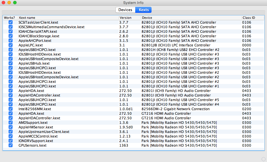

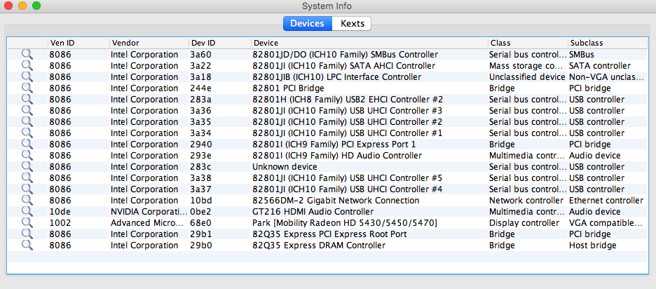

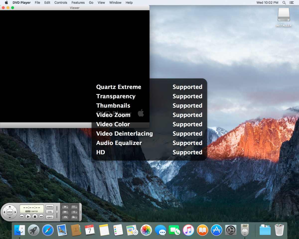

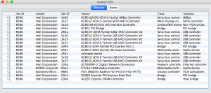

owbp Posted October 7, 2015 Share Posted October 7, 2015 Ok, I reinstalled El Capitan, deleted all entries in config.plist regarding CPU and GPU and installed all kexts.   As you can see, i have mix of ICH8, 9 and 10 controllers. Only ICH10's are working, so no DVD reader error when opening DVD Player (ICH9), no HDA (ICH9) and no USB (ICH8). Also, HDMI is GT220 (216) and video controller is HD Radeon, so no graphics acceleration also (and choppy as hell).  I assume those are DSDT related? Link to comment https://www.insanelymac.com/forum/topic/308097-guide-el-capitan-1011x-dell-optiplex-780-760-755-790-990/page/4/#findComment-2174783 Share on other sites More sharing options...

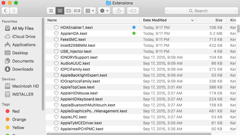

polyzargone Posted October 7, 2015 Share Posted October 7, 2015 @owbp  Try this one and report .  PS : I see that kexts like HDAEnabler1.kext (useless with correct DSDT), USB_Injector.kext, FakeSMC.kext and Intel82566MM.kext are placed in Extensions folder where they should be placed in EFI/CLOVER/kexts/10.11 folder.  It's best to leave S/L/E untouched but not a big deal though… Generic_DSDT.aml.zip Link to comment https://www.insanelymac.com/forum/topic/308097-guide-el-capitan-1011x-dell-optiplex-780-760-755-790-990/page/4/#findComment-2174789 Share on other sites More sharing options...

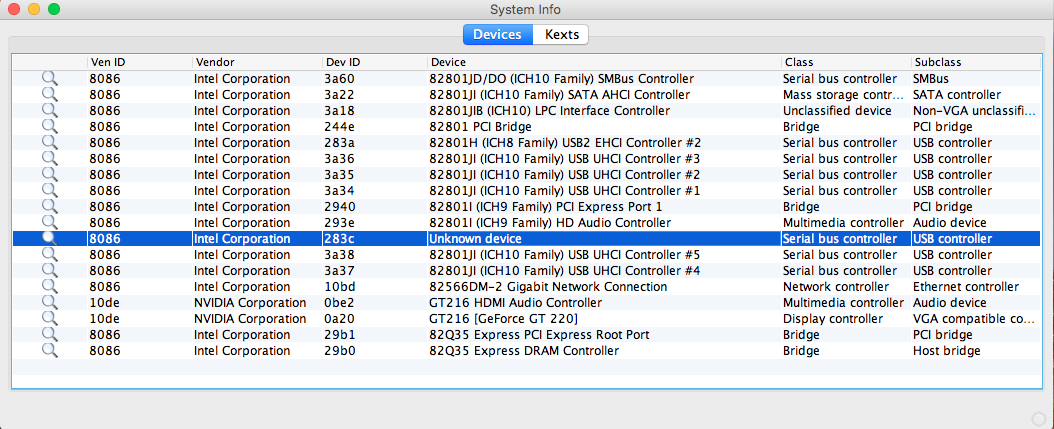

owbp Posted October 7, 2015 Share Posted October 7, 2015 Full QE/CI!  Still no USB or HDA, but now it sleeps and wakes like a champ. Link to comment https://www.insanelymac.com/forum/topic/308097-guide-el-capitan-1011x-dell-optiplex-780-760-755-790-990/page/4/#findComment-2174794 Share on other sites More sharing options...
polyzargone Posted October 7, 2015 Share Posted October 7, 2015 Nice. Â USB should work. I don't know why it doesn't. But you need to be more explicit : how many and where are the ports that do not work ? Â AppleHDA should also work. Are you sure you installed AppleHDA version 3 in S/L/E ? Â This one must be placed in that folder and not elsewhere, especially in EFI/CLOVER/kexts/10.11 ! Also, make sure to rebuild the cache using Kext Wizard after install and before reboot ! Â Sorry, I forgot to insist on that in my previous post. Link to comment https://www.insanelymac.com/forum/topic/308097-guide-el-capitan-1011x-dell-optiplex-780-760-755-790-990/page/4/#findComment-2174797 Share on other sites More sharing options...

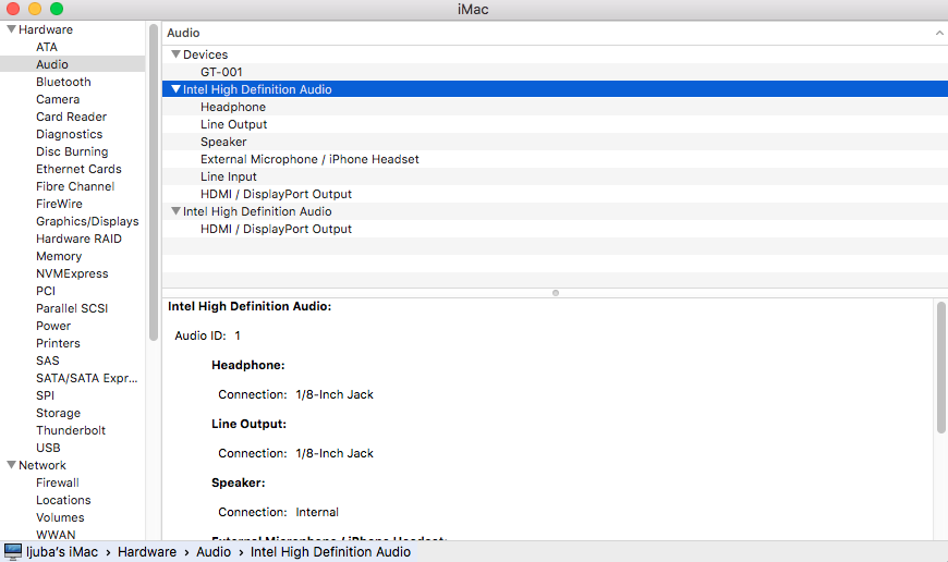

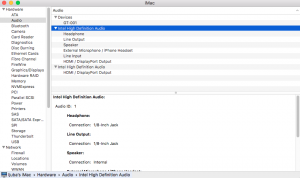

InfintyGhost Posted October 7, 2015 Share Posted October 7, 2015 Onboard AppleHDA Sound is working guys! Line Out, and HDMI.   Make sure you are not using the HDADisabler.kext that was needed with Voodoo Sound.  Is Line Out in your Sound Preference Pane?  Try HDAEnabler.kext  Edit:  There was an incorrect HDEF device error in the DSDT that was in original Clover Folder. This caused AppleHDASound problem  The DSDT was corrected by polyzargone, and DSDT was changed in Clover Folder very late last night.  There are 2 solutions here.  Use the corrected DSDT,  place in EFI/EFI/Clover/ACPI/Patched  or, using the attached HDAEnabler.kext should also enable AppleHDA Sound. This DSDT And HDAEnabler.kext works perfectly, Thank you for all your help  InfinityGhost 1 Link to comment https://www.insanelymac.com/forum/topic/308097-guide-el-capitan-1011x-dell-optiplex-780-760-755-790-990/page/4/#findComment-2174835 Share on other sites More sharing options...
polyzargone Posted October 7, 2015 Share Posted October 7, 2015 @InfinityGhost  Good to hear .  Now, there's one thing you can try : remove HDAEnabler.kext and rebuild the cache using Kext Wizard. The corrected DSDT should eliminate the need to use this kext.  Note that you can also leave it, but why use a kext when it's not needed ?  If that fails, you can still reinstall it. 1 Link to comment https://www.insanelymac.com/forum/topic/308097-guide-el-capitan-1011x-dell-optiplex-780-760-755-790-990/page/4/#findComment-2174843 Share on other sites More sharing options...

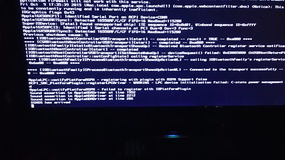

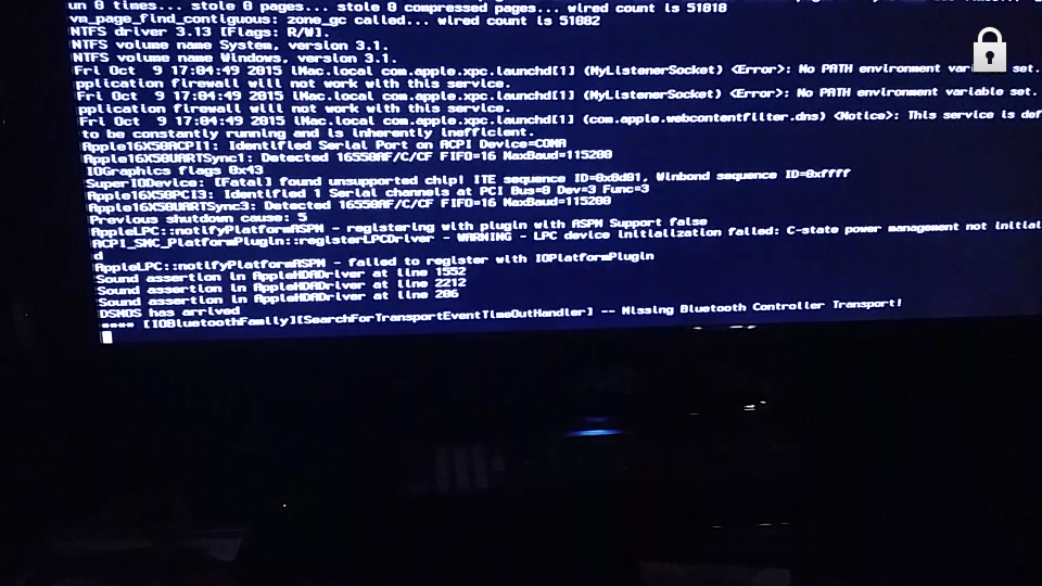

jakeyg1 Posted October 10, 2015 Share Posted October 10, 2015 Hey I'm replying to this as I'm stuck because i get the following message in the attached file when trying to boot OS X from USB Installer  i have an Dell Optiplex 760 AMD Radeon HD5450 BIOS A16 and fakesmc.kext is in the EFI/Clover/Kexts/10.11  Dooes anyone know what is wrong have i done something wrong  PLEASSEE HELPP I've search everywhere and nothing is working Link to comment https://www.insanelymac.com/forum/topic/308097-guide-el-capitan-1011x-dell-optiplex-780-760-755-790-990/page/4/#findComment-2175856 Share on other sites More sharing options...
morpheousman Posted October 10, 2015 Author Share Posted October 10, 2015 Are your Bios settings correct? Â Sata Operation Set to AHCI in Bios? Â What CPU do you have? Â Did you delete the entire Clover Folder In the USB EFI/EFI folder, and replace with Clover folder in attachment? Link to comment https://www.insanelymac.com/forum/topic/308097-guide-el-capitan-1011x-dell-optiplex-780-760-755-790-990/page/4/#findComment-2175881 Share on other sites More sharing options...
jakeyg1 Posted October 10, 2015 Share Posted October 10, 2015 Yes I didn't have to change it as it was already in AHCI and yes I did replace the clover folder and I have an Intel pentium dual core processor Link to comment https://www.insanelymac.com/forum/topic/308097-guide-el-capitan-1011x-dell-optiplex-780-760-755-790-990/page/4/#findComment-2175883 Share on other sites More sharing options...
morpheousman Posted October 10, 2015 Author Share Posted October 10, 2015 What CPU do you have? Â Did you delete the entire Clover Folder In the USB EFI/EFI folder, and replace with Clover folder in attachment? Link to comment https://www.insanelymac.com/forum/topic/308097-guide-el-capitan-1011x-dell-optiplex-780-760-755-790-990/page/4/#findComment-2175887 Share on other sites More sharing options...
jakeyg1 Posted October 10, 2015 Share Posted October 10, 2015 I have an Intel pentium dual core processor and I did replace the clover folder this is why I don't get what's going on haha Link to comment https://www.insanelymac.com/forum/topic/308097-guide-el-capitan-1011x-dell-optiplex-780-760-755-790-990/page/4/#findComment-2175889 Share on other sites More sharing options...
morpheousman Posted October 10, 2015 Author Share Posted October 10, 2015 I just did a quick check, and I deleted the clover folder from my USB installer, and replaced with attached Clover folder, and after reboot, it took about two minutes to reach the install OS X El Capitan screen. Â So the Clover Folder is good,must be something in your hardware. Link to comment https://www.insanelymac.com/forum/topic/308097-guide-el-capitan-1011x-dell-optiplex-780-760-755-790-990/page/4/#findComment-2175906 Share on other sites More sharing options...
jakeyg1 Posted October 10, 2015 Share Posted October 10, 2015 Well I don't know if this helps but I had this other issue that's in the attachment but I fixed it by putting a usb bluetooth adapter into my computer Link to comment https://www.insanelymac.com/forum/topic/308097-guide-el-capitan-1011x-dell-optiplex-780-760-755-790-990/page/4/#findComment-2175911 Share on other sites More sharing options...
morpheousman Posted October 10, 2015 Author Share Posted October 10, 2015 Not sure what Bluetooth Adapter has  to do with USB installer.  You might want to go into BIOS and do a complete reset of bios. Then change SATA to AHCI.  USB installer should not be freezing up like that. You might even want to try using a different USB Drive and making a new installer. Could have some bad spots on the USB drive. Link to comment https://www.insanelymac.com/forum/topic/308097-guide-el-capitan-1011x-dell-optiplex-780-760-755-790-990/page/4/#findComment-2175928 Share on other sites More sharing options...
jakeyg1 Posted October 10, 2015 Share Posted October 10, 2015 I tried resetting bios then changing sata to AHCI and another usb drive tried that to I'm confused man this is annoying lmao And it doesn't freeze as soon as one of them lines come up I get a black screen then lose monitor connection Link to comment https://www.insanelymac.com/forum/topic/308097-guide-el-capitan-1011x-dell-optiplex-780-760-755-790-990/page/4/#findComment-2175932 Share on other sites More sharing options...

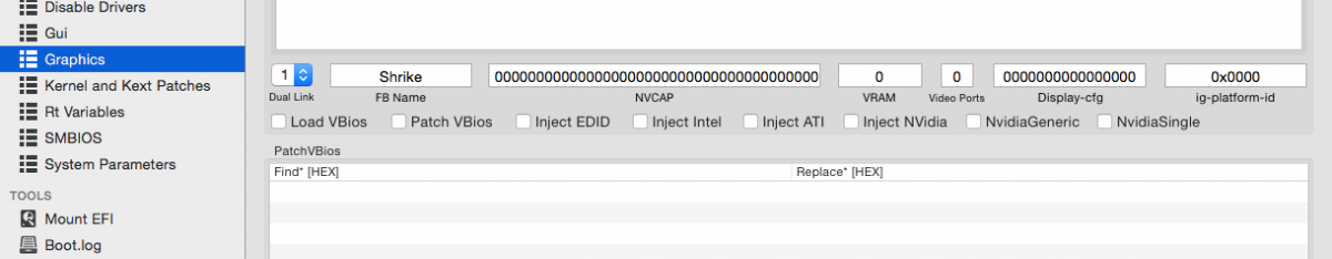

MacPeet Posted October 10, 2015 Share Posted October 10, 2015 Is more like graphics problem Do you have any current DSDT? Link to comment https://www.insanelymac.com/forum/topic/308097-guide-el-capitan-1011x-dell-optiplex-780-760-755-790-990/page/4/#findComment-2175937 Share on other sites More sharing options...
jakeyg1 Posted October 10, 2015 Share Posted October 10, 2015 I just followed the guide to make the usb installer and did everything it told me to do Link to comment https://www.insanelymac.com/forum/topic/308097-guide-el-capitan-1011x-dell-optiplex-780-760-755-790-990/page/4/#findComment-2175939 Share on other sites More sharing options...
polyzargone Posted October 10, 2015 Share Posted October 10, 2015 Try to remove everything in Graphics using Clover Configurator. Link to comment https://www.insanelymac.com/forum/topic/308097-guide-el-capitan-1011x-dell-optiplex-780-760-755-790-990/page/4/#findComment-2175981 Share on other sites More sharing options...
jakeyg1 Posted October 10, 2015 Share Posted October 10, 2015 How would one do that sorry? I've got clover configurator open ? Link to comment https://www.insanelymac.com/forum/topic/308097-guide-el-capitan-1011x-dell-optiplex-780-760-755-790-990/page/4/#findComment-2175984 Share on other sites More sharing options...
