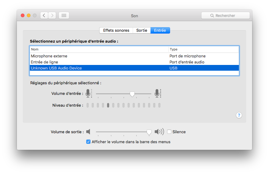

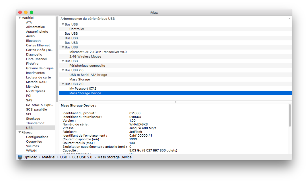

polyzargone Posted October 4, 2015 Share Posted October 4, 2015 OK USB ? Done . New method : No more DummyUSBEHCIPCI.kext, welcome to USB_Injector.kext ! Thanks to this thread. All credits goes to PJalm & Wegface . So delete any DummyUSBEHCIPCI.kext wherever it is, rebuild cache then place USB_Injector.kext in EFI/CLOVER/kexts/10.11 Add this in your config.plist to find and replace any occurrence of EHC1/EHC2 to EH01/EH02 in DSDT. <key>Name</key> <string>DSDT.aml</string> <key>Patches</key> <array> <dict> <key>Comment</key> <string>EHC2 to EH02</string> <key>Find</key> <data> RUhDMg== </data> <key>Replace</key> <data> RUgwMg== </data> </dict> <dict> <key>Comment</key> <string>EHC1 to EH01</string> <key>Find</key> <data> RUhDMQ== </data> <key>Replace</key> <data> RUgwMQ== </data> </dict> </array> That's it. All USB ports should now work at full speed and correctly mount as external devices (for storage devices). Please, test and report . NB : the attached config.plist is not designed for AMD Radeon HD cards. You'll have to edit it to match your current system (InjectATI, FB name etc.) or use your own and add provided DSDT patch to it. NB 2 : Do NOT change iMac10,1 SMBios definition otherwise it won't work. If you wish to use another definition, you'll have to edit matching occurrences in USB_Injector.kext info.plist ! With the help and suggestions of everyone, I would like to start editing the first post as a Guide. Not sure if we want to go back to step by step process for making USB Installer as in Post #2 of Yosemite Guide. I like the idea of using chris1111's app. Maybe he can help us with a custom app with our needed Clover Folder? It seems a lot less problems making the USB Pen. Maybe after that we can start with install instructions for El Capitan, and then installing Clover on the hard drive? What do you guys think? Hopefully, we are now ready to unleash the beast . When we have confirmation that USB_Injector.kext works fine, then we (you ) could start writing the guide. Concerning the DSDT, my point is that we could (should ?) propose both of them. A generic one that would possibly needs to be fine tuned to work on every system and one specifically designed for AMD Radeon HD 5450 users that already exists and is fully working for most of us regardless the FB name/video connector type we want to use… Because once again, the Generic one just work for both AMD and NVIDIA ( testers, testers, where are you ?) users AFAIK… Passing the installation step is what we need to focus on, fine tuning is for another thread IMHO. config.plist.zip USB_Injector.kext.zip 1 Link to comment https://www.insanelymac.com/forum/topic/308097-guide-el-capitan-1011x-dell-optiplex-780-760-755-790-990/page/2/#findComment-2173092 Share on other sites More sharing options...
morpheousman Posted October 4, 2015 Author Share Posted October 4, 2015 Report; All USB ports appear to be working correctly using your config. I tried to patch my config several times, only to get all 8 USB Ports NOT working. lol I wonder what I am missing there? Also, I see you have CSR set to 0x67 in your config, is this correct, or should it be set to 0x03. Will need a little more time to see how this all works with sleep/wake from sleep. You know I will be sure to report any issues with those. Update! Well this was was certainly a buzz-kill! Computer would not completely sleep. Hard drive would not sleep. Then the monitor would not wake up. After doing a hard-reboot, the Bios did not see either of my hard drives. I unplugged power for a few seconds while holding down power button. Plugged back in, and bios still did not see either of my Hard Drives. Finally left unplugged for a couple of minutes, then plugged back in and bios finally saw my hard drives. Back to old config, will do more testing later..... maybe! lol Link to comment https://www.insanelymac.com/forum/topic/308097-guide-el-capitan-1011x-dell-optiplex-780-760-755-790-990/page/2/#findComment-2173151 Share on other sites More sharing options...
