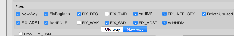

May I ask what's wrong in the DSDT ?

0x3 is OK even without 0x28. Never needed 0x28 and 0x67 with all my Hacks so far for every install I made… However, I agree ACPI fixes and Shrike FB may be confusing and/or useless for new users and for the install process.

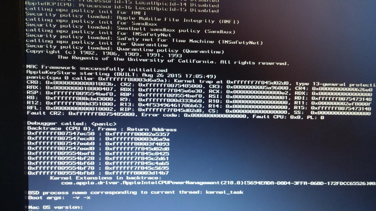

Has anyone had success using this method with the Optiplex 990 SFF? I have one with the below config:
CPU: Intel Core i3-2100 @3.10GHz
GPU: Sapphire Radeon HD5450 1GB
HDD: 250GB
AUDIO: RealTek ALC269
LAN: Intel 82579LM
RAM: 12GB
BIOS: A19
Serial Port Disabled
SATA Operation set to AHCI
All Visualization disabled
SMART Reporting disabled
Thanks
UPDATE:
Just tried to boot from the installer USB and got a Kernel Panic on com.apple.driver.AppleIntelCPUPowerManagement.
I tried using the DSDT for the 5450 and the Generic with no luck.
UPDATE 2:
I found a post in the history of this thread of someone who got this method to work on a 790 and so I used that clover folder. The only thing is now I can boot all the way to DSMOS has arrived and then the monitor turns off saying no signal just when I am supposed to see the installation wizard for OSX. I've tried to use both the HDMI, DVI and VGA ports on the video card.
UPDATE 3: I read back a few pages and noticed someone with the exact same card as mine was having the same issue. I happened to have a MSI 5450 on hand and put that one in and to my surprise the issue was immediately fixed and I was greeted with the language selection screen after the DSMOS has arrived prompt. I am not in the midst of installing El Capitan using the previously posted 790 Clover package by 'pepto'.
