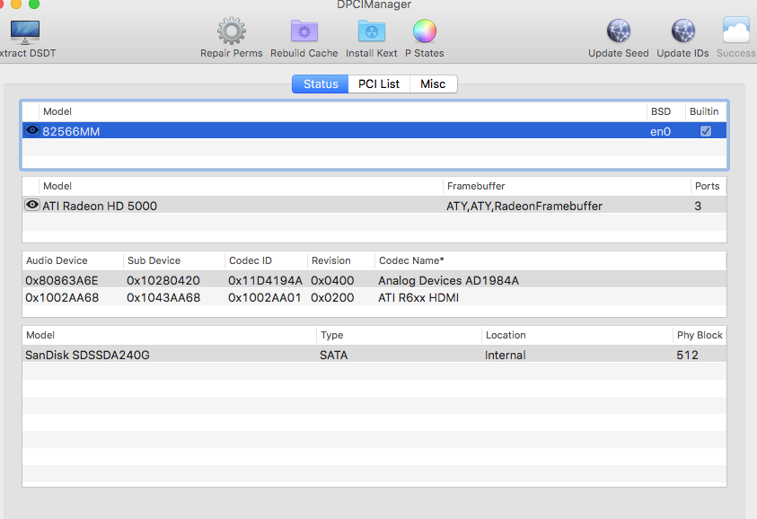

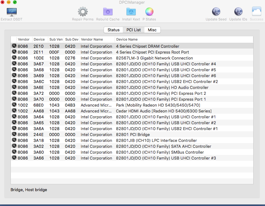

bclinton Posted February 28, 2016 Share Posted February 28, 2016 Hmm… Knowing the exact Realtek chipset and/or vendor/device ID could help a lot. Check in PCI List of DPCIManager and report. Meanwhile, you could have a look at the Realtek download page. Please see below....thanks! Link to comment https://www.insanelymac.com/forum/topic/308097-guide-el-capitan-1011x-dell-optiplex-780-760-755-790-990/page/27/#findComment-2219169 Share on other sites More sharing options...
polyzargone Posted February 28, 2016 Share Posted February 28, 2016 Well, forget what I said about DPCIManager. Your WIFI thumb is USB so there's no chance it'll appears in a software that displays PCI devices . Anyway, according to this page, your Realtek chipset is RTL8188SU. Therefore, you need to install the corresponding drivers available in the downloads page of Realtek I mentioned before. Link to comment https://www.insanelymac.com/forum/topic/308097-guide-el-capitan-1011x-dell-optiplex-780-760-755-790-990/page/27/#findComment-2219192 Share on other sites More sharing options...

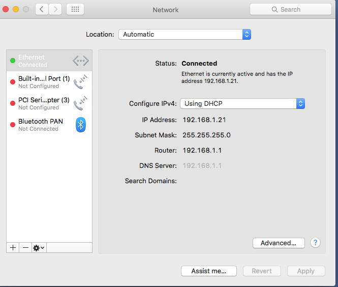

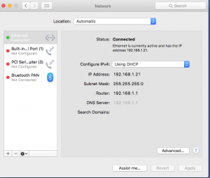

bclinton Posted February 28, 2016 Share Posted February 28, 2016 And you know you have to check in System Preferences > Network to activate the new interface ? And you also know that you have to use the Applications/Wireless Network Utility.app to configure your network profiles ? This is not automatic. No wifi adapter shows up in Network Config. When i try to launch the wireless config util it just flashes and never opens. Link to comment https://www.insanelymac.com/forum/topic/308097-guide-el-capitan-1011x-dell-optiplex-780-760-755-790-990/page/27/#findComment-2219271 Share on other sites More sharing options...

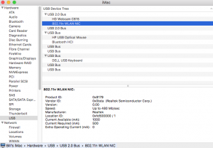

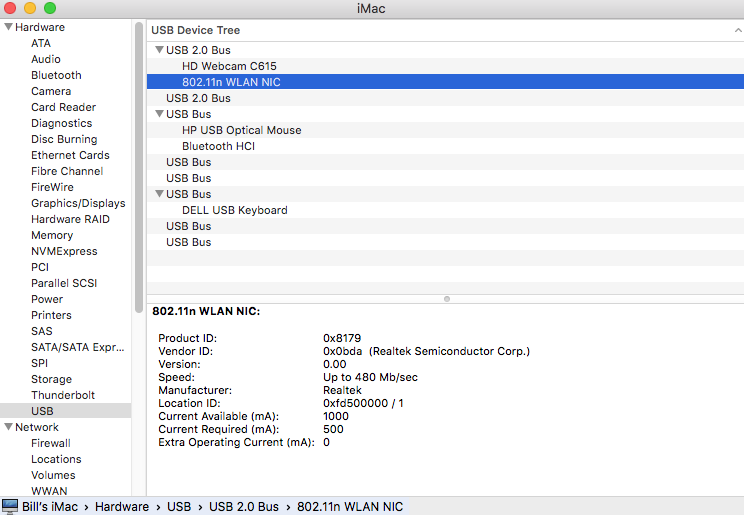

polyzargone Posted February 28, 2016 Share Posted February 28, 2016 @bclinton Check that the USB LAN appears in System Informations > USB. If not, try another port. Needless to say that you have to use USB_Injector.kext in EFI/CLOVER/kexts/10.11 for proper USB management in OS X 10.11. @cfxomega I just made a new USB thumb following post#1 to the letter. I'll report you back later. @cfxomega Well, it boots fine on mine. Primary Video is also set to Auto. What about the video output you're using ? HDMI right ? Link to comment https://www.insanelymac.com/forum/topic/308097-guide-el-capitan-1011x-dell-optiplex-780-760-755-790-990/page/27/#findComment-2219290 Share on other sites More sharing options...
bclinton Posted February 28, 2016 Share Posted February 28, 2016 @bclinton Check that the USB LAN appears in System Informations > USB. If not, try another port. Needless to say that you have to use USB_Injector.kext in EFI/CLOVER/kexts/10.11 for proper USB management in OS X 10.11. Yes it shows up under sys info... Link to comment https://www.insanelymac.com/forum/topic/308097-guide-el-capitan-1011x-dell-optiplex-780-760-755-790-990/page/27/#findComment-2219303 Share on other sites More sharing options...
